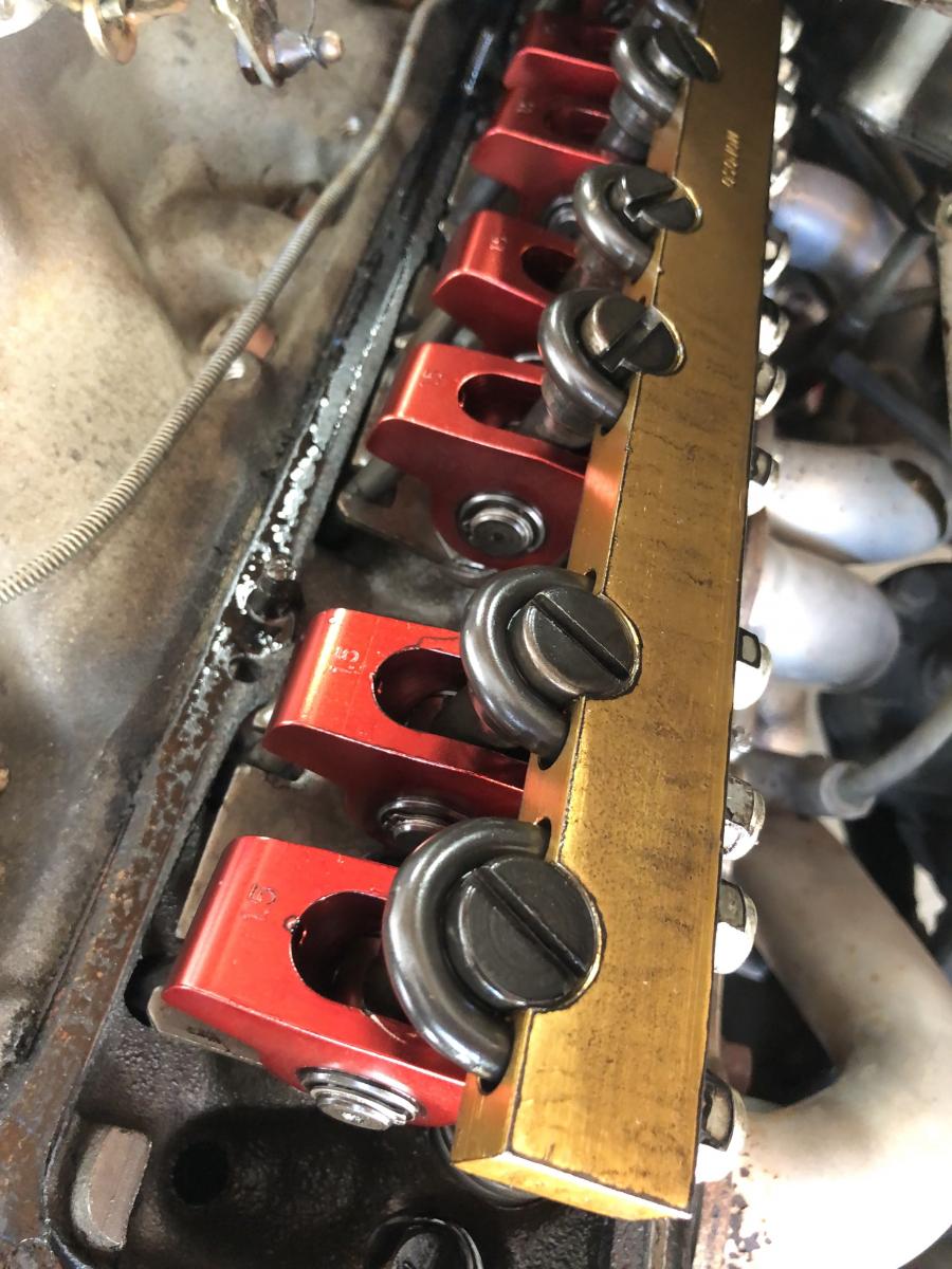

Size:  322.0 KBName:  valves.jpg
Size:  136.0 KBName:  week 1a.jpg
Size:  298.4 KBName:  week 1b.jpg
Size:  266.2 KBName:  week 1c.jpg
Size:  246.0 KBName:  week 1d.jpg

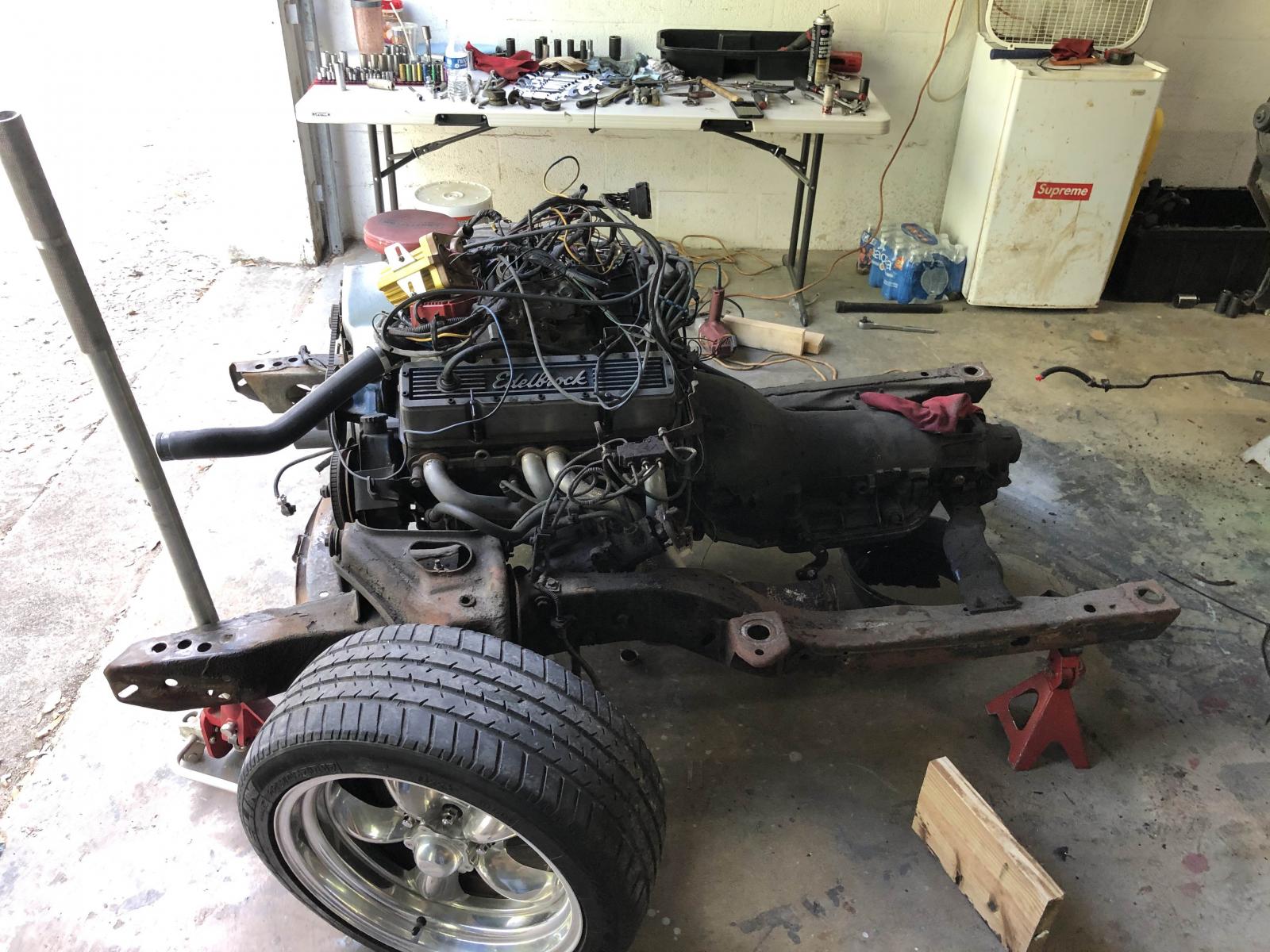

      Week 2 Updates

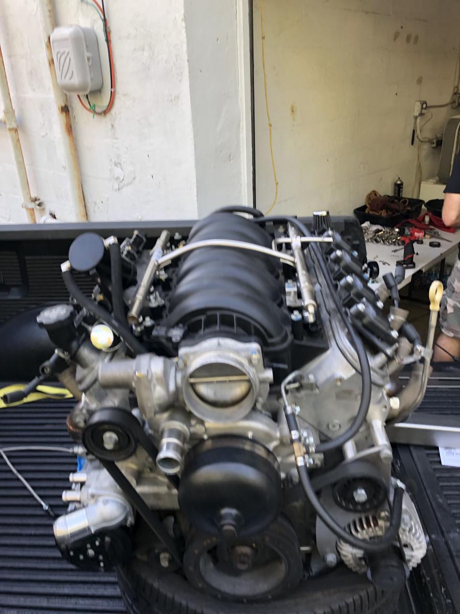

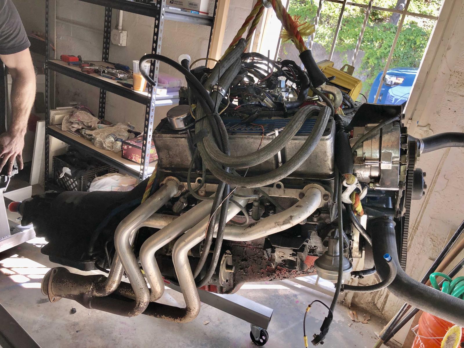

      Some of week 2 progress. Old motor and Trans out. Scored a pretty good deal from a nice guy and got a LS2 with PRC heads and and MS3 cam. May reach out to Texas Speed to find out more about the ported heads. Build on the motor appears solid. Came with changes to the belt system, pretty sure the alternator will have to be put back to stock location and don't think the sikky oil pan will work with the subframe but lots of work to get to before that.

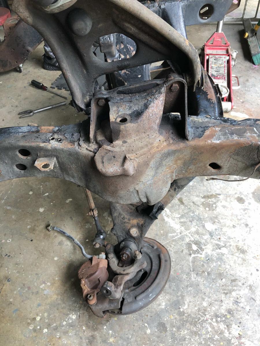

      Sunday week 2 subframe
      Got the subframe stripped of the suspension and brakes
Size:  183.0 KBName:  week2d.jpg

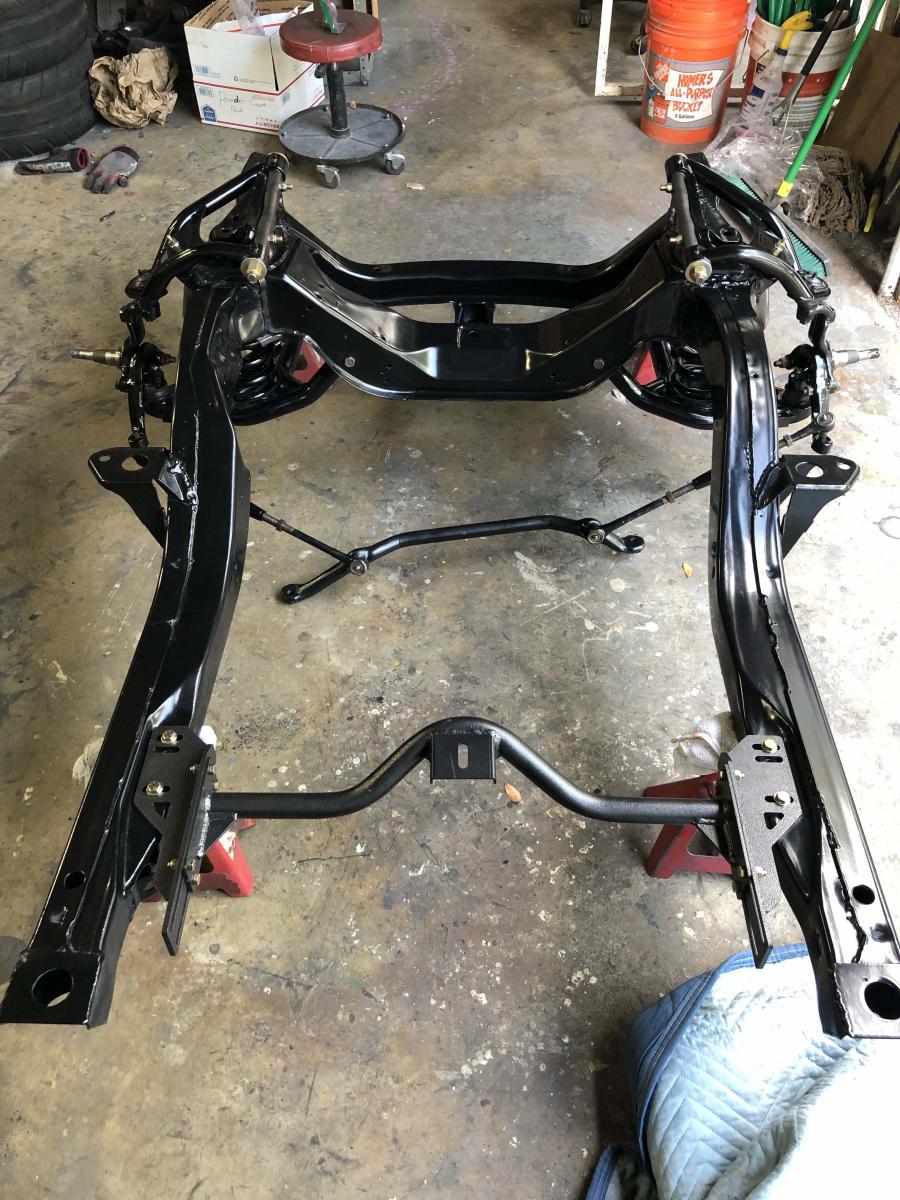

      Really happy with how these Hotchkis parts held up over the past 18 years. Going to have them cleaned and powder coated and upgrade with control arms and lowering leaf springs

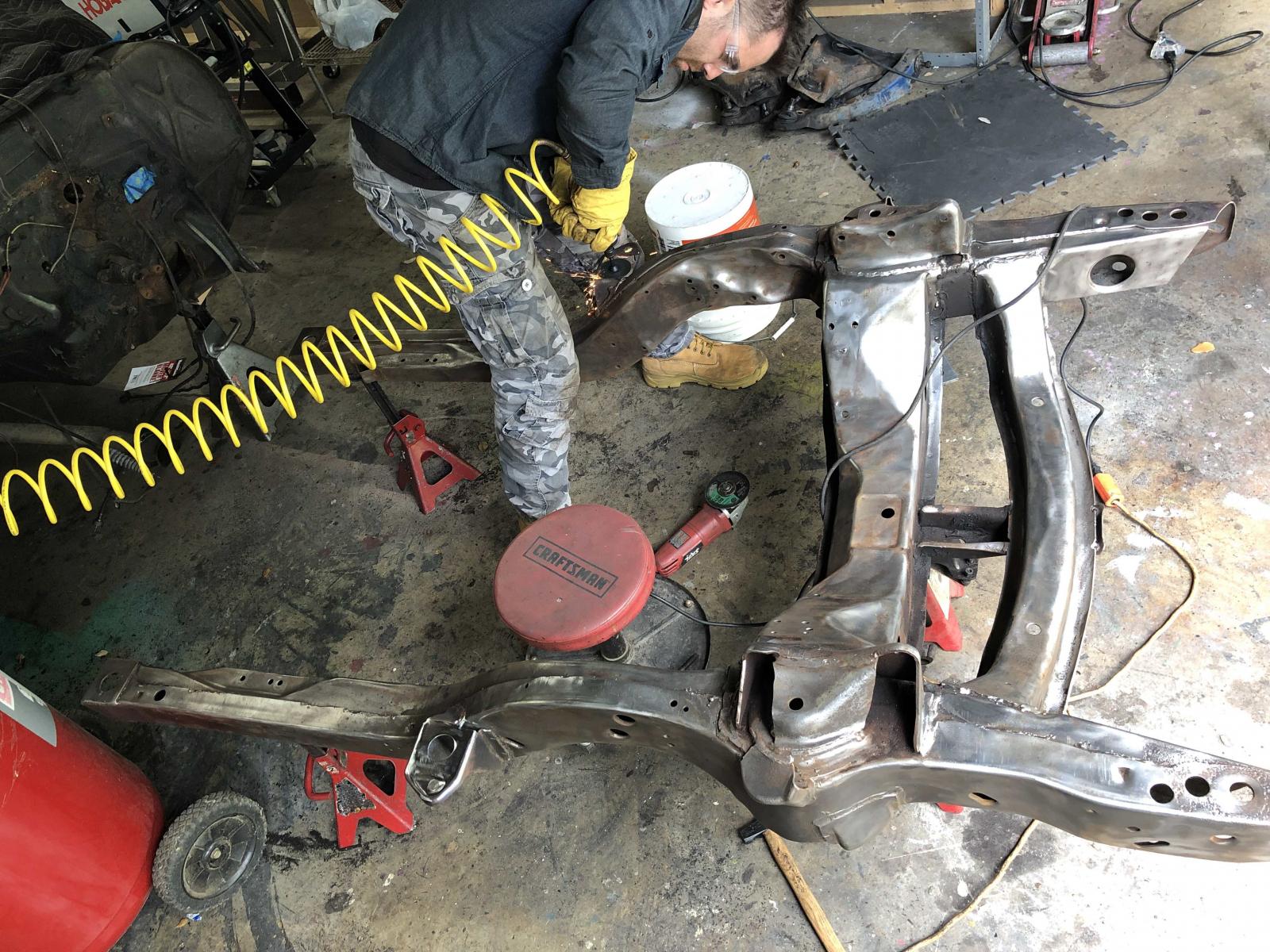

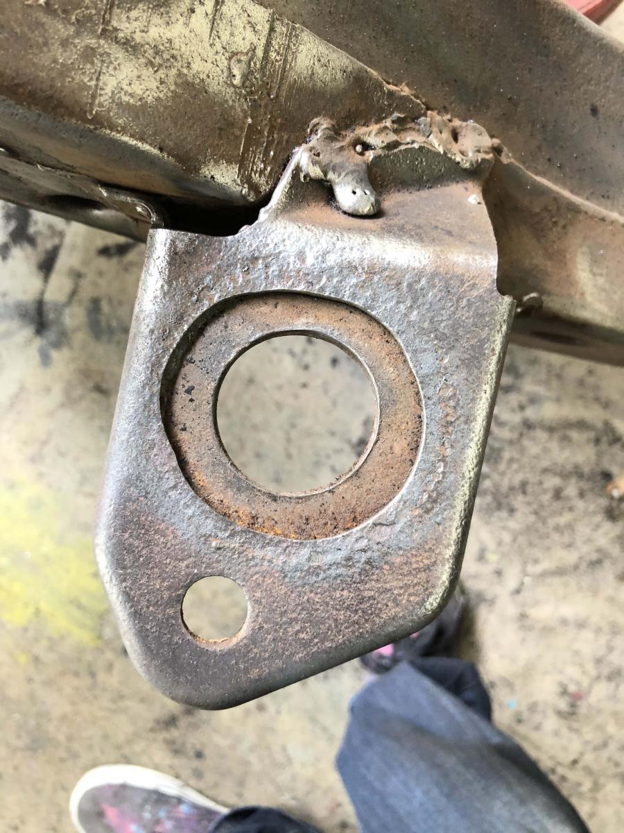

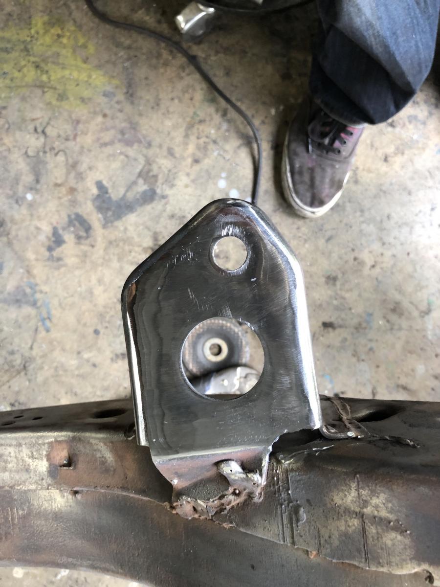

      This is what and angle grinder, a buddy who can weld and several hours of your life look like.

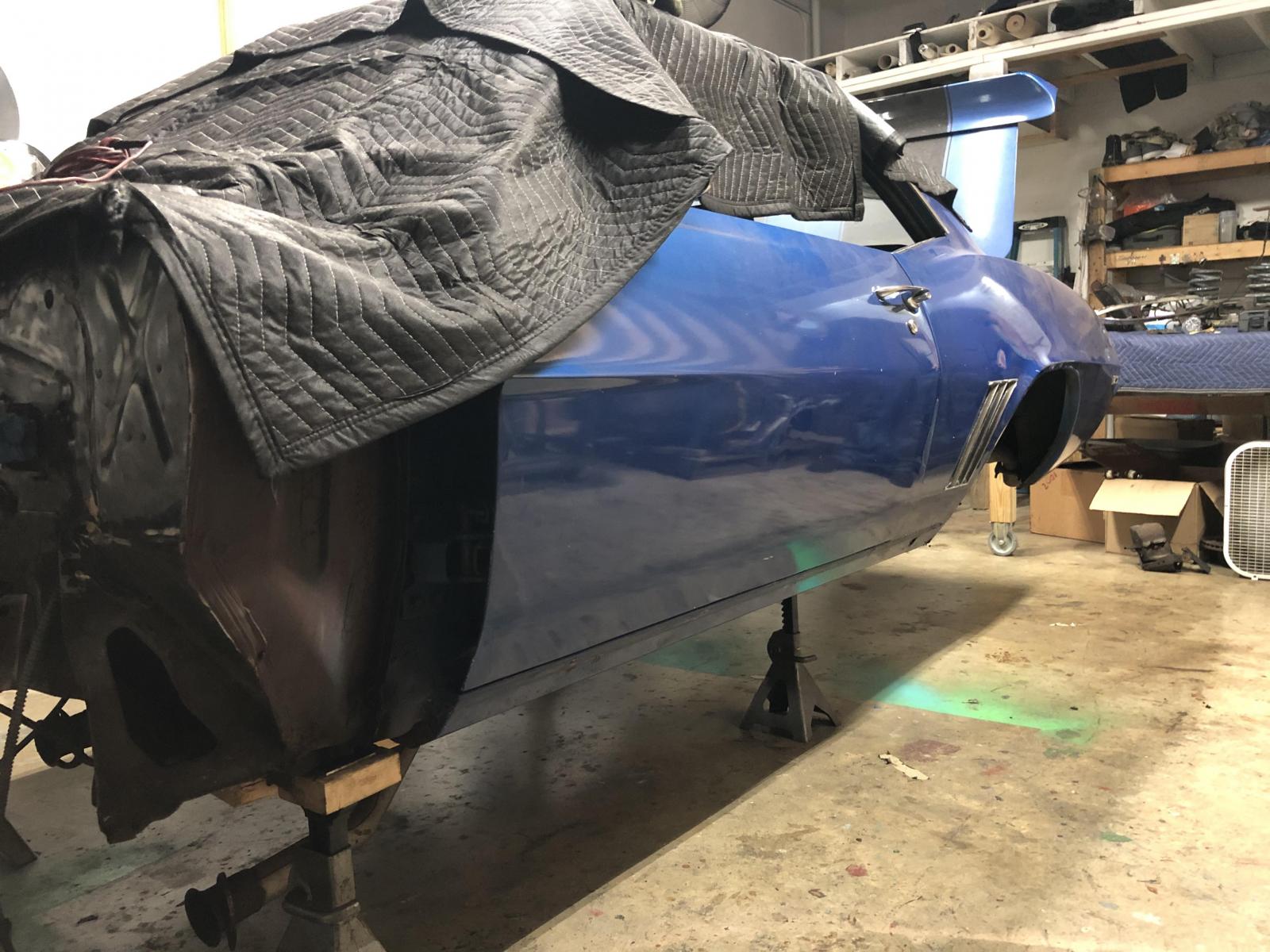

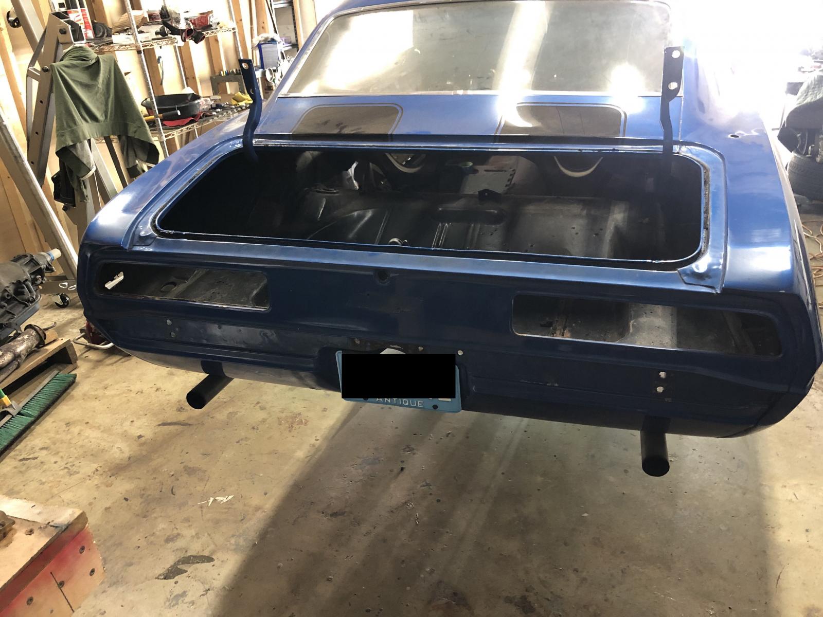

      The repair that took place one year after I first purchased the car was a total joke, we managed to do it correctly this time with replacement metal I got on ebay.
Size:  171.8 KBName:  week2h.jpg

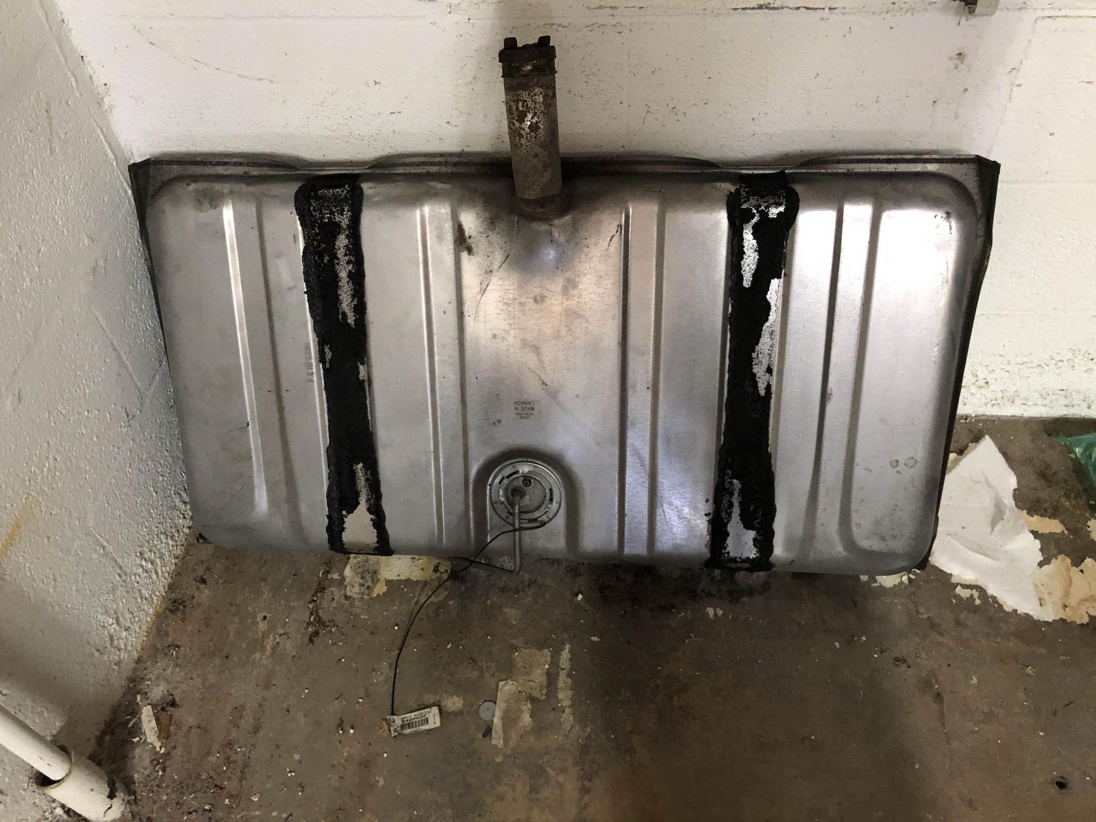

      Got the gas tank out, it was replaced about 13 years ago so not in too bad shape. Finally got the Drum brakes off and man did that feel good. Axle is drained, anyone with any suggestions on kits to rebuild the 10 bolt would be great. Don't think the car has been in this many parts since it was put together, underside of the body seems to have held up pretty well. Will see what direction I go with the body once sandblasting happens. Subframe goes out tomorrow.

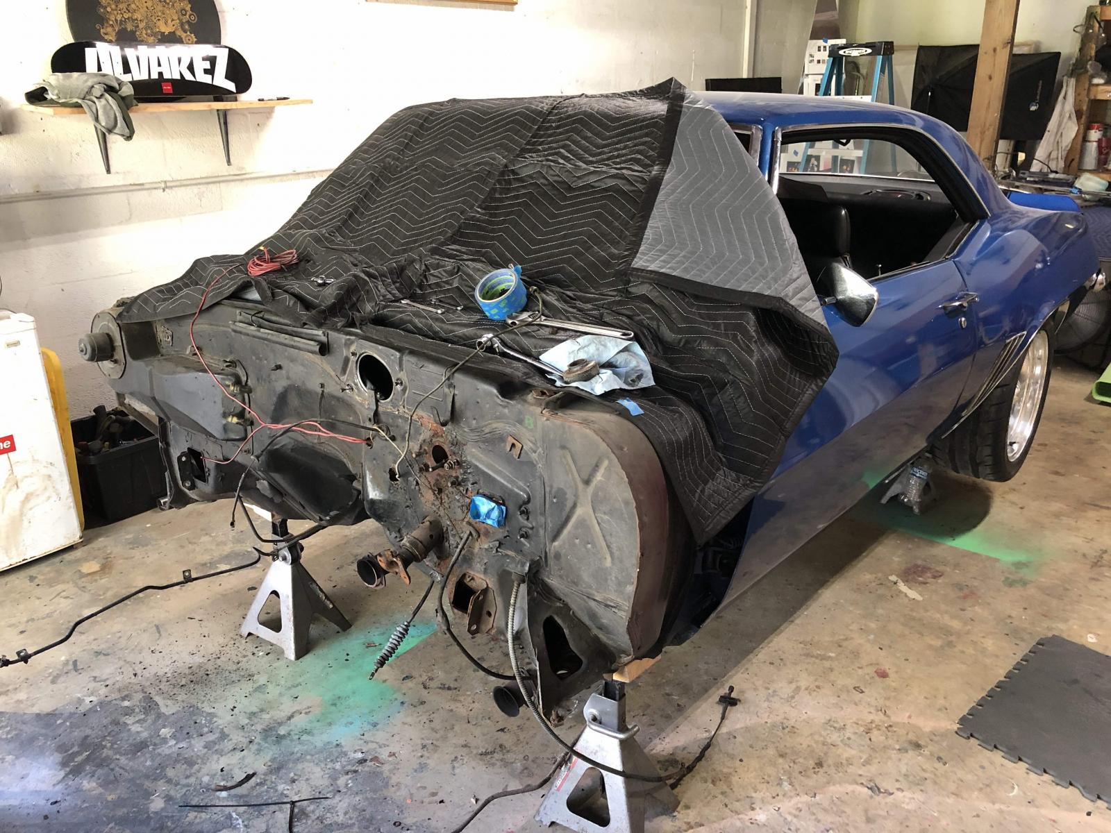

      So apparently something feral was hoarding foam padding and acorns in the headliner and it must have been in there for the past 20 plus years. Funny stuff. Name:  week4a.jpg

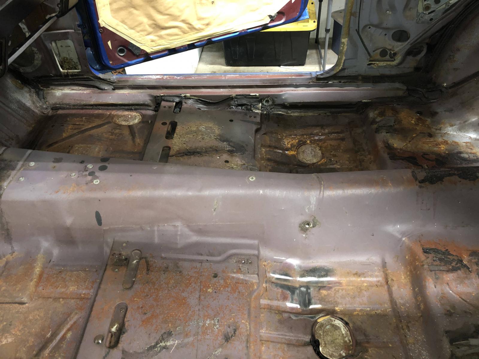

      Got the interior out and besides one spot on the drivers side that had some lame body filler work done (Shhh it was me at 21) it looks to be in decent shape. Going to repair that correctly next.
Size:  209.6 KBName:  week4c.jpg
Size:  224.0 KBName:  week4d.jpg
Size:  214.2 KBName:  week4e.jpg

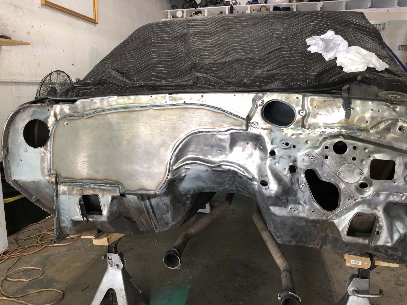

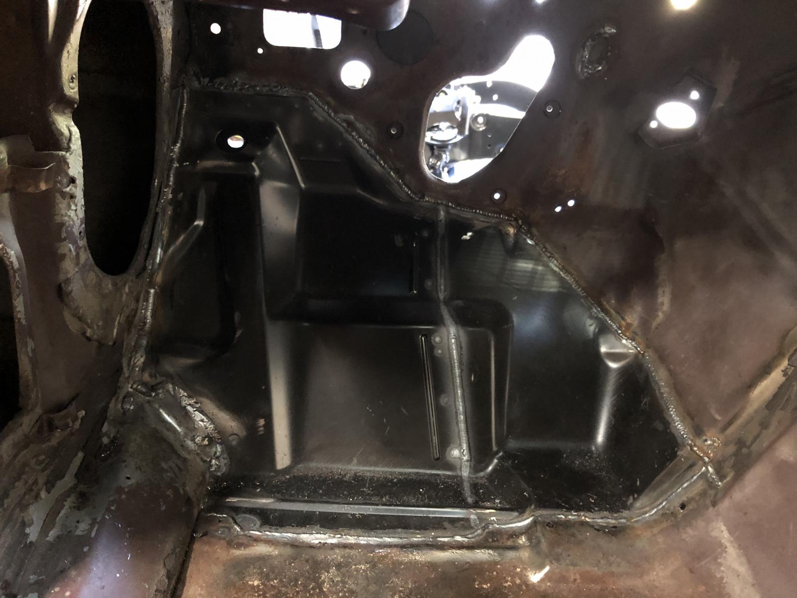

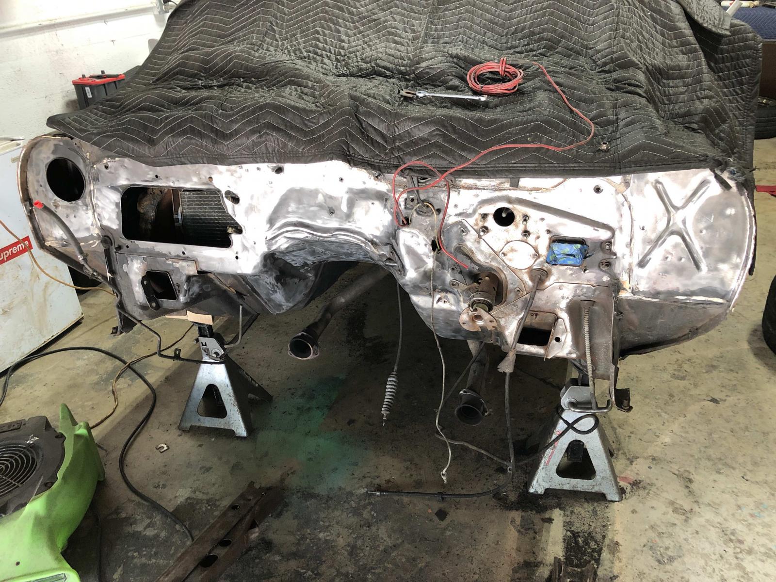

      Primed the firewall and my buddy welded in the Detroit Speed piece. I like the way it holds the original line of the firewall.
Size:  235.8 KBName:  week4g.jpg

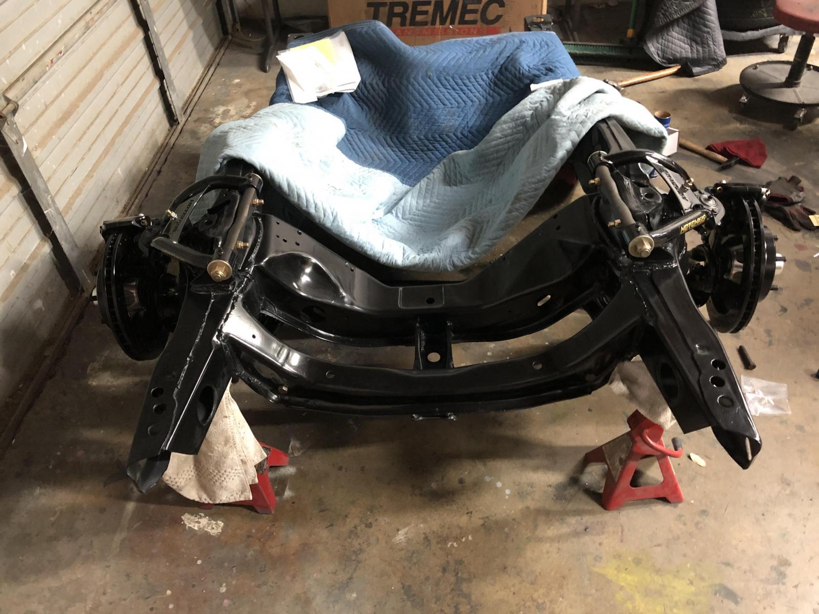

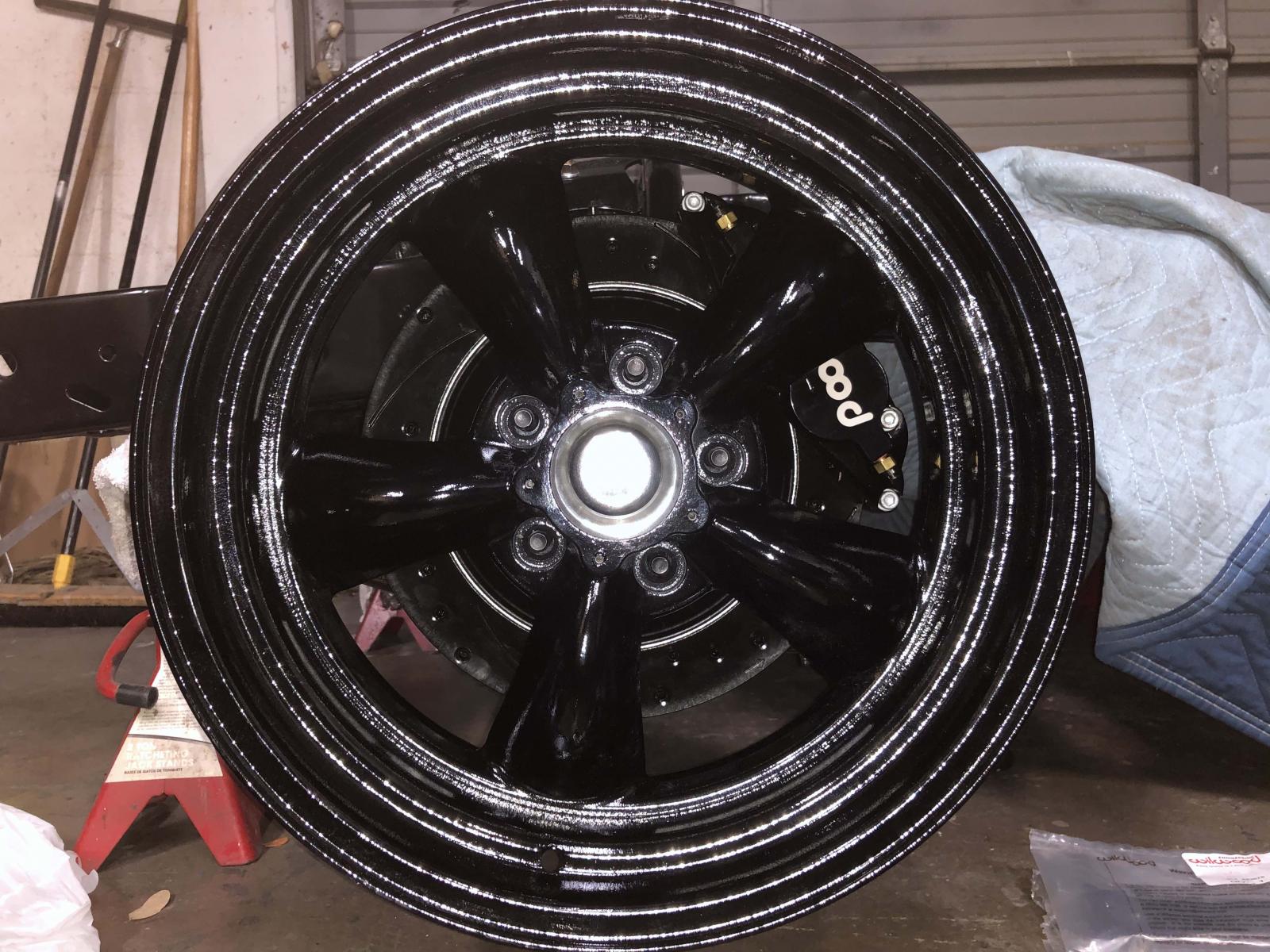

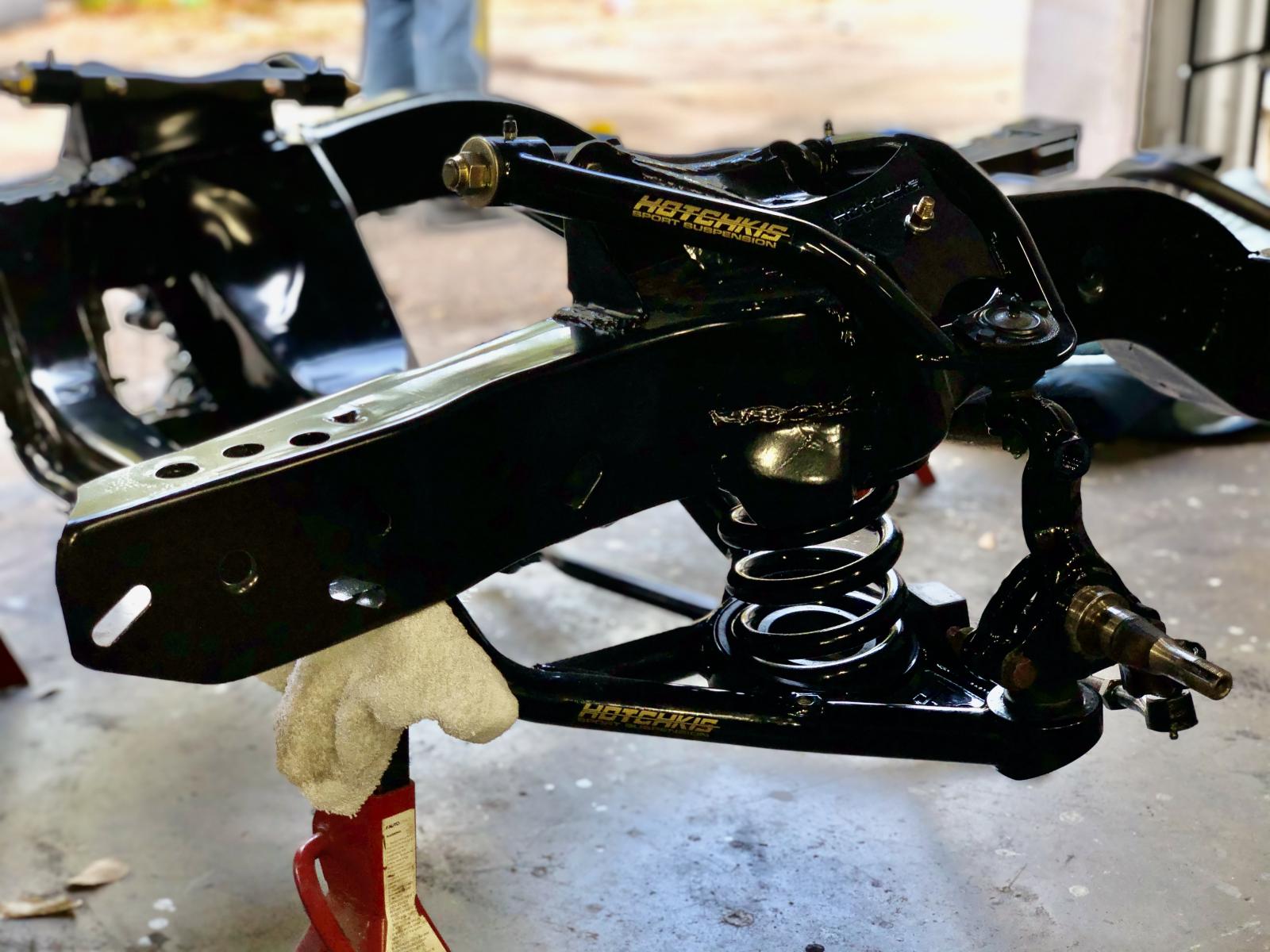

      5th or 6th weekend update, Can't remember what week it is.
      Finally some progress other than pulling things apart and welding. Completed some work on the firewall, Hotchkis was able to get me the upper and lower control arms and tie rod connectors. Shocks and rear leafs are on back order. Happy with how the subframe and wheels turned out with the powder coating. No issues with break fitment and the rims, might have been able to go with bigger rotors but this should still be a major improvement over the one pistons i had upfront with stock control arms. Let me know what you think of the setup. Name:  Week6a.jpg

      You are moving quickly and it's looking very nice. That subframe came out great with the powder coating. The Hotchkis setup with those brakes will be a big improvement on the handling of the car.

      Damn you are moving fast! That subframe cleaned up real nice. You'll be happy with the Hotchkis stuff. I only had the springs, swaybar and shocks from them and it made a big difference in the way the car handled.

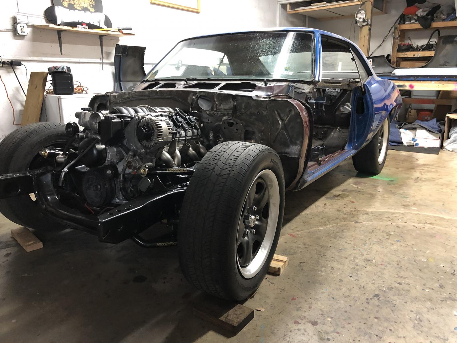

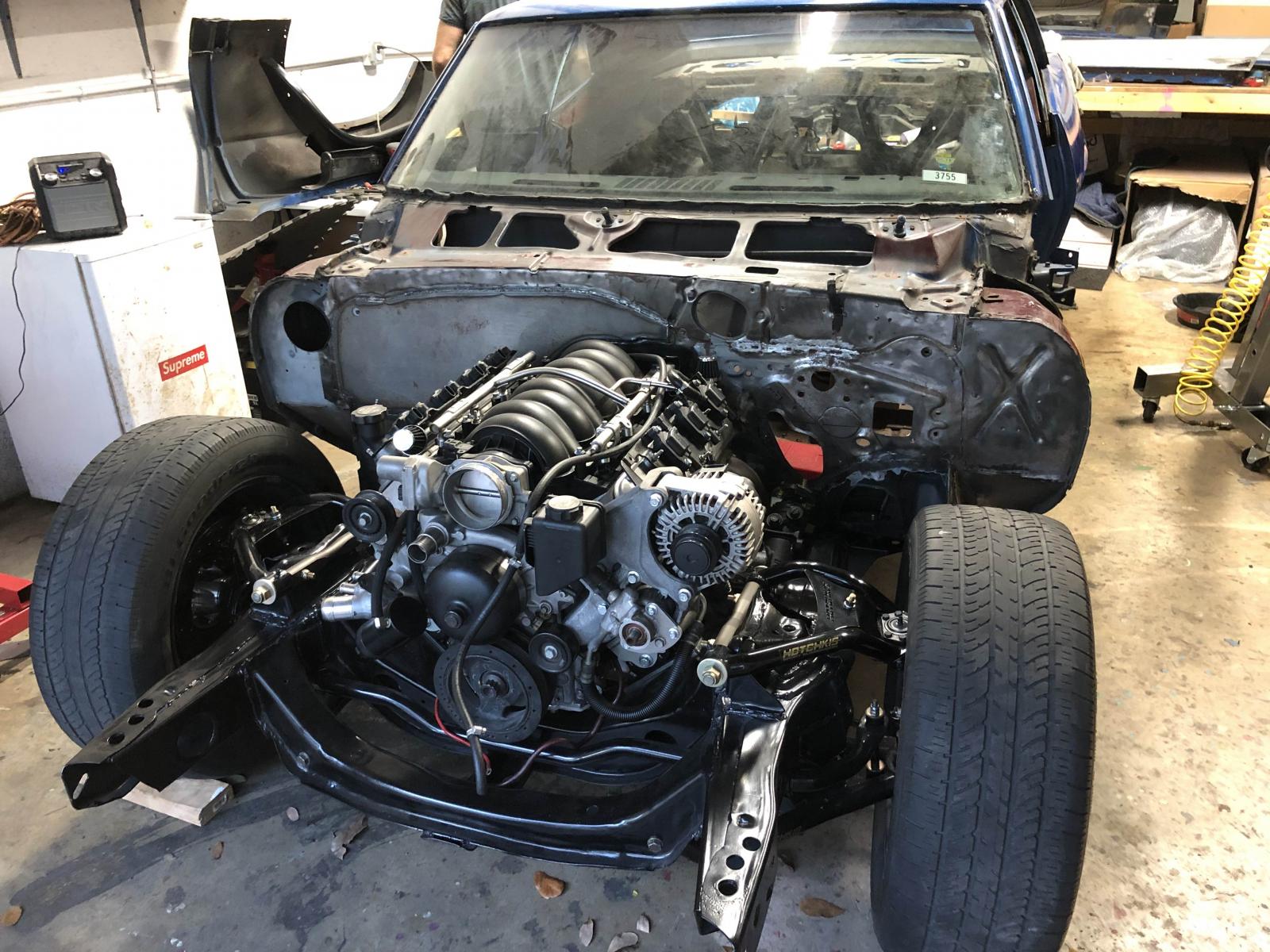

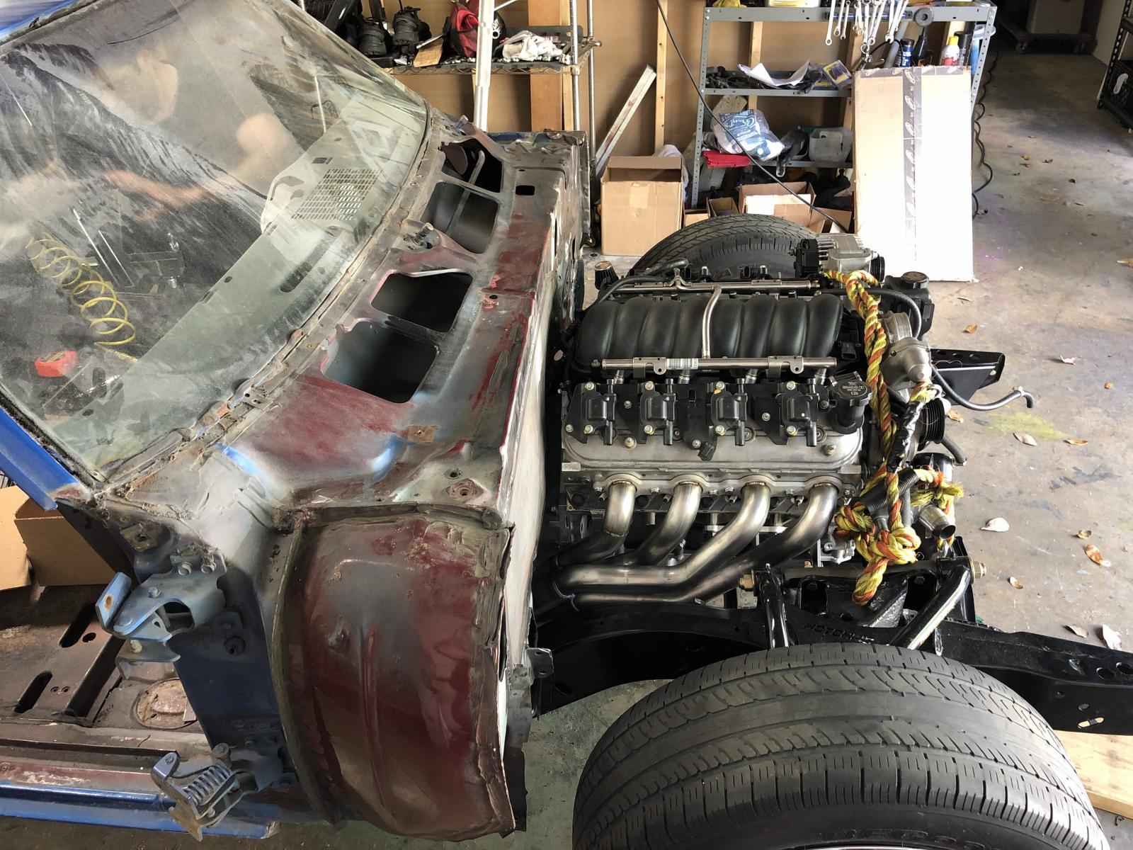

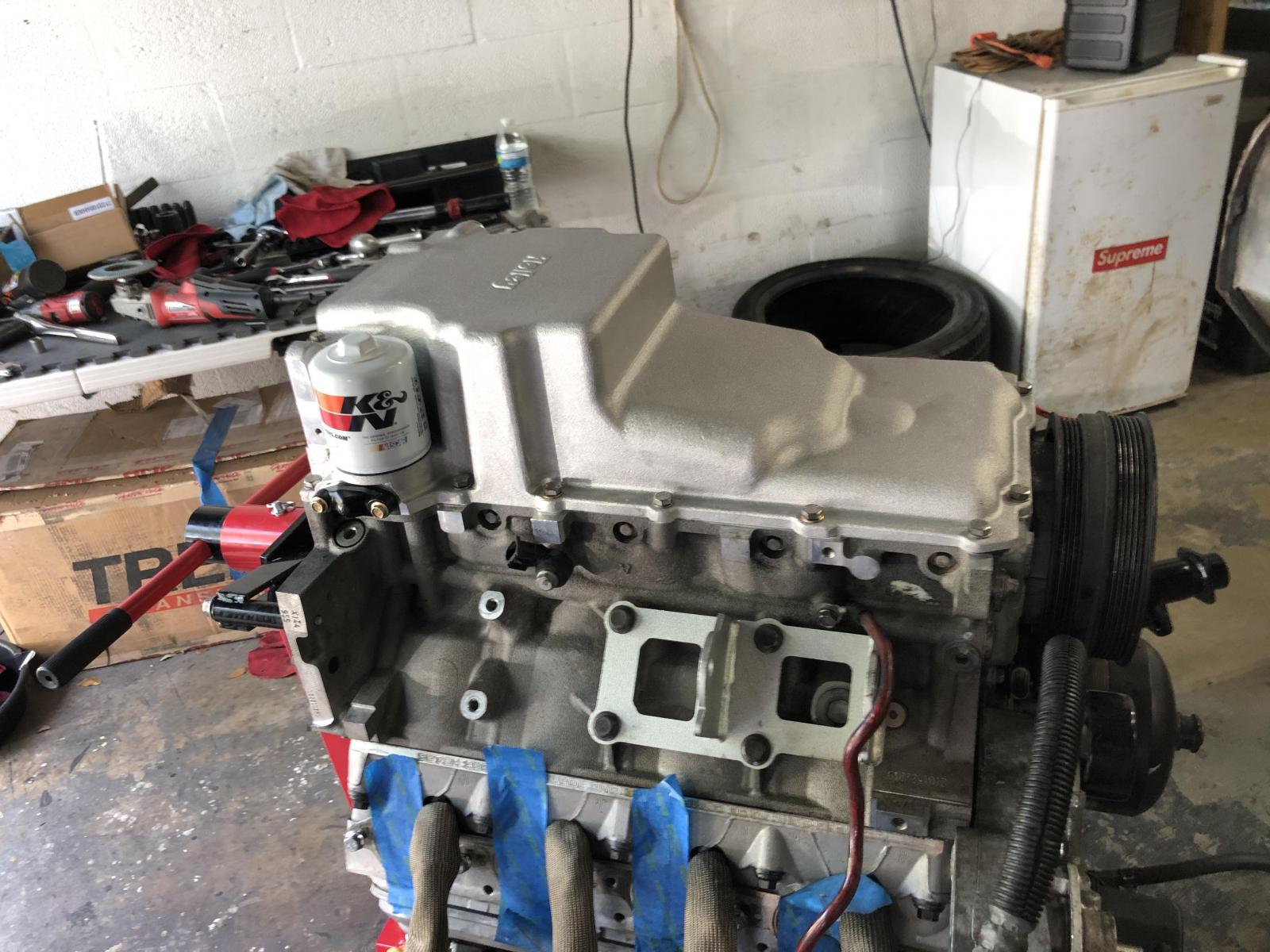

      After some shipping delays the oil pan came in and was finally able to mount the engine. seems to fit but still waiting on the headers as well as the shocks. Just a few more welds to get rid of some rust and then on to paint.
Size:  190.2 KBName:  pan.jpg
Size:  228.4 KBName:  mounted.jpg

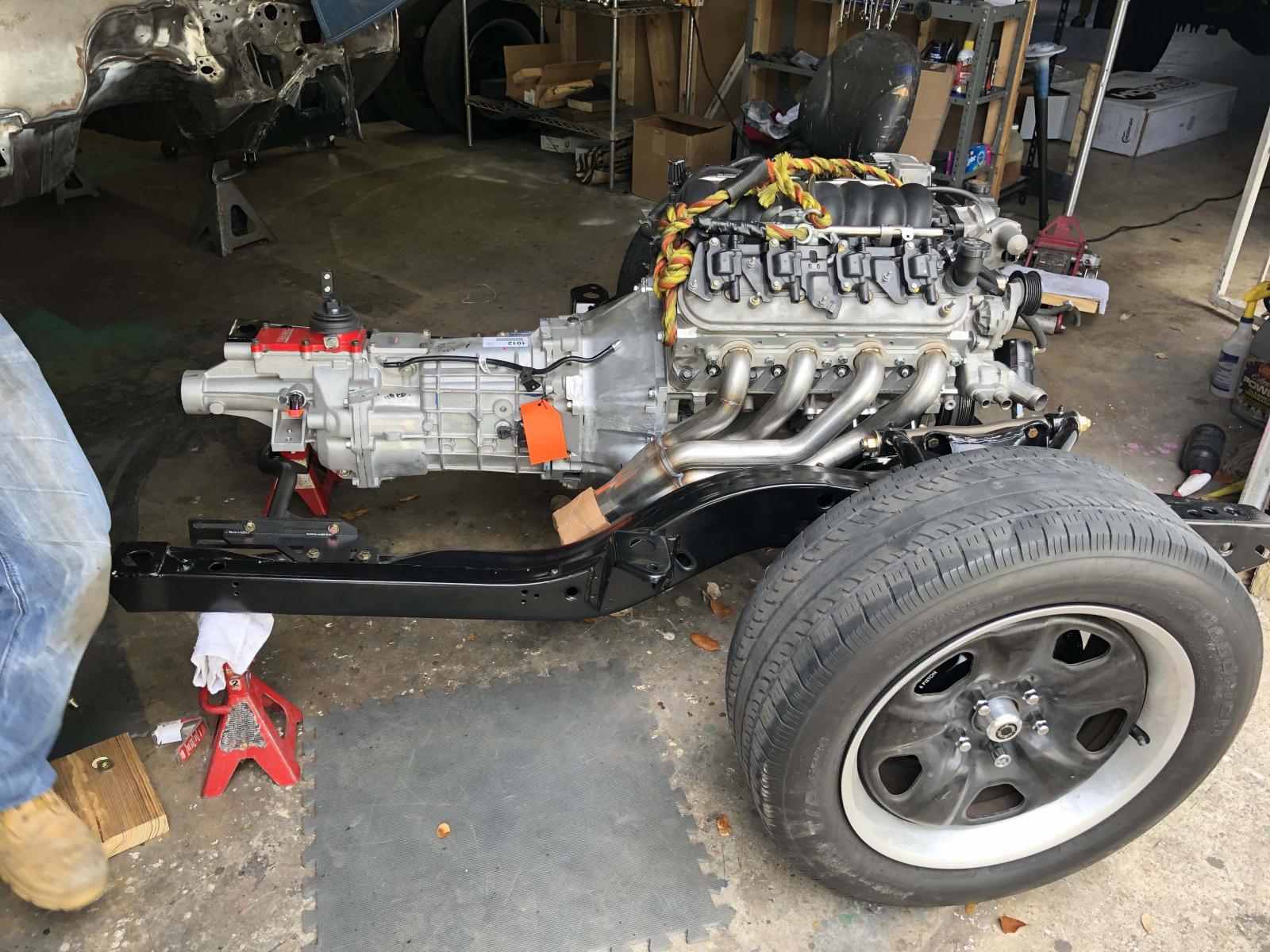

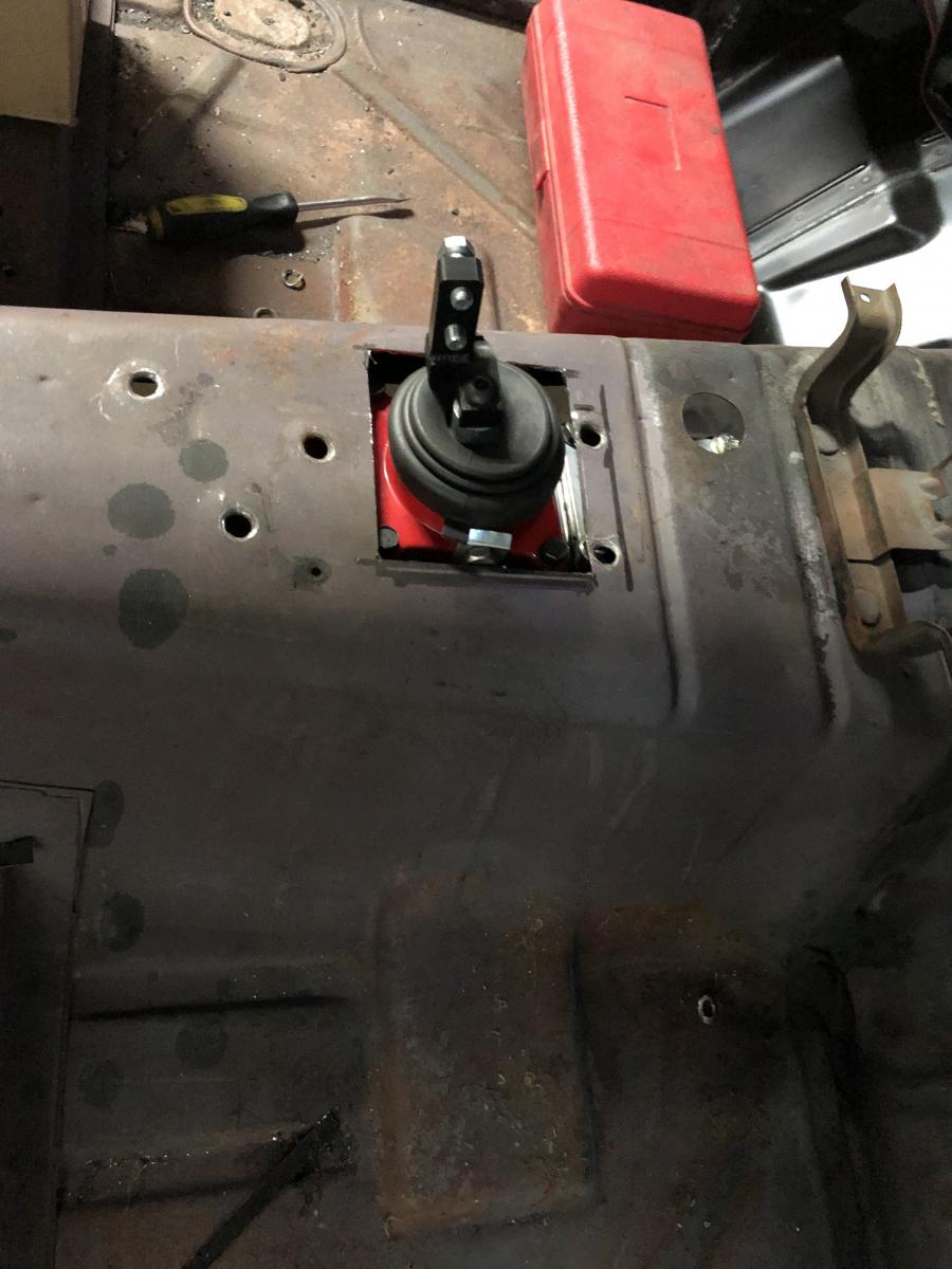

      Headers came in, really liked the way they fit and looked, mounted the trans. It was missing a spacer so we fabbed a wood one just to mock the trans tunnel hole. New Hotchkis leaf springs went in the back. Was suggested to go with the 1.5's. Had 2 inch lower blocks in what was probably saggy springs. Added .5 inch spacers to match the difference. will see how low they sit with the actual tires on as well as doors, trunk, hood and interior. Bushings seemed somewhat softer than the energy suspension ones that were previously on. Going to paint in a few days, wish me luck.
Size:  298.3 KBName:  week 8b.jpg
Size:  272.8 KBName:  week 8c.jpg
Size:  316.3 KBName:  week 8d.jpg
Size:  103.1 KBName:  week 8e.jpg
Size:  291.6 KBName:  week 8g.jpg
Size:  233.4 KBName:  week 8h.jpg
