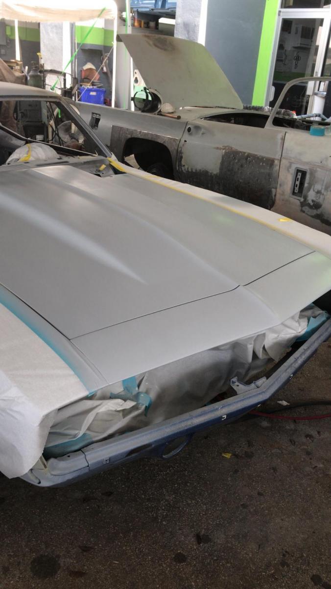

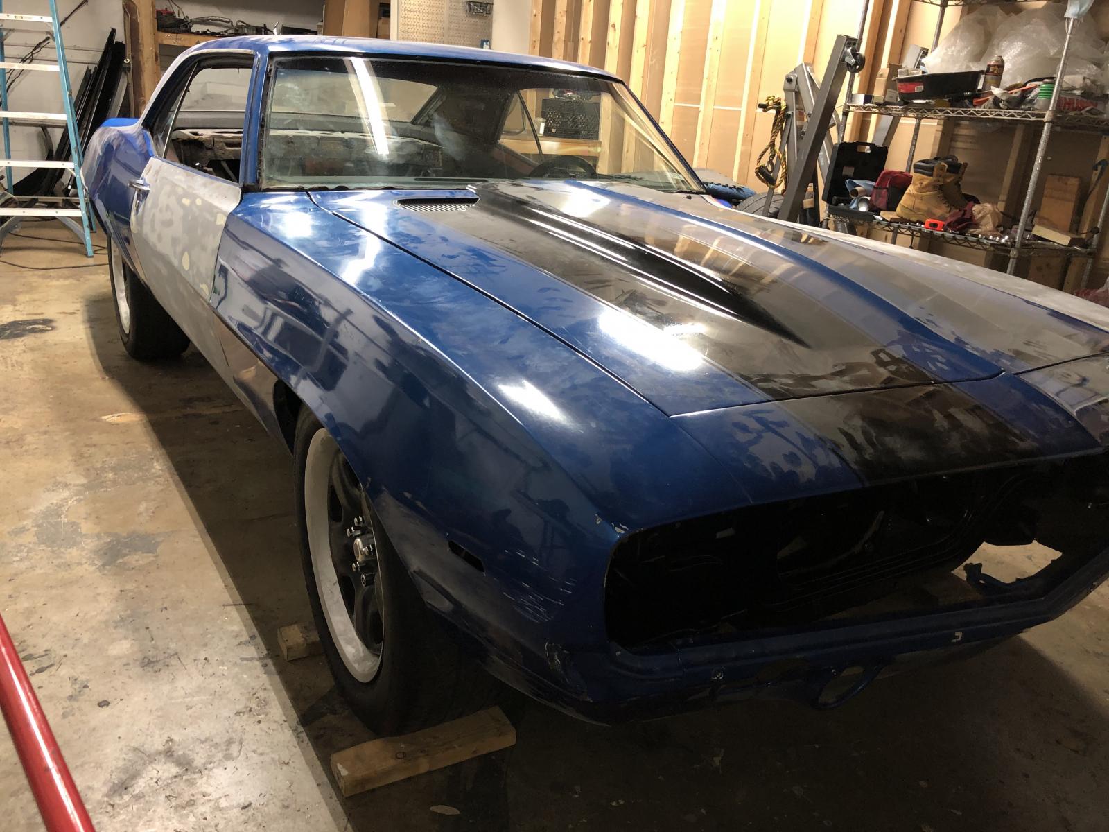

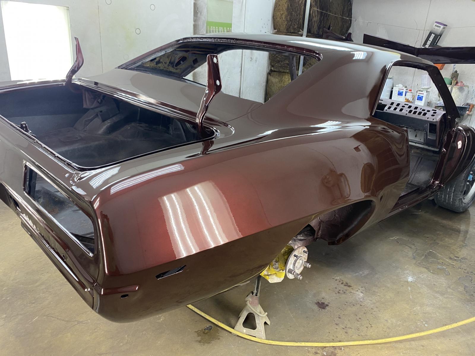

      Off to paint. wish me luck. Going from blue to original Burgundy

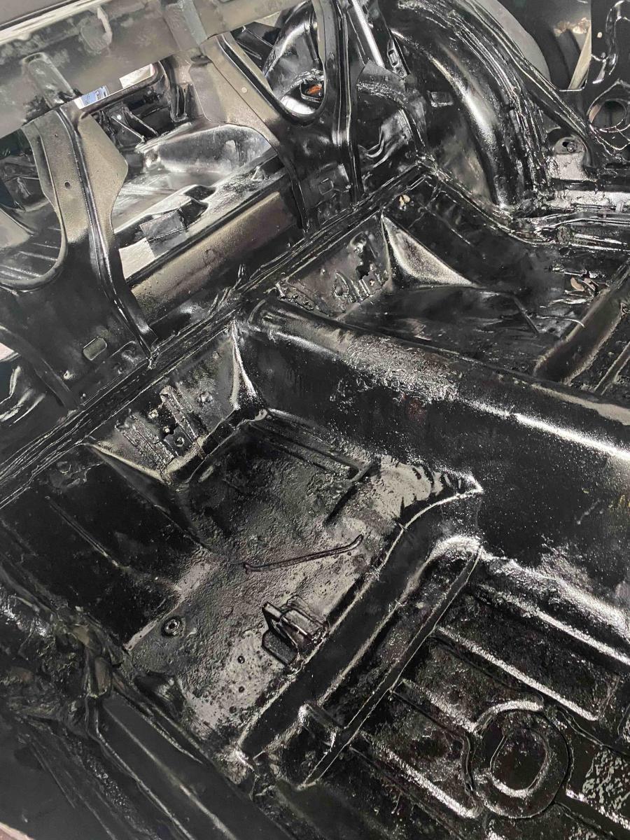

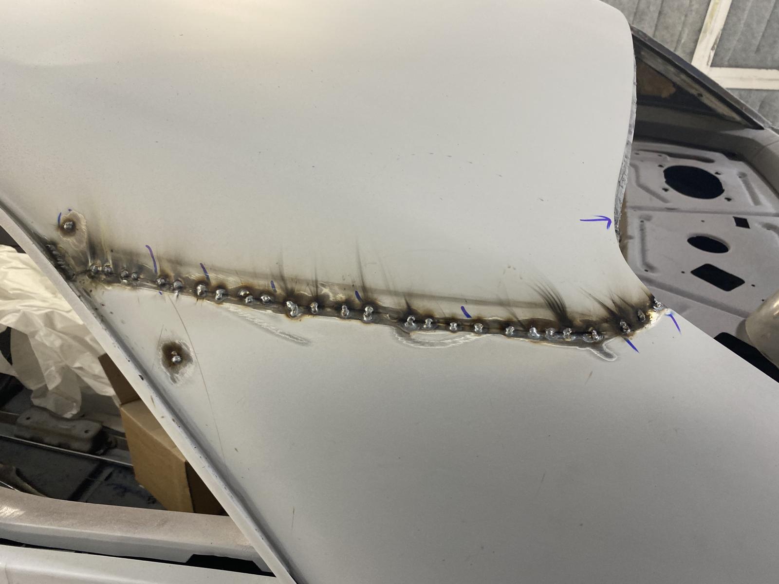

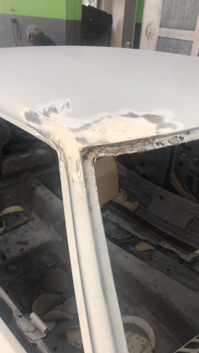

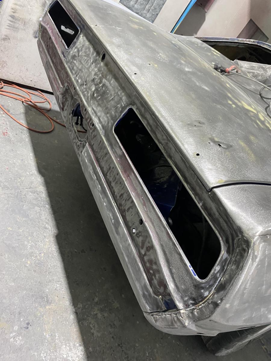

      Body Work Update

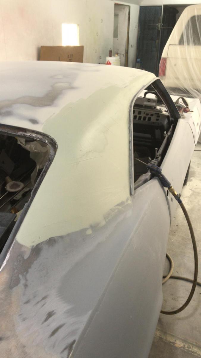

      Disclaimer: body work is not done by me (as is all other work) but here are a few updates. Wasn't planning on a complete restoration on the body but as most of you know, once it starts...

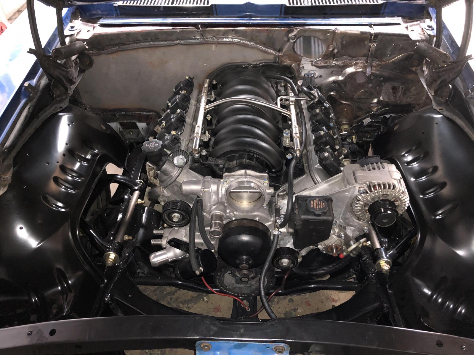

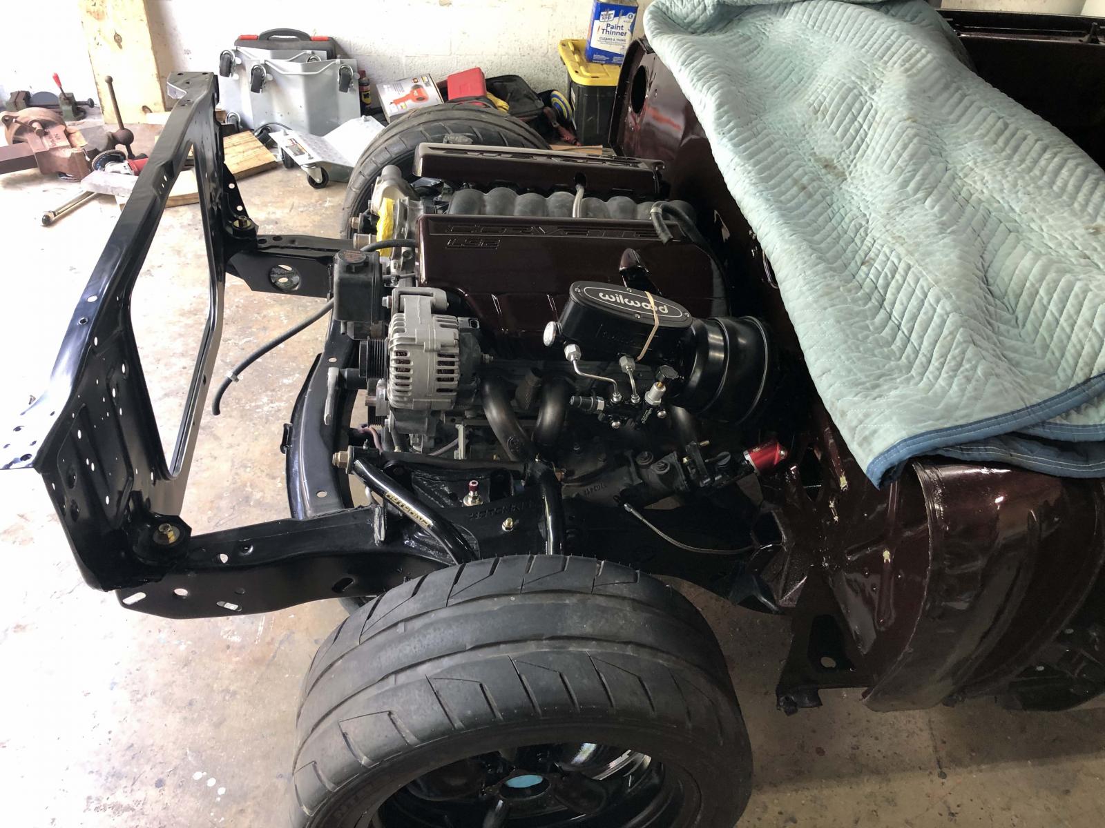

      Headers came in, really liked the way they fit and looked, mounted the trans. It was missing a spacer so we fabbed a wood one just to mock the trans tunnel hole. New Hotchkis leaf springs went in the back. Was suggested to go with the 1.5's. Had 2 inch lower blocks in what was probably saggy springs. Added .5 inch spacers to match the difference. will see how low they sit with the actual tires on as well as doors, trunk, hood and interior. Bushings seemed somewhat softer than the energy suspension ones that were previously on. Going to paint in a few days, wish me luck.
      Attachment 176061Attachment 176062Attachment 176063Attachment 176064Attachment 176065Attachment 176066Attachment 176067

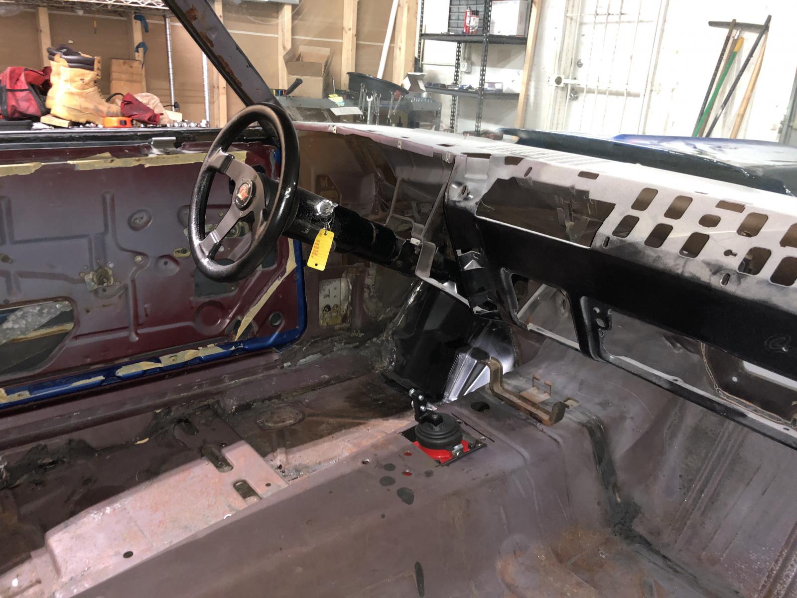

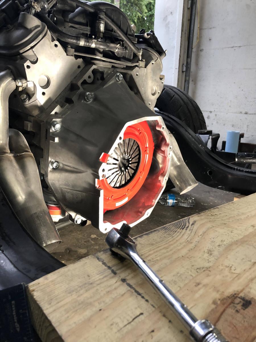

      Car was originally automatic so this is the preliminary cut that was made to fit the shifter. Didn’t appear to be clearance issues but car went to paint before I measured for the drive shaft. I’ll have to determine if I need to cut anymore based on driveline measurements. Did you have any need to raise the tremec box above the tunnel. I’m using the Holley black heart mounts and amp crossmember.

      Quote Originally Posted by Gmc427 View Post
      you didnt need to cut tunnel for tremec box?

      i raised mine for tko 600, wasnt happy with enging/trans angle

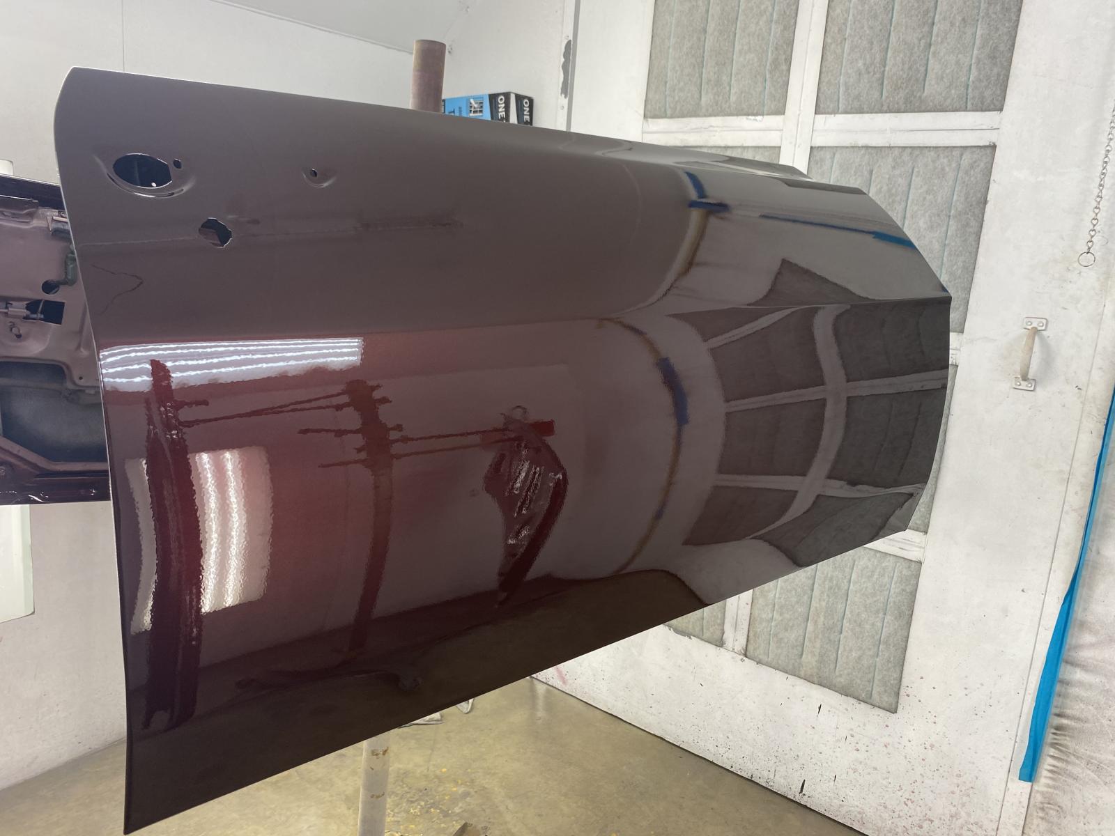

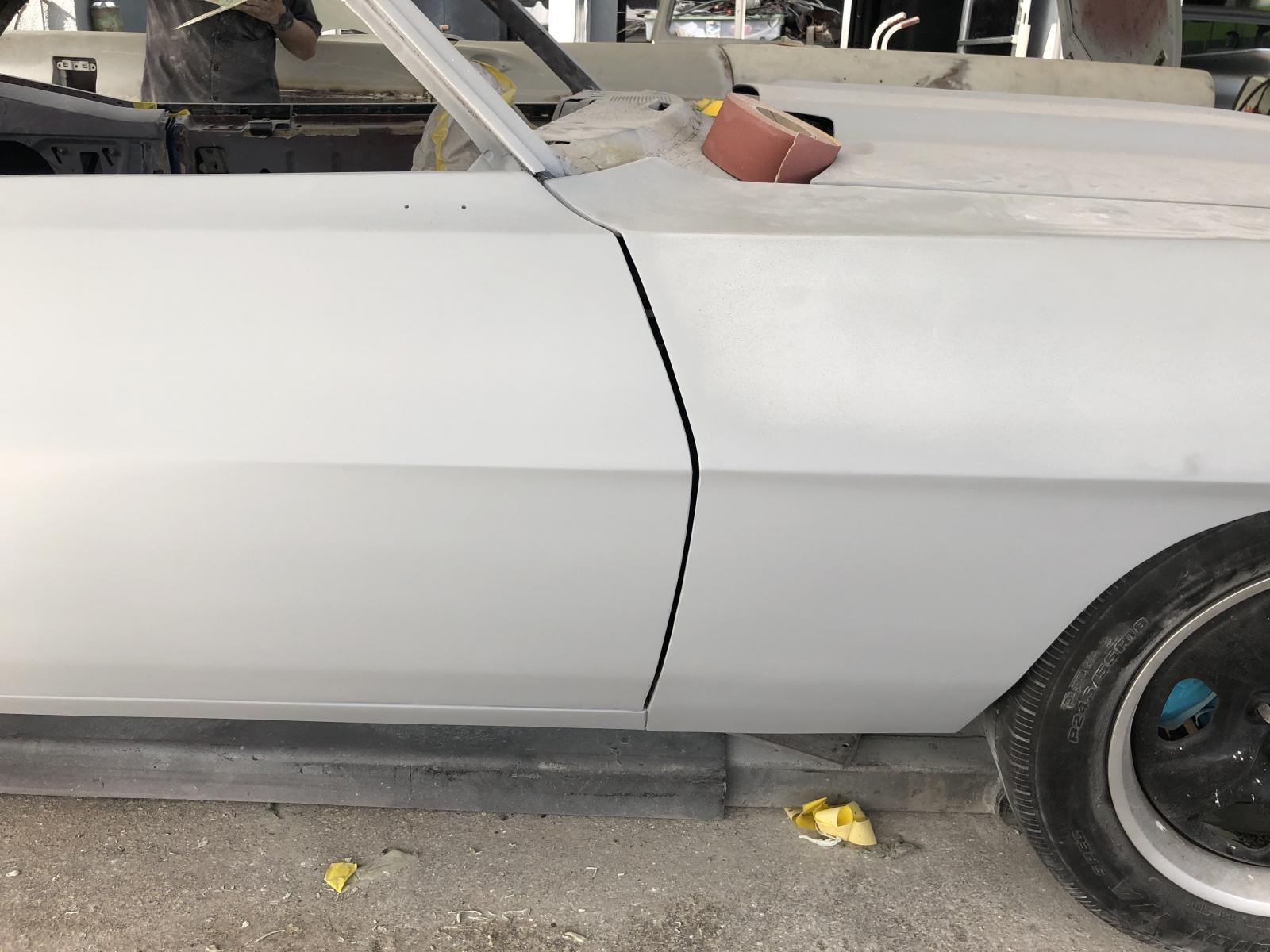

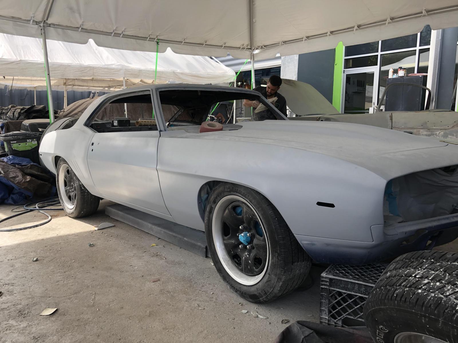

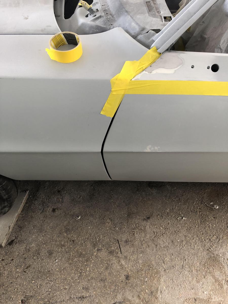

      Hi friends, I need some feedback. How do you guys feel about the door/front fender gaps. Acceptable or not. Want to make sure its not me being overly particular or it looking exaggerated due to the fact that the car is in primer. thanks for any input.

      The way the camaro doors open can't get the front to close. That looks about right.

      5,560
      The paint will tighten it up a little. That car is in beautiful shape. I can't wait to see it all in paint.

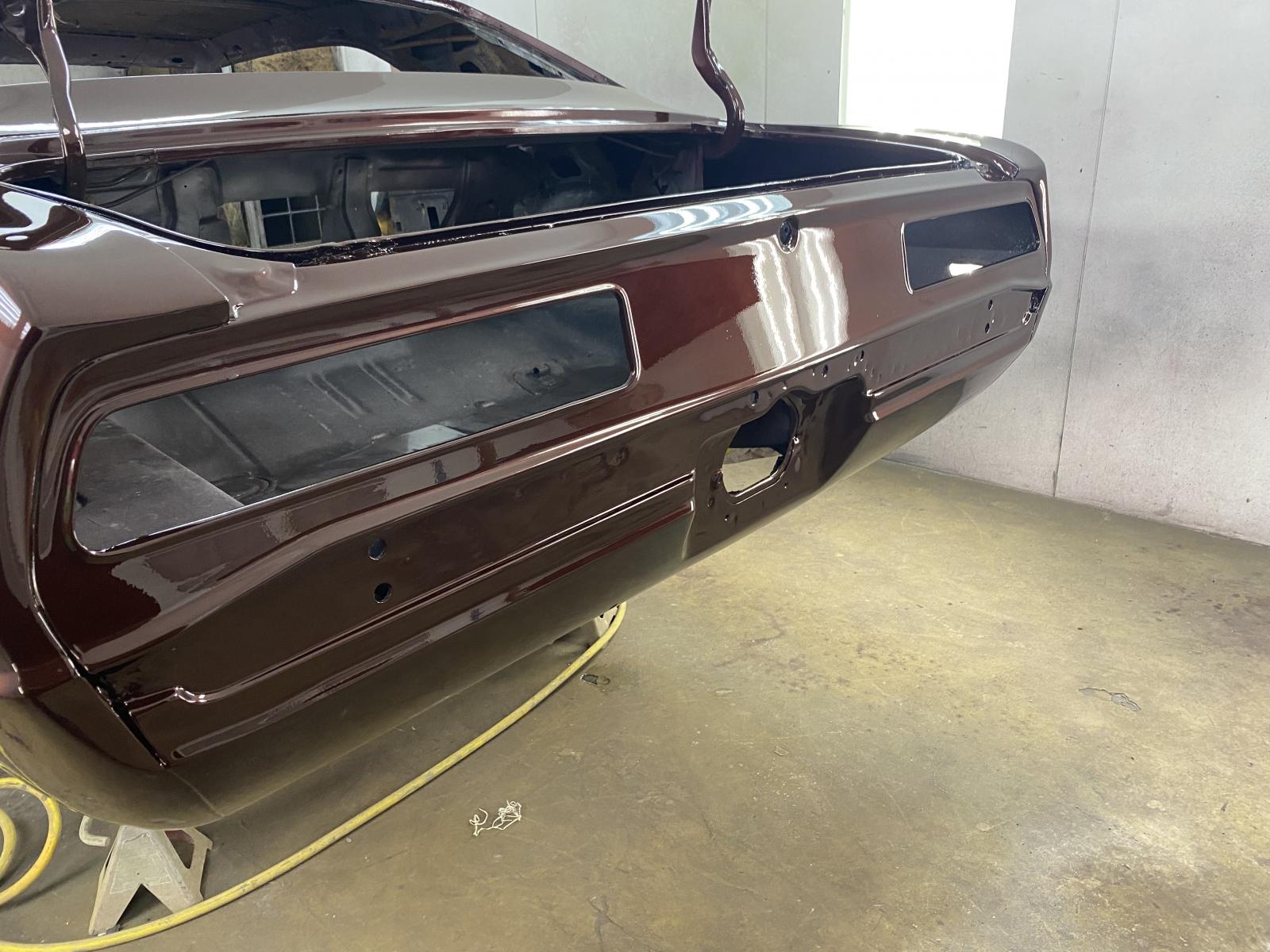

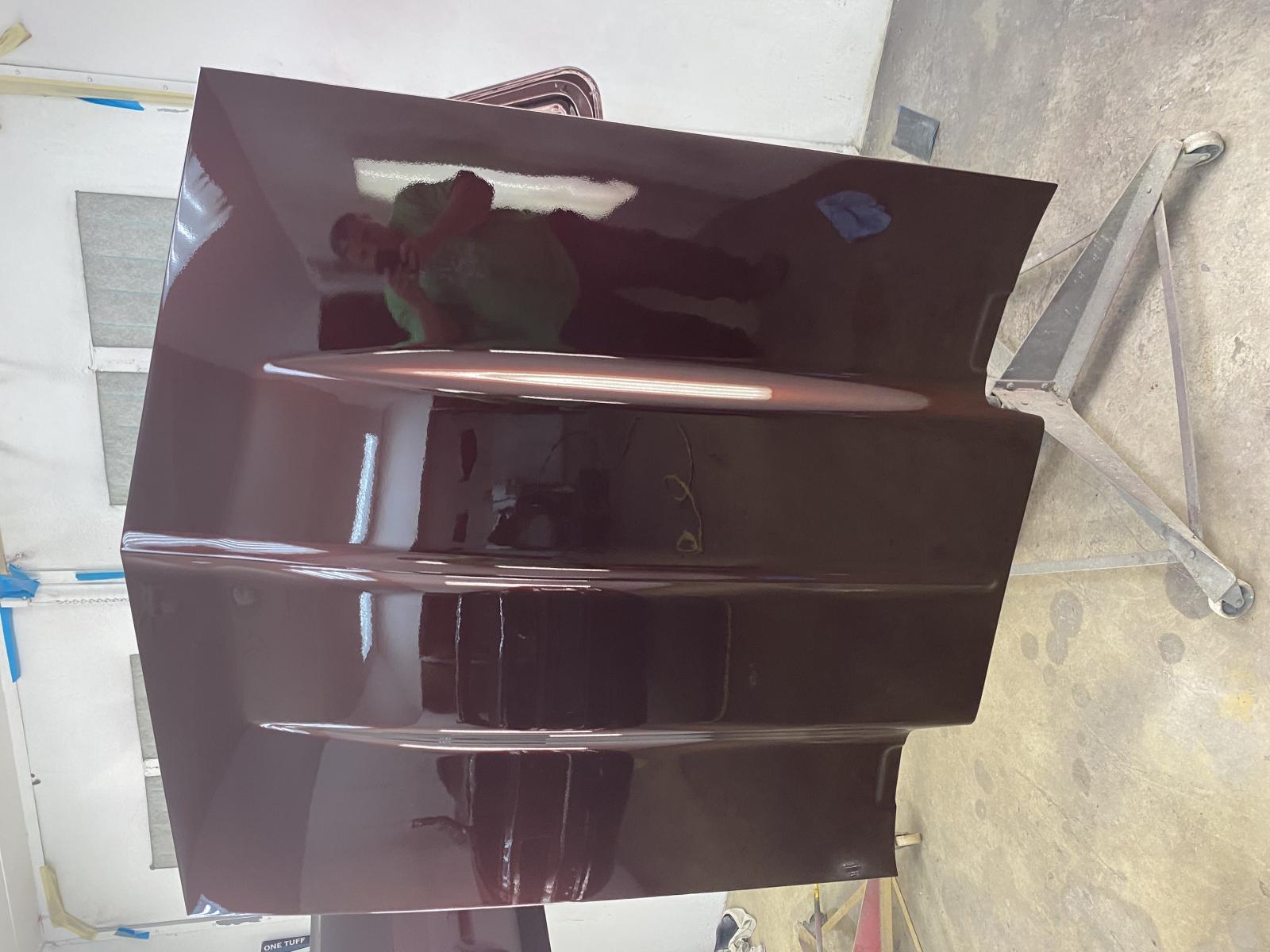

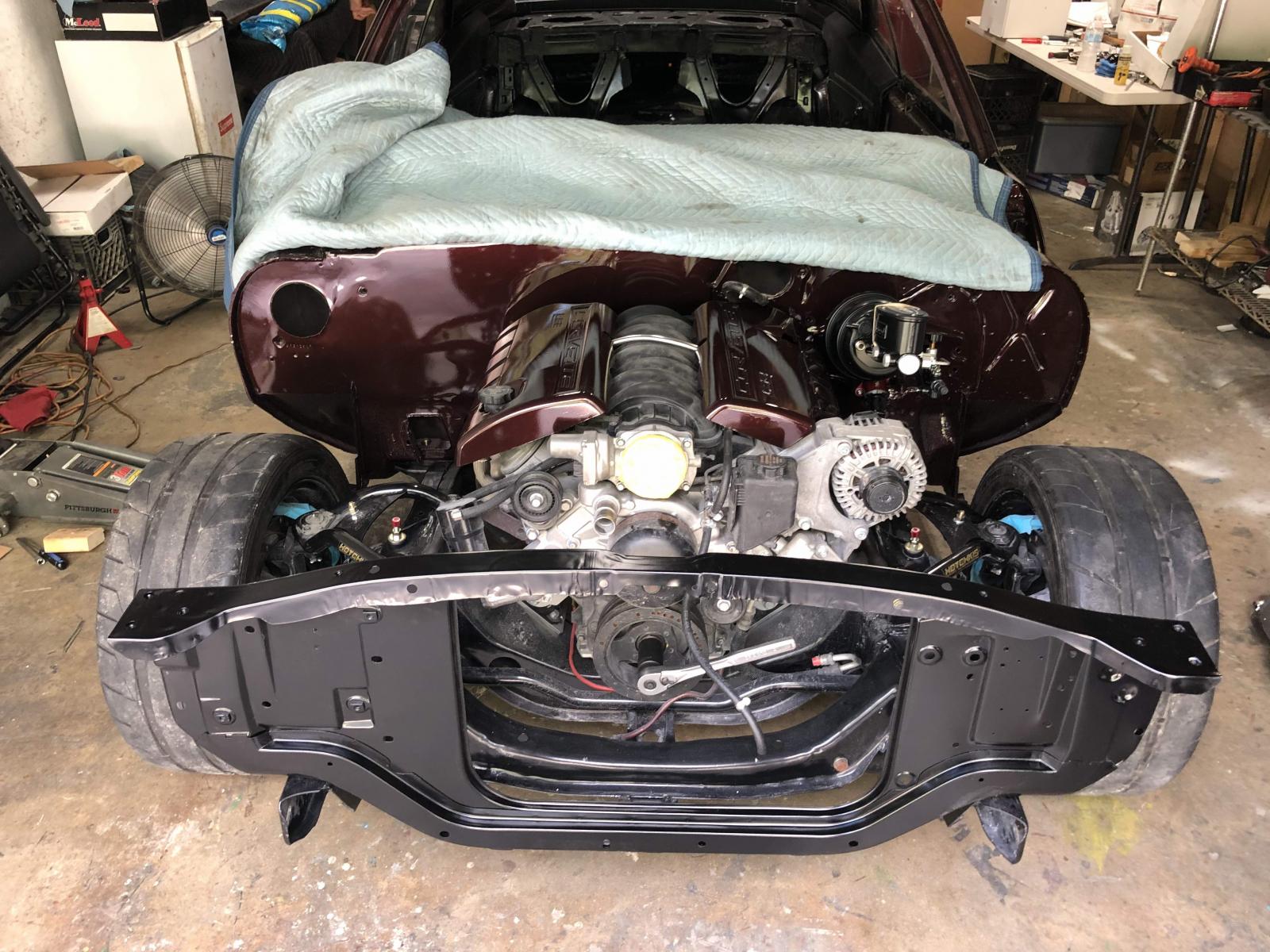

      Close to finishing Paint
      It's been a journey, Thanks to Team V Auto things are starting to take shape. Next is undercarriage and firewall, then reassemble and I can start wrenching on it again.

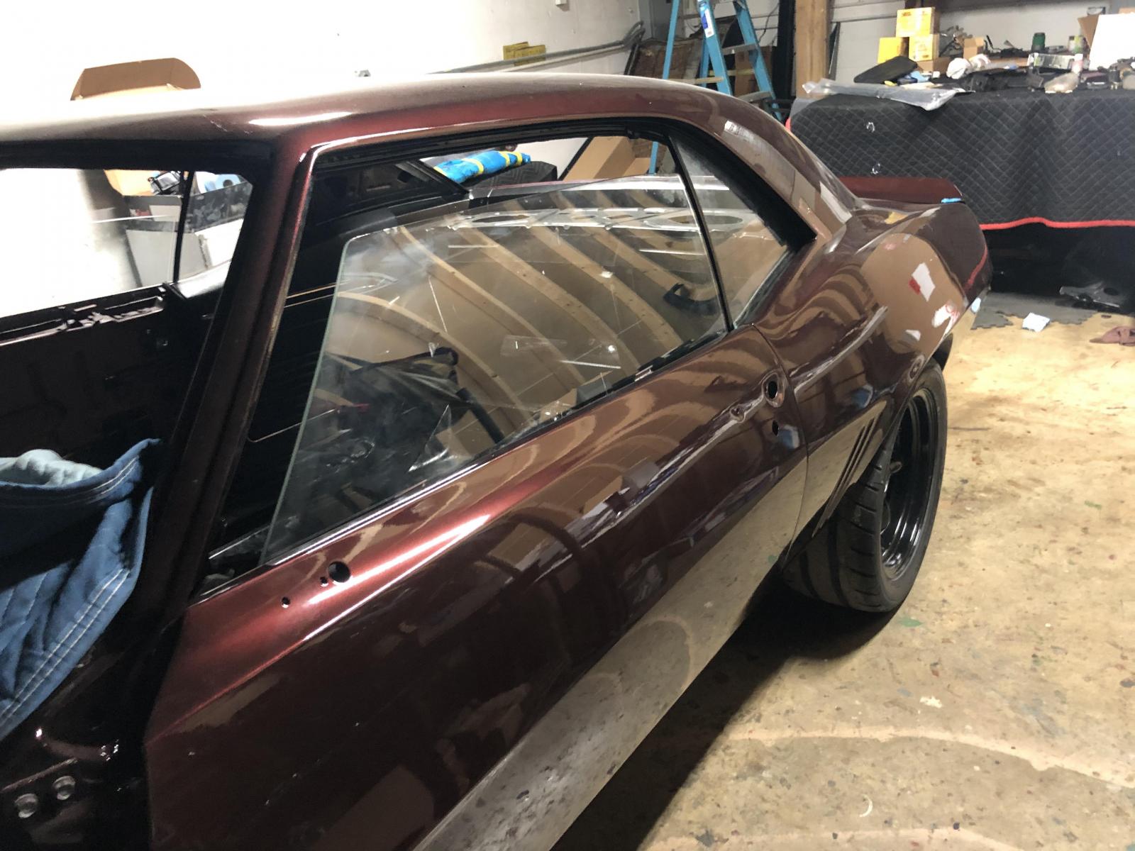

      Finally got it back

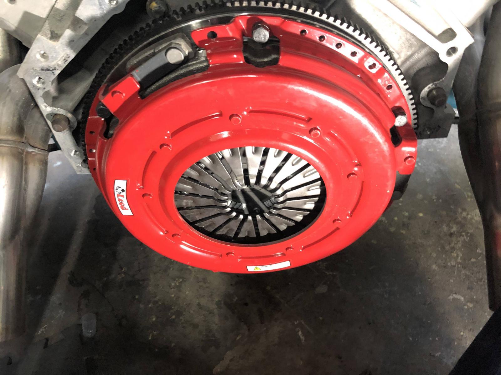

      Got 2/3rds of my car back, LOL. Put in the flywheel, clutch and TO bearing. Spoiler and taillights on as well as glass. Hood and fenders then a wet sanding. Little by little.

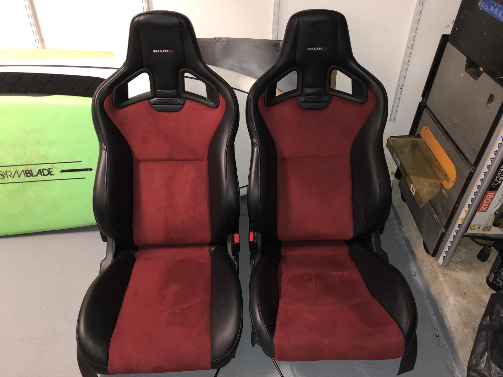

      Those Nismo seats are really slick!
    19. #39
      Miami
      77
      Quote Originally Posted by ICrombie View Post

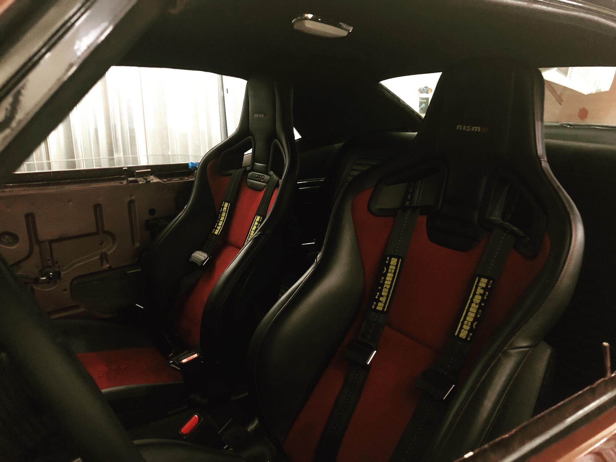

      Thanks guys appreciate the feedback. Scored the seats from a salvage yard. Really wanted recaro’s but didn’t want to wait so long then these showed up. Surprisingly the red was a lot closer to dark red/burgundy which I dig.

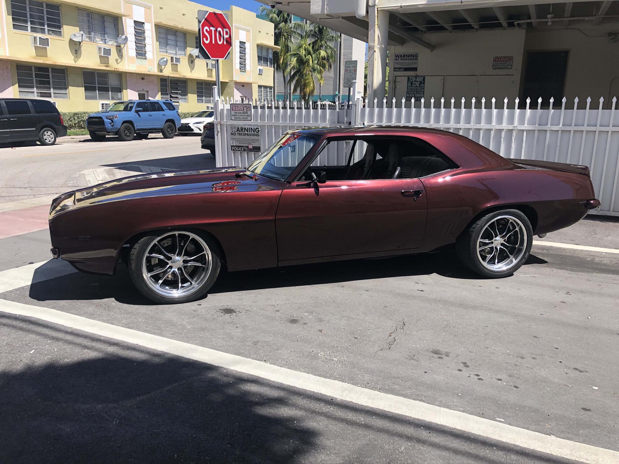

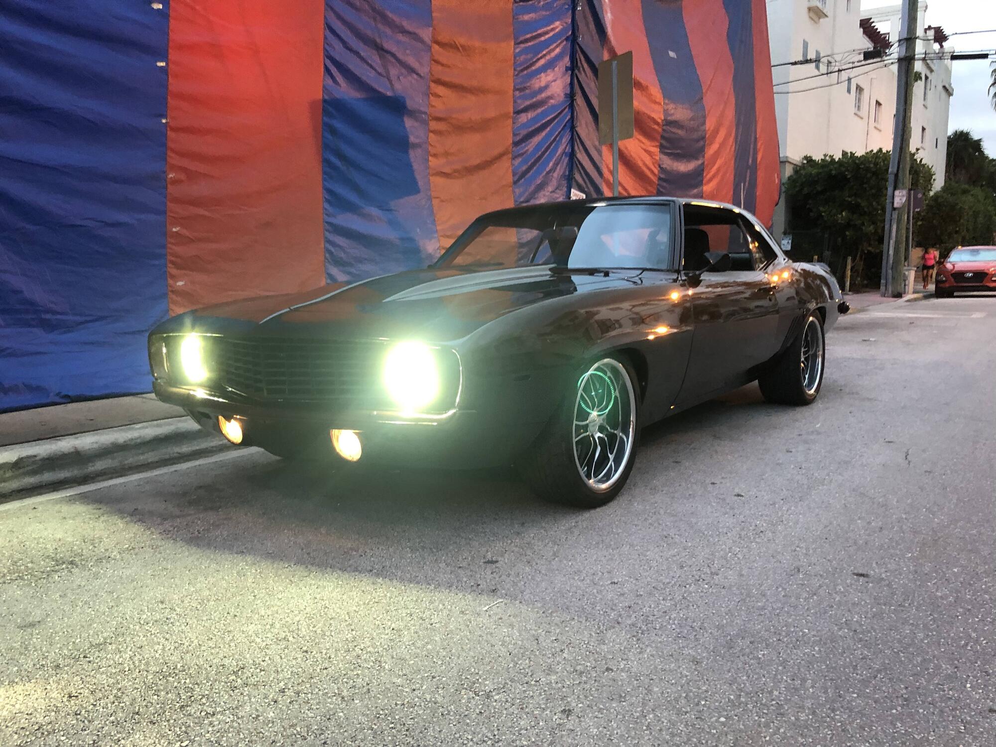

    20. #40
      Miami
      77

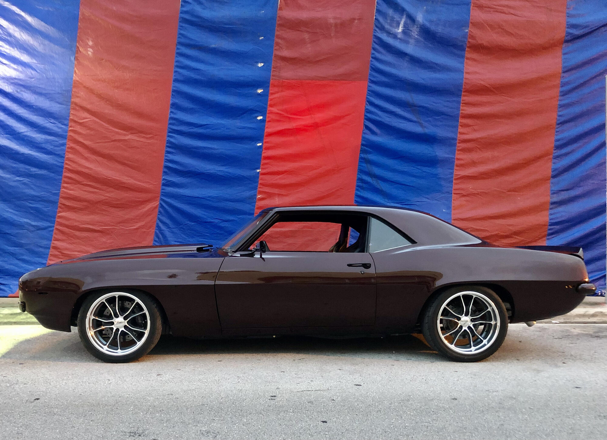

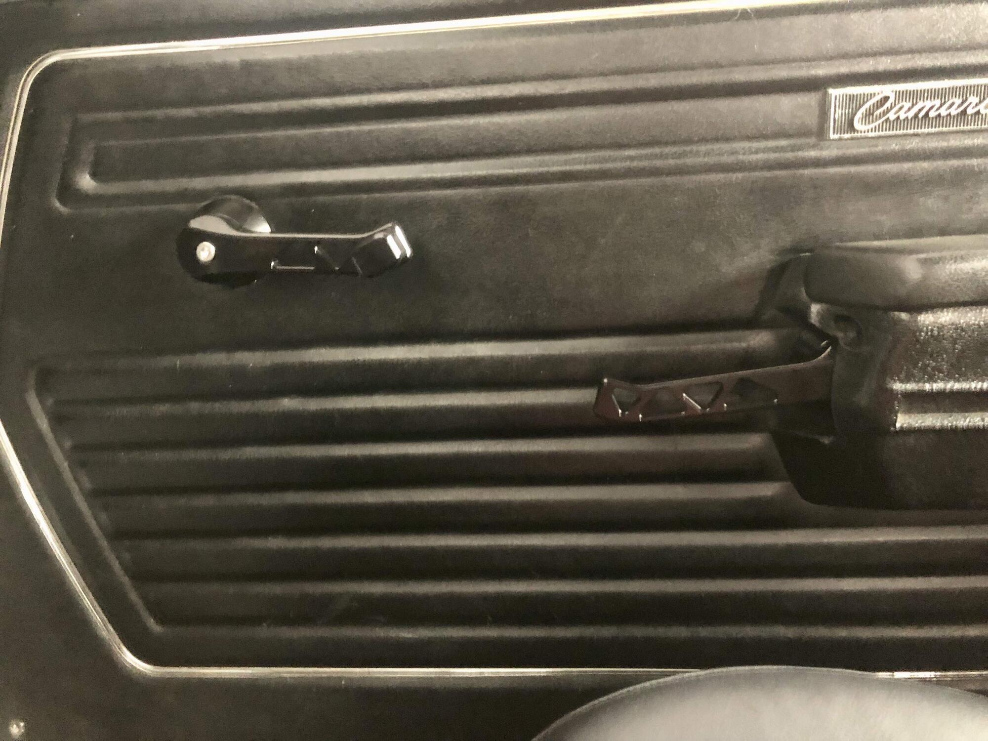

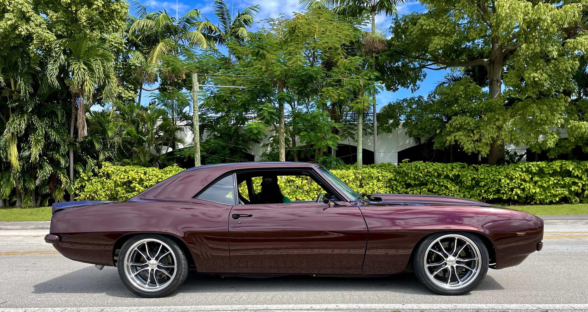

      Finishing things up and wanted to show the results of 20 months of work. Really stoked how it turned out for 2 guys with some hand tools and a compressor. Will post more pics of engine compartment and interior that are not on my computer. Really happy with the suspension and drivetrain performance. Car is a ton of fun to drive. Took a little bit longer due to it needing to be repainted by I'm glad to have had the experience to build it myself with a buddy. Learned a lot along the way.
