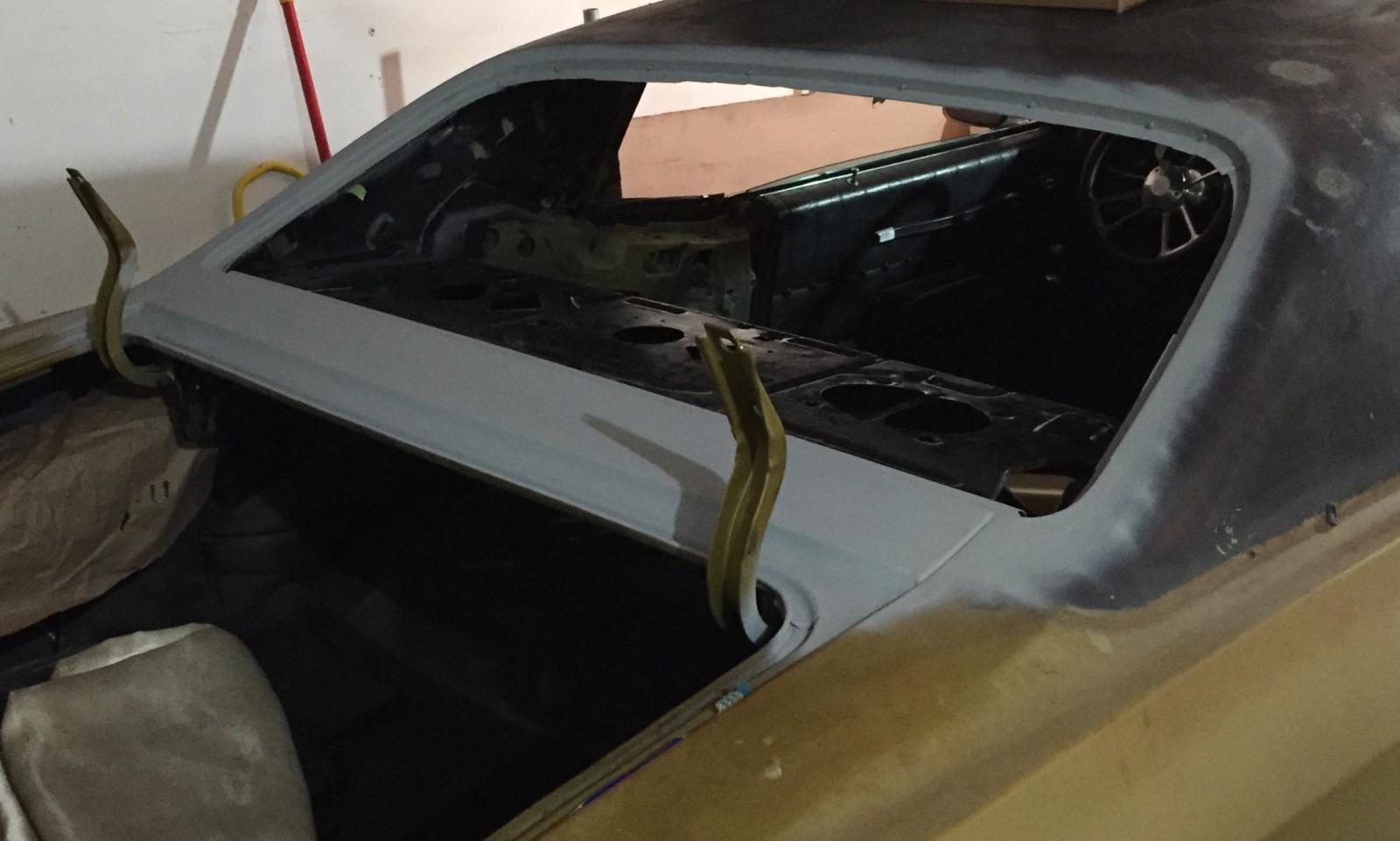

      Some more surgery around the back window. Picked up a replacement trunk fill panel. It fit pretty well except one of the sides seemed to have a slightly different angle on the drop down tabs than the existing quarter panel. The location of the channel and the overall shape was dead on though

      3d Tetris coming together. This was one of the major rust areas of the car. Once this is done, the decision will be to move onto mechanical or patch up the roof. I started using 0.023” wire but that was not conveying enough heat to get good penetration for plug welds so I switched to 0.030” wire which is working much better after I spent a little time on the welding table getting my amateur technique dialed in. I am using MIG process with C25/Ar75 shielding gas.

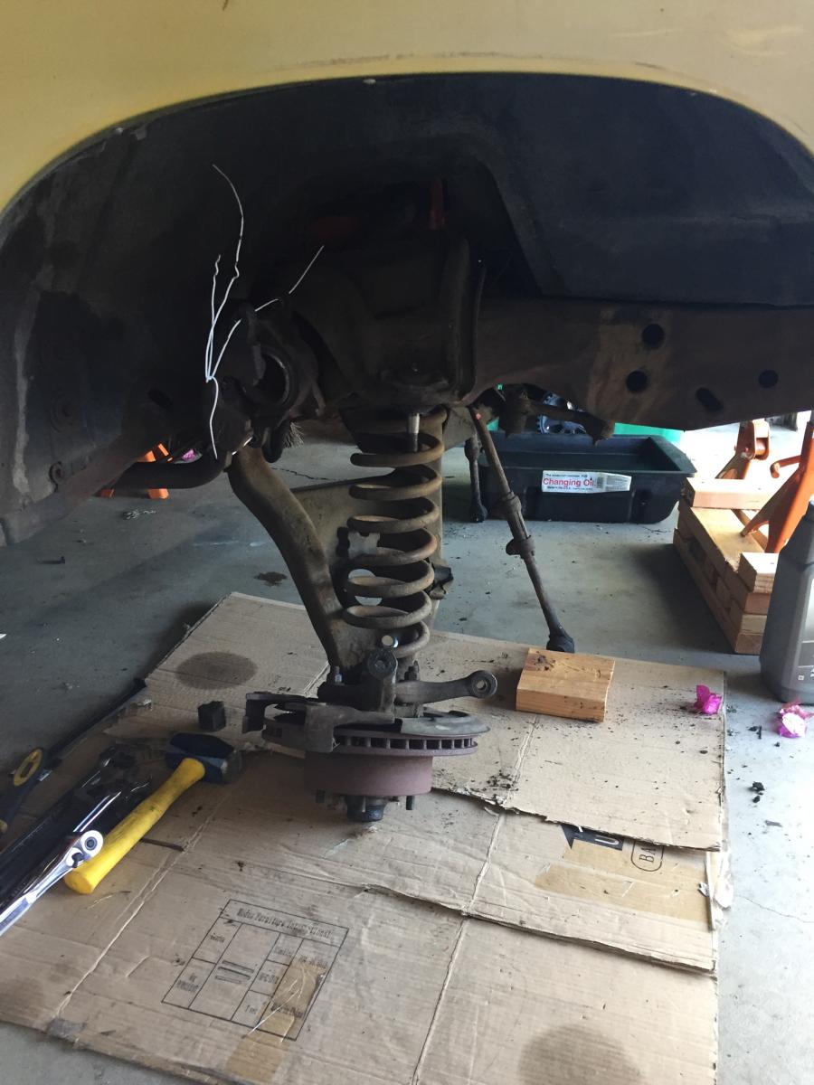

      Up next is the front suspension. After much research and considering my budget and use case, I decided to go with UMI Stage 4. I like the Viking front shocks and the swivel (roto) rear control arms. I am also replacing all the steering linkages and the steering box. This car is a survivor meaning that there are dust boots and bushings on here that were manufactured when Orange County’s very own Richard M Nixon was in the White House. And like tricky dick, I am also “not a quitter” when it comes to wrenching into parts unknown. Approaching this with a 1/2” ingersoll-rand impact and can of Kroil penetrating lube.
      The suspension came apart fairly easily. The front spring are OEM and were fatigued enough that after splitting the ball joints and swinging down the lower control arm, the springs just fell out. Almost didn’t need the floor jack to contain the potential energy in the spring after all

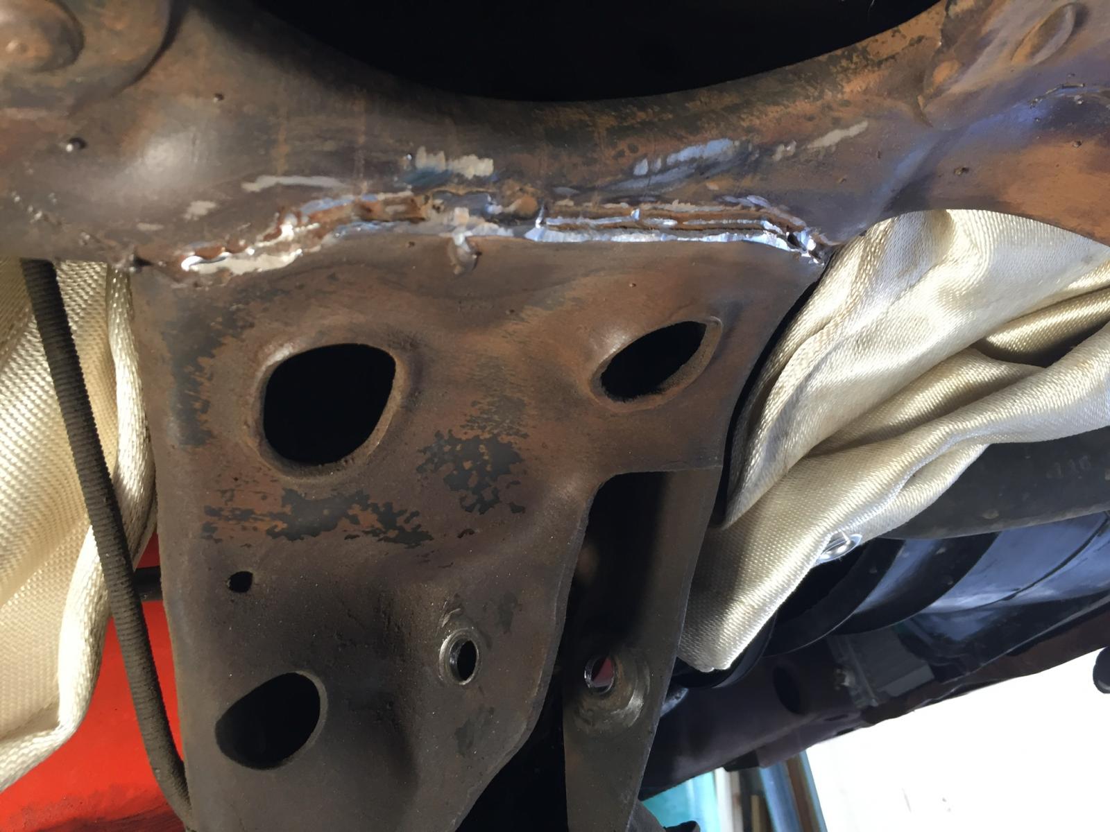

      Cleaning up the factory welds. There are areas of the frame where the old stick weld bead is not even on the seam and other areas where the pieces seem to be held together by weld spatter. It is truly shocking that these cars have survived 45+ years
      Plan here is is to reweld the key load transfer/stress points like the cross member-to-frame joint and the abutting channels near the control arm pickups

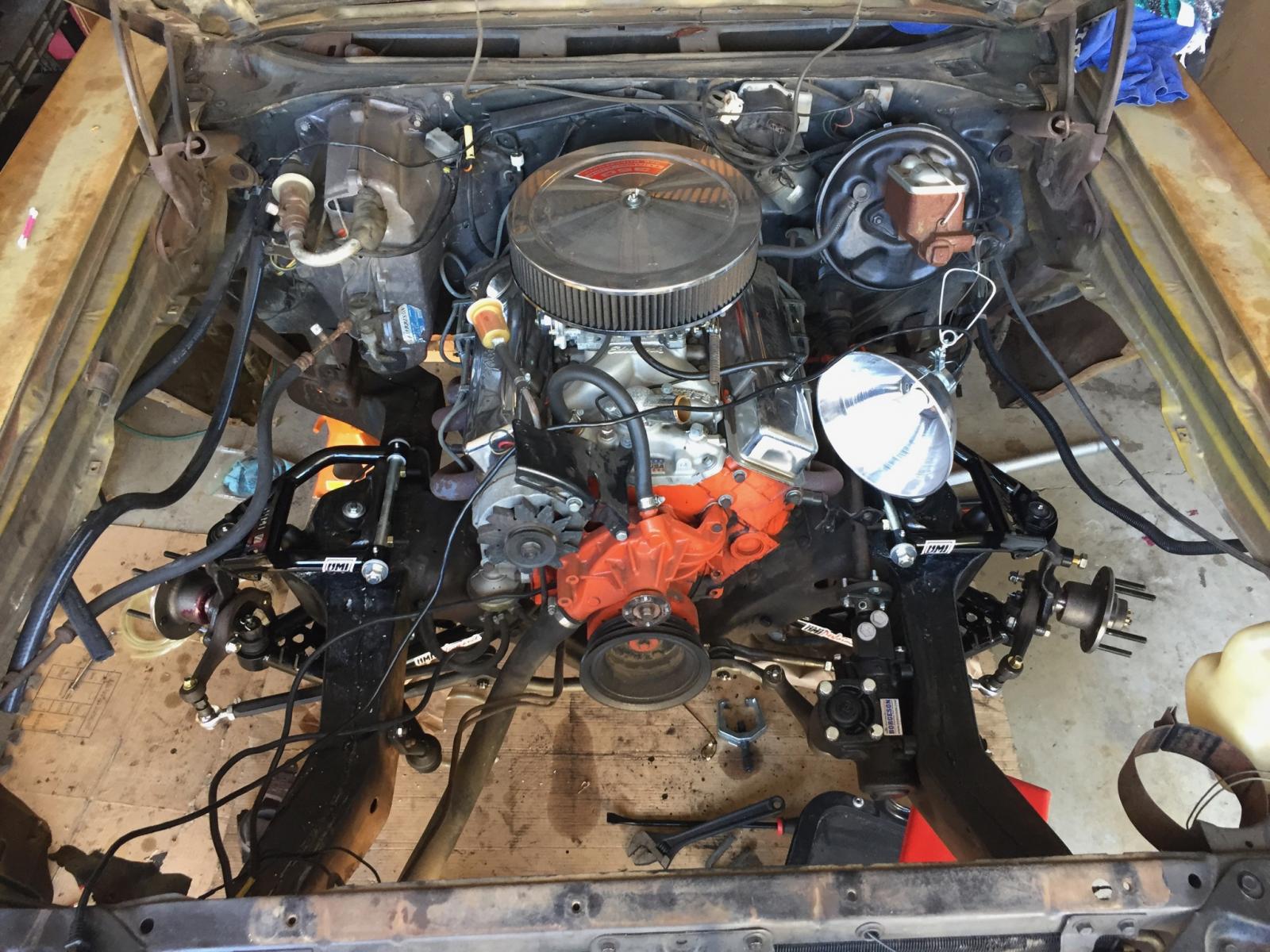

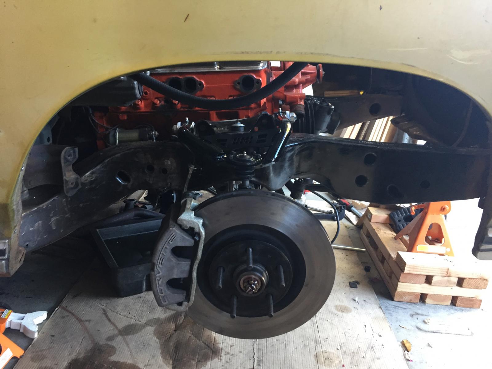

      Viking Double adjustables and UMI tubular arms mocked up

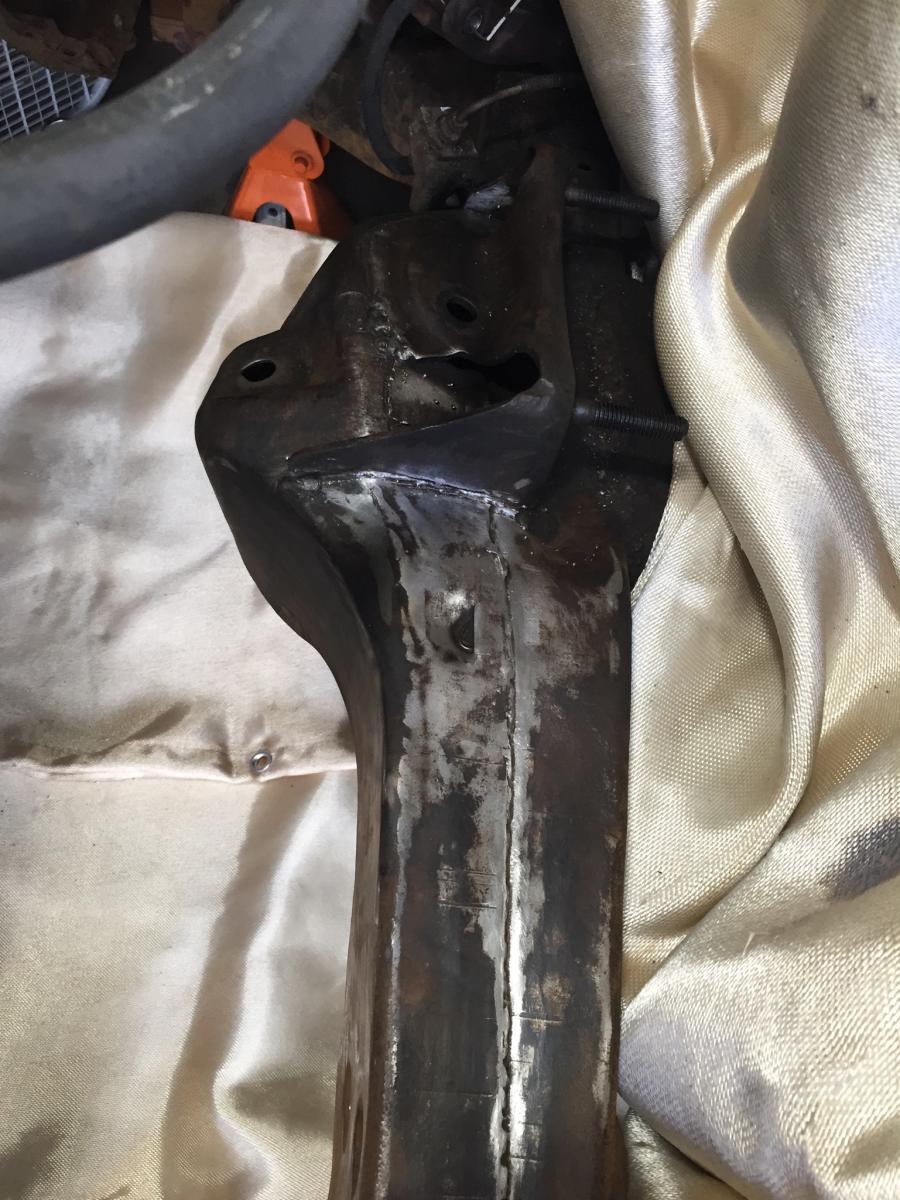

      Then came a ton of additional grinding and re-welding of the frame: 1) seams on the front frame horns (the OEM weld beads weren't even on the seam in places), 2) the engine crossmember connection to the longitudinal frame rails 3) seam around the rear lower control arm ears and the frame
      Then front suspension mocked up
      And here is the top view with fender liners out. 12.7:1 boregeson steering box and UMI bump steer tie rods. Next will come a new center steering link and idler arm drag link. The gear looked original and there was a decent amount of play in the idler arm joint and the inner air rod links. I will reuse the original Pittman arm as I can't really see how that thing would even need to be replaced based on its design.
      I can thank all this quarantining for the push of activity on the car!
      Some bugger-ey welds on the frame below. looks like I need a little less wire speed and maybe a but slower travel speed. I am certainly no pro but I am having fun!

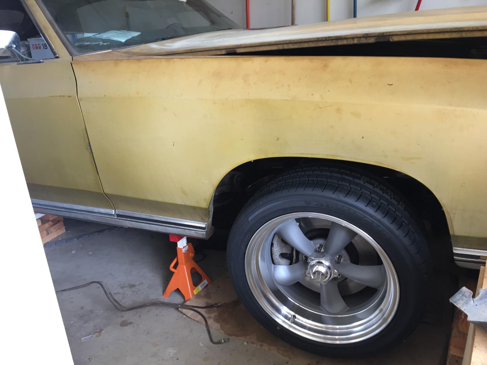

      Since stock wheels or even 17" stock "reimagined" wheels are not going to work with the caliper diameter of the C6 z51 brakes, i needed to go to 18" for wheels. rather than getting out the micrometer and trying to nail stance and fitment with all the new parts coming together (aftermarket suspension, brake hubs, calipers), i decided to keep it simple for now with the expectation that once i get alignment, ride height, and some real-life miles, I can think about custom offsets etc.
      ended up going with TT2s in 18x9 up front with 265/40/18s. I will go with 18x10 with 295/40s in the rear. to lear the depth of the c6 calipers, i had to run 3/8" spacers upfront (not ideal but will work for now). I havent dialed in the camber but it looks like it will be pretty tight against the outer lip with upon compression to the bump stops.
