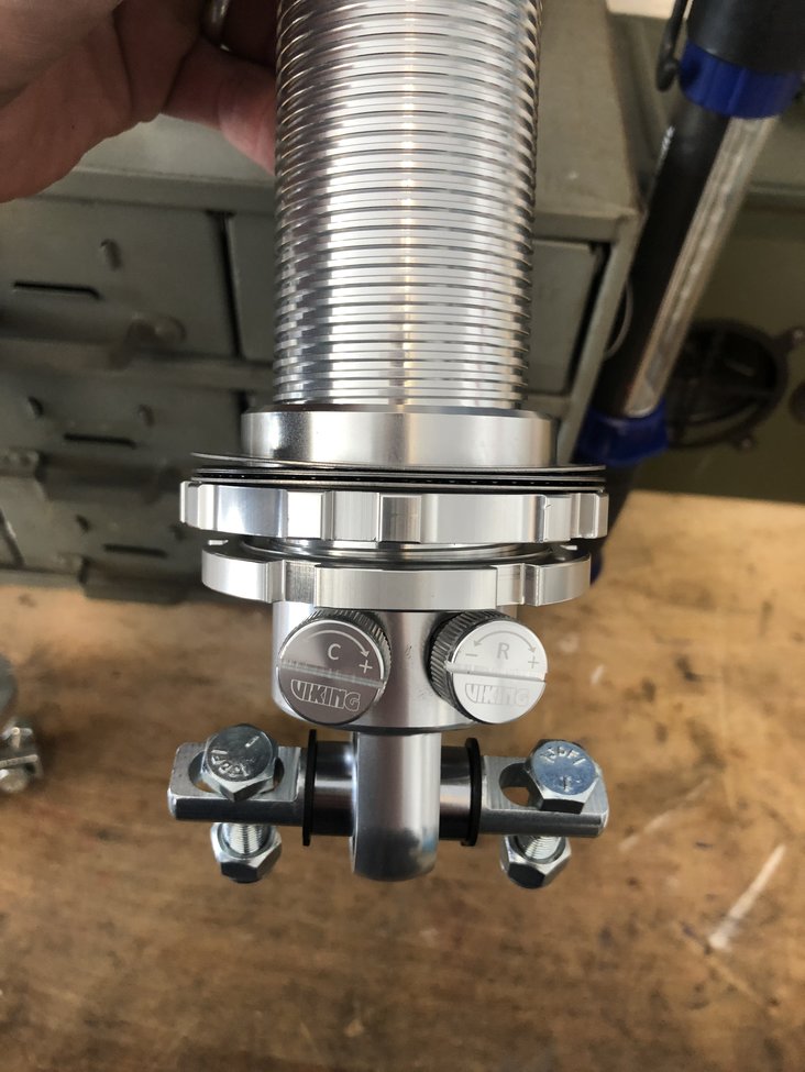

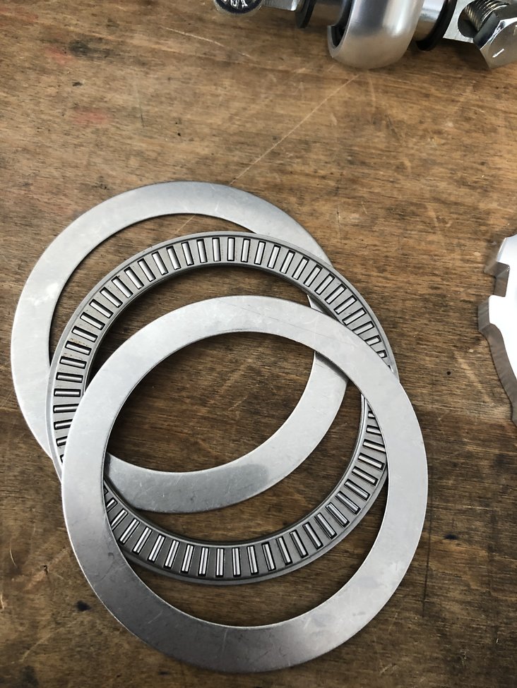

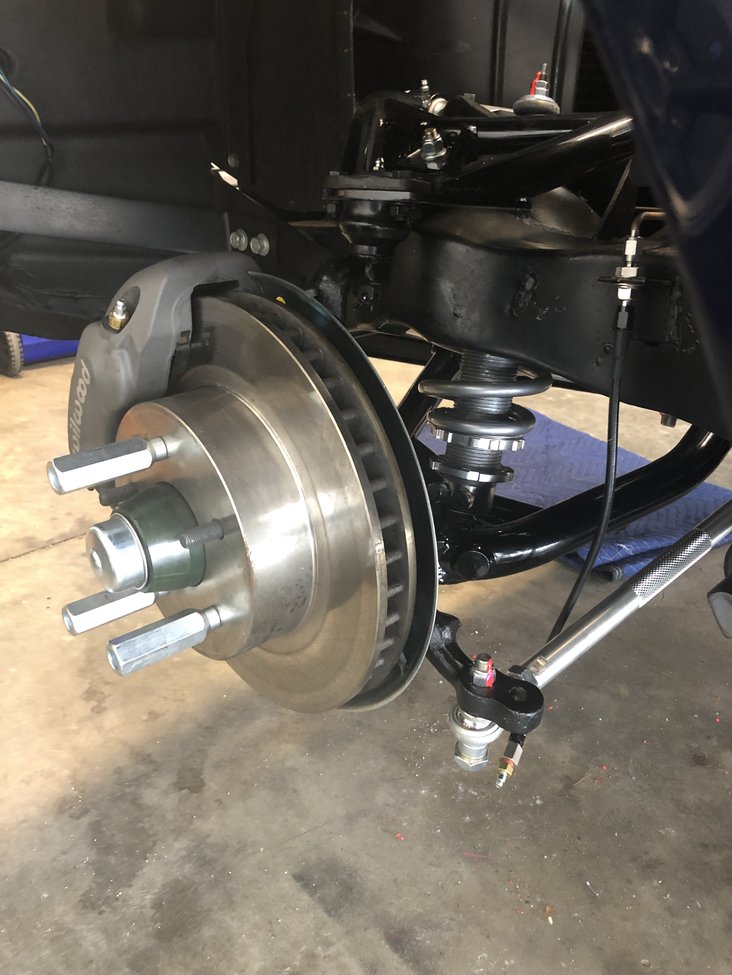

      So a little back story....when I was initially deciding what I wanted to do to the suspension while I was doing the disc brake retrofit, I leaned heavily on Herb Adams' article about how to make the C2/C3 chasis handle like the then new C4, and the Corvette Handling book. Both sources recommend trimming 1/2 coil off the front springs to lower the ride height slightly, and increase the spring rate slightly, app. 10%. Factory small block springs at 280 lb while the Corvette Handling book recommends 300-350 lb springs. I never trimmed my springs when I put my suspension back together, but after putting 500 break in miles on the car, I wished I had. The performance and handling are exactly what I was looking for, but the ride height is too high in the front (personal opinion) and the factory small block springs are a nightmare to deal with if you have to do any sort of maintenance requiring their removal.
      Ride height adjustability and ease of installation led me to start looking at some of the hybrid coil over kits. The hybrid set up is nice because it doesn't require any modification to the frame...the spring and shock mount in the factory locations. The key is that the bottom of the spring rests on a perch, threaded onto the shock body. This allows precise adjustment of the ride height. I ended up going with the set up from Viking. They have been around a few years and are well known in the C5/C6 and Pro Touring communities. I like the fact that they are made in the US, and if you call to ask questions, the tech guy may very likely be the owner of the company. The other selling point for me was that they offered a 350 lb spring....the lightest you can get from QA1 is 450 (which coincidentally is what Viking recommends for big block cars). Additionally, there is a roller bearing collar that fits in between the spring and the spring perch, thus making ride height adjustments a relatively easy affair. Viking only offers double adjustable shocks, which is overkill for my street car, but because they only offer double adjustable shocks, they're at a similar price point as most performance single adjustable shocks. As a point of reference, the Ride Tech shocks I had on the car were $785. The Viking front semi-coilovers with double adjustable shocks front and rear were $960...made in the USA out of billet aluminum. I was quite pleased with the quality of the set up, and the directions include a very comprehensive guide to getting the double adjustable shocks dialed in....I'm always leary of unnecessary adjustability, but the guide is a very good starting point.

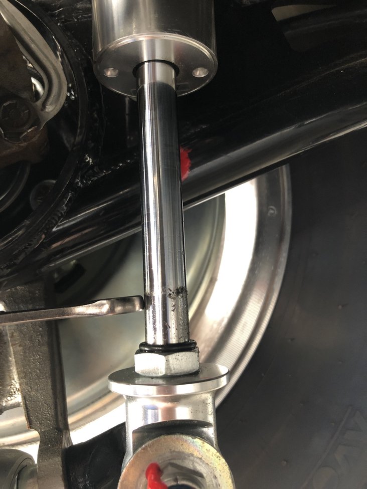

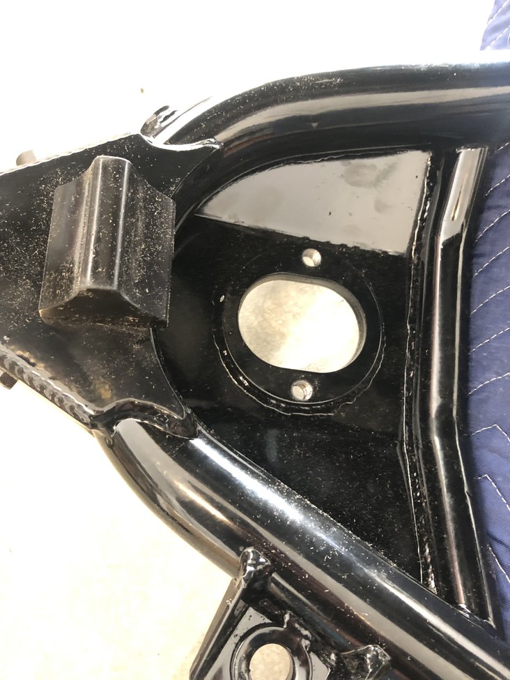

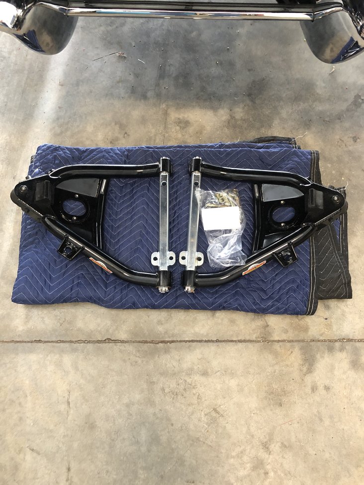

      The switch to the semi-coilover did necessitate a change in lower control arms. Global West sells a lower control arm, similar to their factory replacement arms I had on the car, that has a reinforced mounting pad specifically designed to handle the load of a coil over. The minimum recommended thickness for mounting the coil over is 3/16 and the mounting surface on the Global West arms is 5/8.
      It took about 4 hours of total work from the time the car was on the ground, until everything was buttoned up and bolts torqued and striped. (yes the lock collar is backed off in this photo as I anticipate having to make some adjustments to the ride height after I see the car on the ground for the first time.)

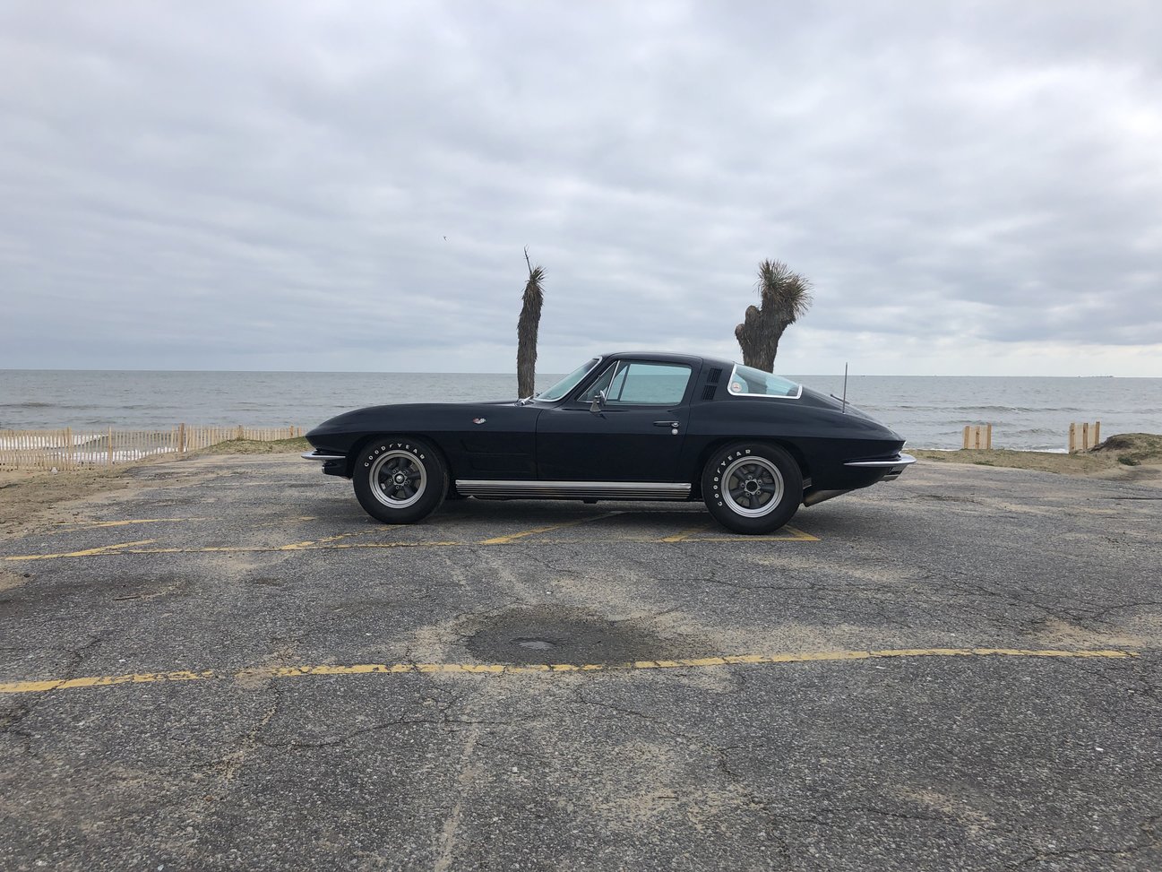

      I finally got a break in the weather this morning, so I decided to take the car out for a test drive....actively looking for the bumpiest roads in Norfolk, and to get a few side shots to judge the ride height from a distance.
      The ride quality is perfect....pretty much the same as the set up with the factory front springs and the Ride Tech shocks, so I'm very happy with those results. I gained the adjustability in ride height, while maintaining the ride and handling quality I already had. As far as the ride height at the moment, I'm inclined to leave it where it is.....at least for the time being. I have the factory castle nuts in the rear backed down as far as I can get them, while still getting a small cotter pin through the hole in the bolt. I did order a set of 7" bolts and nylock nuts from McMaster Carr in the event that i want to go slightly lower. The front still has plenty of adjustment in the coil overs, but I think the current setting did a good job of taking the gap out of the fender and bringing the nose down to level with the rear. Eventually, I may go down an additional half inch in the front and rear, but nothing more aggressive than that. For now, I plan on just driving it, and I'll reevaluate in a month or two.

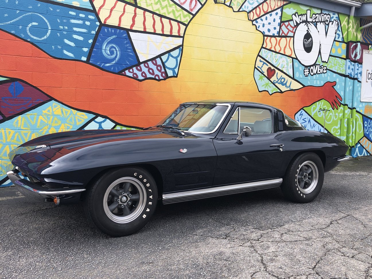

      1972 C20 Suburban
      1964 Corvette Coupe
      Aug 2002
      Waleska Ga.
      2,722
      That's a cool picture
      I wonder how old that establishment / building is ?
      David Sloan
      16,129
      Very cool Corvette! I think the ride height is perfect. I would not go any lower.
      If I can be of service with any Holley related tuning or wiring, please let me know.
      Jan 2014
      Austin, TX
      667
      Andrew, agreed completely....as you can see, it settled a bit in that last picture compared to those from March. The ride height is exactly where I wanted it. I will definitely give you a shout when/if I get to the fuel injection. Right now, Ive got the motor running so well with the rebuilt carb, I'm tempted not to mess with it. I've got a dyno tune scheduled for the 28th of the month with a wide-band O2, so I'm hoping Abacus Racing will be able to dial in the carb and timing well beyond my rudimentary skills.
      1972 C20 Suburban
      1964 Corvette Coupe
      Oct 2007
      Camas, WA
      640
      That is a great picture and stance. Good luck on the 28th. Always a fun day when the car is on the dyno.
