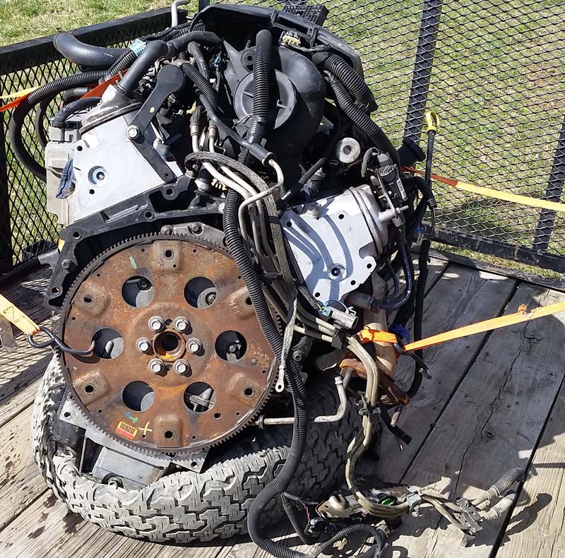

      I've got a L92 with "stock" LS flex plate sitting on my engine stand. From the back edge of the flex plate to the cylinder head casting is 1". Not the bell housing machined edge the cylinder head casting that has 6.2 cast into it.
      The flex plate has a "dish" to it pushing the ring gear away from the block. Could it be possible they installed the flex plate backwards?
      I've done a number of LS swaps with different flex plates/flywheels and never had to skim one for clearance.
      Not an LS expert but I hope this helps.

      I found this picture of when I picked up the engine. I looks like it is facing the correct direction.

      Quote Originally Posted by rchaskin View Post
      This does help, Thank You! I may potentially have the short crank and need the spacer. So far, this makes the most sense. I'll look into it.
      742
      That was my first thought that you had an early 6.0 but it looked like you had aluminum heads and I thought they had iron heads. If you need a spacer let me know I think a have one. No charge. Just a few a bucks for shipping.
      15
      Quote Originally Posted by 79 Camaro View Post
      Sounds like a plan. I will let you know. Thanks!
