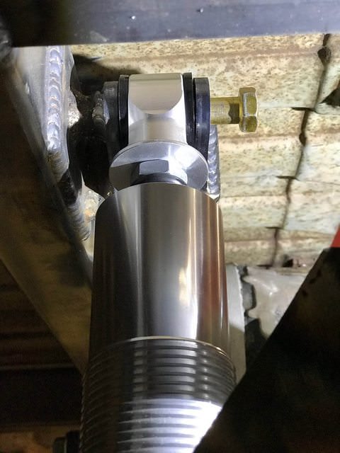

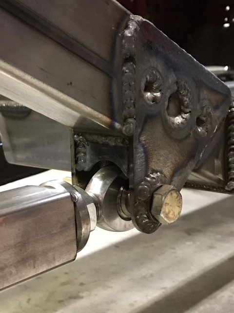

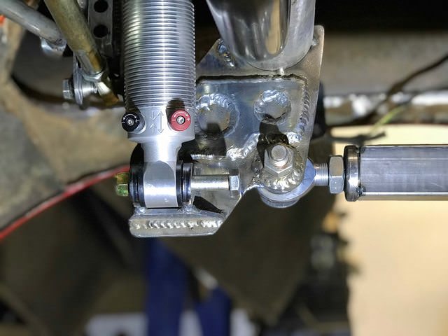

      As a very good friend told me “I am my toughest critic” after going to SEMA and looking at some amazing Cars and trucks I felt like it was time to cut off the back end of my car and start over. But that same wise friend and others talked me off the ledge, again. I have made some updates and changes to the rear set up. I cycled it and it seems to work well. So, time to start welding it up and putting the rear suspension to bed.
      The watts link brackets and support brace are welded in.
      It's hard to see in the picture, but I sleeved the cross member and welded that sleeve to the inside shock tab. I have a long 5” bolt that should make it strong.
      The bottom mounts are incorporated into the into the lower link brackets and I was again mindful of things moving under load. I hand-cut that overlay plate to add some stiffness. I also added small gussets on the bottom of the shock tabs to handle any side loads.
      I welded this sitting under the car and I couldn't get comfortable. I find that I am very critical about the level of work I do. I follow plenty of builders and welders. I know they are professionals and weld and build for a living. I also am a quality inspector for Turbine Driven Generators and Compressors. So I'm very hard on myself when I know I can do better.

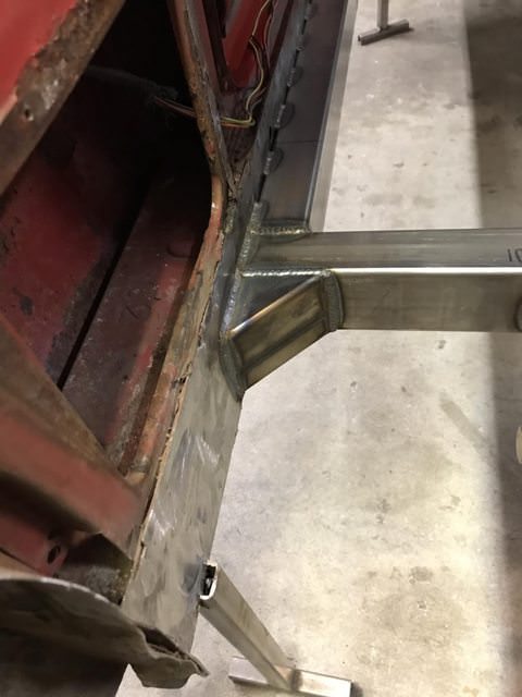

      I got the nerve up to weld the front mounts for the lower rear links. I felt like I wanted to add some extra weld area and some style, so I spent the morning becoming friendly with the drill press and hole saw. Found my press has a wobble in it. Does anyone repair 1950’s-era Craftsman drill presses?
      While I was there, I cleaned up some of the factory welds for the rear suspension mounts. Ford really knows how to make some spot welds. I couldn't cut, drill or Sawzall them. I had to use three 40-grit flapper wheels for my grinder. After that was done, I added some corner gussets for a little strength but also to finish off the frame.
      Next on the list is to make some bump stop brackets and install them on the frame and axle. Then I can pull the axle and weld everything up. After that, I can move on to mounting my Agana Metal Products Fuel Cell.
