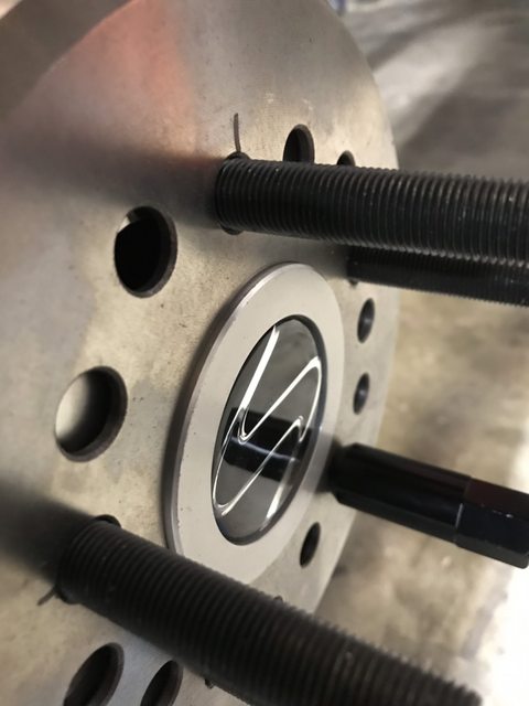

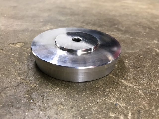

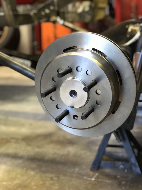

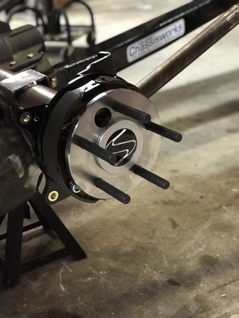

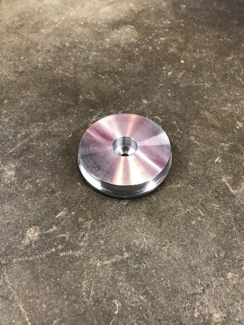

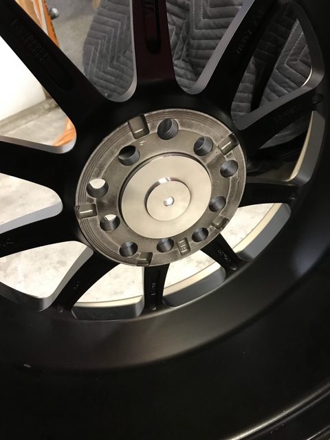

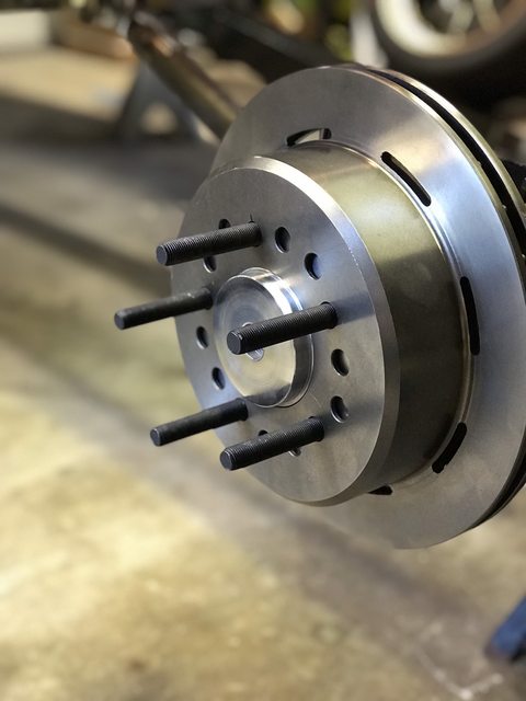

      When I ordered my axles and brakes there was a slight math issue from my guy and the axle builder (no big deal). The register (the part that centers the rotors to the axle) was too big and wouldn't let the wheels sit flush on the rotor.
      This created a problem with a great opportunity. My wheels are hub centric and the center bore is 73.1mm. Spending my life in the aftermarket industry, I knew that can cause issues if not centered properly. So I reached out to a friend who has a machine shop in his garage and he went to town and made an amazing pair of parts for me. They center the rotors and have a lip to center the wheel as well.
      I was so excited, I went outside at 4:30 am before work and slapped them on and checked the fitment.
      I’m super impressed with the tolerances and the finish of the part, and so was my indoor drawing assistant Tailpipe. Yes, my cat’s name is Tailpipe. I found him as a small kitten after a test ride on the exhaust of a car for 5 miles.
