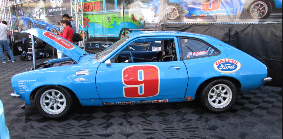

      Here is the front wheels moved forward about 8 inches.Name:  1971-Ford-Pinto-Trans-Am-side-moved.jpg

      I am doing both. I moved the front wheels forward 2 inches and the motor back 4inches. I guess I’m undecided. Both work. I would still set the engine back in the Pinto whether or not you move the front wheel. Unless you move them forward dramatically like a foot or so like this Monza.

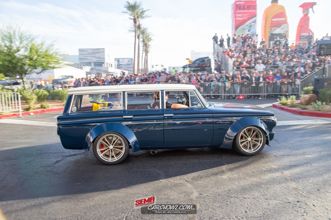

      a shorter wheel based car handles well on the autocross and longer wheel base handles the road course better, corvettes do well on both so that's the wheel base I wanted to be close to, the wheel base on the car I built for suzy was 100 inches close to a corvette so for me it was move the motor back for better weight balance, and I ended up with 49/51

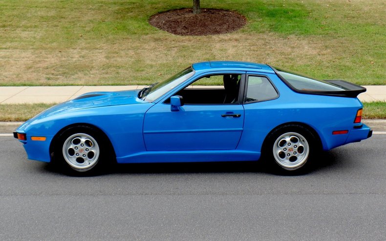

      The Pinto has a 94 inch wheelbase, the C4 corvette is 96.2 The C4 also has rear wheel steering that helps a lot in parking lot racing I would think.
      The 944 has a 94.5 wheelbase. I'd of thought the pinto was even less. sure looks like it when I look at my C4 in comparison.

      The 944 transplant idea should work great. Have you looked at http://www.renegadehybrids.com/ for adapters to mount the engine of your choice to the torque tube?
      The 944 has the differential in the front. The C5/6/7 has the differential in the rear. The 944 setup will fit much better in a Pinto where the Corvette setup might interfere with the seats.
