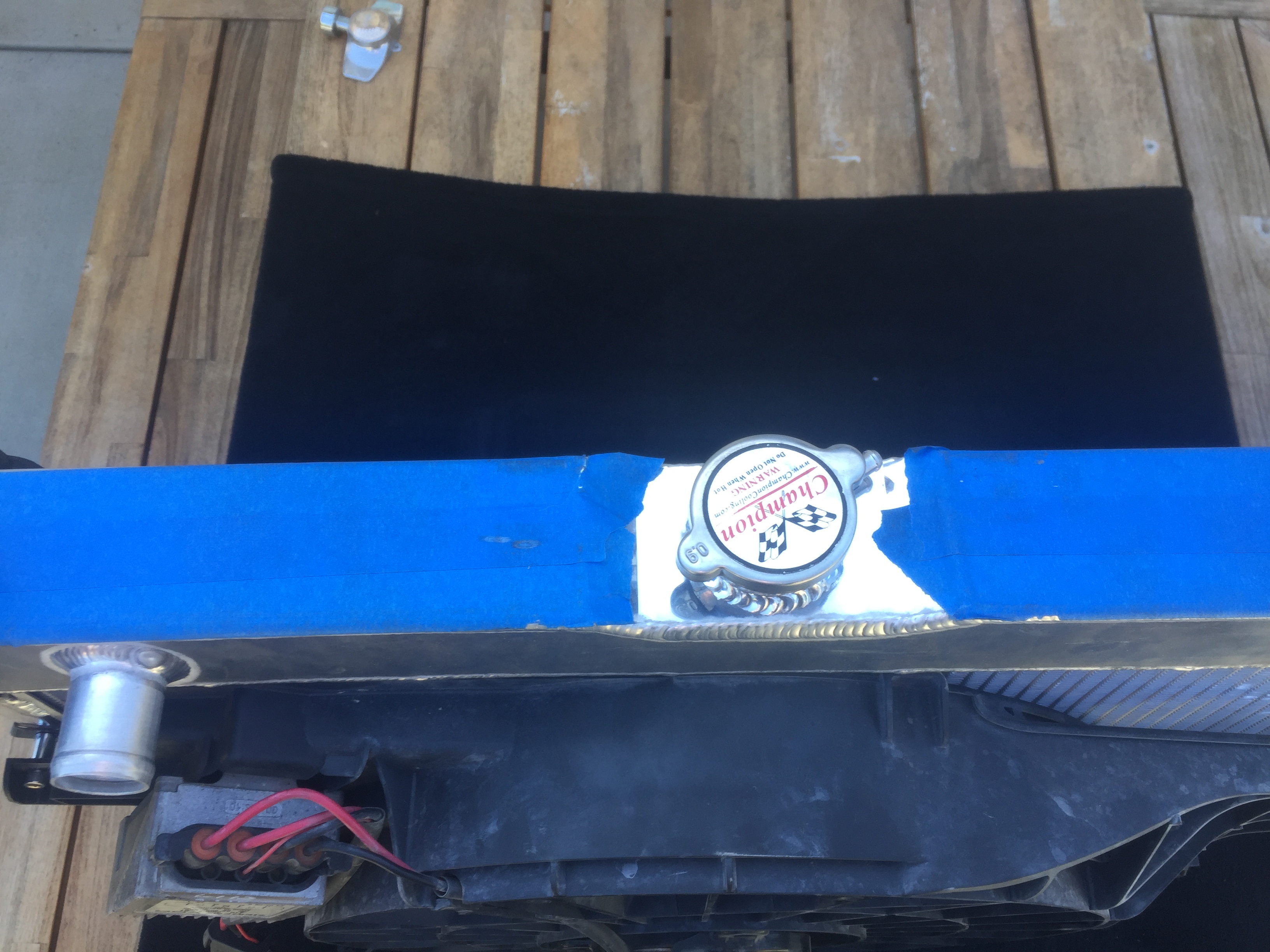

      I ordered a 3 row Champion Radiator for a big block mustang and had ls1 sized hose outlets added in the traditional Chevrolet locations. This radiator has caused a lot of frustrations. The reproduction saddle mounts for a big block mustang do not fit at all. I had to order two upper brackets and cut one up and weld in almost an inch of material to make it fit the top tank of the radiator. I also had to order two sets of bushings and cut them in half to make up for the added radiator width. The bottom saddle mounts were too wide and had too much material for the radiator to sit flush. I had to grind away material and cut the bushings down to make the radiator sit flush. I then squeezed them in a bench vice to get them to hug the radiator.
      I also took a hacksaw to my C6 corvette fan and made it fit up to the radiator. I used 1/4-20 U nuts along with stainless cap head screws and steel spacers to mount them. I had to flip the fan upside down to make it sit flush to core. It worked out great and only sticks out 4". The fan Relay looks close to the upper radiator hose in the pictures but actually has lots of clearance.

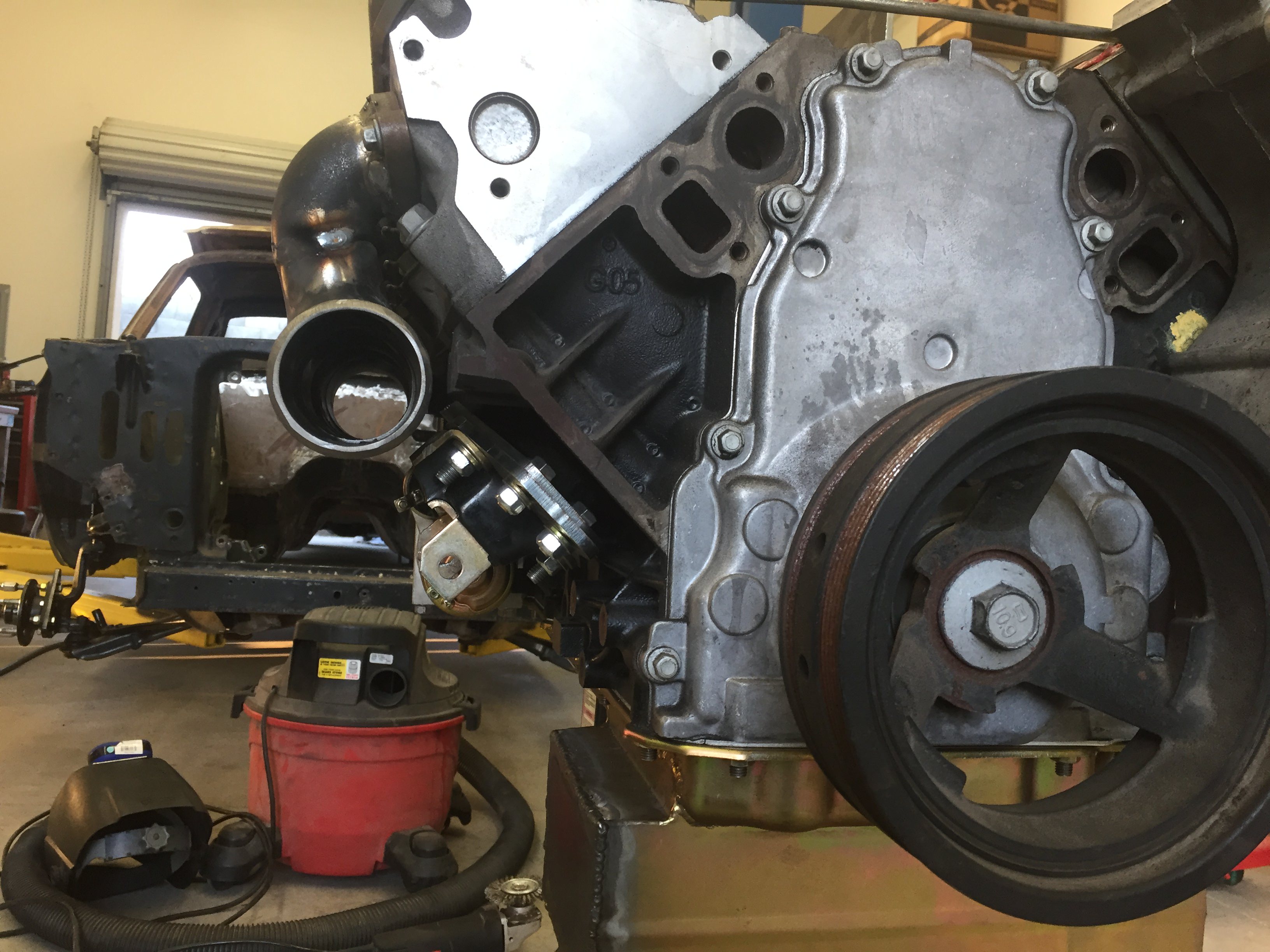

      The hooker manifold was a big flop. I took it out of the box once, held it up to my motor then packed it back up. I wasn't about to ruin my engine mounts and try to make it work.
      SO... I decided to make my own header that mimicked the hooker. I had a set of 1/2 thick 1.75" port flanges laying around so i said why the hell not! I made it out of 1.5" and 2.5" schedule 40 butt weld elbows and tees. Its not completed but you get the idea. The back of the engine will get a long radius elbow that points down and the front of the header will get two short radius elbows in a S shape that will exit to a 3" transition next to the crank pulley, similar to the hooker.
      This is as far as I got today. I welded everything with the flange fully bolted to the cylinder head. I hope it didn't warp.
      I welded the flange pipes in small sections starting with the center and working my way outward.
      as you can tell by looking at the tees I had no system to assure they were all the same length. lol. They butt welded just fine though.
      I test fitted it in the car and it fits awesome.
      Here is a shot down the center of the header.I had to cut and grind down two casting standoffs on the block to get the tees to tuck in tight. All I have to weld up now is everything that it facing the block.

      Had a few helping hands today and a slight change of plans for the turbo log. Managed to finish welding the flange and the tees. What do you think?
      The engine is cocked to the side on the engine stand. The up pipe is actually exactly 90*
      The down pipe will clear the shock tower and should easily transition from 3" to 3.5" straight out of the exhaust housing. I need to determine waste gate placement and order some 1.75" DOM tubing. Not sure if I like the T4 transition i got on ebay. Its slightly magnetic, im sure its stainless. Its a CNC 3" pipe to T4 flange. Since the schedule 40 tubing im using has such a thick wall I can just weld it to the 2.5inlet no problem.
