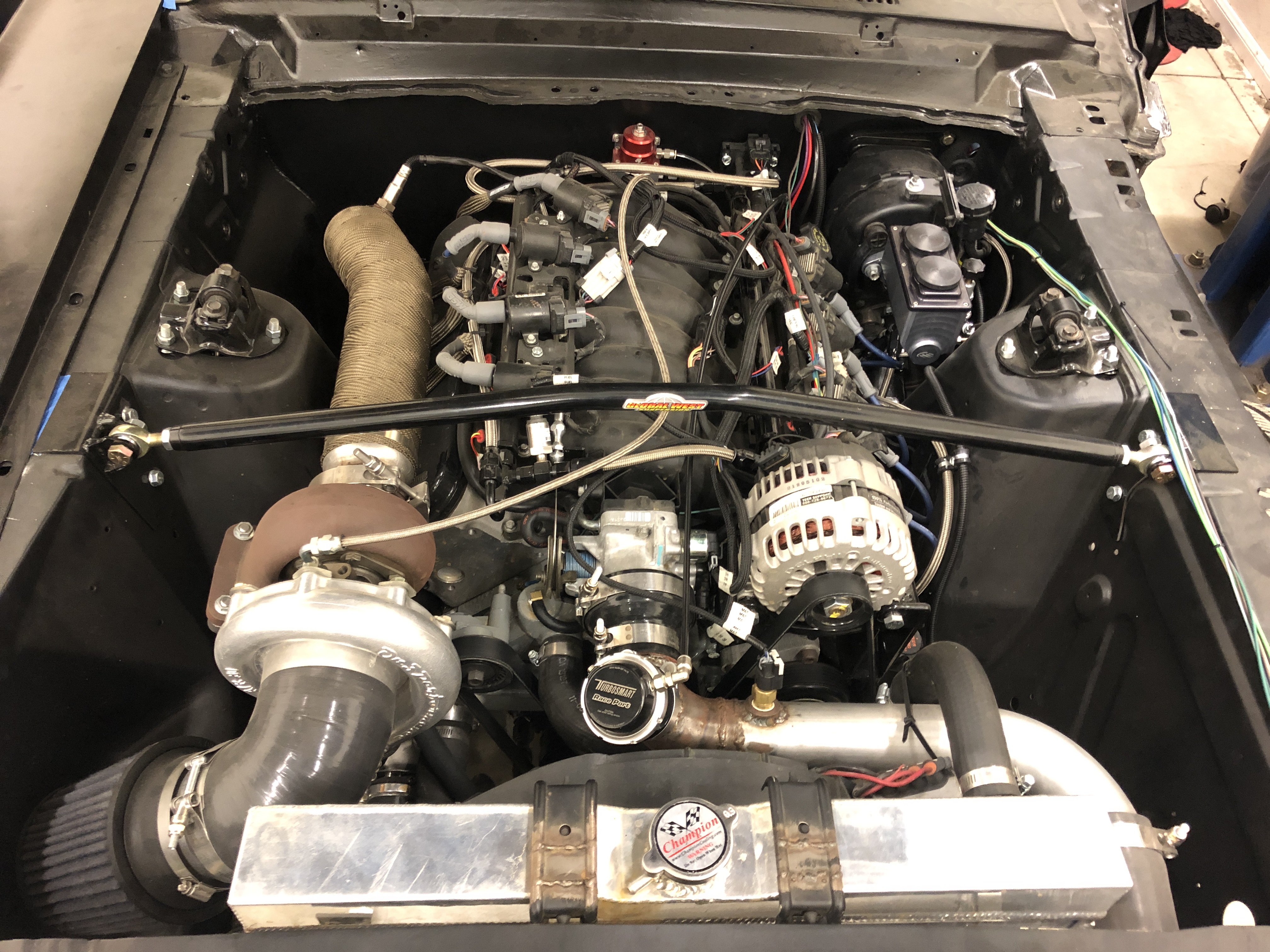

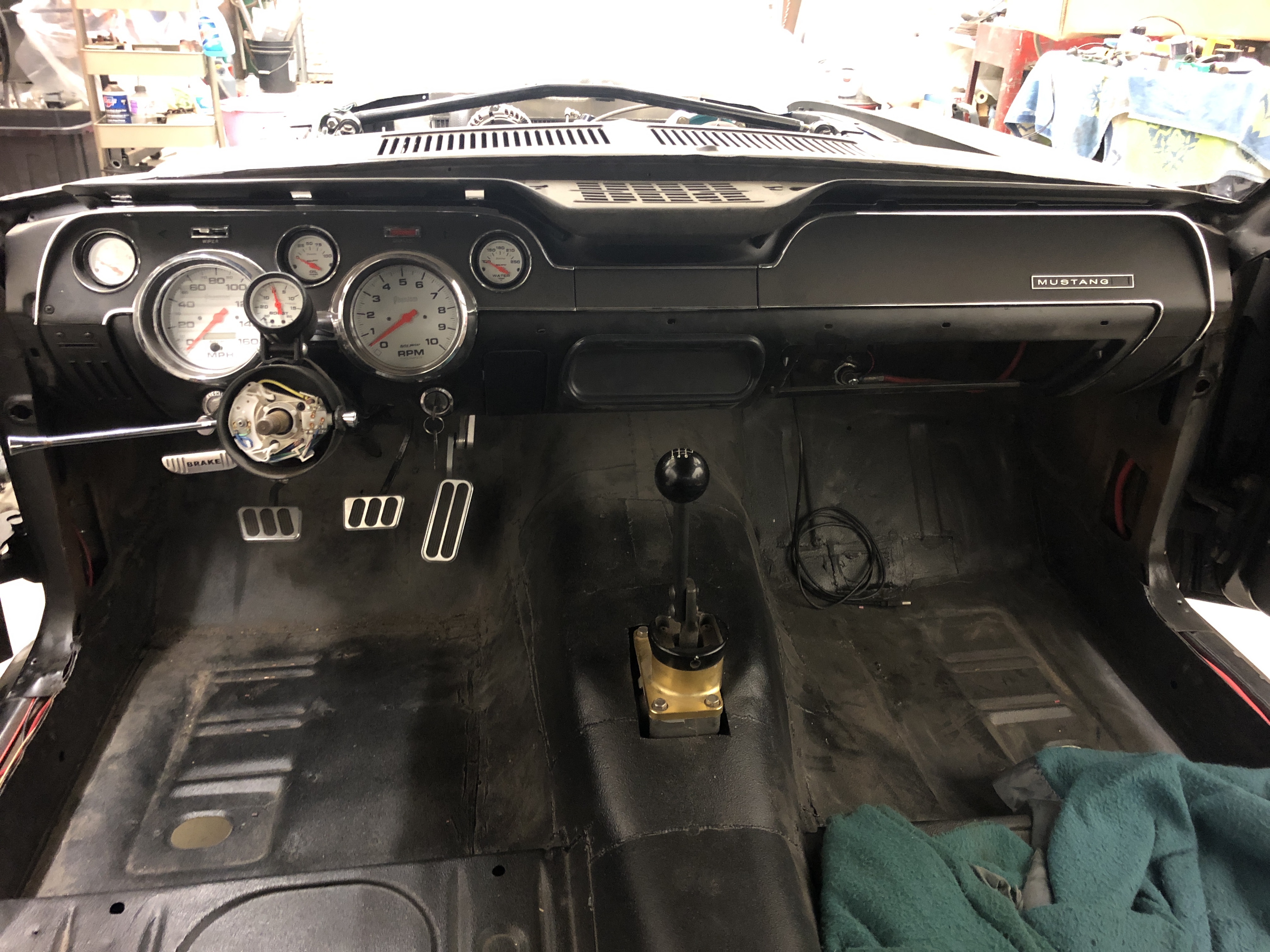

      Did some work on the car today. I managed to tidy up all the turn signal wiring, brake lights, reverse lights, fuel sender, cigarette lighter and the fan. Not much to show but here is a current picture of the engine, trunk and the dash area.
      I still need to wire the headlight and loom the rest of the wires coming out of the firewall to the starter. Other than that she is turn key! I also added a global west monte carlo bar. It fits under the turn signal hood. I also have a global west shock tower brace to add as well.
      The cord hanging down is the USB link for the Holley HP EFI. I misplaced my glove box latch. I may need to order another.

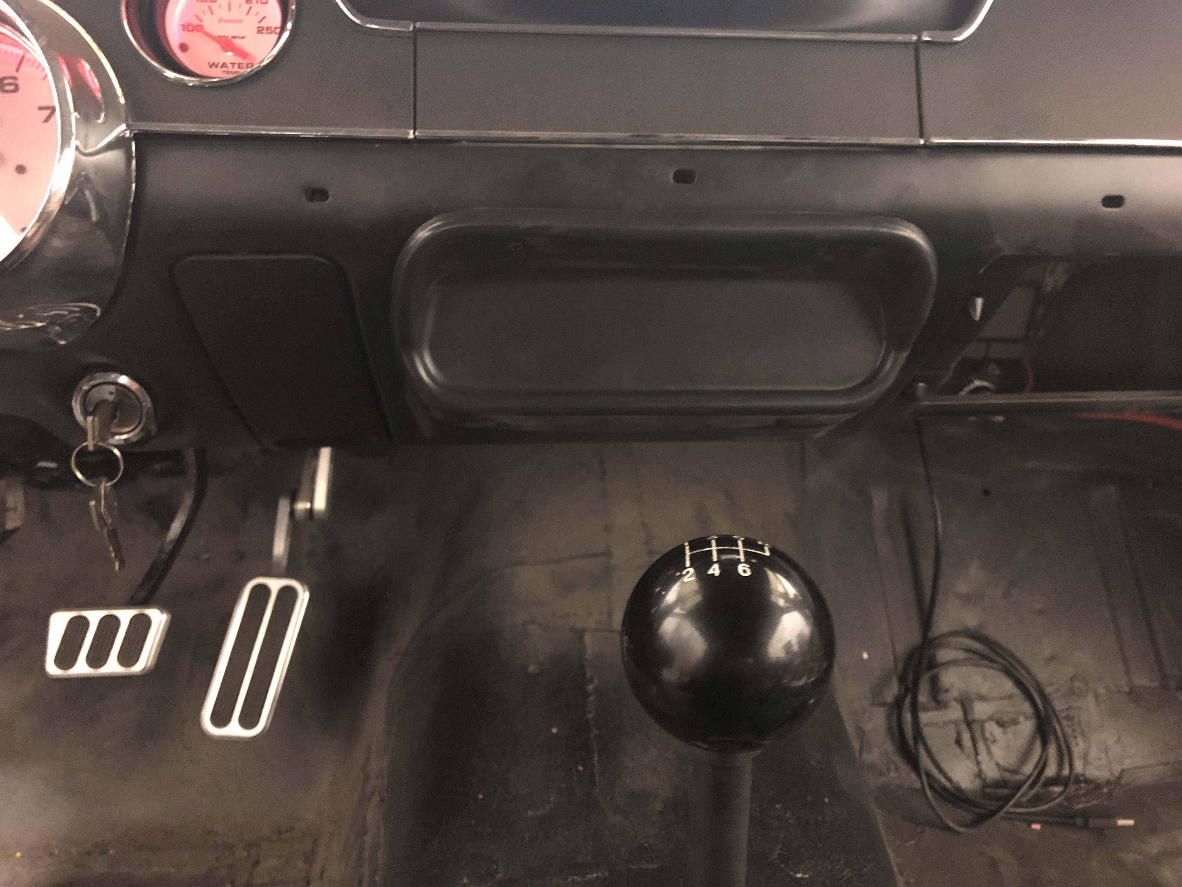

      Found this plastic radio delete on the internet last year. It fits okay. it needs to be painted to match the shade of the dash. My car is super loud, I doubt it will ever have a radio.

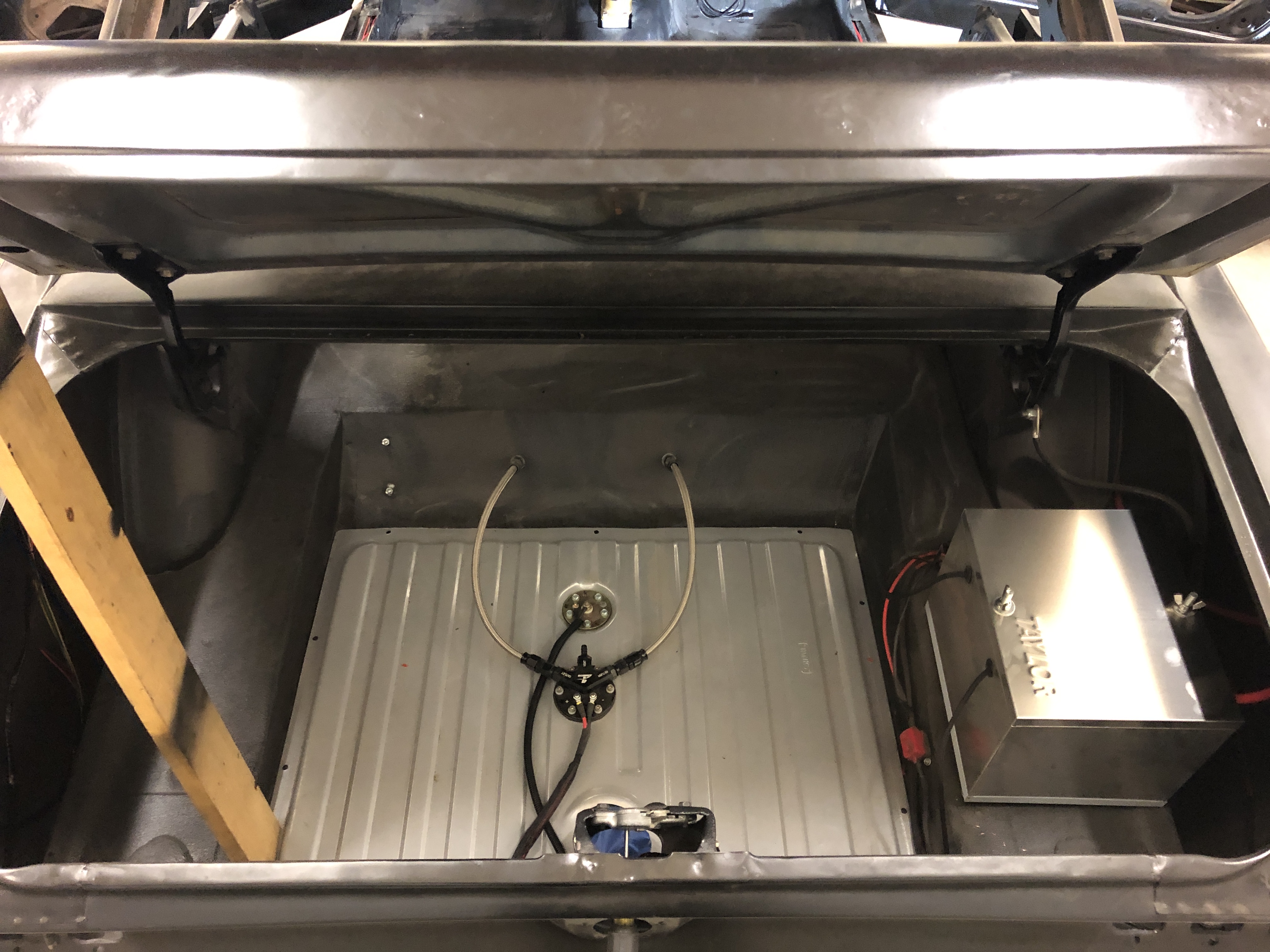

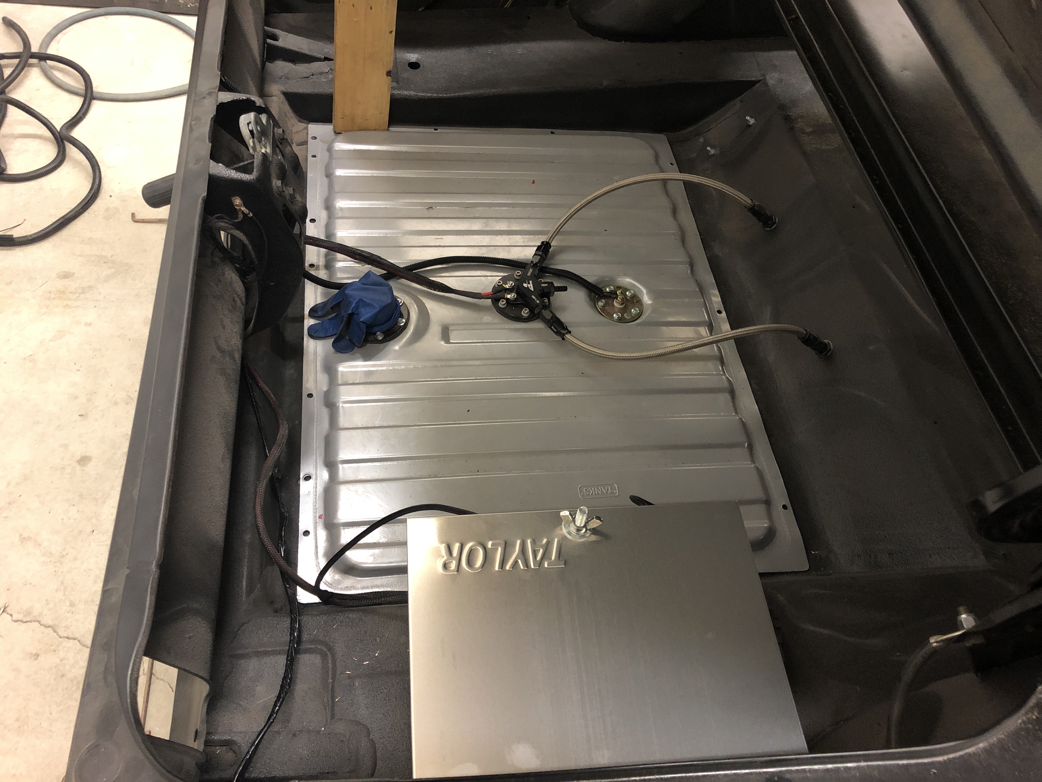

      This is the first gen aeromotive stealth 340 tank.. The fuel lines exit the trunk through bulkheads. It's all PTFE line.
      The exposed wiring is an aeromotive fuel pump relay harness and fan wiring. Everything terminates into the Taylor aluminum battery box, housing an optima redtop.
      I might change the fuel fittings to the bulkheads. At the time i plumbed the lines 45* fittings were on backorder so I used the straights I had laying around. Angling the fuel lines down will prevent the arch. So far it runs and idles great.
