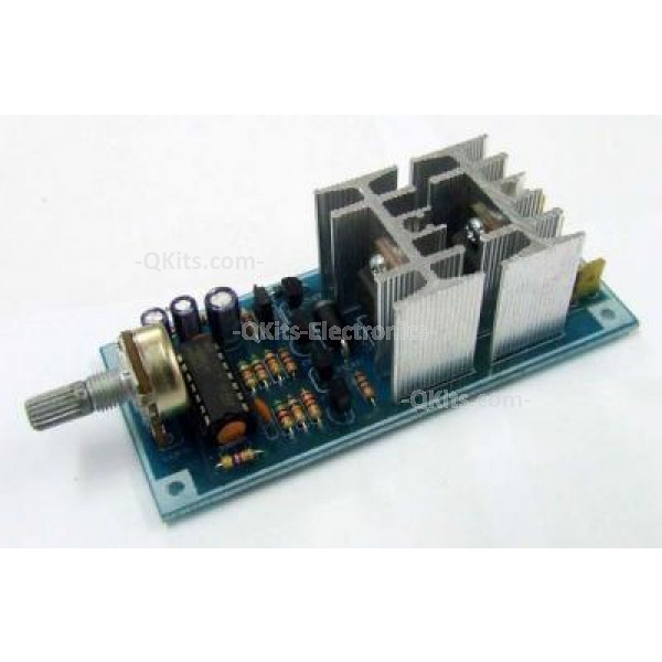

      I've had good luck with this company- out of Canada- and used several of their PWMs
      The potentiometer is not remote- but could easily be done-
      This one handles 30A- and shipped about $30
      https://store.qkits.com/pwm-dc-motor...mp-mxa066.html
      This seems like a slick way to do it!
      that's exactly the kind of thing I'm after, google turns up numerous choices so its good to know that someone has used this brand and had good luck. thanks guys I may give these a try.
