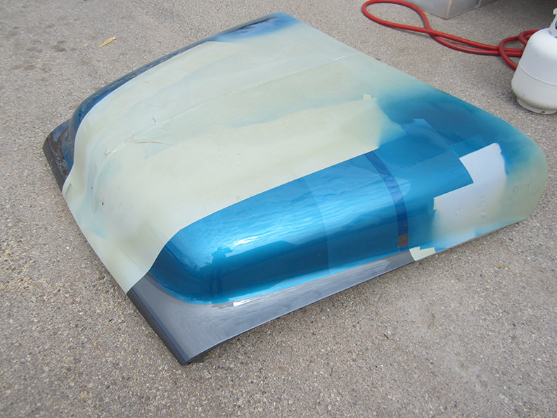

      While block sanding moves along Bob did a quick spray out of the colors on the old hood. You can see the charcoal gray at the bottom and then a few shades of BMW blue paint hues. Which shade appeals to you?
    2. #62
      Minneapolis, MN
      195
      I'm sorry but I'll be mostly not helpful and say all the blues look good with the gray. And I know you have a color scheme mock-up and all, but with how you did the test paint it makes me think of the Boss Mustang hood stripes. And doing the blue on blue stripe from the hood, down the fender could look really cool.
      If I had to pick a color to go with the gray I'd pick the main blue you laid down on the front corner of the hood.

      You're right, that's not helpful, ;) Lol! Just kiddin'... I like the front blue too, and I think Bentley's leaning toward the lighter shade in the wide stripe. At this point he's torn whether he likes the gray and blue combo and we may just paint the whole truck blue, so I throw it out to you guys to hear your thoughts too.
      Personally I think these trucks with their very rounded Popeye type curves kinda get lost with a single tone paint. They gray and blue are different enough that they contrast quite a bit and break up the monotony. In that case Brawls, your liking all the blues with the gray is helpful.

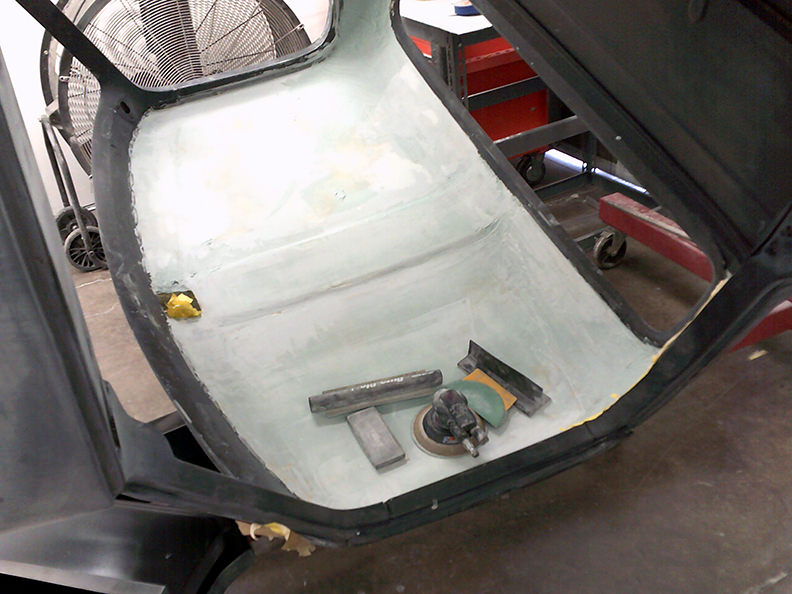

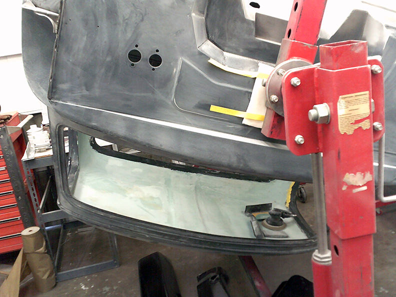

      Here's a cool bit of custom work- what do you do when you lack a decent headliner? Of course there are several methods for this issue but we wanted this interior with it's late model Mustang cues to have that same level of smoothness and refinement to the headliner and other interior panels. The solution we have going on here is flip the truck upside down, fill the roof cavity with a special foam, shape the foam and fiberglass over it, and then add a thin skimcoat of metal glaze to smooth and even it all out. This will be wrapped in leather and then trim pieces will be made to finish off the edges.
      More details coming in here and underneath the cab, stay tuned!

      One of my friends did headliners by waxing the outside and shooting fiberglass on it. He would cut it in the middle to narrow it and glue it back together. He used a chopper gun and would be finished so quick that it was impressive.

      Now there's an idea. I have a 73 Nova that had a heavy cardboard headliner wrapped in vinyl. Pretty much everyone of them I've ever seen has drooped. Now you can buy an ABS plastic version to wrap but they're over $300! Supply and demand I guess. That 'glass on the outside sounds like a good way to pull it off for the guys who can't flip the car on a rotisserie. Thanks for sharing.

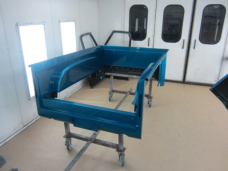

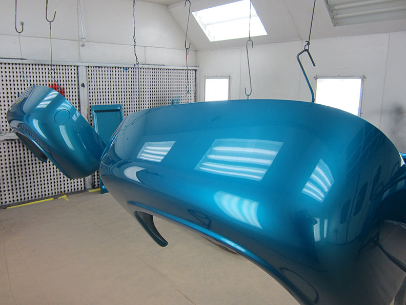

      While the cab was in the body work booth getting final sanding and the bottom bed lined the back half of the truck was in the paint booth making the transition from busted up to BMW blue and beautiful. As usual Bob laid down some sweet hue which after curing will get buffed to a glass-like finish. To be continued...

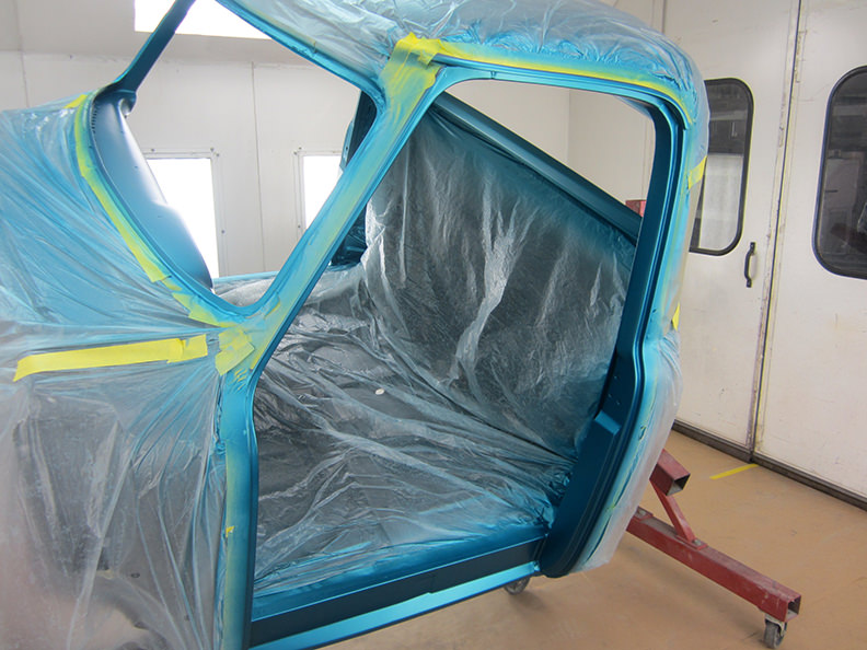

      "Hey, hey we're jammin'" ... and sprayin' ...

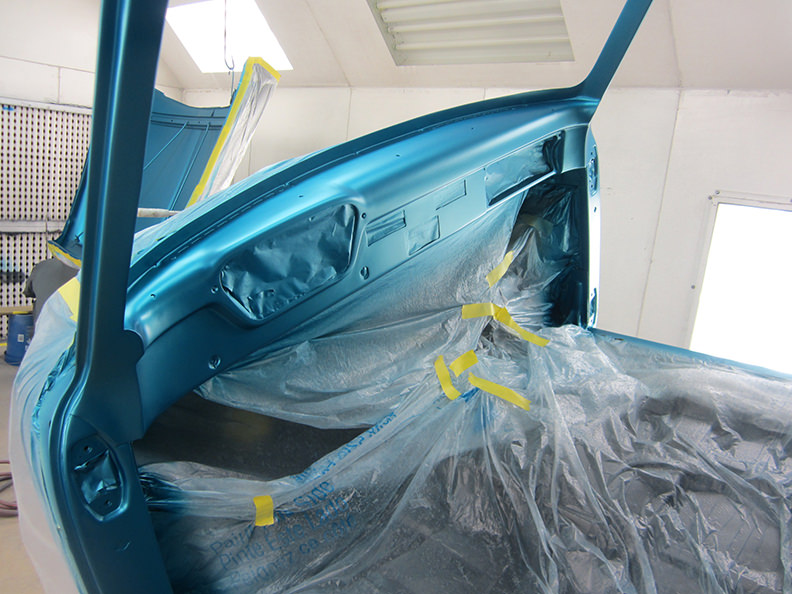

      Laying down the base coat on the cab and you can't help but think this blue shade even looks nice in satin too, right?

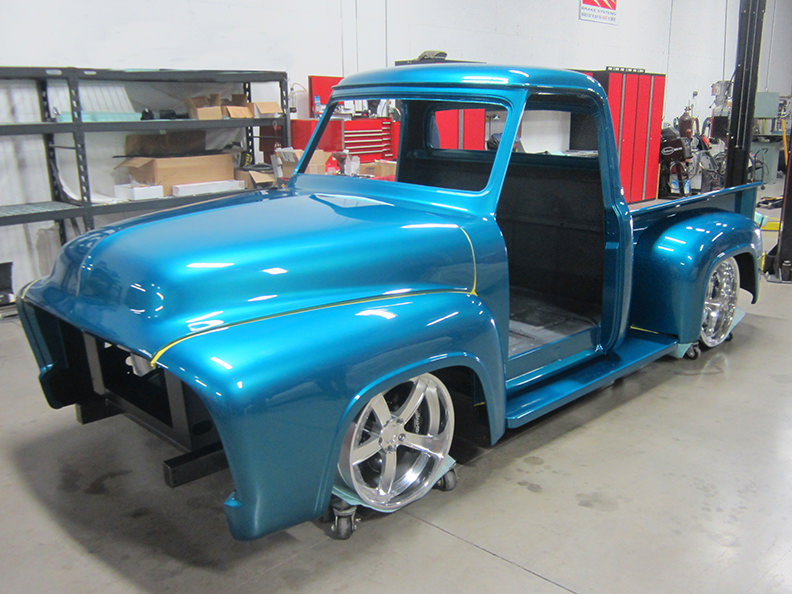

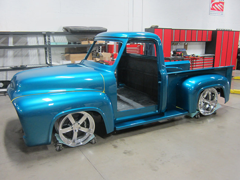

      Initial mock up of body panels on the F100. Hmmm, maybe 2 tone isn't necessary after all?
