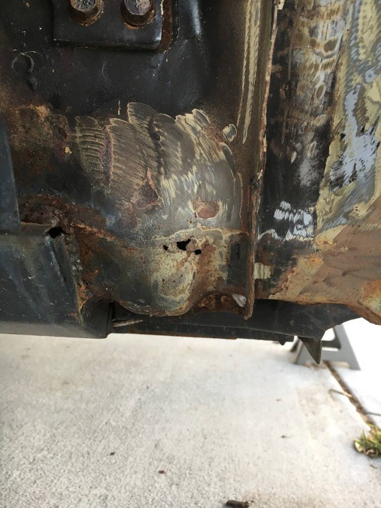

      Started tackling the firewall. I cut out the two rust holes by the doors. Not much welding to do for the patches. I also ordered the pedals and covers. Going to weld the necessary patches and seam seal the firewall. After it spraying matte black and coating the underside with bed liner, I'll run the gas and brake lines and mount the subframe.

      Got a little bit of firewall work done, ran out of motivation so I'll sand the filler later. Turned out okay.
      Before;
      Aftermath:
      Door area plugged, no turning back now...
      Seam seal, will sand down and paint. (Going to reseal entire firewall and will tape it off.)
