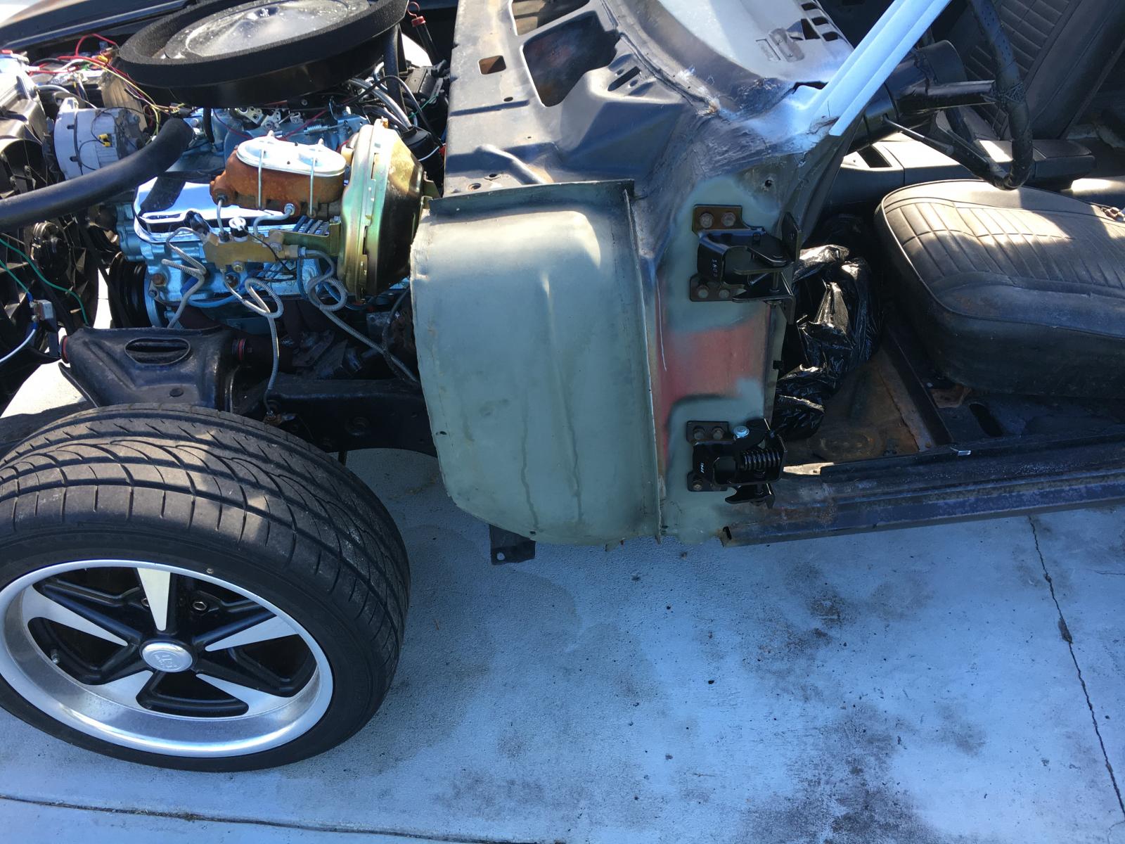

      Started on the rust removal/body work. Got the trunk and hood down to bare metal and covered in
      2k high build primer. I’m going to spray the engine bay, inner fenders, under hood, dash and interior panels around the package tray satin black then work on prepping the outside for color (Solar Red) and clearcoat

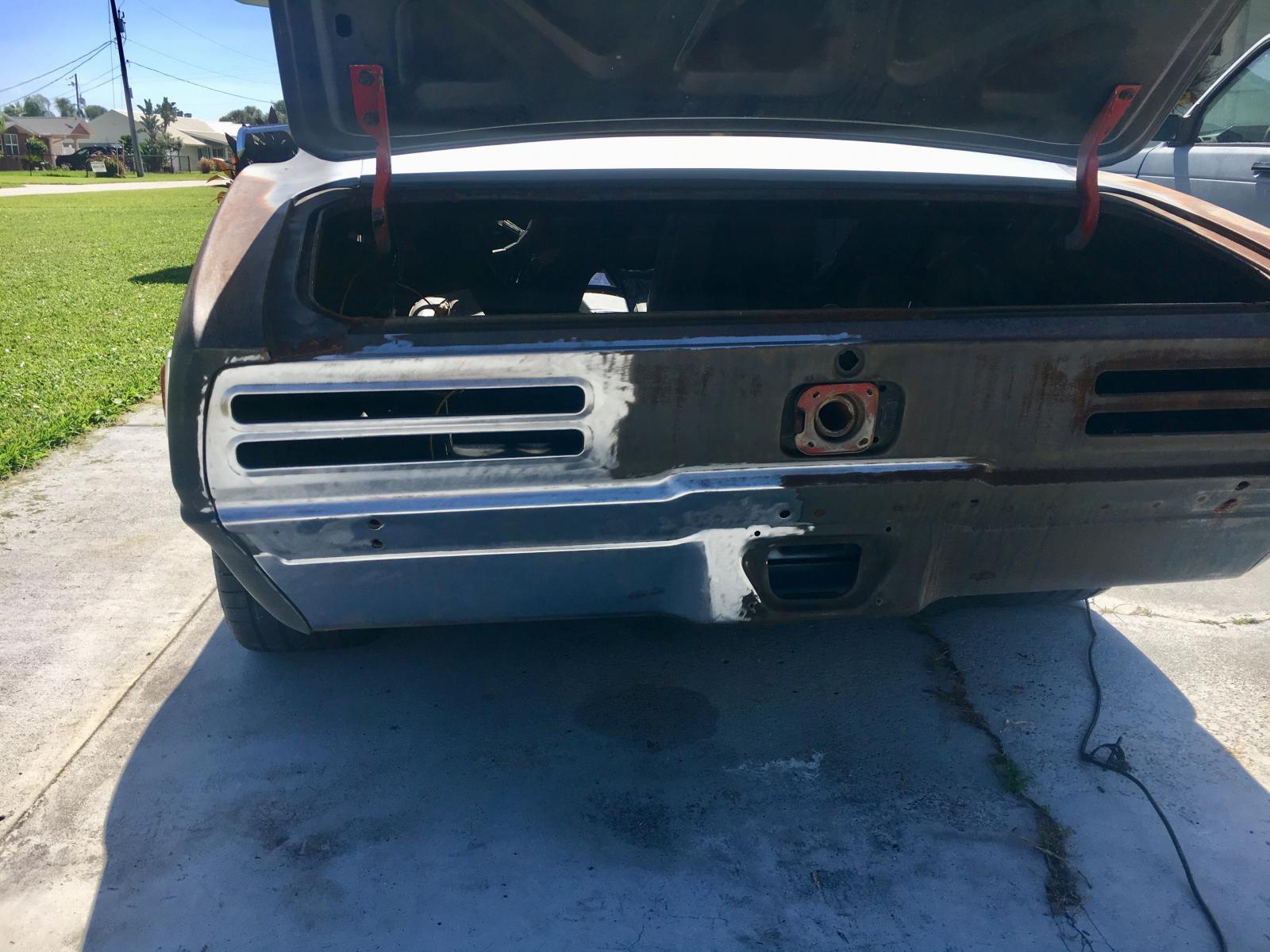

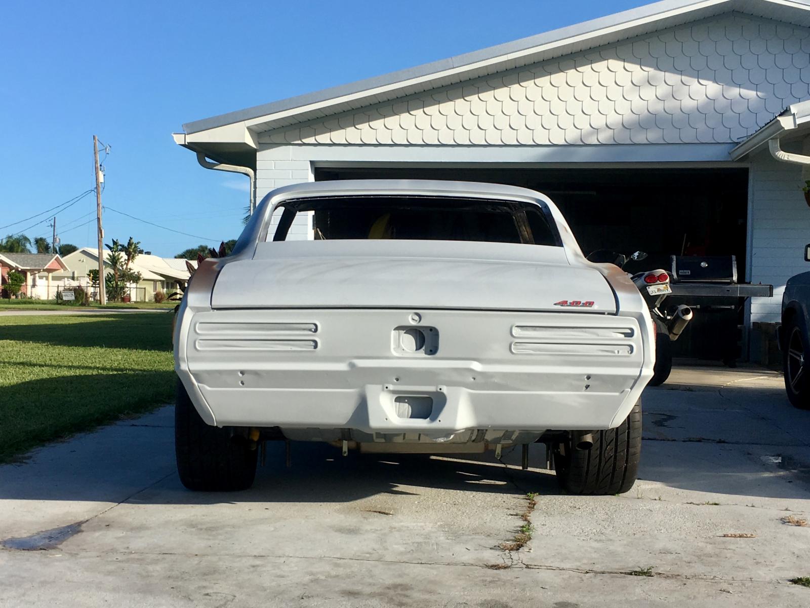

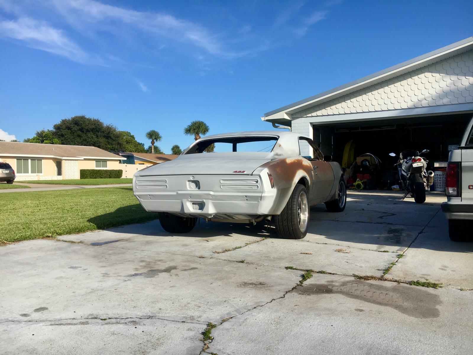

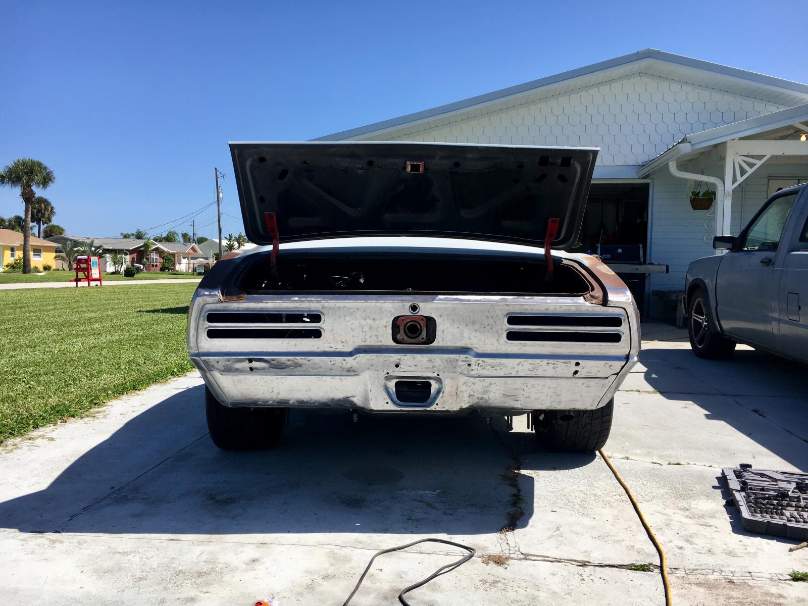

      Managed to tackle the rear before I headed out to the Superboat races in Clearwater.

      Ben

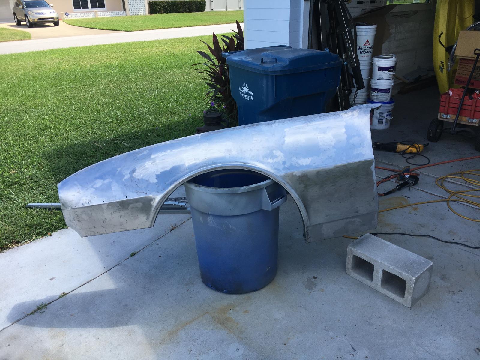

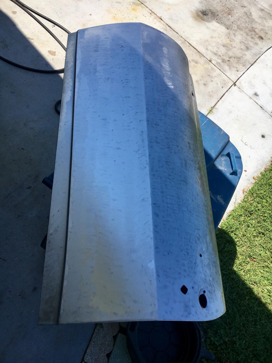

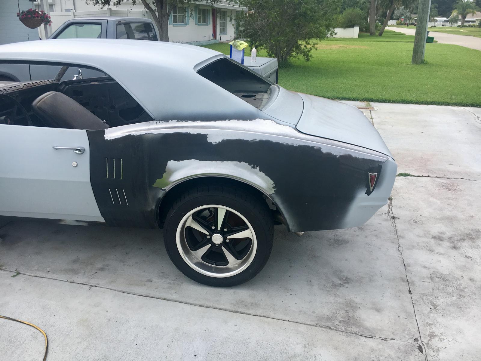

      Tackled the driver side quarter panel. Might get the passenger side done this weekend if weather cooperates.

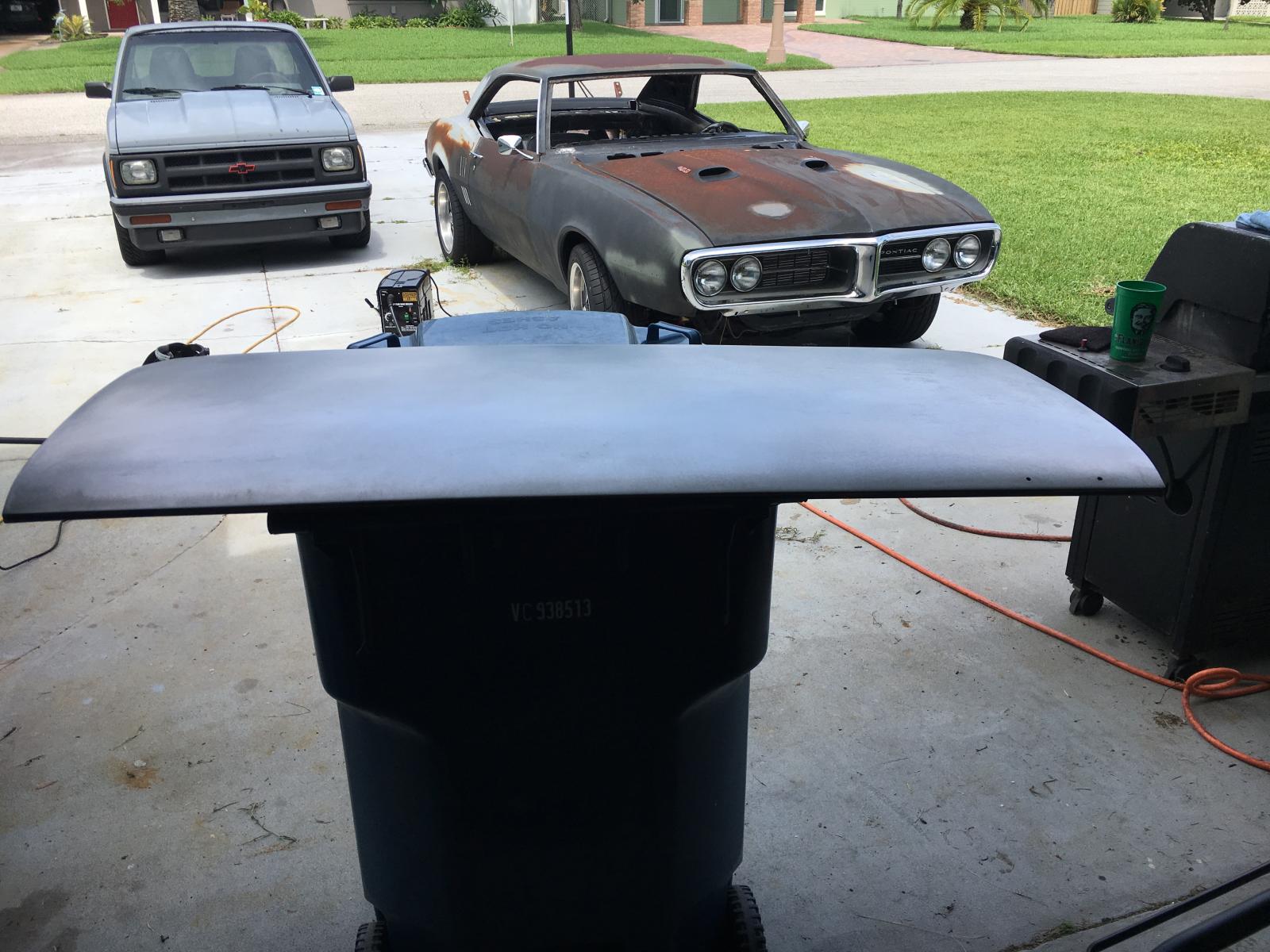

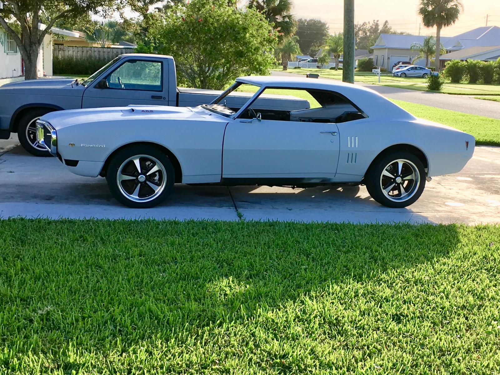

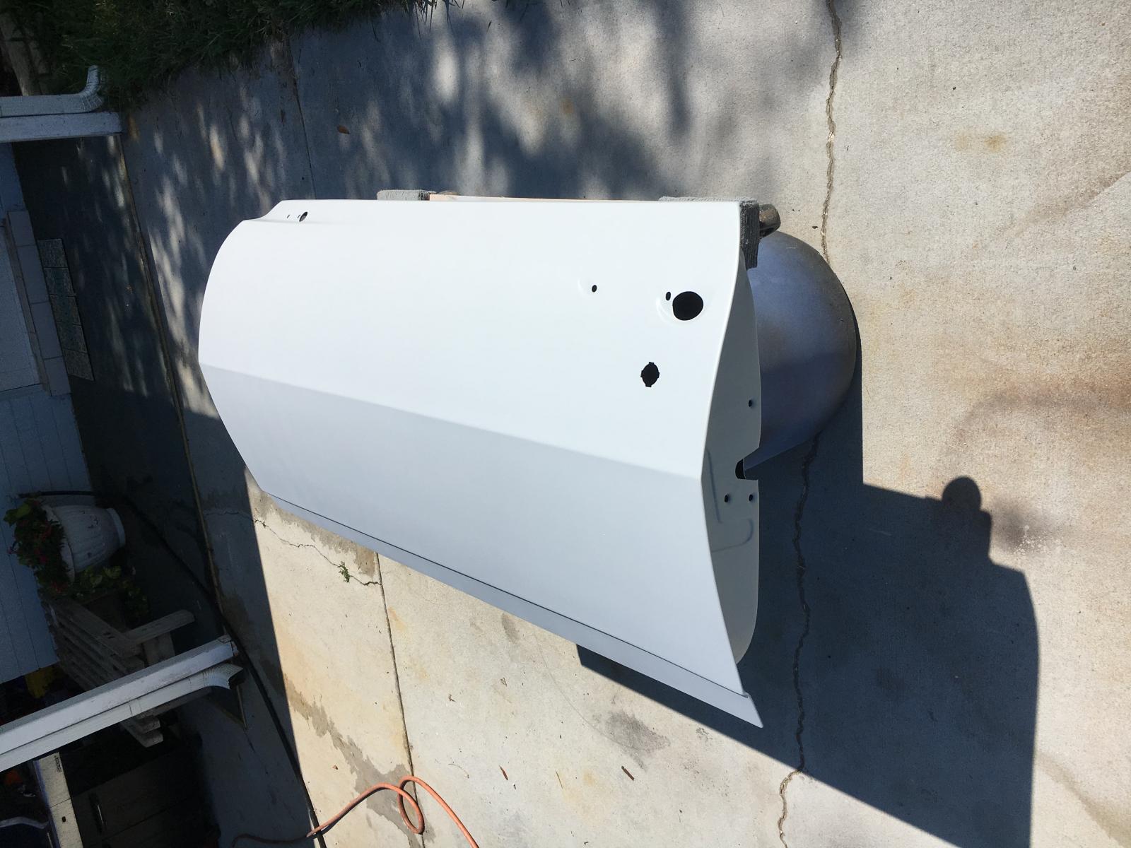

      Almost ready to start block sanding. Got to adjust the doors and fenders. Going to spray on a tinted sealer, after blocksanding the high build, before the color coat. Finally feels like I’m making headway.

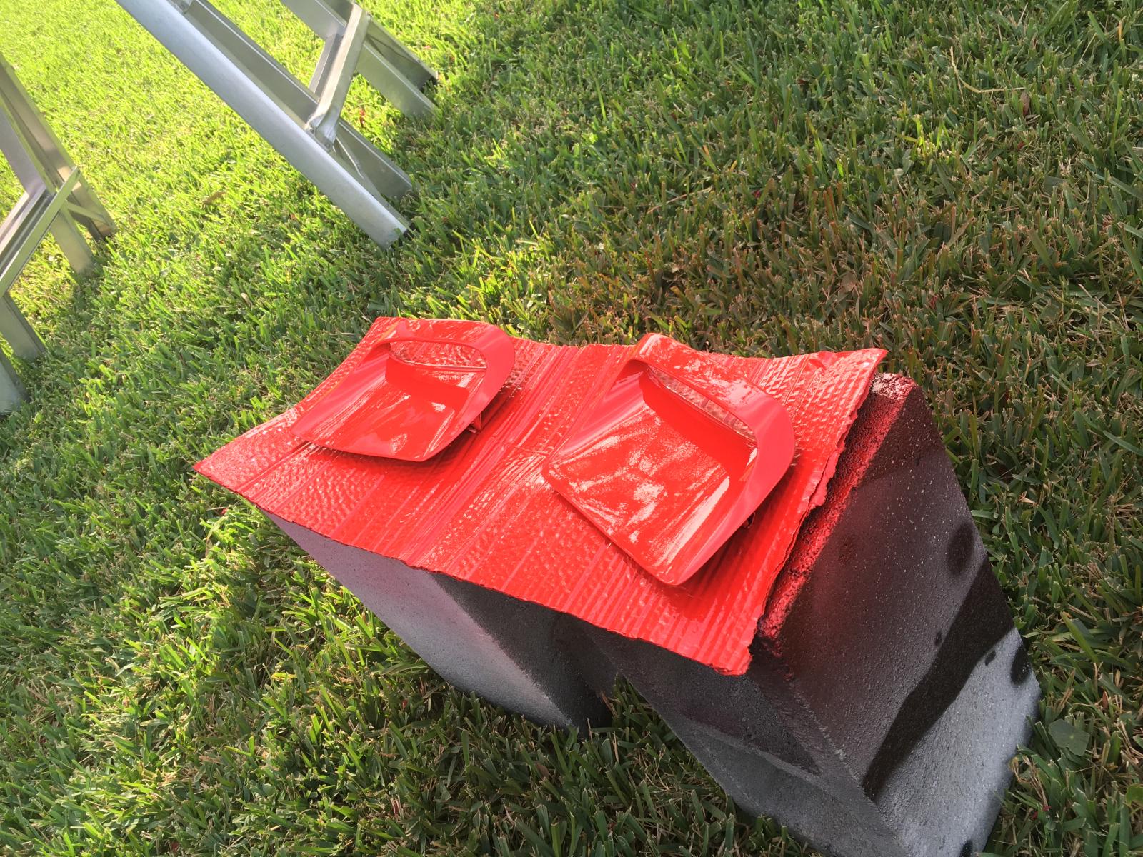

      Didn’t like the chrome base of the Camaro console QuickSilver shifter so I painted it along with the package tray upper trim and dash.

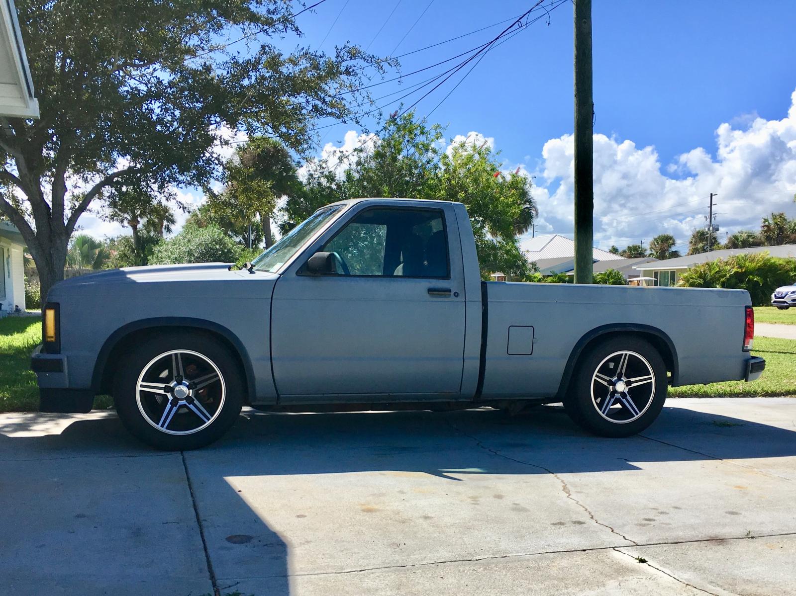

      Any more pics of the S10/Sonoma?
      Jay
    17. #77
      Feb 2010
      New Smyrna Beach, FL
      116
      Haha, here’s my dirty ‘87 S10 daily beater. 1995 5.7 LT4, HotCam, 1.6 roller rockers, T56 manual, 3.42 gear 8.625” disc rear with Detroit TrueTrack, ZQ8 suspension and dual piston Blazer brakes, A/C:

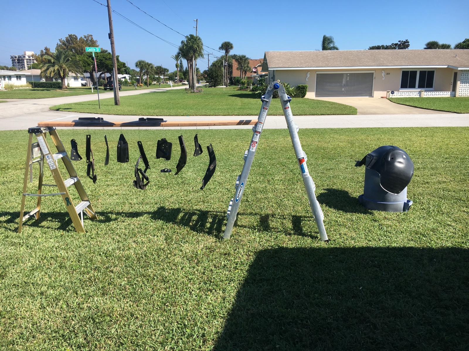

      Been working on painting the under hood items. Finally replaced the bucked cam plug with the correct, shallower depth one. Fun times. Slowly making progress in spite of the setbacks. The old bumper assembly was pretty beat. I think what I’ve got so far isn’t too shabby for a daily driver.

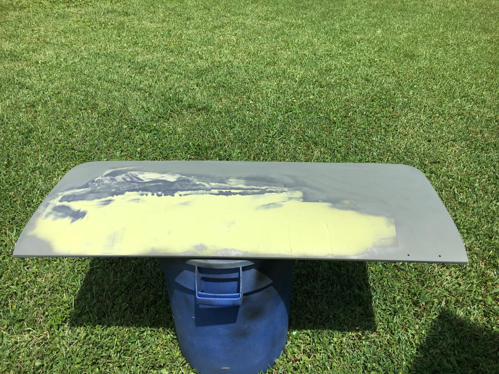

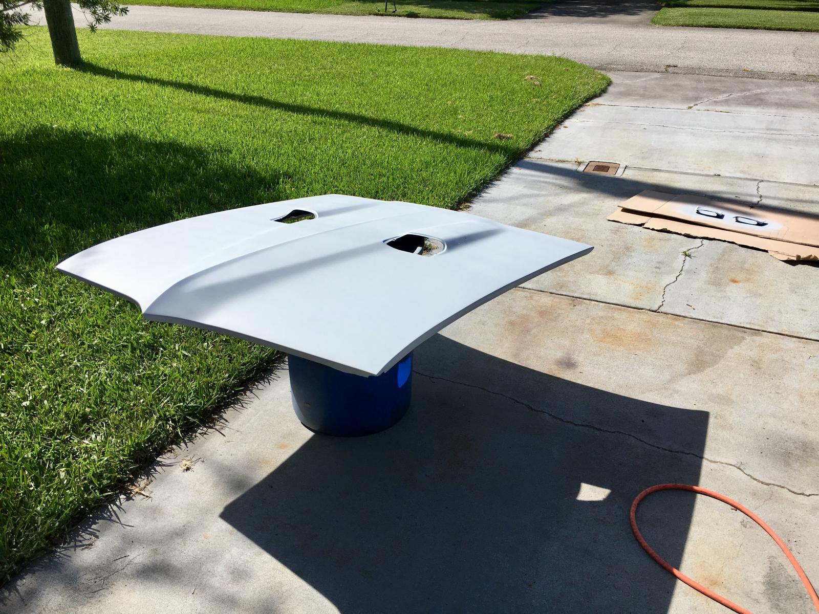

      Block sanded the deck lid and a couple small parts. Sprayed them with red tinted sealer primer.
      Ben

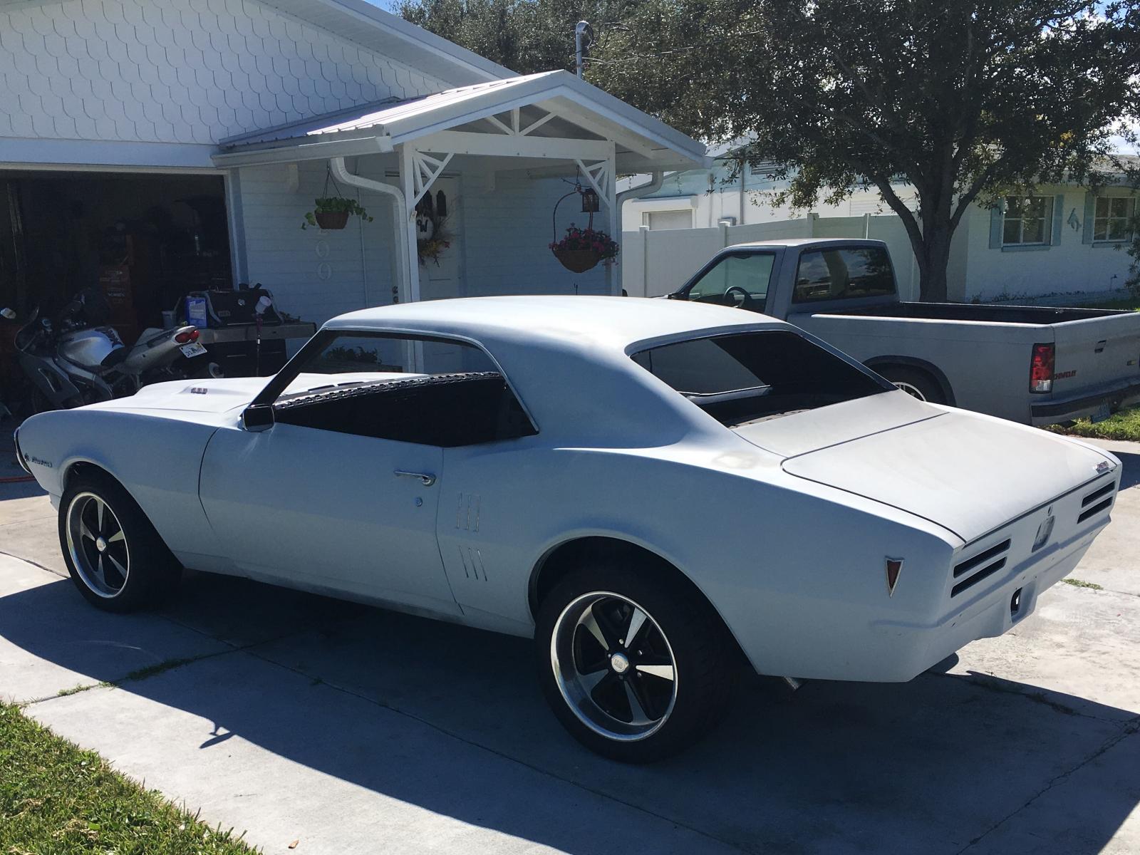

      Sealer primer is laying down well. Got most of the front end sprayed. Looking forward to getting the Solar Red base and clear coat on.
