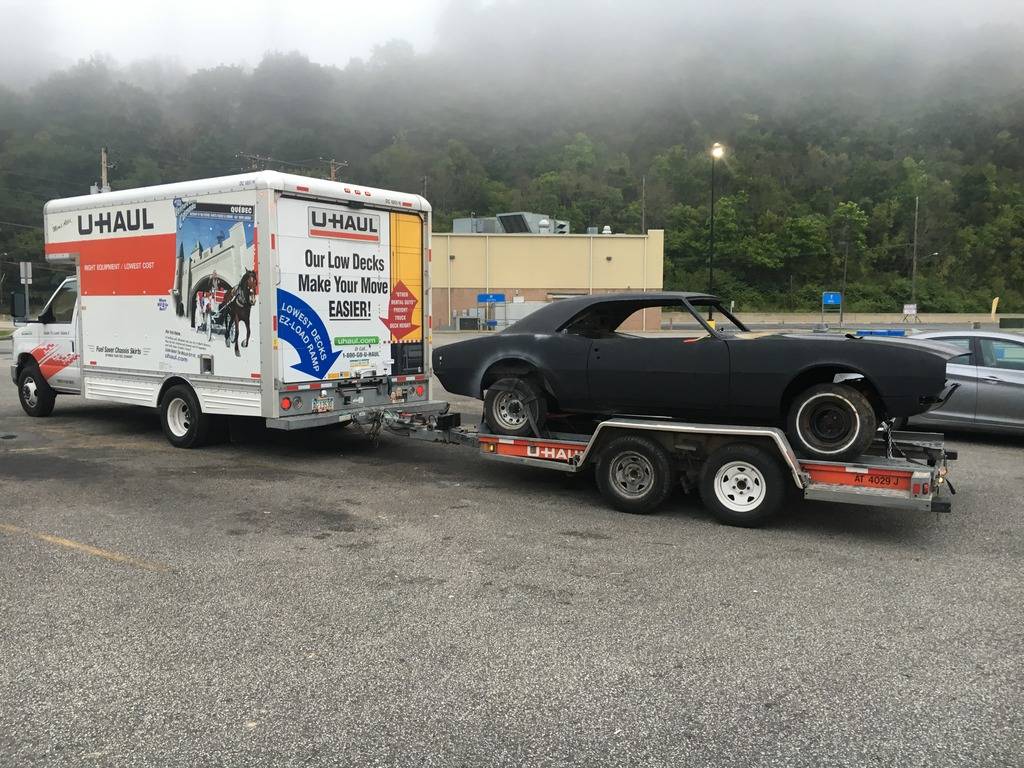

      Last summer my girlfriend's Uncle came across a first gen in Ohio. He asked what I was looking for and I told him a 67 or 68. Turns out a friend of a friend of his had passed and was beginning a full restoration of his 1968 Firebird. His son sold it to me cheap and I flew up to Ohio, rented a UHaul and towed it back to Florida. The firewall, cowl and rear seat bracket were the only original metal left.
      In my girlfriend's dad's garage in Ohio
      Loaded up on the UHaul
      900 miles later

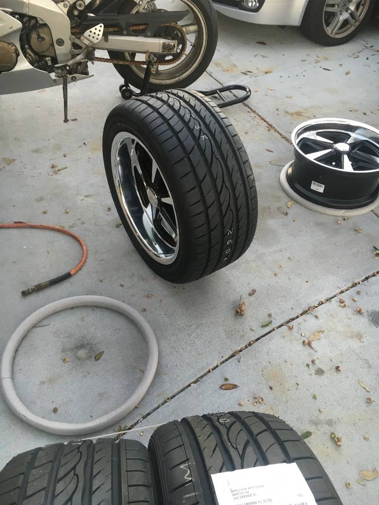

      14" mags had to go with the new brakes so I went with US Mag "Bandits" that reminded me of my Dad's Rally II's. 17x8 235/45 front, 17x9 275/40 rear.
      Old and busted:
      New hotness (my son approves):
