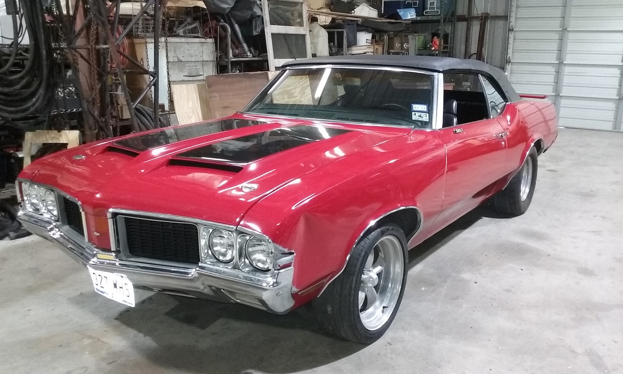

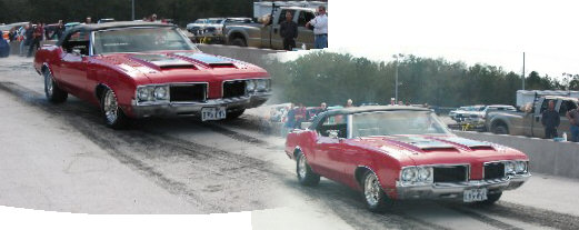

Size:  31.2 KBThis is my Cutlass that I have owned since 1995 in its native setting at the drag strip. When I first got the car drag racing was all I cared about. All of my effort went into making the car faster in a straight line, brakes and turning ability were not of any concern. This car got me started in racing and I moved on to faster less streetable cars but those cars have been sold and I kept this one long term. With the responsibilities of raising a family and running a business I just have not had time to drag race as much and the Houston TX drag racing scene has died down over the years. The car has been driven on the street the whole time but it became dated and time for some changes. A few years back I replaced the TH-350 with a 700r4 overdrive transmission to make it more street friendly. I had a guy cut me off and bend up a front fender in 2012. I had to chase them down after they fled the scene but ended up getting some insurance money because they had no insurance. The car sat since then while I came up with the direction I wanted to go with it.

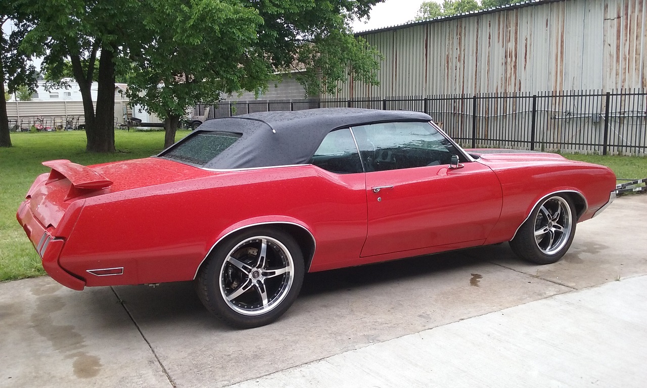

Size:  342.4 KBThis picture is from November 2016 when I stated the updates. The rear suspension is Currie upper and lower control arms with UMI springs and braces. Varishock single adjustable shocks on all four corners and Helwig Tubular sway bars front and adjustable rear. The front suspension is Global West upper and lower arms with a 1" taller upper ball joint. The engine is pretty stout and does not make much vacuum for the brake booster. The brakes were sketchy at best, I fixed that by installing a hydroboost system and now it can stop on a dime. The 12 bolt rear end has all Strange parts and axles with c-clip eliminators from its days as a drag car. There are limited brake kits available for c-clip eliminator axle ends so I pretty much had to go with Wilwood's Forged Dynalite-MC4 Rear Brake Kit. I wanted to match the rear pretty close so I went with Wilwood's Forged Dynapro 6 Big Brake Kit up front.

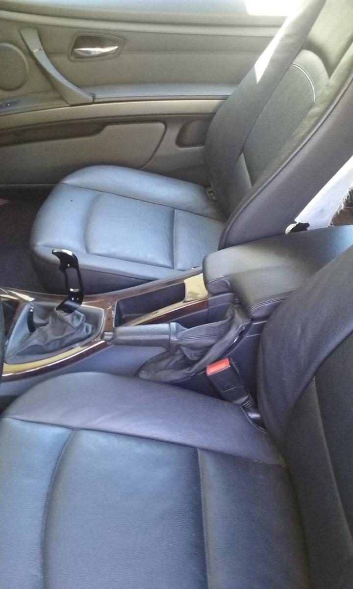

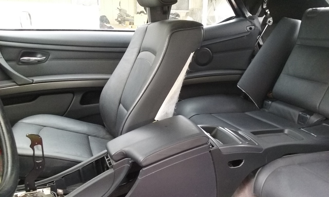

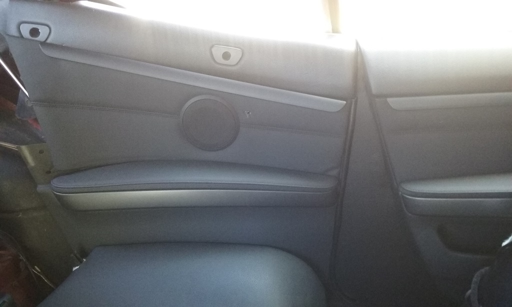

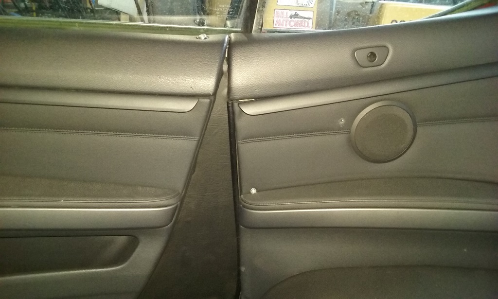

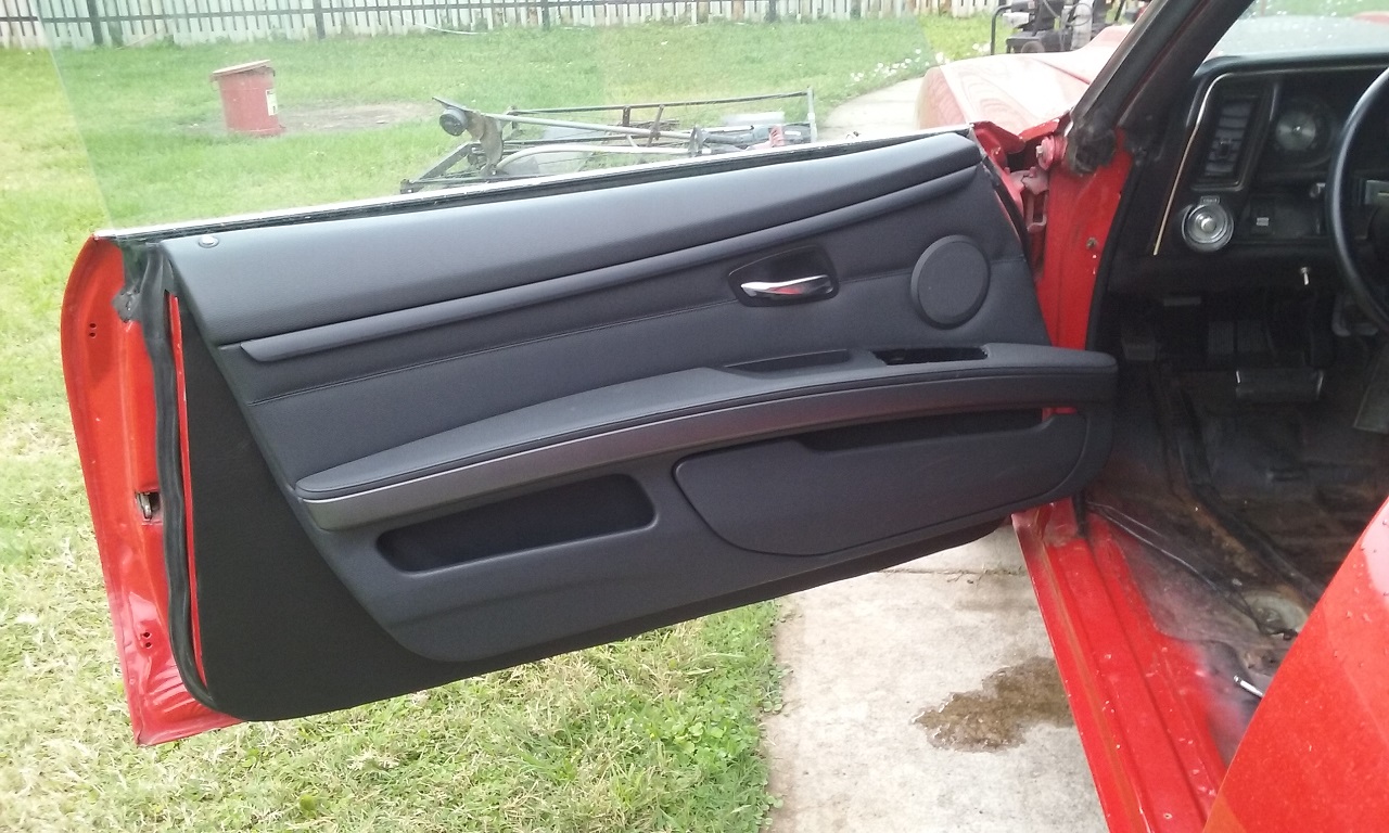

Size:  270.7 KBAll of this work was a piece of cake compared to putting the Interior from a 2011 BMW 328i convertible in the car. I am a mechanic by trade and a bit of a perfectionist, I have never done any interior or upholstery work before. I can tell you that there is NOTHING perfect about putting a late model interior in an older car haha. The door panels were the hardest part, I just had to start cutting and forming to get them in. I have it roughed in for now and will finish it off when time allows. I need to get some new rims and tires, new convertible top and paint job to finish it off. I will update this thread as things slowly get done.

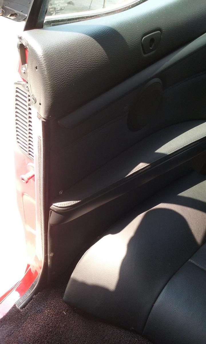

      Any chance you can post up a shot of the transition from the door panel to the rear quarters? I really like what you've done, just wondering what the transition looks like.

      I am not sure what shot you are looking for, I am going to work on the car this weekend and would be happy to snap some pics for you.

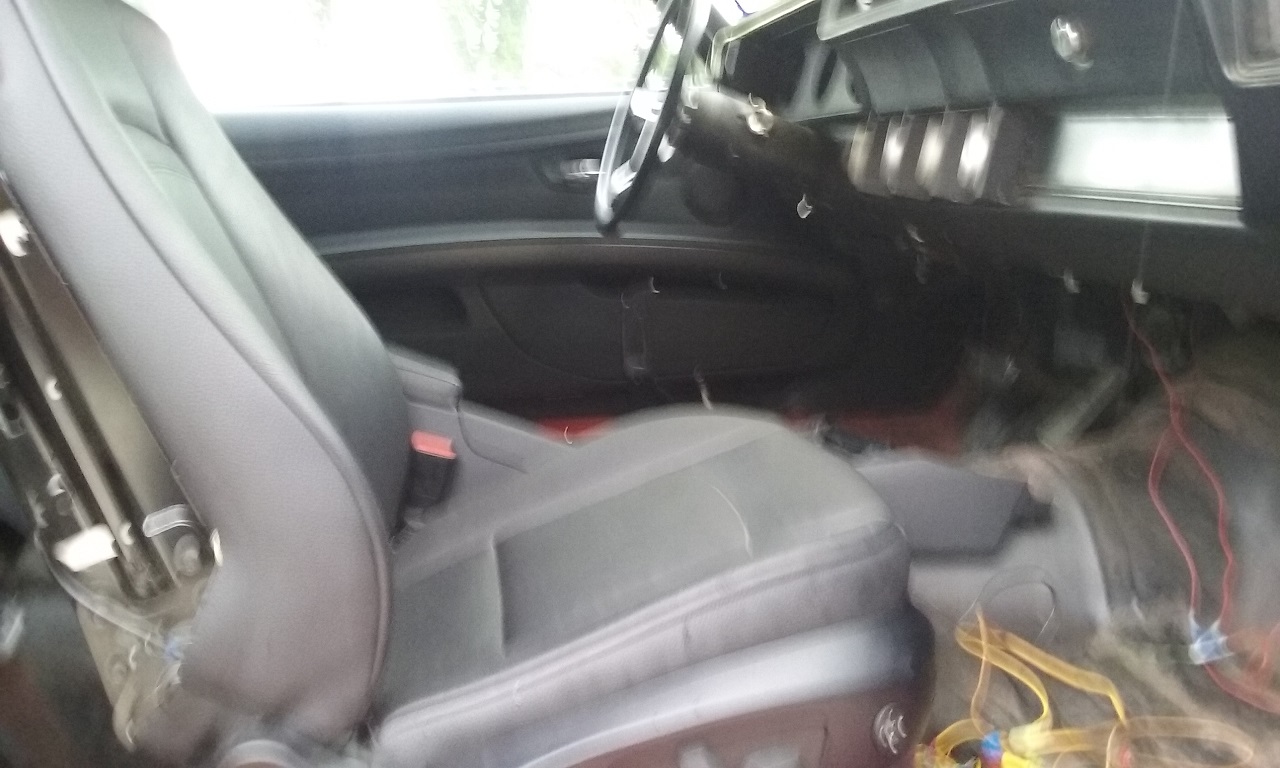

      Interior progress
Size:  90.6 KBName:  20170430_072135.jpg
Size:  171.0 KBName:  20170430_140903.jpg
Size:  132.5 KBName:  20170430_141340.jpg
      I got to work on the car a little bit last weekend. I have the front seats mounted and the console coming together. I ended up mounting them to the floor without brackets. The door panels I am using are much thicker than the originals so I have no way to center the drivers side to the steering wheel without them interfering with the door panel. The seat is about one inch inboard from the centerline of the steering wheel. The front seat rear inboard bolt is 7/16 grade 8 with a big washer under the car. The front inboard bolt is 3/8 grade 8 that also goes through my driveshaft loop bracket making it very secure. The three outboard bolts are 3/8 grade 8 with not much room for washers underneath because the are so close the edge above the frame. I will just have to live with what I can fit as far as structural washers. Instead of using a bracket or spacers to lift the rear of the seat I just took a BFH and beat the floor flat so the seat tracks sit flat but tilted to the back. The seat adjustment makes up for the slope easily and the seat feels comfortable and has plenty of room for rear passengers to get in and out. I posted a couple pics for Just John showing how the rear door panel meets the door jam. Keep in mind that this is just roughed in for now, I will try and make it pretty later. This interior project will look great when the doors are closed. It will never be show quality but it is good enough for me.

      Hello Morten, Best of luck with your project. I could not find anybody crazy enough to try this before me. A bit of advice on the door panels is to not modify the car to fit the panels, modify the panels to fit the car. I could easily put the original interior back in if I wanted to. I had no idea if I could make it work or not so I just started working on it and what do you know, somehow I made it happen. The rear door panels I had to grind and drill the plastic rivets till they are three separate pieces. I then fanned them out in the back and cut the front to fit the door jamb. I am trying to find a solution to the seats timing out after a few minutes of activity. Please let me know if you find a solution to this problem. If you search my post's you will find a lot of info on this subject but no solution yet. I believe the E46 are wired differently than the later E93 seats.
