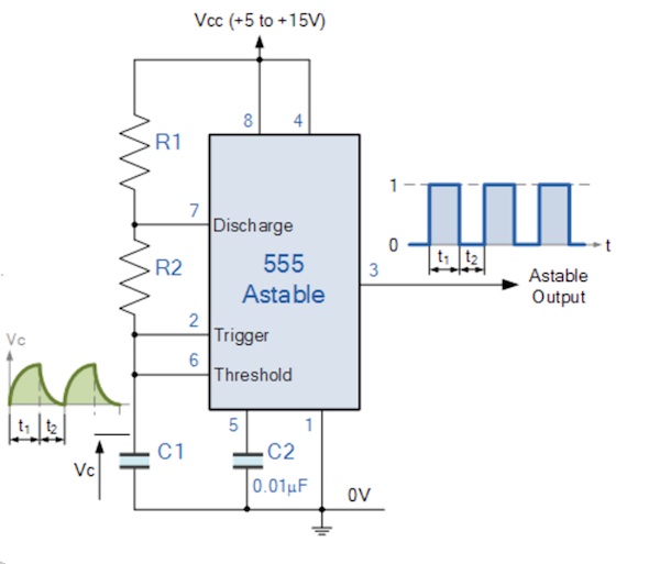

      555 Timer to wake up BMW seat
      BadOlds:
      Where did you get the info about the K-bus "wake-up" pulse? If that info is good, you can wire up a basic 555 timer circuit that will pulse the seat every 0.7sec whenever the ignition is on. Using the circuit below; use the following component values and you will have a 0.7sec oscillator to wake up your seats.
      R1=1kΩ, R2=2kΩ, C1=220µF
      Vcc=12v switched, Pin3 goes to the k-bus pin on the seat

      Here's a web link for more info:
      http://www.electronics-tutorials.ws/...scillator.html

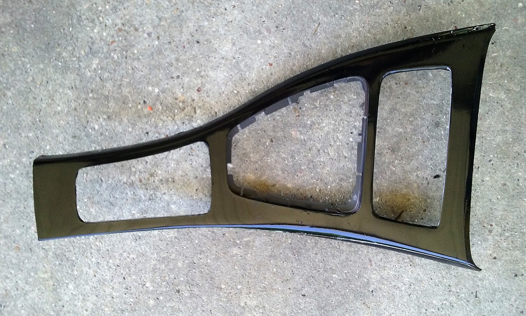

      I wrapped my woodgrain console trim in black vinyl and finished up the shifter today. I have a few odds and ends left to do but the interior portion of the build is coming to an end. I measured my rear tires and feel like a 285 35 20 will fit pretty good on a 20x10 rim with 6.25" backspace. Has any other A body owners ran that combo with good results? I have 19x8.5 rim in front with 5.5" backspace, I would like to have a slightly shorter tire on the front. What is a good size tire to run in the front to compliment the 285 35 20 on the rear?

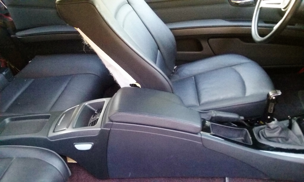

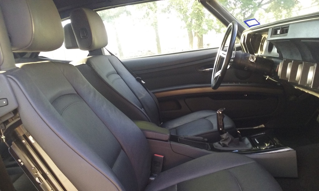

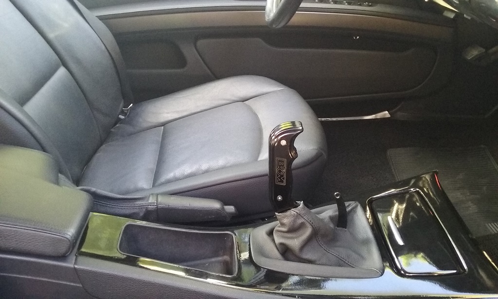

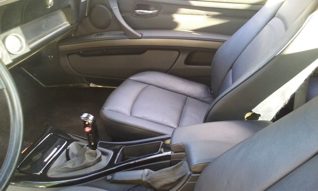

      I have the seats bolted in and working good. I decided to wire them with a switch located in the console under the armrest. If they time out you can just flip the switch off then back on and they work fine. The seat back covers which got damaged when the airbags deployed are on back order from BMW until mid June. I also finished the console, I tried to make an extension out of sheet metal to extend the console further forward under the dash. No matter which way I tried it looked out of place. I decided to just hack it off in front of the trim, DONE!!

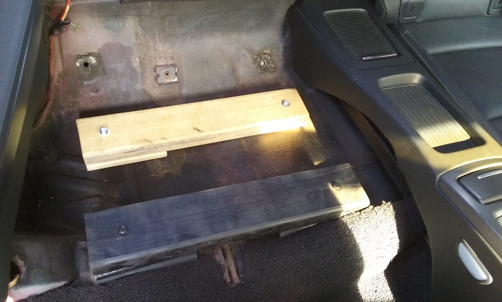

      Looking good Dan!
      How did you mount the center console and the back seats? I have testede fitted the front seats and console, but I havent figured out how to mount the seats in the back..
      You got some pics?
      Morten

      Oh no, you are going to expose me for the caveman I am haha. I used 2 x 4's bolted through the floor and screwed/ziptied the seats and console to them. I will post some pics for you later today or Monday when I get back over to the car.

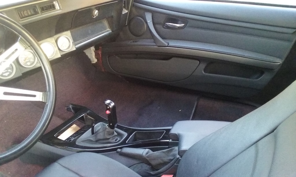

      Here you go, my dirty little secret is out on the interwebz now. When I first got the interior I just stacked some old boards in the rear seat area to see if it was going to work at all. After trying some different ideas I just screwed them down and they work good. I am going to attach the lower rear seats to the boards with extra long and thick zip ties. The console screws to the boards running down the center with some zip ties to make it sturdy. High tech stuff for sure.

      Thank you Dan,
      I will probably go for a simular solution. It is not the first time wood is used in the interiors of cars, so I do not agree that this is "caveman style " lol, but I see your point.
