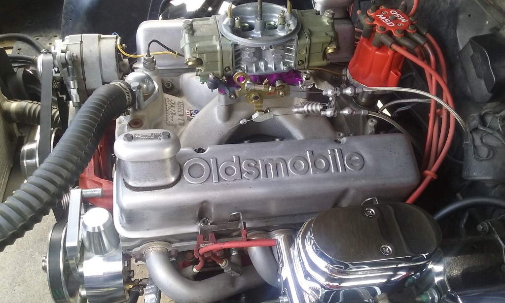

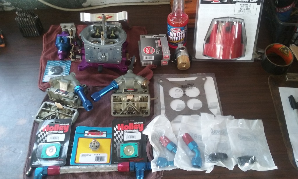

Size:  225.2 KBGot the carburetor and regulator rebuilt today. Replaced the old fuel lines and relocated the fuel pump to a less visible location. I used some old rubber sway bar end link bushings to isolate the fuel pump from the frame. I am hoping this fuel pump is as quiet as they claim and by isolating it with the thick rubber spacers it is not noticeable when the engine is running. I also replaced the cap and rotor, I cant believe how much rust and corrosion builds up inside the distributer cap. New spark plugs and the motor is ready for some abuse haha. I am going to drive it to get inspected soon. I have not drove it since the suspension and brake upgrades.
      A couple shots of the engine.

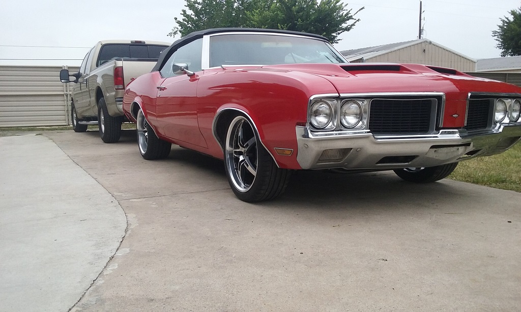

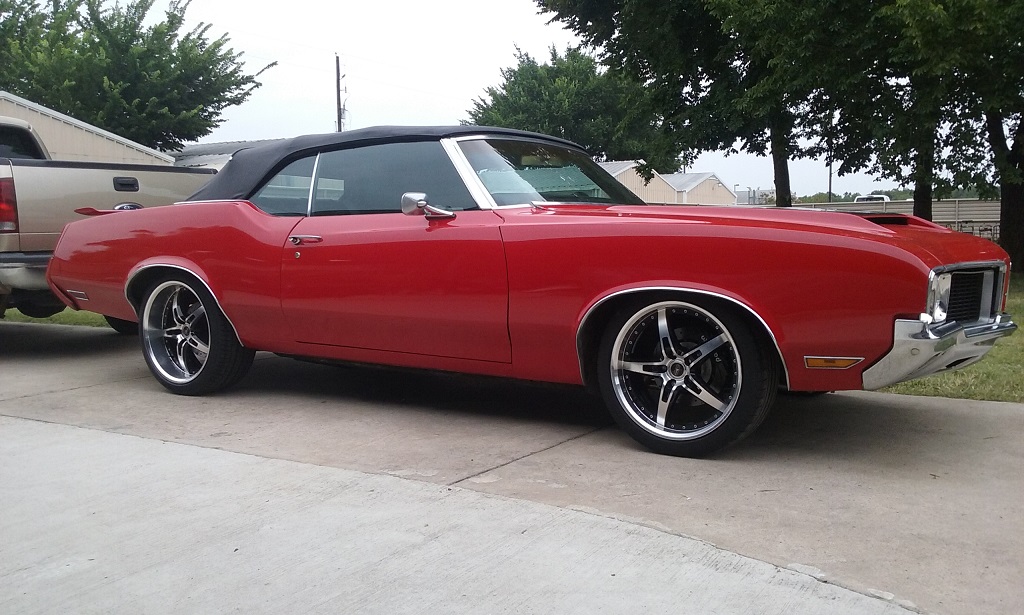

      I got the wider rims installed and some used craigslist tires to try out. In doing my research for this project I have seen many guys order the wrong wheels and tires that don't fit. I decided to get some used tires to check for fitment before I throw down the cash for new shoes. I found some 275 35 20 p zeroes for the rear and some 245 40 19 Dunlop sport max for the front. They fit like a glove with no rub at all, I can go 285 in the rear with out issue and possibly 295 would fit as well. I took the car for a spin yesterday and let me say it was really a SPIN!! The motor was real peppy with the fresh tune up and blew the tires off at any speed any gear. I am going to play with tire pressure to see if I cant get it to hook a little better. Both of these tires are run flats, I would like buy run flats when I decide on new tires so I wont have to carry a spare tire but am not sure if you give up traction with those style tires? anybody know?

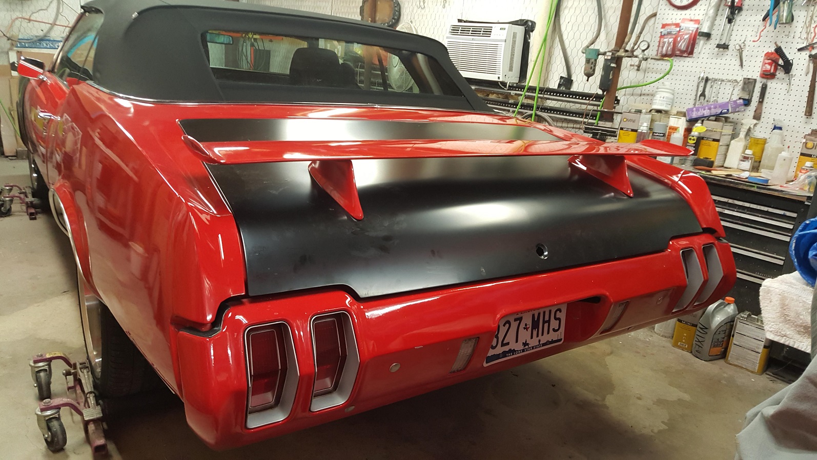

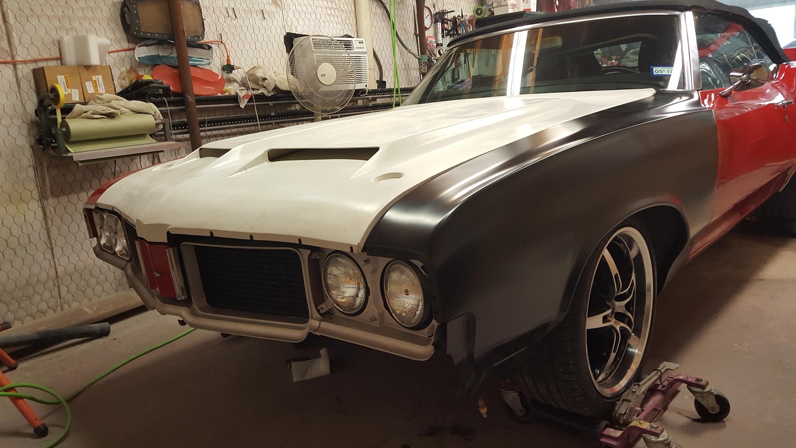

      New body panels
      The painter has already started replacing some sheet metal. The driver side front fender was smashed pretty good in the hit and run. The rear deck lid was in bad shape and I have never been real happy with the hood that was on the car. It is just dimensionally too long, if you line up the front the trim does not line up near the cowl. I like the design of the steel hood with the fiberglass grafted to the top. I just hope it fits right.

      Looking good Dan. If that's a glass decklid, you may want to see my post about adding the "shocks" to slow down how fast the trunk opens. The glass decklid is so light if you don't hold it when you open it, it could literally rip on the hinges. Plus forget about using a power trunk or keyfab or anything. I'm really happy with how mine came out and will now be able to use my factory power trunk button in the glove box then add the power trunk to my key fab with the alarm.

      I went with a steel deck lid. That is a slick setup you did on yours, with a steel deck lid and the wing bolted to it I don't have to worry how fast it goes up lol.

      oh OK sorry about that. It just looked like fiberglass in the pic - although it sure fits MUCH better than mine so that should have told me something right there. Still lots of work to be done on mine. And you are correct - you have the opposite problem - it will pop open but stay closed. That's how my steel one was with the wing before I switched to the glass one. Glass decklid is 26 lbs lighter than the steel. Fenders were only 16 lbs lighter and the front bumper was only 20 lbs lighter. It's a shame the decklid is in the rear! Would love to have more of that weight loss up front.

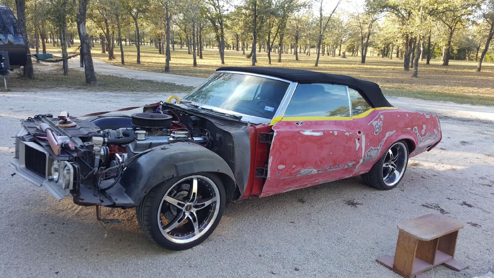

      Kenny the painter has been busy on my car. So far he has sanded the car and replaced the door hinges. Good news is there is very little rust to repair. Hoping to get it back by springtime.

      Looking good Dan - Got a tough call on paint jail for mine coming up. Think I'll probably drive it as is for a while since it's been gone so long. We'll see.

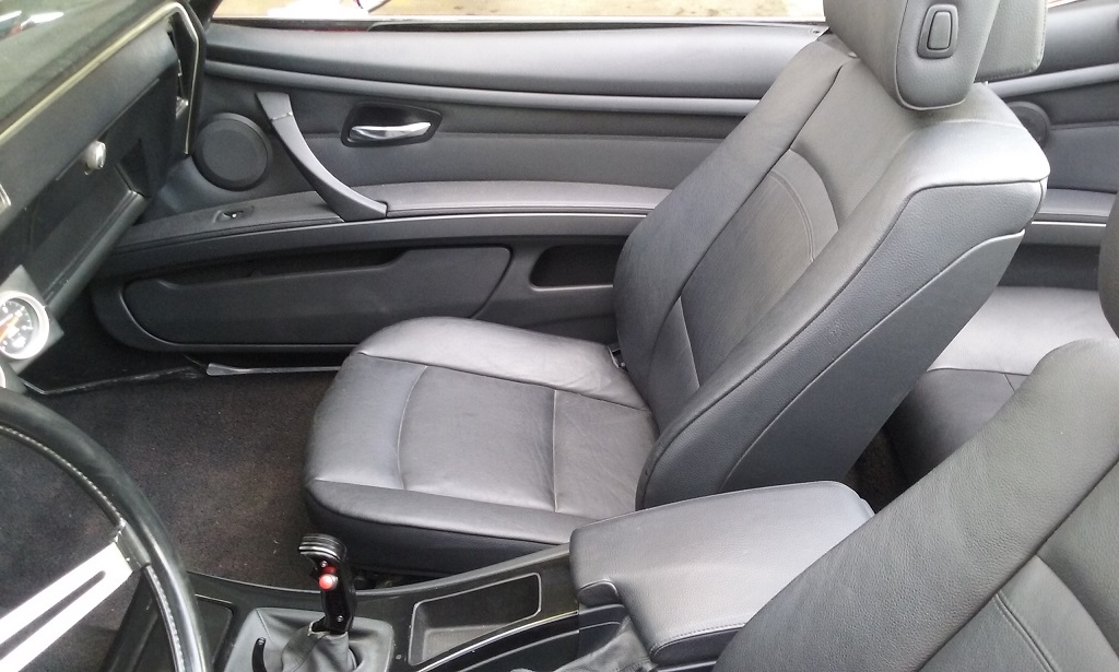

      I would love to see some pics showing how you mounted the front seats. I have some E46 seats from a 2001 M3 convertible but they aren't centered on the steering wheel if I bolt them directly to the floor. I think I need to raise them up a little so I can move them closer to the doors. How did you mount yours?

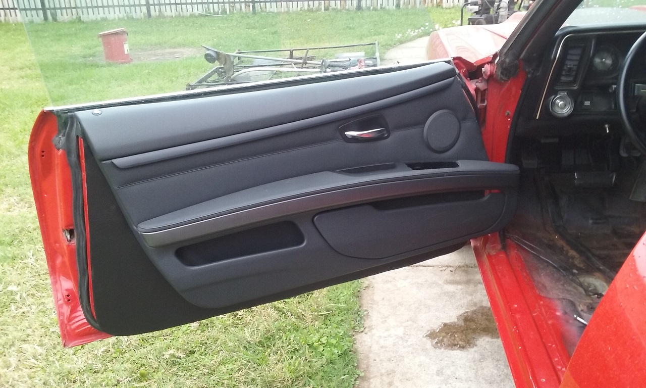

      Seat mounting
Size:  329.3 KBName:  20170923_170728.jpg
Size:  245.3 KBName:  20170923_170852.jpg
      Rodney, the BMW door panels are much thicker than the originals. If I tried to center the driver seat to the steering wheel it would interfere with the door panel. After installing the door panels and center console I had to just bolt the seat right in the center. The driver seat is one inch inboard of the steering wheel. I thought this would bother me but it is a non issue, I have drove the car quite a bit since the install and don't even notice it anymore. I did not use a bracket to mount the seats, I beat the floor of the car flat and mounted the seats directly to the floor. The range of adjustments of the seats allows them to be level when you sit in them even though the floor of the car runs downhill to the back. There is plenty of room to get in the back seat and they are very comfortable to sit in.
