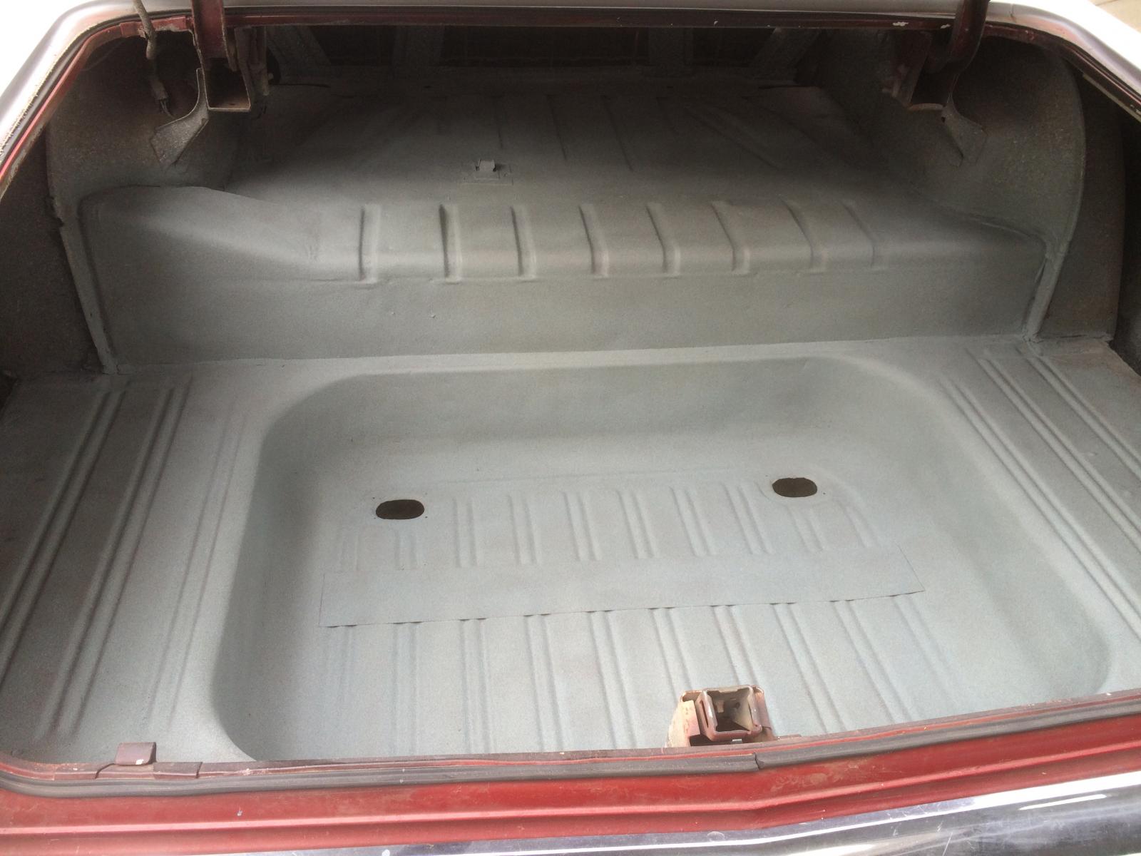

      Been a while since I've had time to do much work on her. Finally got some nice weather and a few free moments. I cleaned up the trunk area with a wire wheel and some Rust evaporator, then re sprayed with Rust-Oleum trunk liner Splatter Paint. Turned out pretty decent.
      Also replaced the old and finicky Rochester Q-jet with a new Edelbrock performer 600 w/ electric choke. Runs beautifully now, no more shooting starter fluid into the carb every time I need to start it.

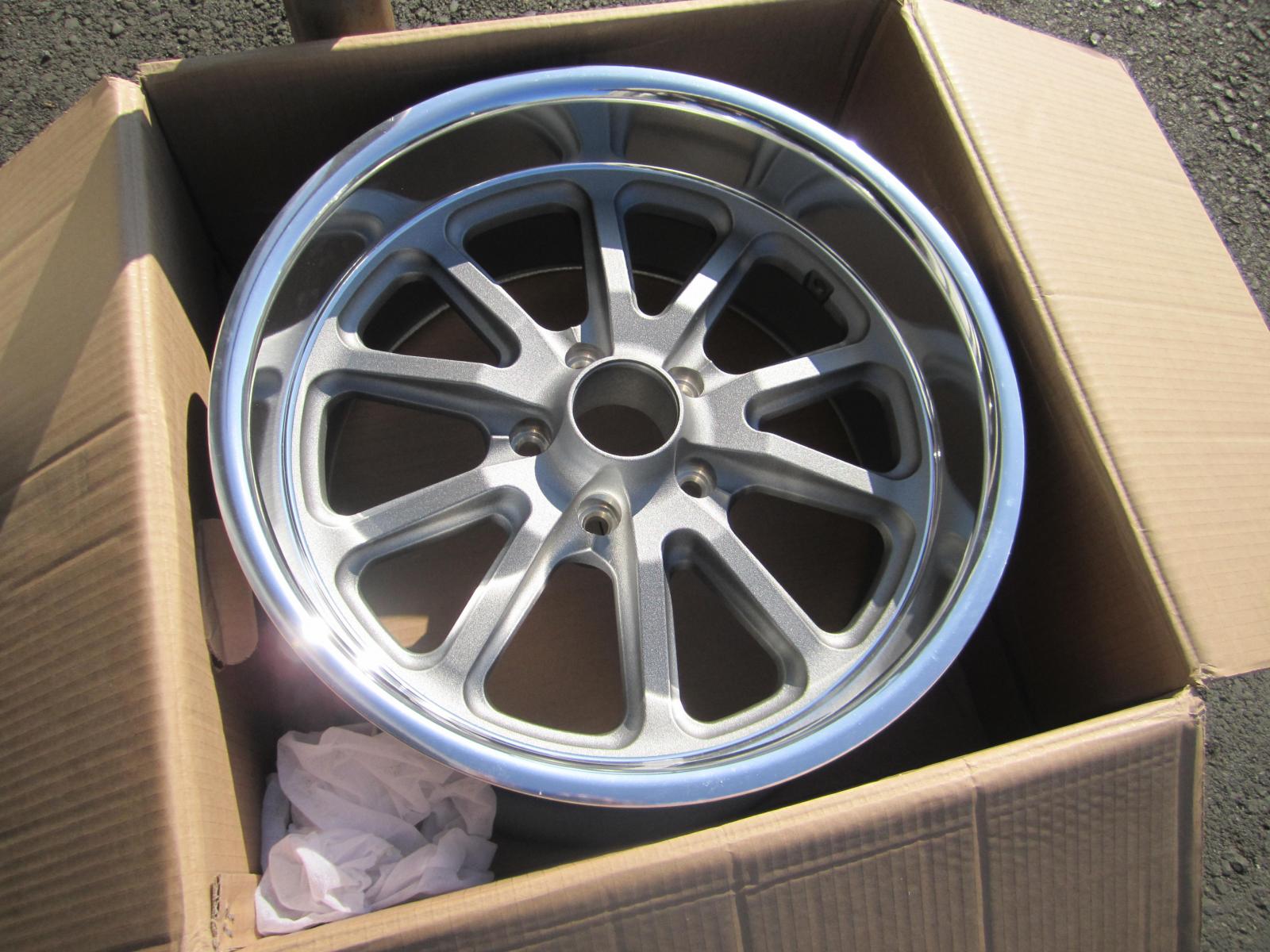

      New wheels and tires came in!! Went with the US Mags Rambler U111. 18x8.5 Front. 20x9.5 rear Tires are Sumitomo HTR2 225/45r18 Front 275/35R20 rear. Mocked them up and i am STOKED! i think they look amazing. Fronts fit and clear everything very nicely. Still waiting on rear rims to arrive, but the tires look MASSIVE!
Size:  217.9 KBName:  IMG_1913.jpg
Size:  206.2 KBName:  IMG_1912.jpg
Size:  155.7 KBName:  IMG_1911.jpg
Size:  164.6 KBName:  IMG_1910.jpg
Size:  152.8 KBName:  IMG_1914.jpg
      Aug 2016
      Penngrove
      61
      ok not really sure why it attaches ALL the pics, i only wanted the top 4... oh well... you get the whole lot. The Torque thrusts will be for sale very shortly if anyone's interested
