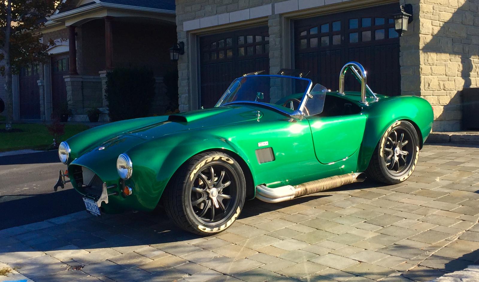

      Thought I'd start a thread on the Cobra. Factory Five Mark II. Since I bought the car ( as is in the before pic) I've made some changes and additions. It's now a FAST EFI fuel injected 306 putting about 310 hp to the tire on a 2100 pound car. Tremec 3550 with a 31 spline 373 gear posi 8.8 and Willwood brakes. It also got new 18" wheels and NT 555 G2's. 275 and 295. I'm in the process of installing a LaMans hard top that will be colour matched to the body.

      Rear and side glass is going to be Lexan with pop up vents that are 360 degree directional and can be opened or closed. That's what I'm working on this week.

      If I left the wheels and tires as I bought them vs painting them. Not horrible but no life I think.
      May 2012
      412
      How the top totally changes the look from being more centred with no top to being very rear weighted and slung back with the top.

      Once the top is painted, it will be completely different. Having a car be useful for more than 3 months is always good.
      Oct 2013
      H-Town, TX
      356
      The car looks a lot more modern- I'm really interested to see how the side profile changes with the top the same color. The wheels really make the color... if that makes sense?
      May 2012
      412
      Hey THANKS Andrew. Didn't make sense before.
      333
      These cars look cool with a hardtop. I'm not sure I"d paint it, the contrast of the two tone looks kind of cool.
      LIke you said it weighs the backend of the car visually and makes it look very sporty.
      May 2012
      412
      It is cool in a two tone because I think the tire lettering is kinda balancing it out. Don't know if it would look so good otherwise.
      May 2012
      412
      I think colour match looks great.
