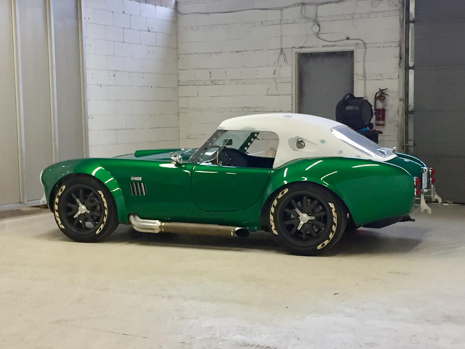

      Mocking up the new 4 point roll bar rather than the single hoop. Debating on chromed or blacked out. Never a fan of taking a hole saw to a nice paint job but it was worth it. I think it's low enough and has the right curves for the style of car. I'd hate the roll bar to look like it belongs on a pickup truck. It's still tall enough to save my neck if I go wheels up but I'd rather not find out.

      Done shaping and modding the top. Going to spray out the high build primer and block it ready for paint. Roll bar on a bit of a delay since I need to roll a slight curve to it and both chassis builders I know don't have a roller. Just benders. It needs to look right so I'm not going to rush it.

      Looks great Angelo, but I would seriously consider going white with the top.
      May 2012
      412
      Really? You don't think it would look better with the paint flowing as all one? What makes you like the white better? I don't exactly hate the white myself.
      Oct 2013
      H-Town, TX
      356
      I suggest going with one single color- I think the car will have awesome lines when you are done.
      May 2012
      412
      I don't hate the white but I'm not a two tone guy and one colour for the whole car does create some serious lines. Only thing that may go white is the gum-balls with the number 36 done in black.

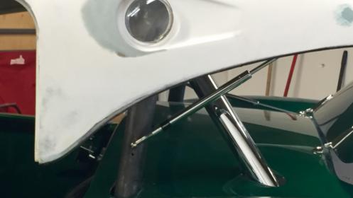

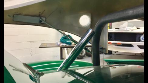

      Got the main tube made for the roll bar so I can move onto making and installing the custom brackets and dampers. Working out fine except the top is so light at 25 lbs. that I need softer pressure dampers. Not a big problem although working around this really nice paint has been.

      Angelo, I found this chart when I was doing the hood one the 51. It might be useful.
      http://www.fiero.nl/forum/Forum1/HTML/092437.html
      May 2012
      412
      Thank you. My supplier is looking into the carbon-fibre weighted ones for me.

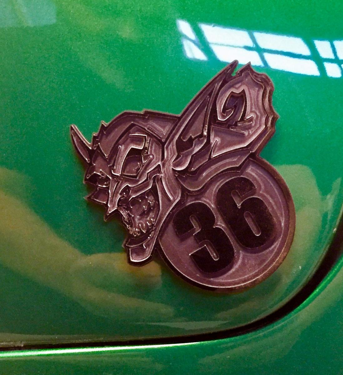

      Besides. My friend Marco and I chose to give the car an identity of its own and too much chrome wouldn't suit this character. This is a rendering of the piece that will be CNC'd and added to the lower corner of the trunk lid.
      May 2012
      412
      Pic
      May 2012
      412
      The actual acrylic piece before paint.
