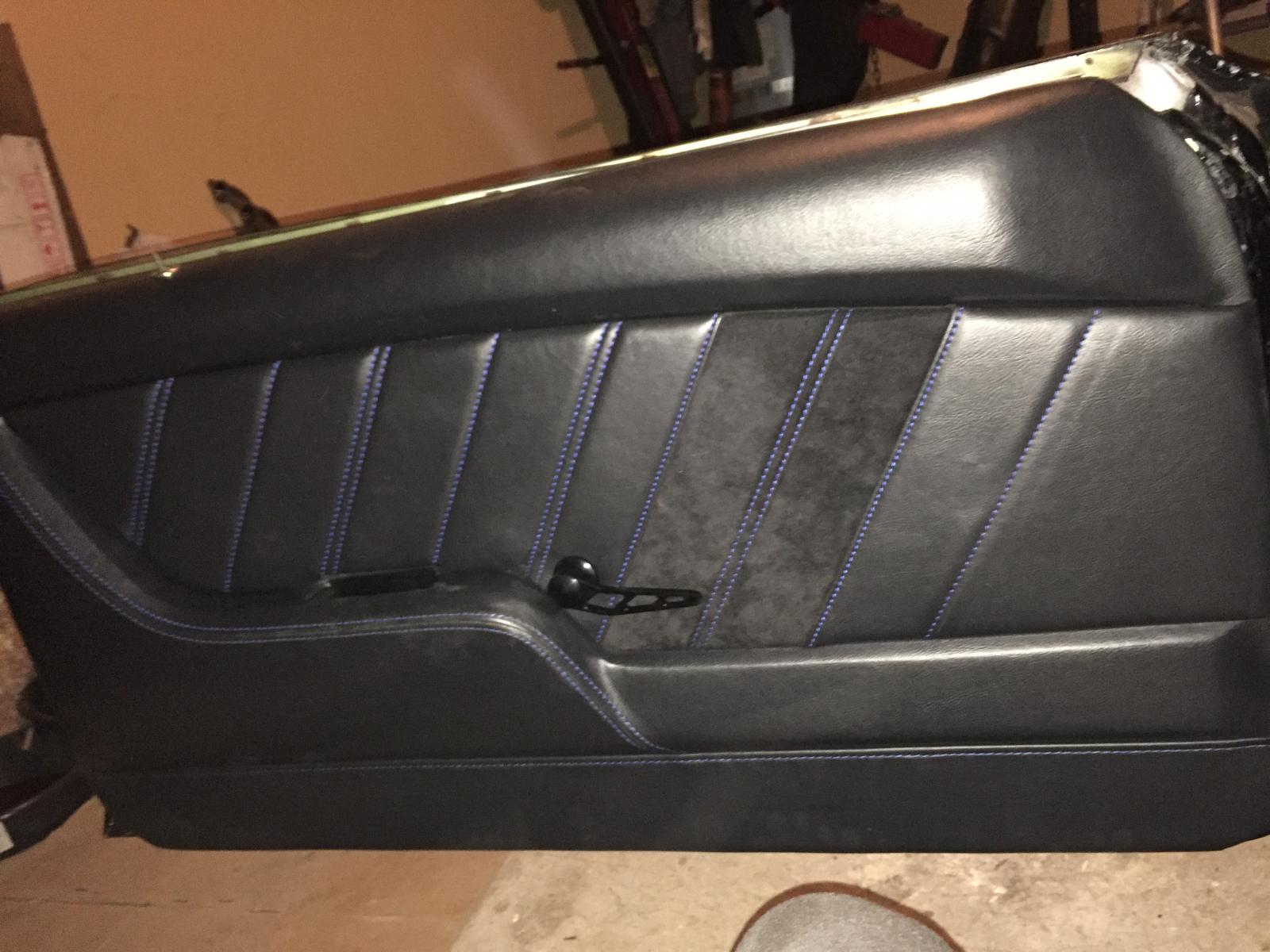

      I bought the 2go kit from digital guard dawg so I had to get power doors. I got one door done and put together with the door panels.

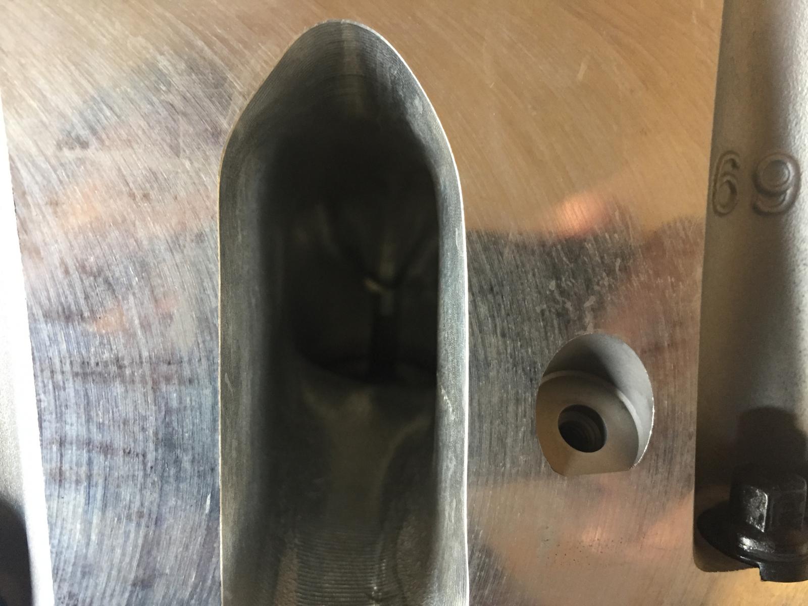

      Well I started driving my car around. Pulled my car out the garage last week and heard a clicking sound coming from the engine compartment. I revved the motor and the clicking got really loud and sounded like it was coming from the passenger side. I put the car back in the garage and started to check everything. The rockers weren't loose and rods weren't bent. I drained the oil and saw metal flakes so I knew I was in trouble. I pulled the oil pan off and saw this Name:  IMG_1252.jpg
      So I pulled the motor out the car to inspect the damage and quickly found out that I'm not a very good engine builder

      since I'm already here, I decided that I want to stroke this out or buy a stroker motor. So if anyone knows where I can buy a stroker short block (383) for a good price and from a reputable place let me know. Otherwise, I'm going to take it to a engine shop and wait 8 weeks for them to rebuild the short block for me.

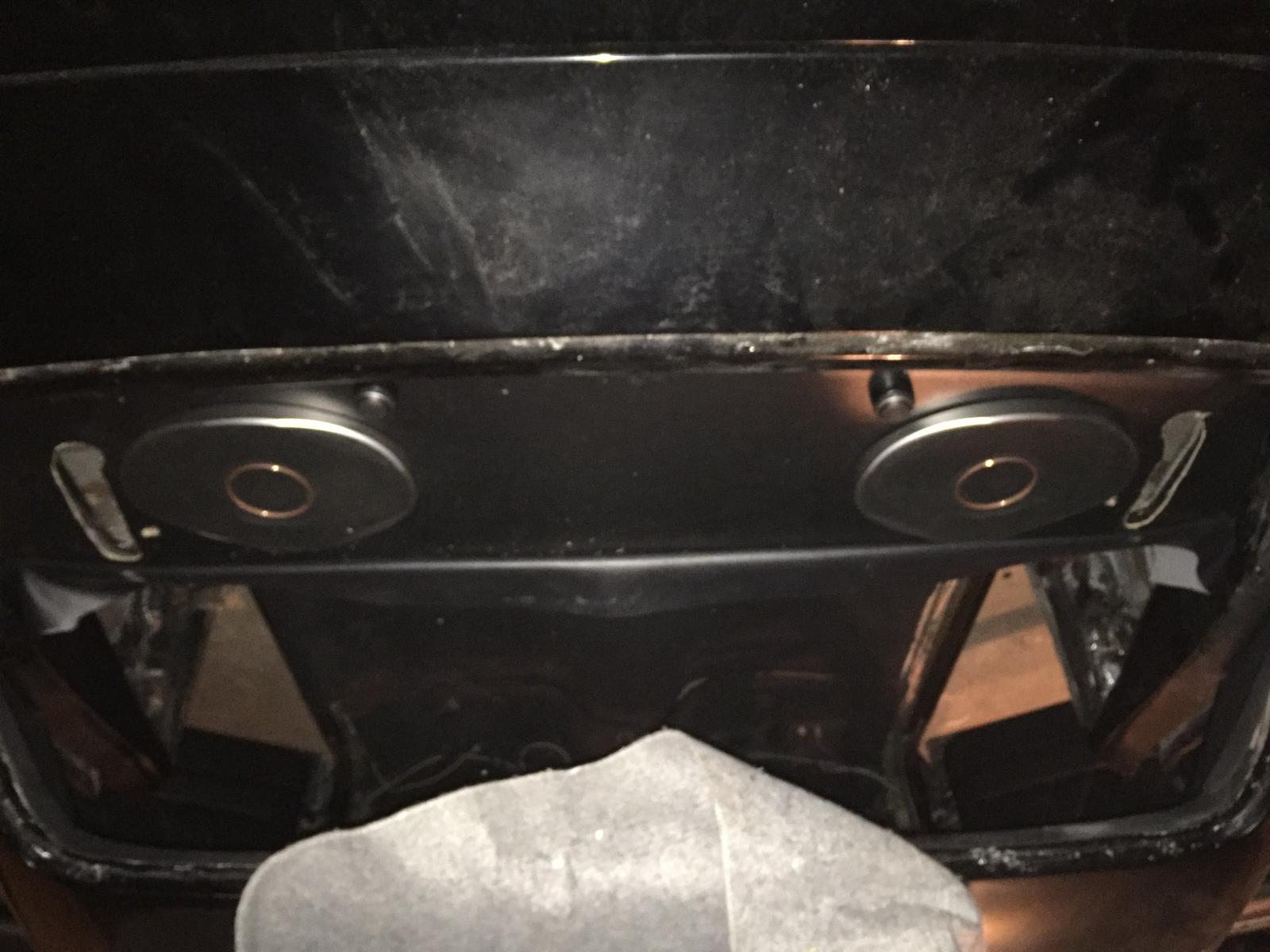

      So I've done a few things while I was waiting to get the new motor all put together. I put in my sound system. I put Infinity component speakers in the package tray. JBL two way speakers in the kick panels.

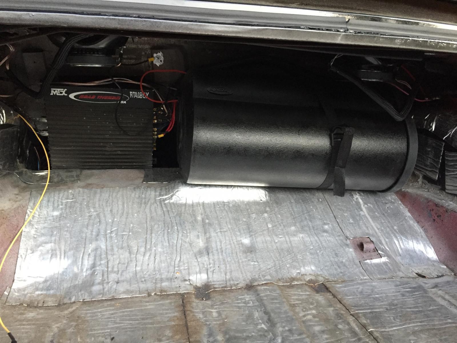

      I bought a bazooka tube to put into the trunk for bass. I got a trunk kit from tmi (I'll be putting that in last) some I wanted something small that would fit.

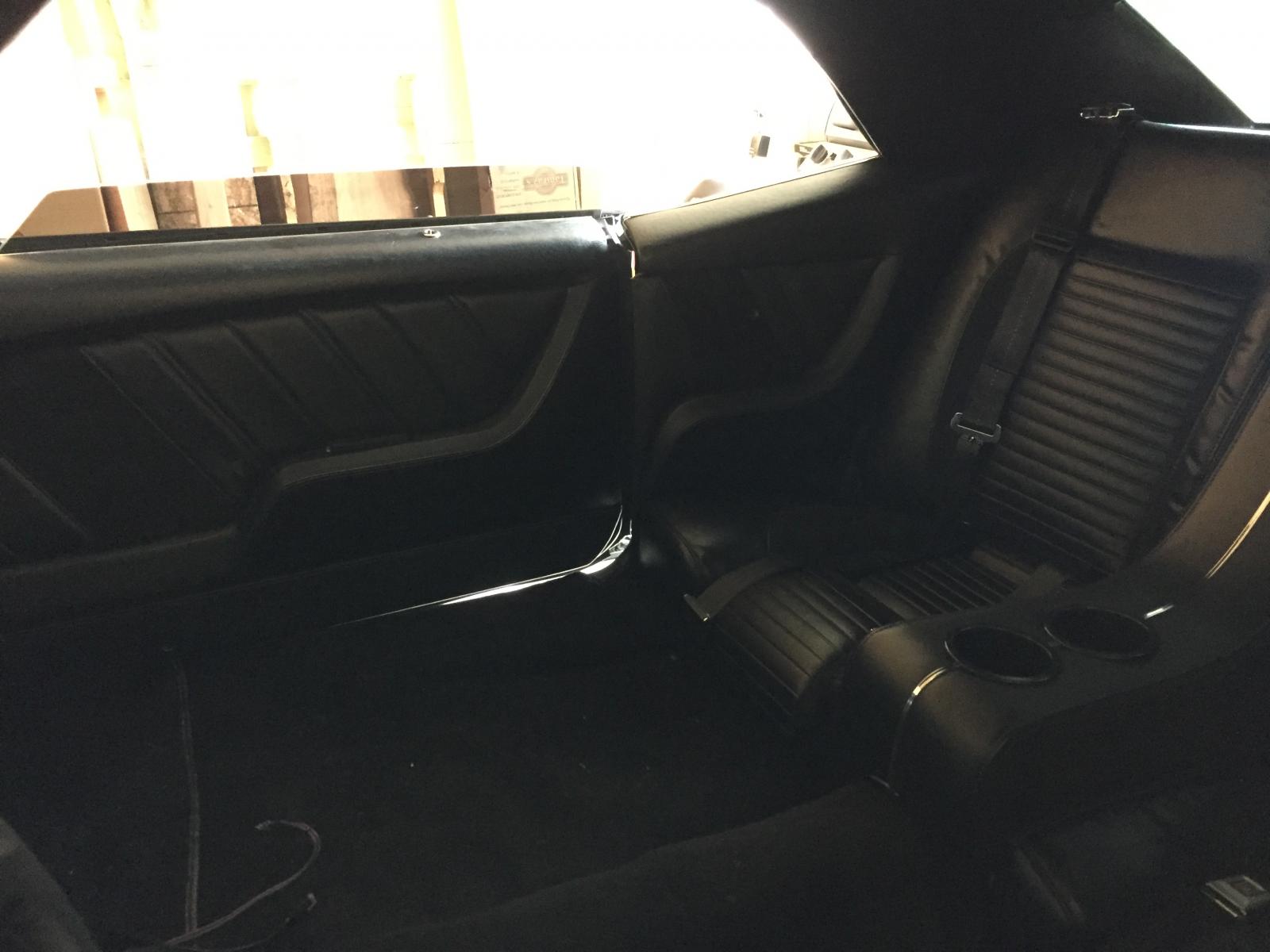

      Other than that, I’m finishing up the interior. I put the back seat in. I’m working on the dash and center console. I got a center console from a 2014 Camaro zl1 off eBay. I’ve seen a few people use these on the first gen f body and it’s working out so far with little modifications. These are so in progress pictures.
