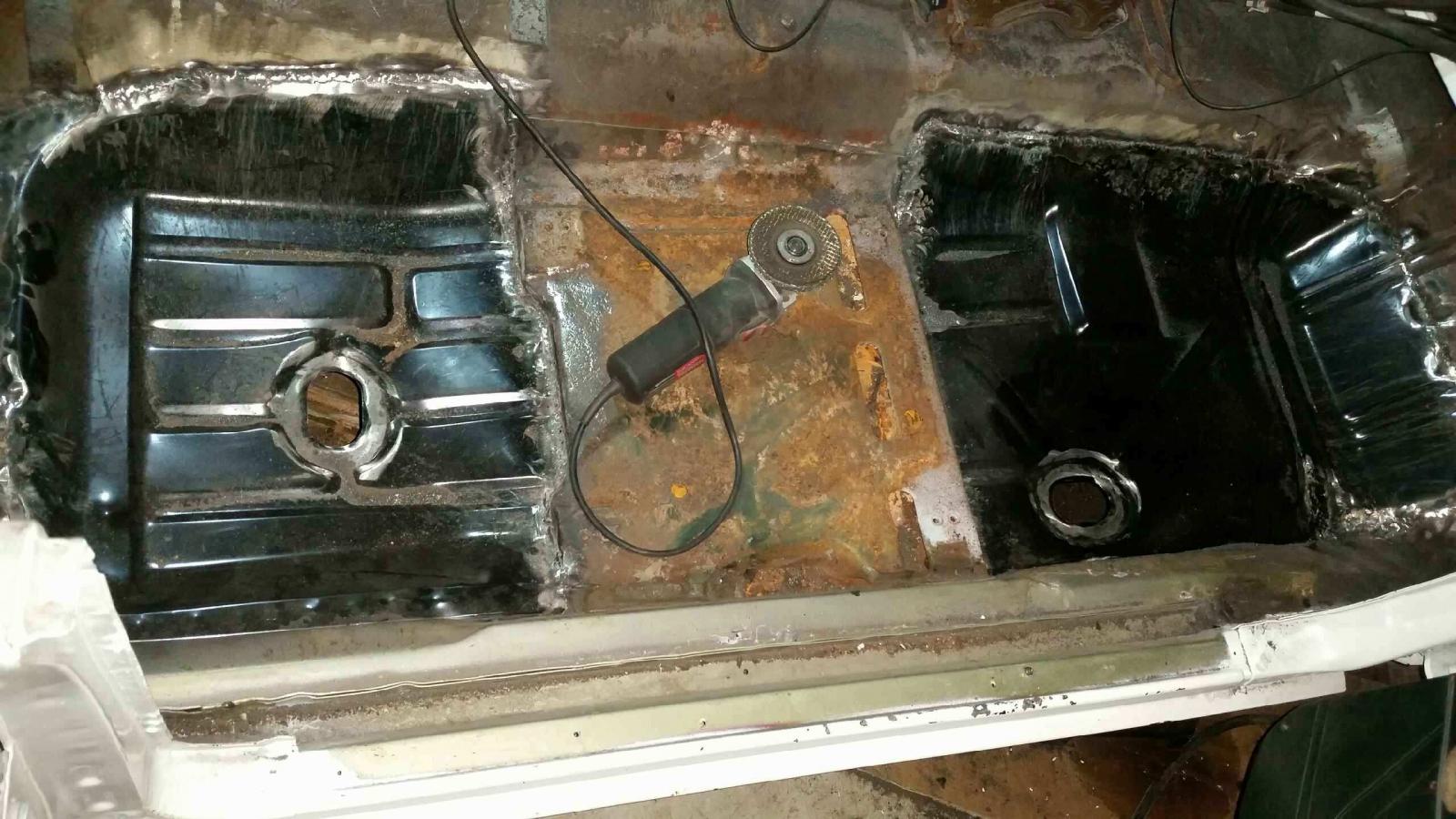

      Apr 2016
      Fairfield, Ca
      35
      the floors were rusted so I replaced all 4 floor pans. If the welding doesn't look great, that's because it was my first time welding. I taught myself how to weld on this car. YouTube videos is how I got my ideas.

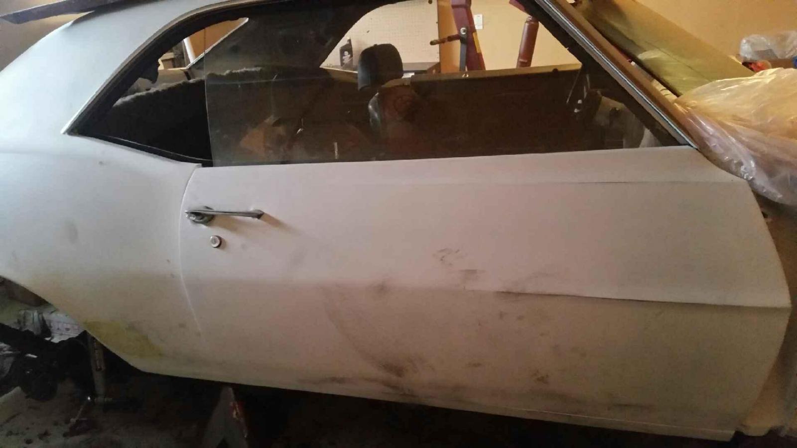

      This is how the body looked when I bought it. It did not have any rust or dents.

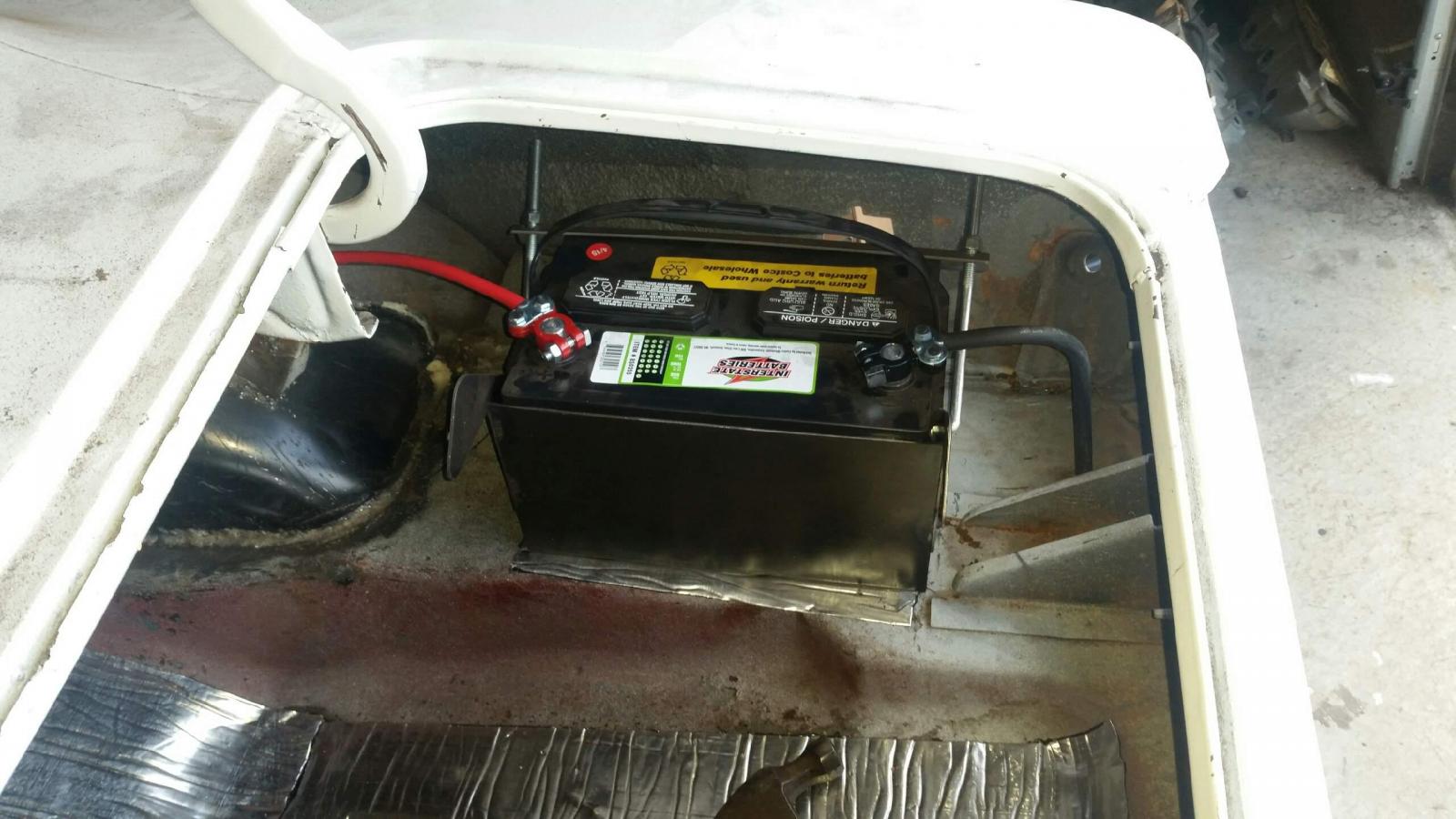

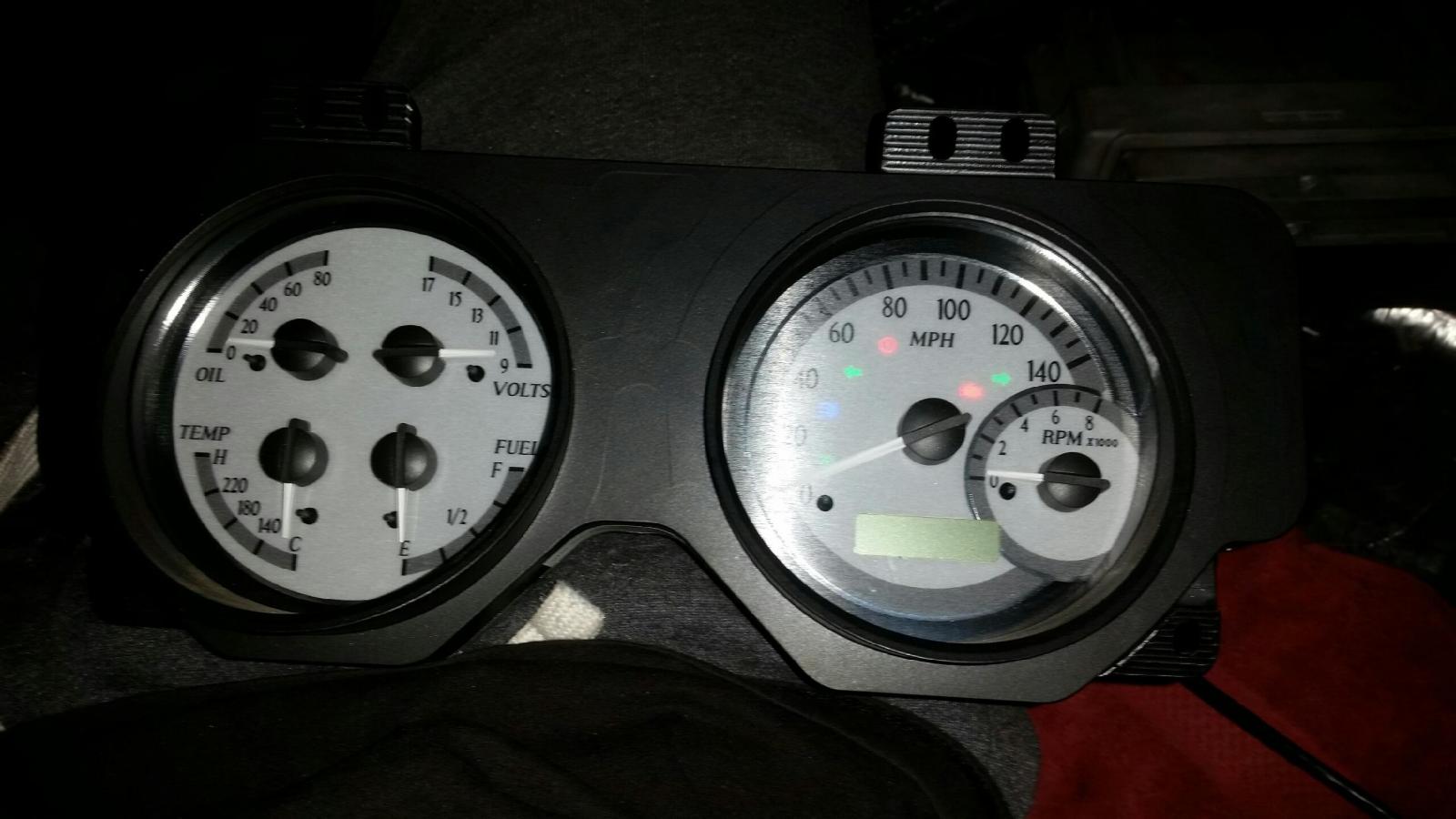

      Apr 2016
      Fairfield, Ca
      35
      I put the battery in the trunk with lots of help from people on this site since wiring. Wiring was so intimidating, but American Auto Wire made wiring super easy. I had no clue on how to wire anything but their kit was as plug and play as it gets. I got my first taste of excitement when I saw the gauges actually working. Dakota digital had great customer service as well. They sent me a kit without the two push buttons and they shipped them to me free of charge with no questions asked.

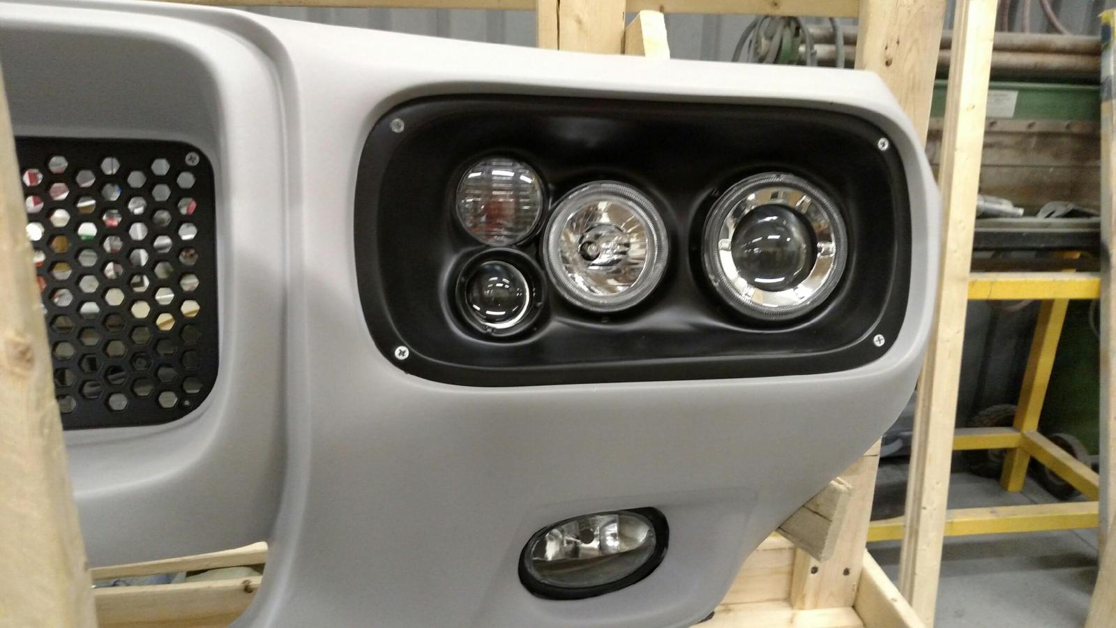

      Apr 2016
      Fairfield, Ca
      35
      I got a complete front fiber glass piece from Josh at Zinger customs. Josh was super down to earth, gave me updates continually, and even sent me pictures of the progress. I must say it was hella high quality work. I know nothing about fiber glass, but I have a close up picture to show it looks real good. Stevie wonder can see its good work. I can't wait to put this bad boy on the front... it's going to set it off!

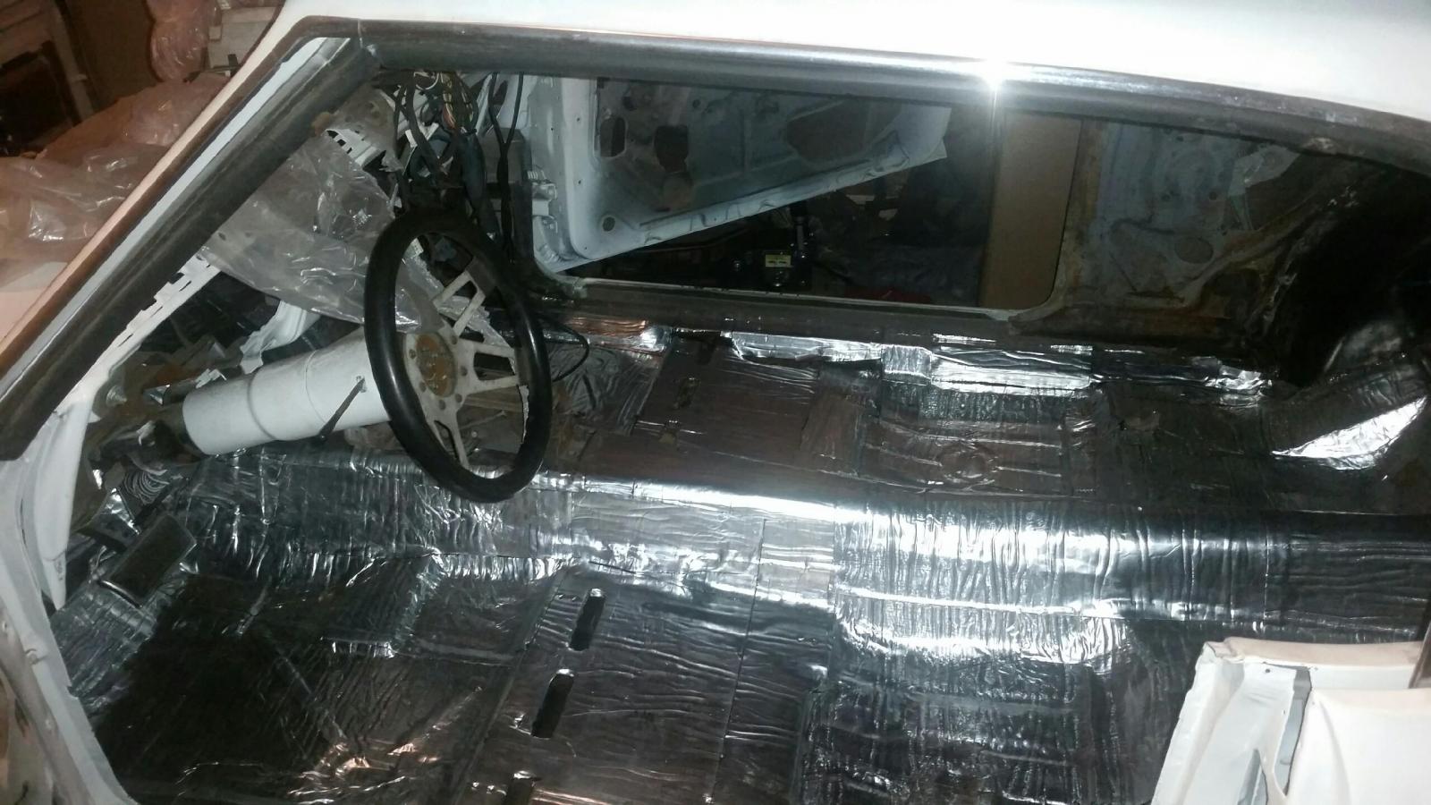

      Apr 2016
      Fairfield, Ca
      35
      And this is how she looks right now. This was the first time I sat her on the ground. I wanted to put her lower to the ground but the front fender wouldn't fit over the tire. I know there will be more weight on the car once I put all the other stuff on it; I just put the fenders on the car without fitting them on there so I'll wait to mess with the stance. Thats how she looked before I sent it into paint.
      But damn she looks good!

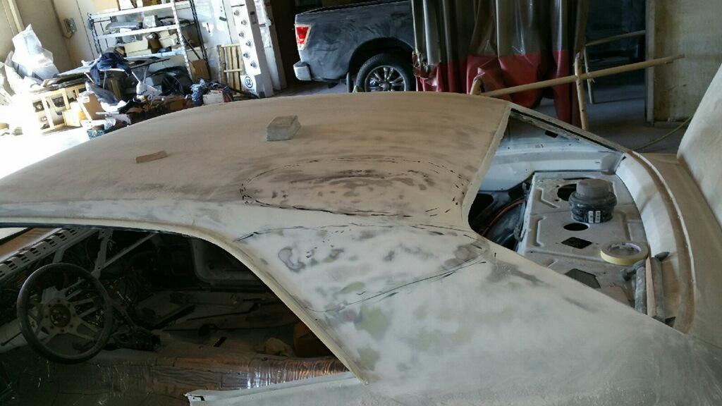

      Apr 2016
      Fairfield, Ca
      35
      This is how she looked the last time I seen her. No rust underneath the white coat so I'm still on schedule. She should be out of paint at the end of May or the beginning of June.
