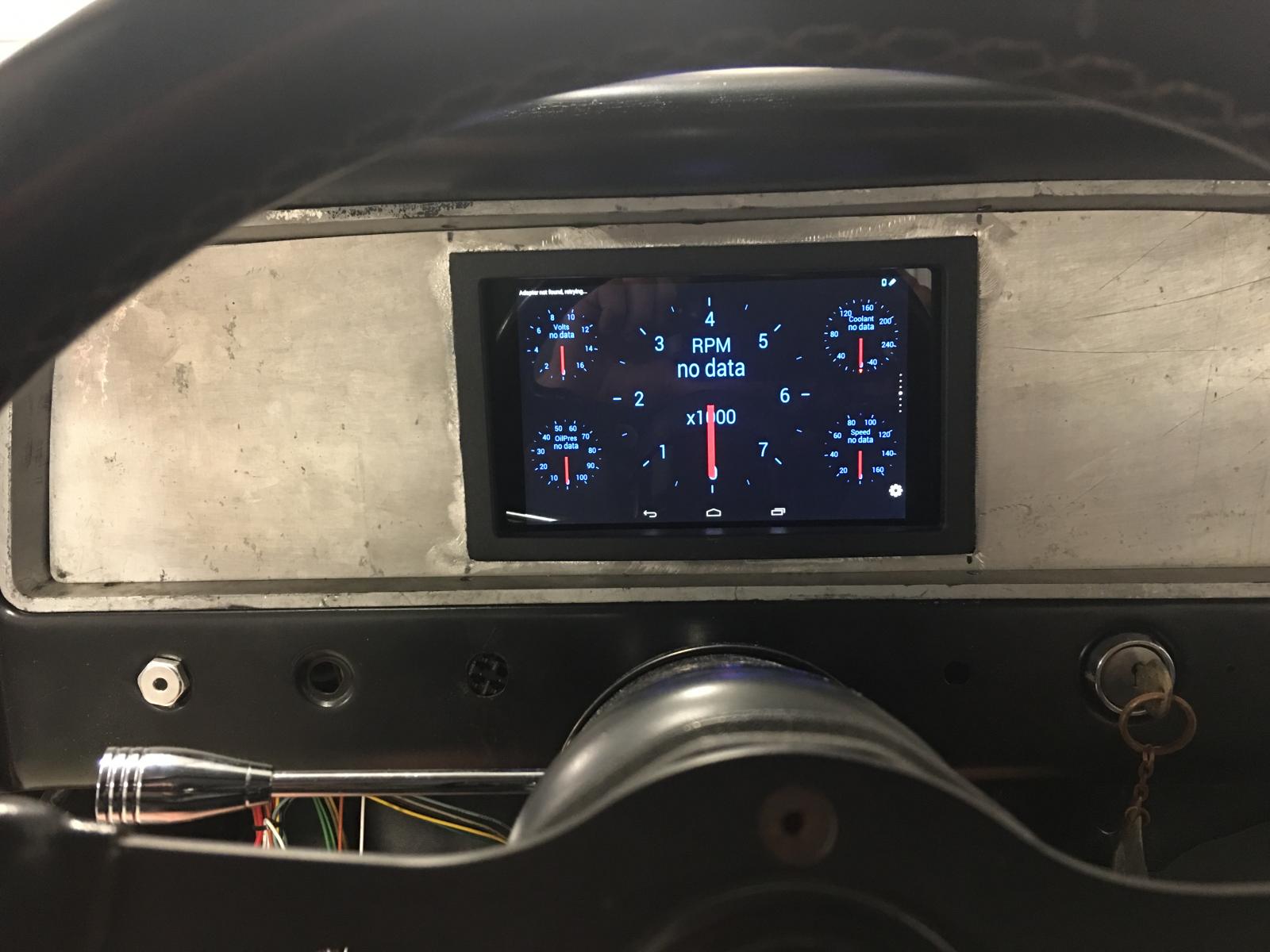

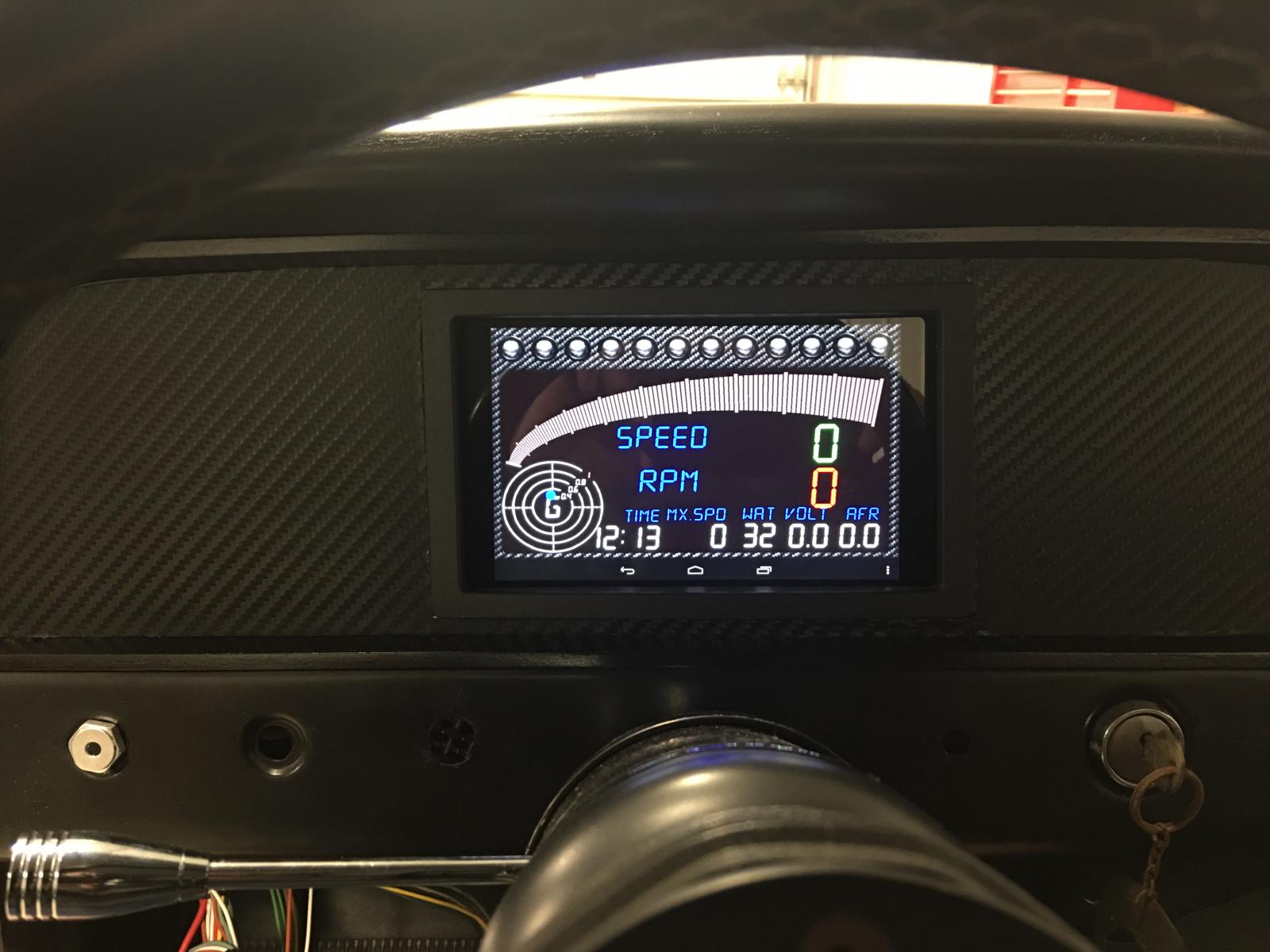

      Getting closer, interior is Raptor Lined and put the original floor mat back in. Installed the No Limit fuel tank which is a super nice piece. Grille and front end parts are just on for wiring. Using a universal kit. I'm building a gauge panel out of aluminum that will hold the tablet to display gauges from the OBD port. Super cheap and works like a Racepak.

      What brand gauge app is that? And what tablet?

      Quote Originally Posted by Dmoen View Post
      It is a Nexus 7 tablet using the Torque App and added on the Racing Dash Plug in. The round circles on top of the screen change colors with RPM's. You can literally set anything you want that comes from an OBD port. I have a Bluetooth OBD plugin that connects with it.

      Thanks, trust me I would much rather have that autometer dash but trying to somewhat keep this truck "cheap" tough to run my car and the truck at the same time at all the events. Here is the dash I just somewhat finished tonight. I'm still not sure if I'm going to add any gauges to the sides of the tablet or not.
      I used a double din radio mount and made an aluminum plate to mount it in. It should work well.

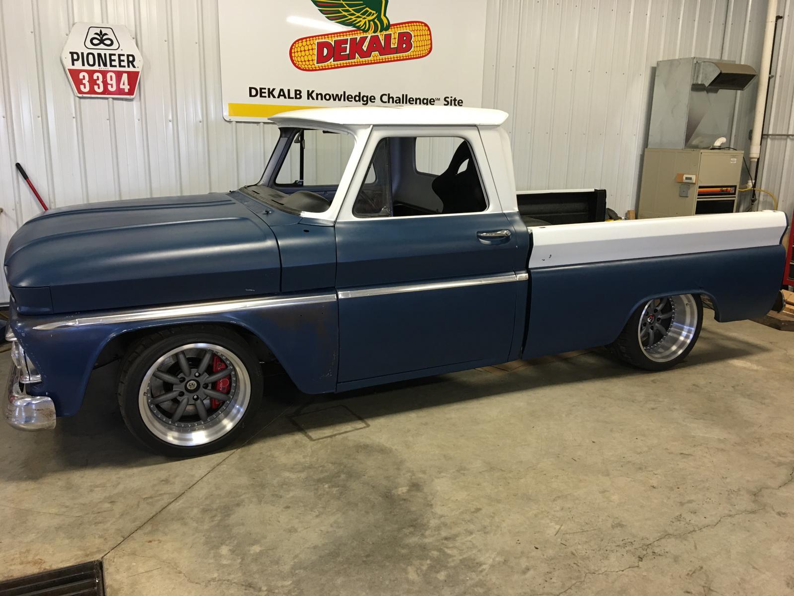

      66 GMC Build
      Wheels are finally done, should be driving soon!

      Mar 2000
      San Diego, CA
      339
      Looks awesome. Love the wheels.

      Very nice.
