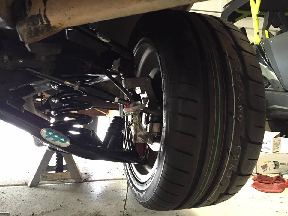

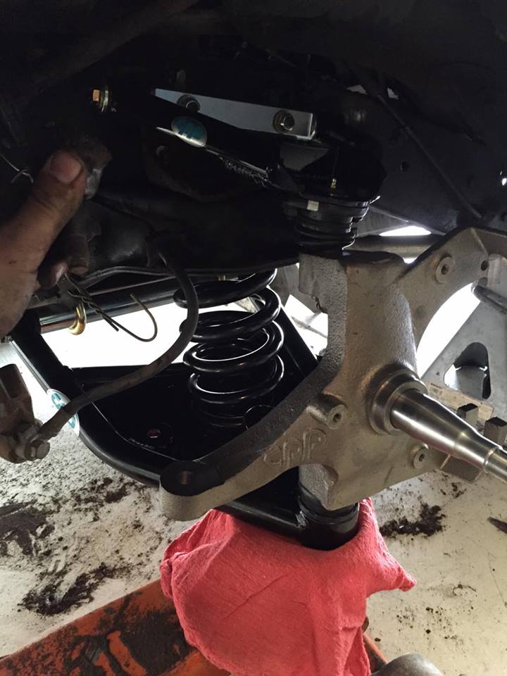

      Suspension, I went with cpp for the suspension, I really liked their stuff so i picked up upper and lower control arms, Drop spindles, drop springs, sway bars (still waiting on the rear) tie rods, and some other small stuff, everything bolted on easily, but i am still waiting on my shocks as well, i ordered HQ adjustable shocks from ride tech. As for the rear, as of now im just doing the rear sway bar, shocks and i am keeping the leafs on, yes i know leafs are not ideal but i thought id like to try it before i go throw money down on trailing arms. Ill also be putting a fuel cell in the rear rails of the truck and getting the one out of the cab, battery will also be placed in the bed/ under the bed to help get some more weight to the rear on the truck,

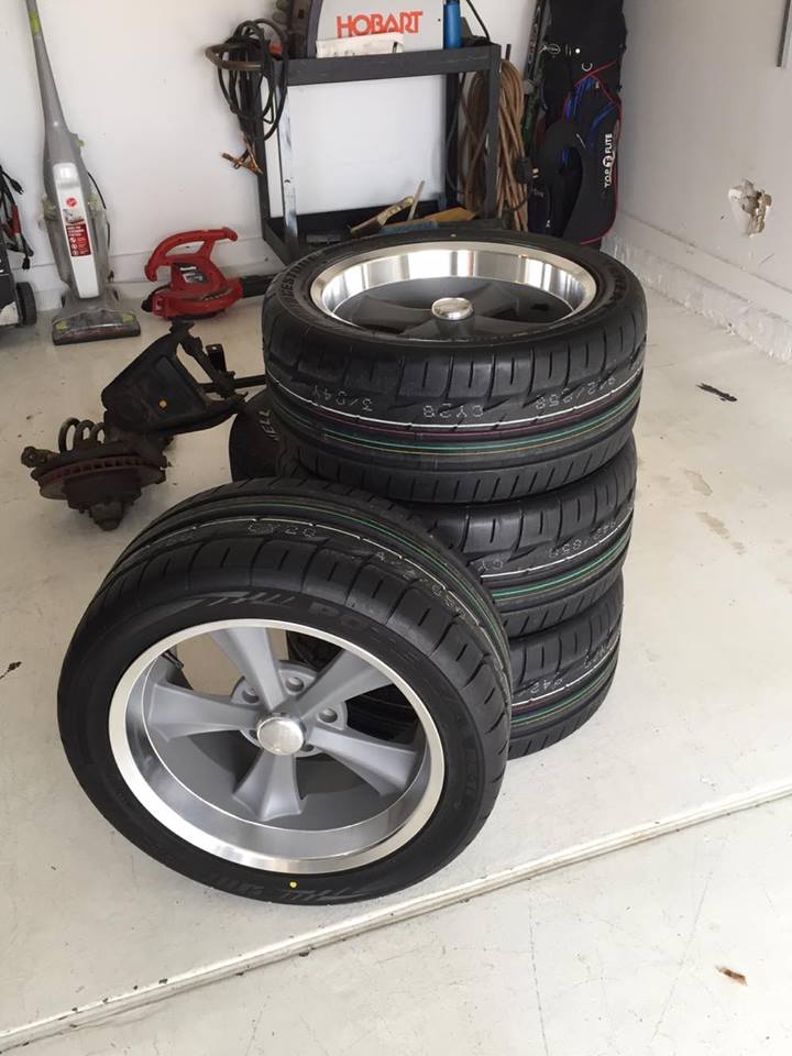

      Wheels/Tires, i went back and forth and back and forth and couldnt see myself throwing down the cash on forgelines at the moment. so i went with rocket booster wheels, i liked the look and i heard that for the price they are a really good wheel, i went with a 18x9 on all 4 corners, with a 5.25 bs. Tires, Bridgestone Potenza RE-11, kept hearing great things about the tire and wanted to try it out, they are a 200 treadwear tire, almost went with a cheaper nitto invo but i know the softer tire will benefit me in every way. went with 275/40-18 on all 4.

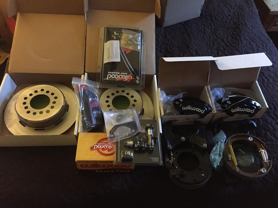

      Got my rear brakes in, as well as proportioning valve, lines and fluid. just waiting on funds for my Lsd and axles.

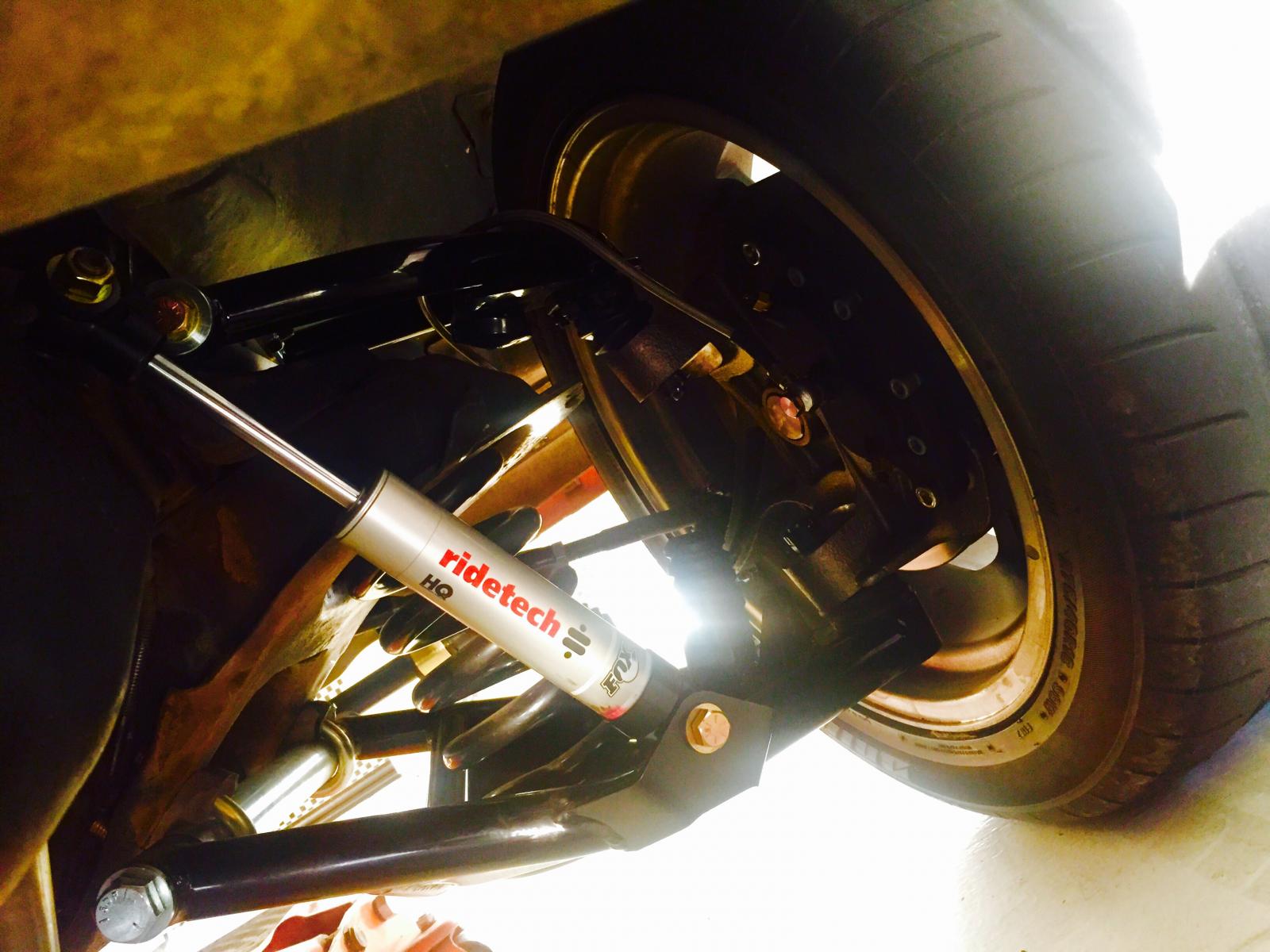

Size:  245.8 KBName:  image.jpg
Size:  170.3 KBGot my shocks mounted and went and put them to work this weekend. Love them, i was told after beating on the truck to re torque the upper control arm shafts. they were right, they were super loose, i couldnt find any torque specs so i went off the stock specs, 70ft lbs, does that seem high to anyone?

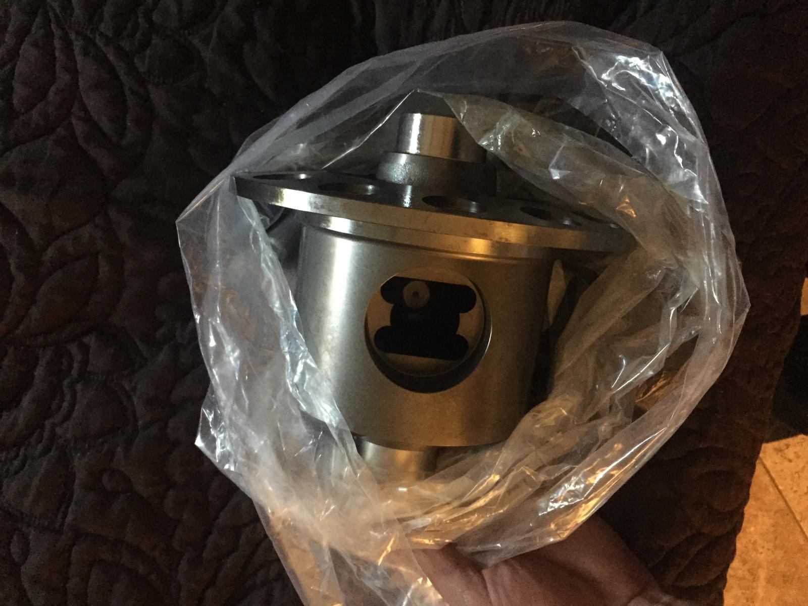

      Finally got my trutrac. Gearing is the next obstacle, I'll be running a 400hp sbc with a 700r4 on a 18" wheel with a 40 series tire of anyone has recommendations. I decided to pull the old 350/th350 this weekend and to start degreasing and undercoating the frame and under the body. The rear end is going off to get the ring and pinion installed soon. I will more than likely be running the stock axles seeing that I won't be making any crazy hp. I also got my shock brackets for the front from cpp. Name:  image.jpg

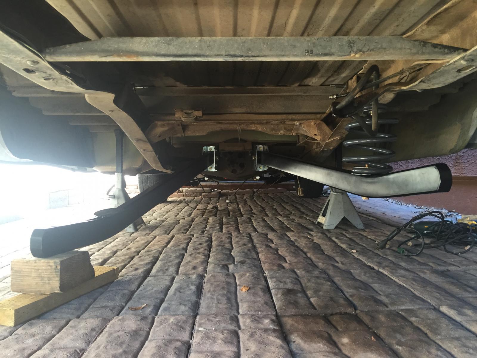

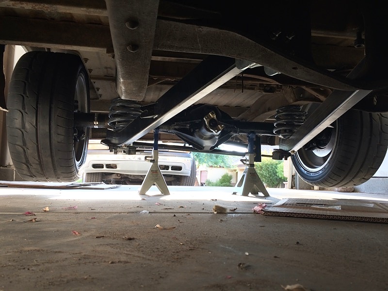

Size:  228.5 KB got early classic trailing arms, installed hotchkis springs front and back and got adjustable trailing arm mounts. Just waiting on 2 more spring retainers.

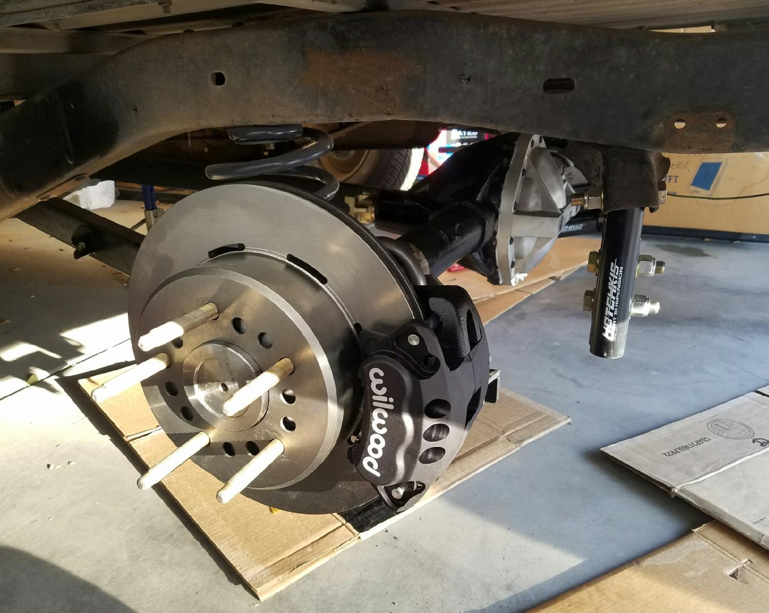

      Alright guys sorry ive been away for awhile, i have got alot of stuff done on the truck.
      I contacted Ron Sutton to build be a brake package that can be used on a road course as well as be able to compete in autocross and still be used on the street He created a good set up that i like that utilizes the stock front rotors and can use most of my parts i ordered for the rear . I ended up getting rid of my D154 calipers that had the two smaller pistons because of their lack of clamping force. So i ended up Getting
      -Wilwood D154r calipers for the rear (Has one 2" piston opposed to the two smaller pistons)
      -Wilwood BP20 Pads (for Road course)
      - Wilwood 7/8 tandem M/c
      -Wilwood Pushrod kit
      *He recommended The "E" pad for autocross, I didn't purchase this yet, before i go to good guys i will get a set.
      Ron is a very Knowledgeable source when it comes to anything on from purpose built track cars to street cars. I do not hesitate to take any of my question to him.

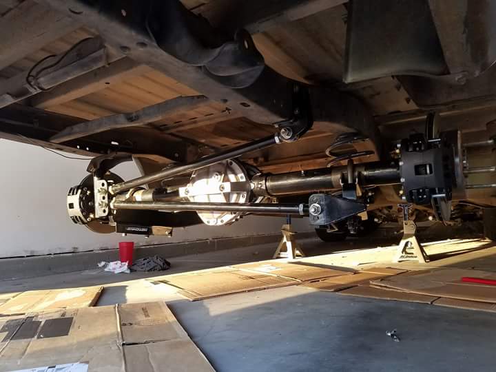

      I finally had my 12 bolt built. I took it to a local shop that did an awesome job on everything, i ended up having the trutrac installed, gears, 1350 yoke, bearings and new axles with arp studs with a moser girdled cover.
      I ended up getting rid of all of my cpp stuff, i wasnt too happy with it. So i ended up getting all hotchkis components to make a complete TVS kit. Upper and lower control arms, springs, panhard bar, sway bars, shock mounts, center link and tie rod adjuster. I didnt get their shocks because i already purchased ridetech HQ's which i will get Ron's "secret sauce" valving once i get the engine and transmission in.

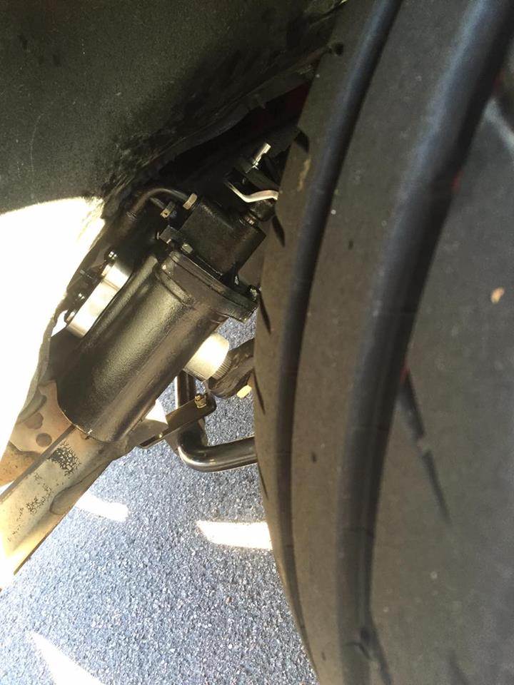

      Thanks guys!Name:  FB_IMG_1470617890754.jpg

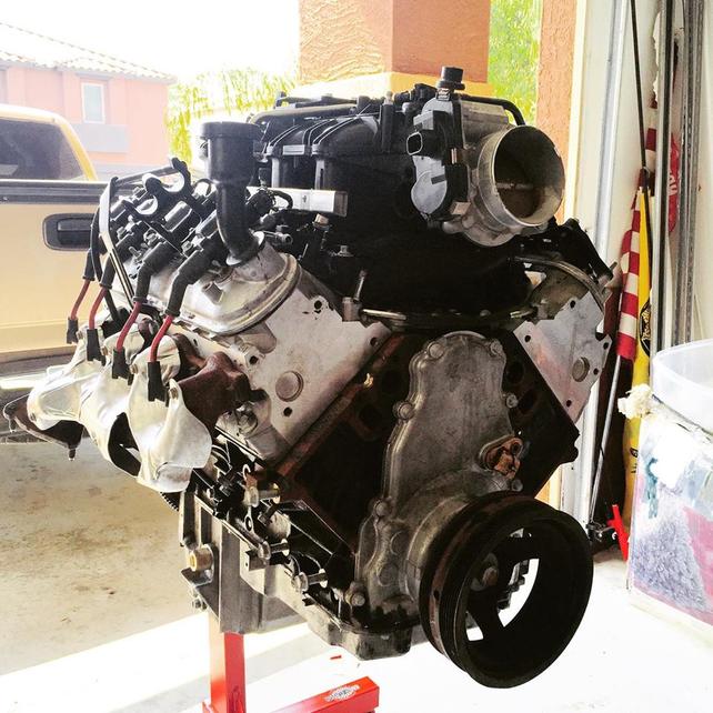

      I picked up a 2008 5.2 with 70,000 miles on it, it already has 243 casting heads and a good intake, its going to get rebuild along with getting the heads ported and a custom grind cam when the suspension and brakes are finished
