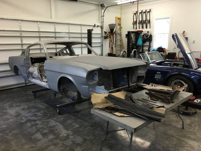

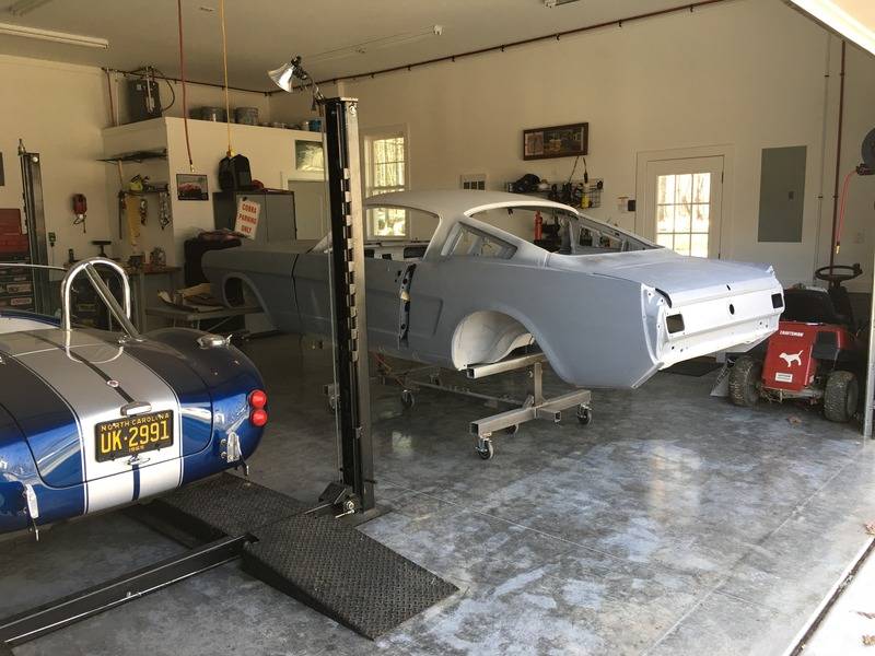

      Car was delivered today...some pics of my starting point.
      The other car is my Factory Five Cobra Replica. With a 347 stroker, it's a rocket ship on 4 wheels.

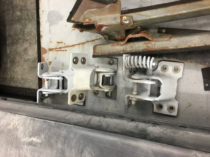

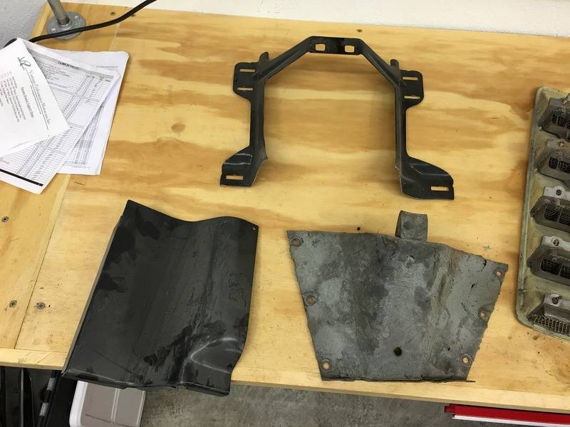

      Here are some pieces I found in the car that I can't figure out where they go. Any ideas?
      What are the hinges for?

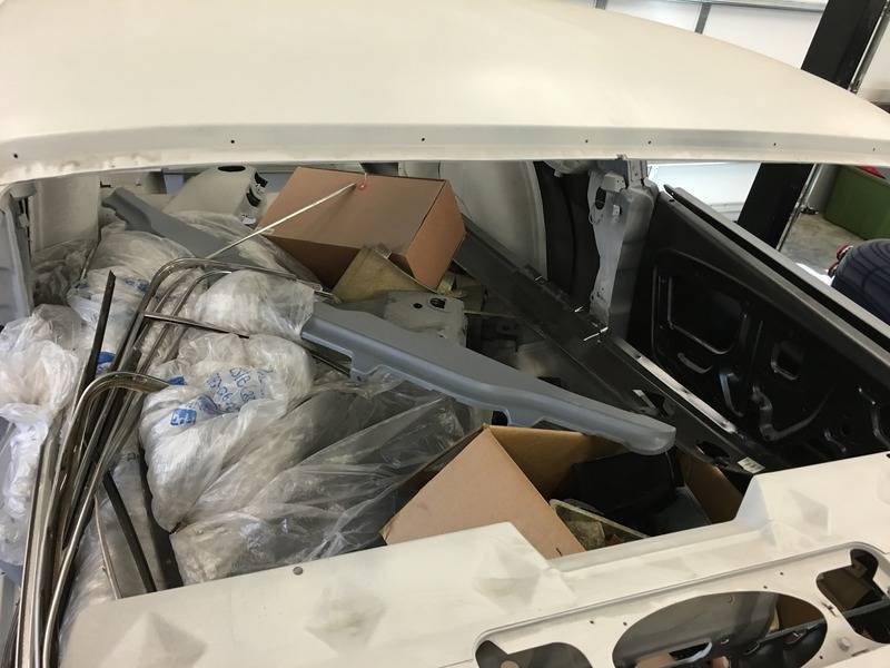

      From what I've read online, Fastbacks didn't have torque boxes installed from the factory. I'm probably going to do a 4 point roll-bar in the cab. Do I need to install torque boxes or would it be overkill for a street car with moderate power (probably 350hp max at the rear wheels)?
      This is inside the driver wheel well.

      Hinges may be extras we had or came off of one of the other tear downs

      Quote Originally Posted by funbnme View Post
      The piece in the lower right:
      is normally found under the front fender and serves as your front bump stop on the stock suspension. It covers the spring as seen here:

      Thanks...I do have two of those. I thought they were bump-stops but didn't see where they bolted in. The picture helps a lot. Will have to see if I use those when I get the aftermarket stuff installed.

      The part on the lower left is a replacement rear torque box top. The middle top piece is a mystery piece, haven't seen that one that I recall.
      The plug weld spacing on your seat riser would need to be between 1.5" to 1.75" apart, as needed. The factory had diagrams to go by (which you can buy) and spot welded them in the general locations, approximately. Drill 5/16" ish holes as it is a little thicker material than other locations.
      Torque boxes would be a fantastic upgrade and will add noticeable torsional stiffness to your chassis. With your planned 4-link and coil over conversion I would suggest installing convertible inner rocker panels as well. These tied into your 4 point bar would stiffen up the "wet noodle" chassis even more allowing your new suspension system to work even better. Any bracing installed into the platform will help, in the right places.

      i put torque boxes in my coupe on both sides, plus frame ties and a rear rollbar. Cant go wrong making it as stiff as possible while you are in there....

      I would always add torque boxes! By the "64.5-66 mustang weld and sealant assembly manual" . It will have all the weld points in it!

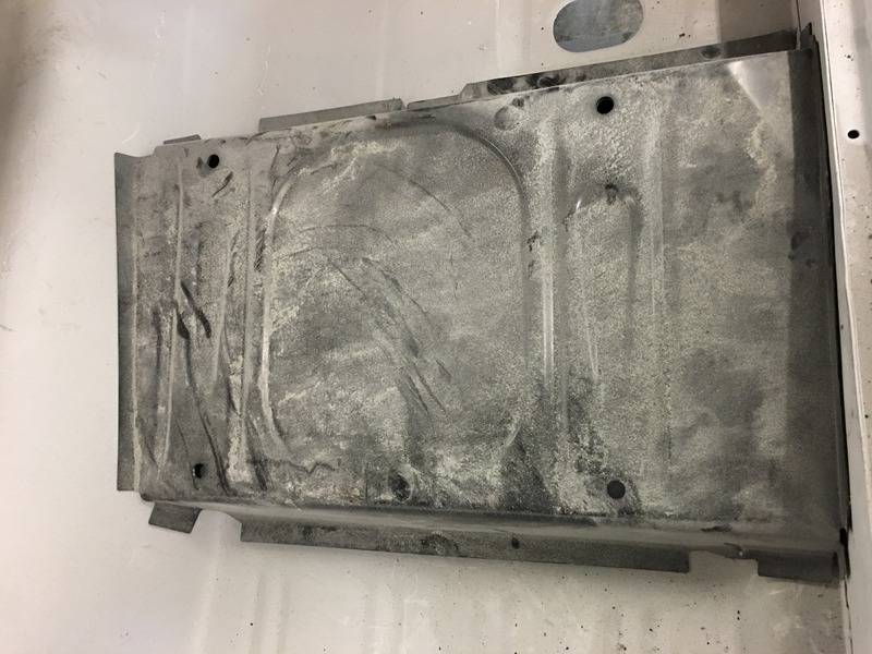

      Also spent the weekend getting the seat risers to fit and prepped for welding. I had to do a good amount of adjusting to get the driver side to sit flat on the floor (picture not shown), but it sits nicely now. Have them held in place with some sheet metal screws now (just a couple on each edge).
      Just waiting for the weld-thru primer to arrive and then they will go in permanently.
      Anyone know what gauge metal the seat risers & floor are? I have a sheet of 22 gauge I picked up at the store so I can practice plug welding...does that seem like a good piece to use for testing?

      The seat pans should be in the 14-16 gauge flavor. Depends on the quality... Before you weld those in you should look into getting a one piece seat pan for the coupe/fastback. It will add tons of support and stiffness to the car.

      I agree with 1967marti! Go with the one piece seat base. It will add a fair amount of strength to the build. Use the torque boxes and frame connectors.
