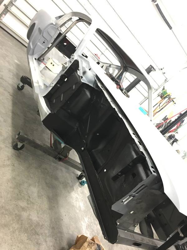

      Nothing major to report…the front & rear suspension pieces arrived. I'm finishing up welding some things on the front of the car…then I'll seam seal and put berliner (or something similar) on the inner fenders.

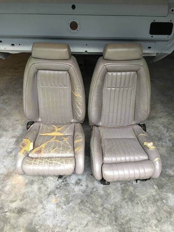

      I was surfing craigslist today and found a pair of fox mustang seats. I figured I'd pick up the seats because I could put them in and then mark where I want the seat belt harness bar to go. They need to be recovered, but the foam is in good shape.
      Where do you find reasonably priced upholstery for these seats?
      At most of the places I'm finding online, they sell TMI. I'm sure the quality is good, but I'm picked up the Fox seats mainly because I thought I could save a few bucks. By the time you buy the TMI covers and pay a shop to put them on, I could have bought ProCar or similar seats ready to drop in.

      You could always install the TMI covers yourself to save on the install. It is not too difficult of a job, just time consuming. Here is a video of guys installing TMI stuff on an early mustang seat. https://www.youtube.com/watch?v=Bc7xKc6A2T4

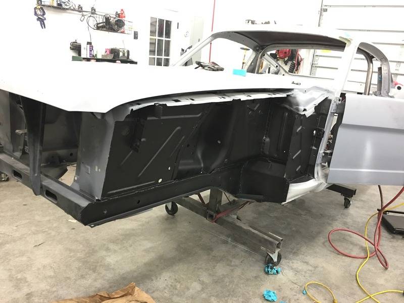

      I finished welding and seam sealing the front end, so I used some bedliner on the inner fenders. This will give it better long-term protection from the elements and add a bit of sound-deadening to the sheet metal (not that anyone would really be tapping the inner fender from the engine bay side.
      I did this part now so I can mock up the front suspension and leave it there when I eventually get the car on the road and drive around in primer for a while (before I tear it down for paint).

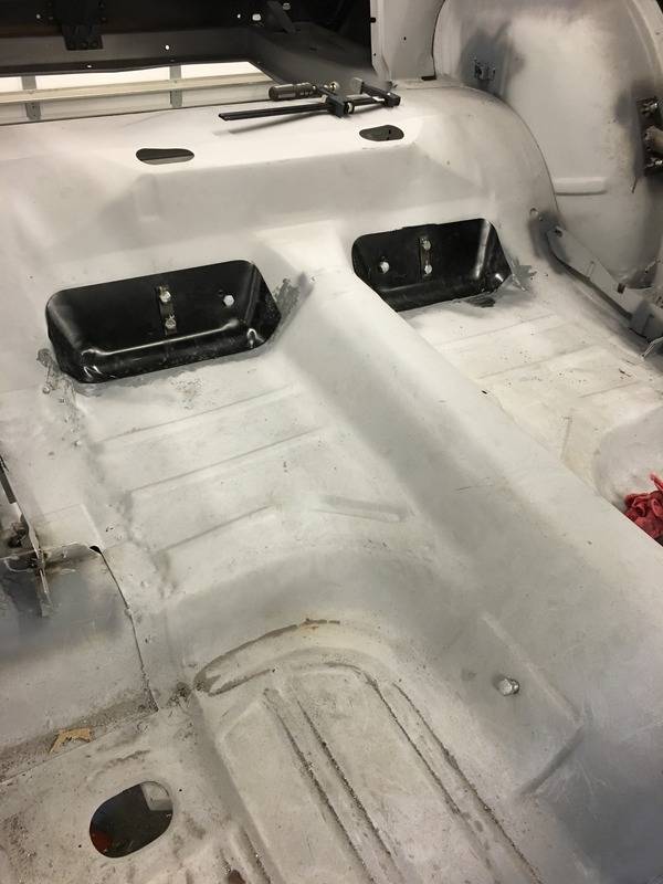

      I'm still not sure if I'm going to do a side or rear exhaust, so I figured I would put the floor reinforcements in place just in case I go out the back. It's a lot easier to get these in now before I spray sound-deadener on the floor.

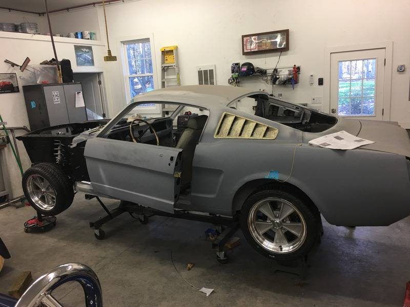

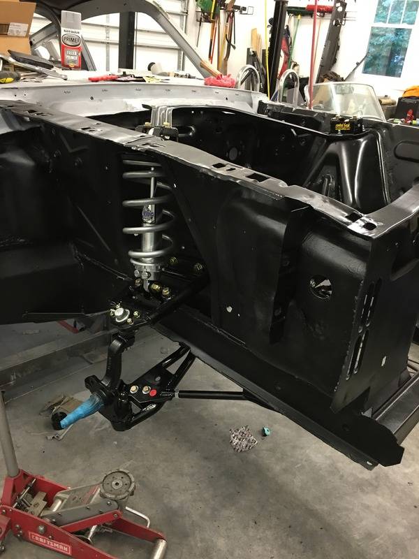

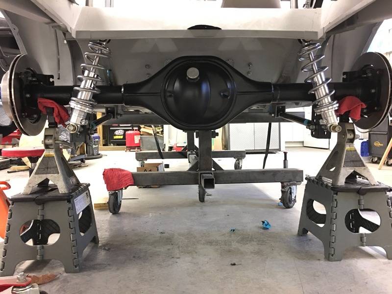

      Got the front & rear suspension installed.

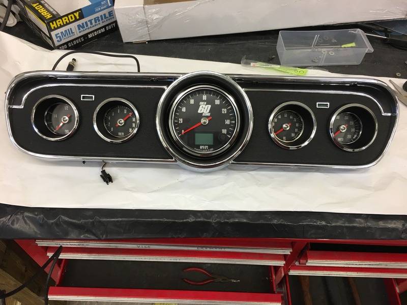

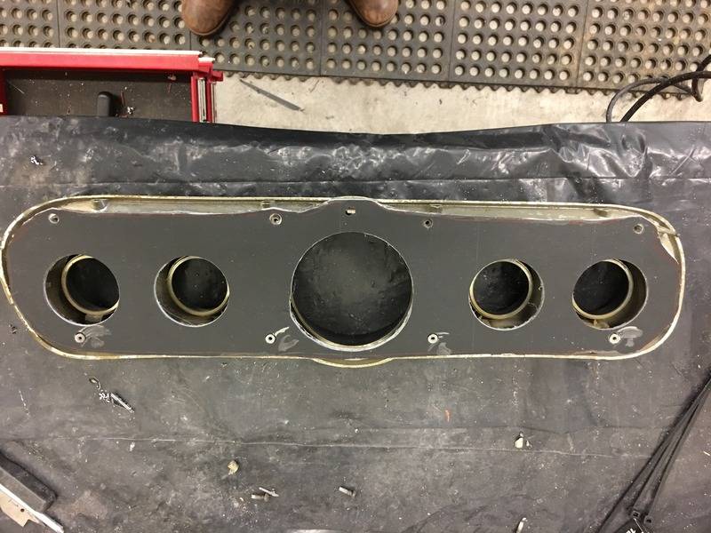

      I found a used set of Speedhut gauges and wanted to use a 66 GT 5 gauge cluster. Made up my own mounting plate to make it look as close to stock as possible. I'll have the dash pod for the tach & oil temp.

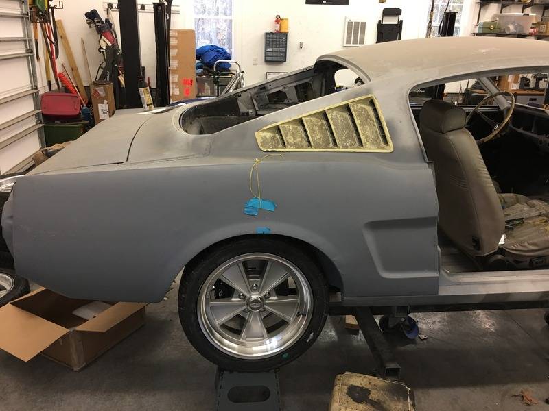

      Got the wheels & tires on the car:
      Wheels are Cragar Eliminator 17x7 (4.25" backspace) and tires are BFG Comp2a 225/45/17.
      I measured with the wheel fit tool and couldn't fit wider wheels on the car without having to modify the car too much.

      Thanks. The front and rear suspension are from Control Freak. Freakride.com
