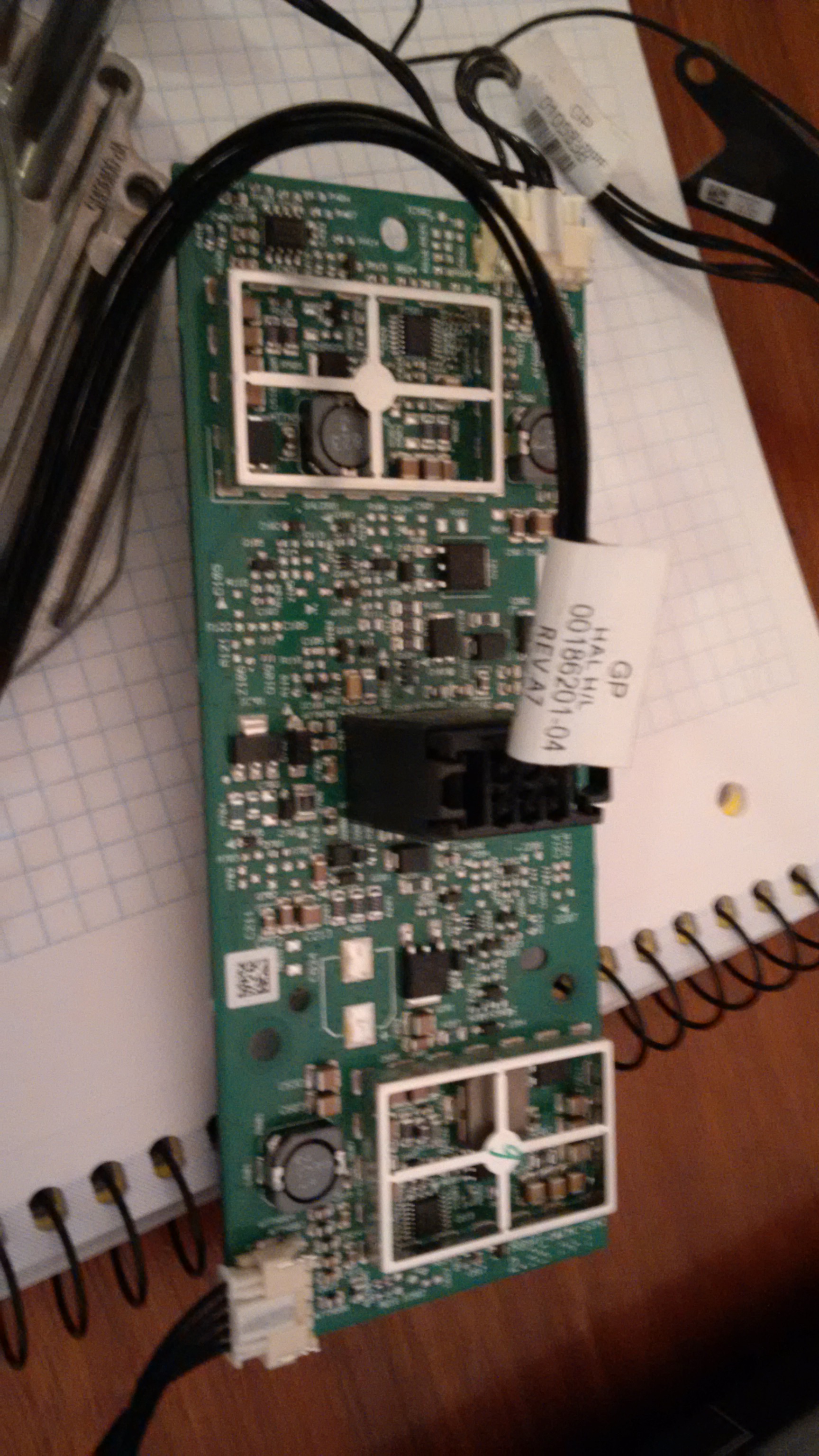

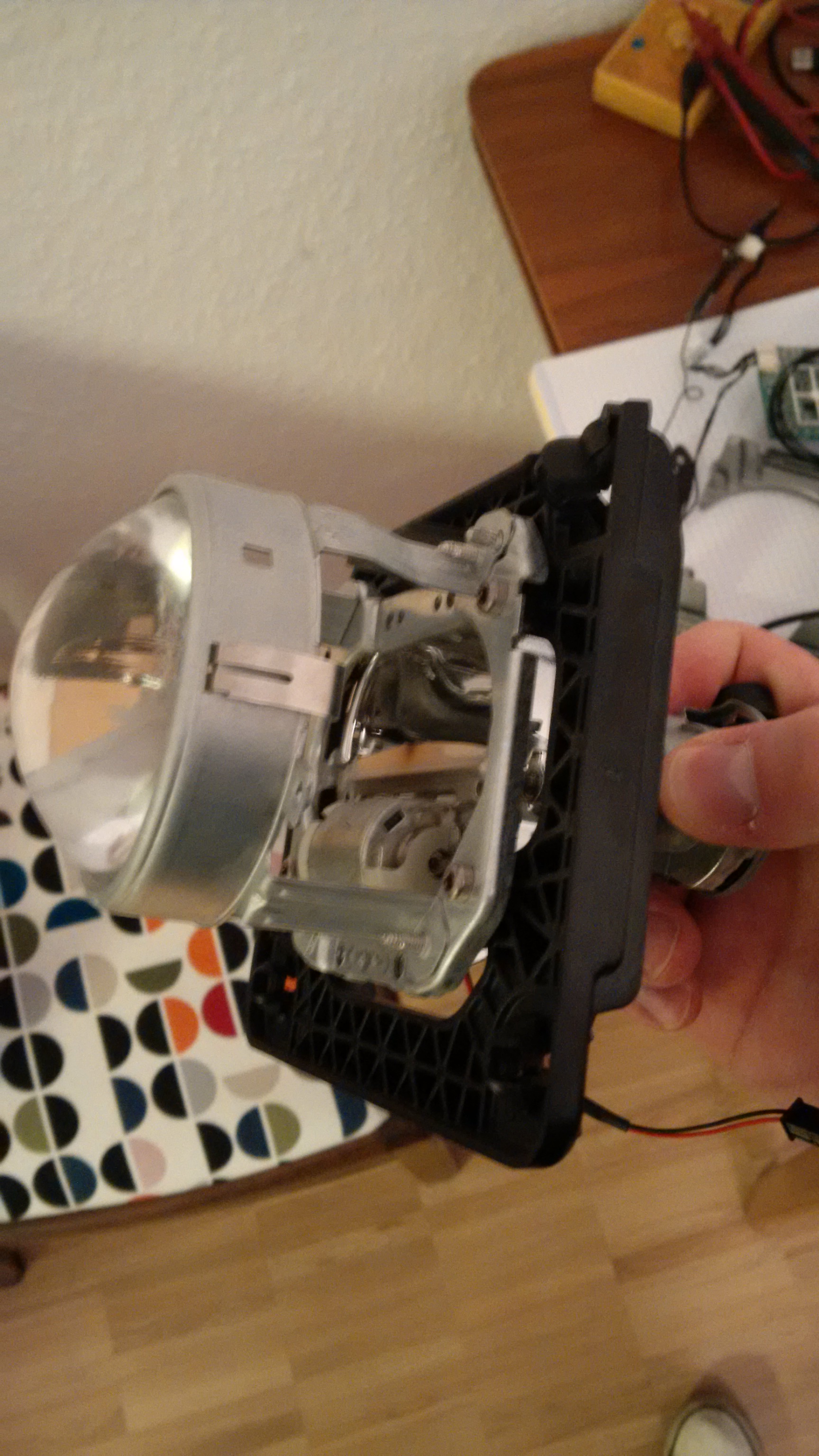

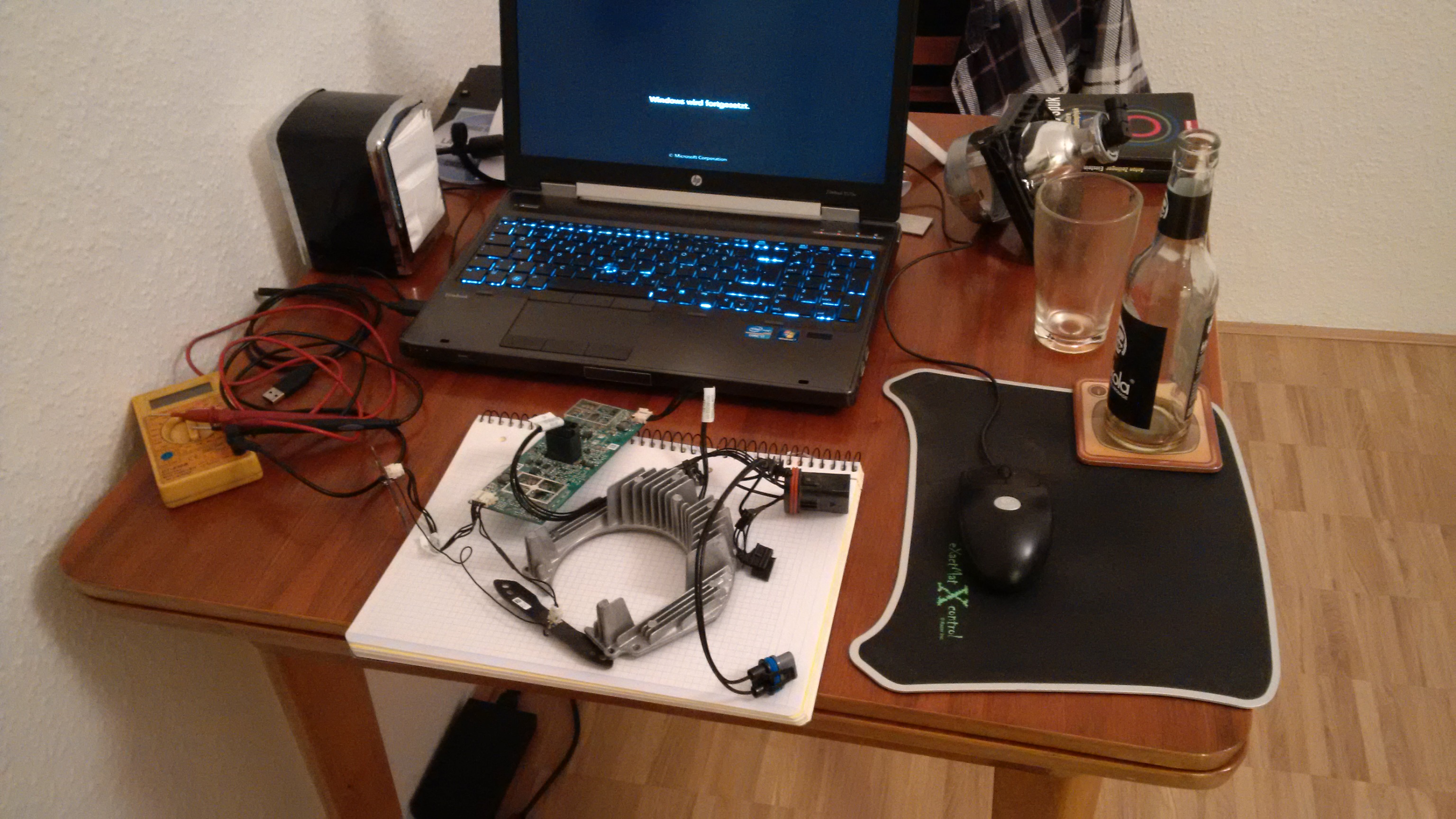

      I tore apart the headlight and the tail lamp i bought and after round one of massive headaches around midweek, here comes round two of monstrous headaches. It's circuit board is much more complicated and more compact which makes it harder to see the traces.
      It turns out that all green solder mask (headlight circuit board) is about as bad to trace out as black solder mask (tail lamp circuit board).
      Bits and pieces of the headlight:
      I now understand how the fault signal is created in the tail lamp, what message it transports and i will proceed to understand how the headlight does its thing.
      What i already know is, that i can not use the wiring configuration i already figured out.

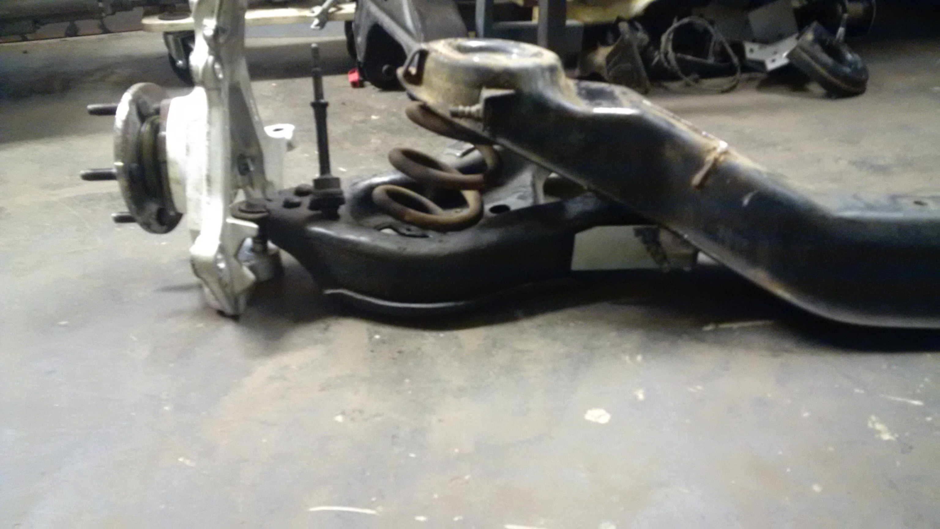

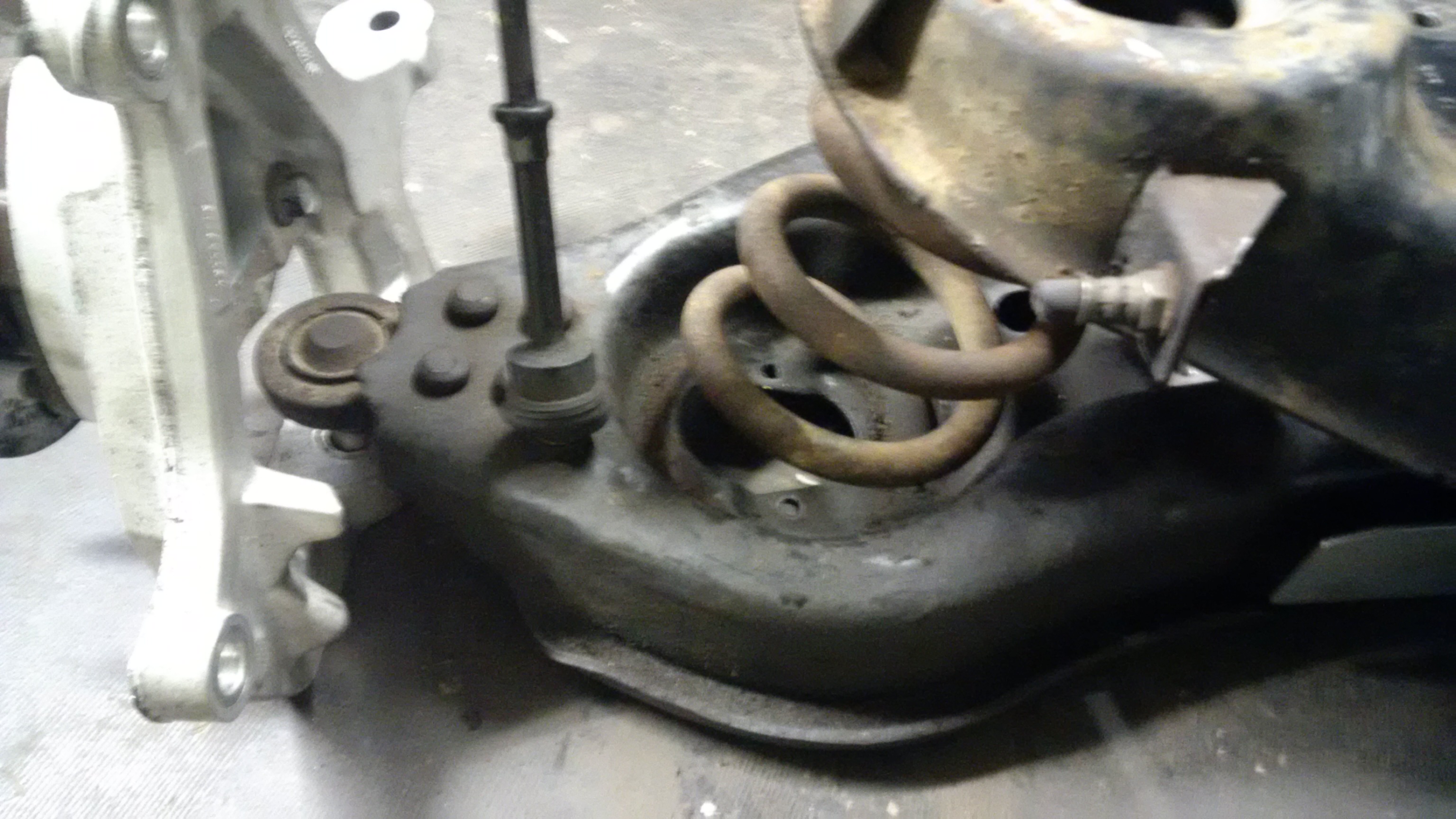

      Did something completely different in the last few days. I stayed in bed to get rid of the flu so i could head back into the shop this week.
      Yesterday was the first day in the shop for about two weeks and i am glad i went, because i learned that i might not have to cut the C10 trailing arms to get 3.7" u-bolts in there.
      I just hope the repop arms from Dynacorn have the same amount of wiggle-room between the bolt holes.
