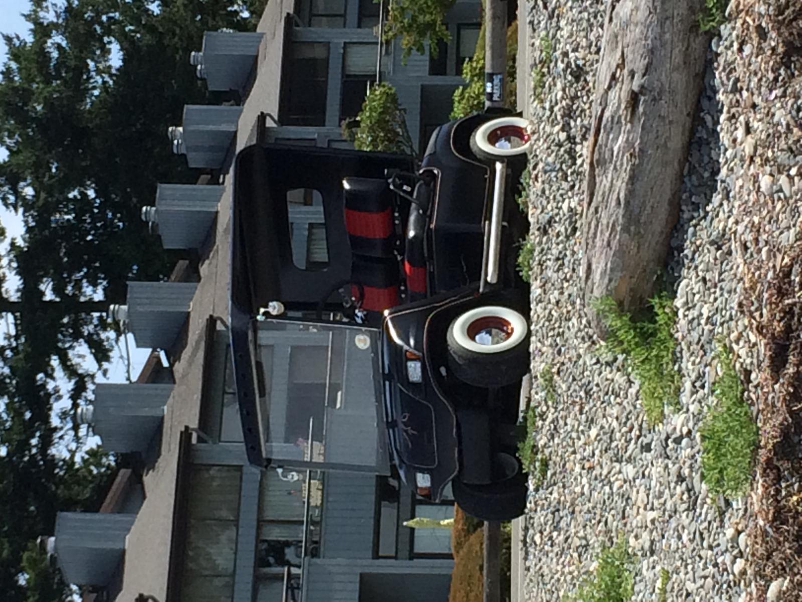

      Good to see you're making progress. I wish I was. Too many other things getting in the way. Building a hotrod golf cart being one of them.
      Before
    8. #68
      May 2011
      Brisbane, Australia
      453
      Country Flag: Australia
      Haha! Looks cool, but nowhere near as cool as that truck of yours.

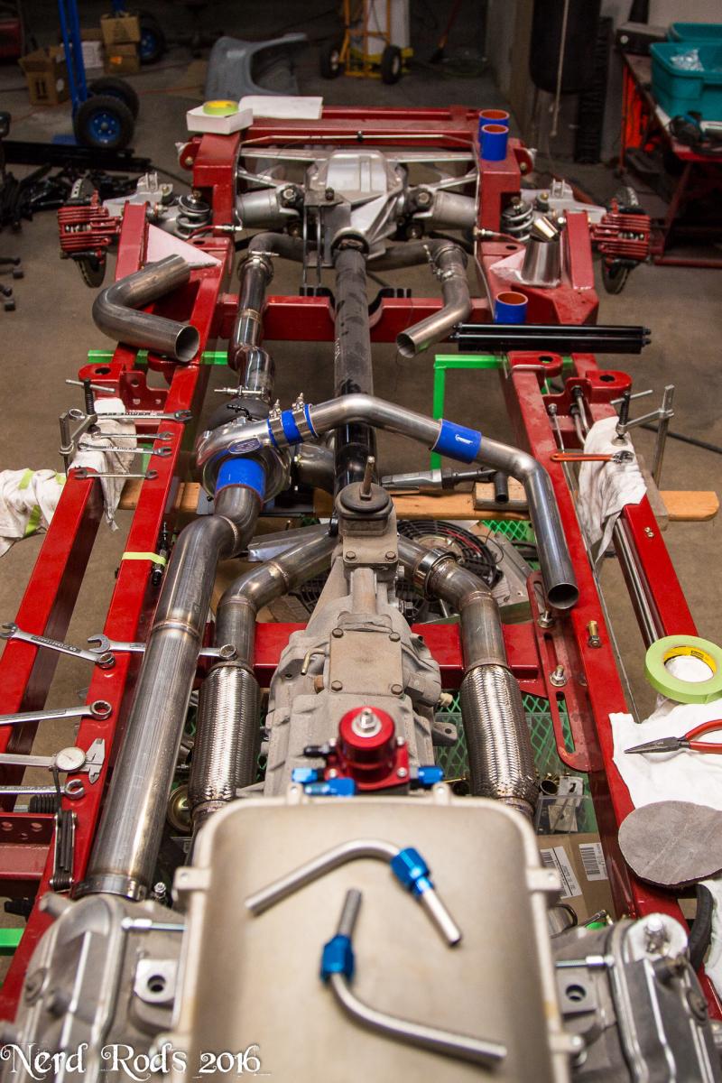

      I waiting to see how you do the pedals. That was the biggest problem with my C6 57 Pickup and I used a front mount transmission.
      Exhibit A
      Driver placement has stopped me from doing any other C5/6/7 stuff really. That and the added cost of all the other stuff you'd need to change to make them work properly.

      Quote Originally Posted by rat_rod_russell View Post
      Exhibit A
      I used a set of 5th gen Z28 exhaust tri-y exhaust manifolds which let me use the Progressive Automotive brake pedal assembly. They tuck very close to the head. Only had to move the pedal over 1/4 inch. Using C5 cradles and torque tube. It’s an auto so no clutch pedal.
      Exhibit A
      Super cool chassis
      This may be dumb question but I see turbos a loooong way from the intake.
      What about lag?? It could be glacial in turbo time?

      Quote Originally Posted by dhutton View Post
      Don
      Gotcha, Auto makes that much easier for sure. Its also easier on the driveshaft. I'm just a hard ass about driving position now so foot box room is always a consideration now to make that happen. I'll be interested to see how it turns out.
      Quote Originally Posted by camuchi View Post
      Super cool chassis
      Have you ever had problems spinning the tires in first gear for any V8? Turbos or not? I can blow the 275's loose in my 5.3L Suburban in first if I feel like it with 5k lbs holding it to the ground.
      Turbos were small to help spooling and get more area under the curve. And turbo lag is un-noticeable in V8 cars for the most part anyway. I was more concerned with keeping the CG as low in the car as possible. Power doesn't do you any good if you can't keep it in line through the corner. I wrote a small book about it in my forum post about that truck. ( https://www.pro-touring.com/threads/...-Hot-Rod-Jim-s )
      But I have centralized the turbo and other weight on my more recent projects.
