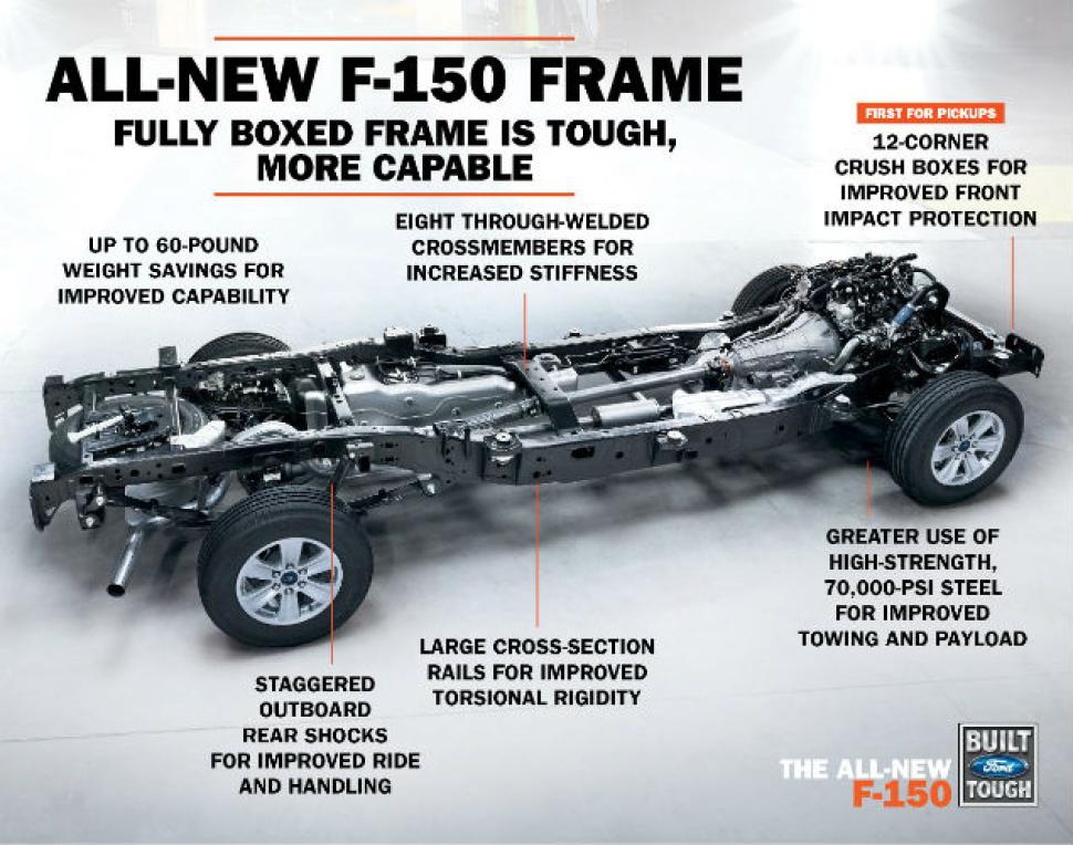

      So Ideally, you want them mounted outboard of the frame, staggered front & rear....Like a Ford...
    6. #46
      Aug 2010
      now In Dandridge, Tn.
      1,301
      This is a leaf spring set up, so staggered shocks (without the coil spring) will help the natural spring wrap and oscillation. - But, these shocks are not carrying the weight (spring load) of the suspension. If you were to stagger the shocks on a four bar/coil over set up, the two sides would react differently. The coil-over in front would see a higher load, and slightly less travel, the rear coil-over would see a lower load, and slightly more travel. (realistically less than 3% difference) So to get the two sides even, you would need custom springs and valving for each side.
      - No, Ford doesn't have a 'left' or 'right' shock. It's the big compromise. this gives them the best ride for the least $$$. Honestly, I would rather put the coil-overs in front of the axle, but that brings in a packaging problem, so, to get everything to fit, we put them on the back side. - Except for our Big-10 chassis, where they are chassis mounted and drivin with a push rod and rocker arm, on the front side.
