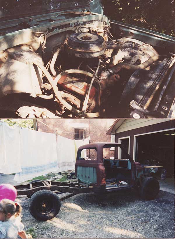

      A little history from 1989.
      I have owned this truck for over 25 years. My dad gave it to me as a father-son project when I was 14, it was a 100 dollar pile of green... rust. It took 8 years to complete the original build and over the years I have kept upgrading it, mostly for road trips and occasional trips to the drag strip and I land speed raced it a few years ago. You may have seen a small blurb about it in Aug. 2011’s Hot Rod.

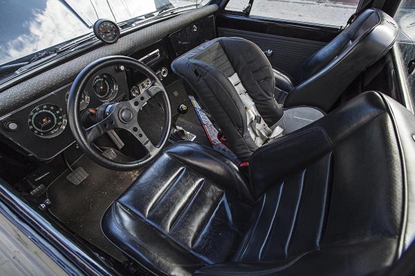

      The current interior is very simple. A couple of seats out of a Benz, a custom stick to get around the baby seat. Done. This will all be changing as I have to fully 'cage the truck.

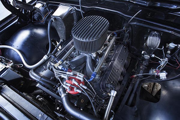

      And the crown jewel. My LSX race block based 427, AFR heads, Callies rotating, Big stuff 3, etc, etc. It’s backed by a t56 Magnum and a Spec 3+ clutch. It’s crazy, crazy fun. This I did not build, it’s capable of 8000 rpm, but the current cam is built for torque and runs out of steam in the 7000 rpm area. It pulls like a freight train at any rpm.

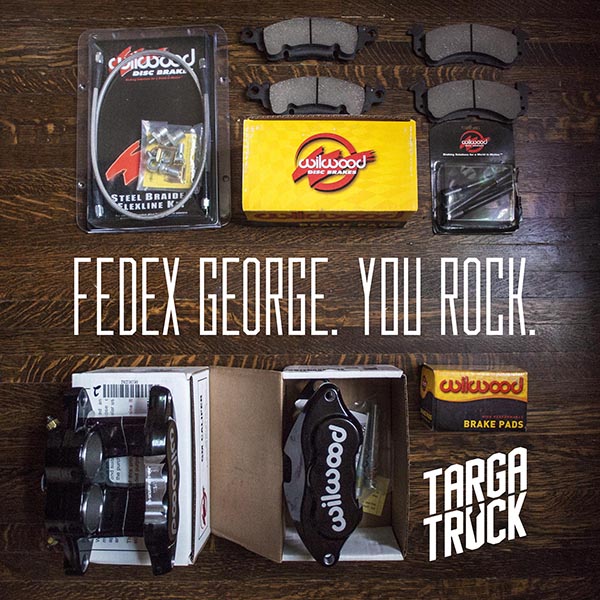

      Hey Ron, thanks again for everything this far. It has been awesome to work with you.
      I had to order my parts online, in the end from both Summit and Jegs. Normally, I'm a shop local kinda guy. But it just did not work this time.
      Anyway, both shipments where super fast. But someone went above and beyond at FedEx. A guy named "George" noticed I had a box for pick-up as my other box was going out for delivery. When he saw were the boxes came from he figured I was building a "race car" and gave me a call. He saved me a trip and a couple extra days of waiting.
      So...
      Installation starts tomorrow, so long as my son recovers from his illness.

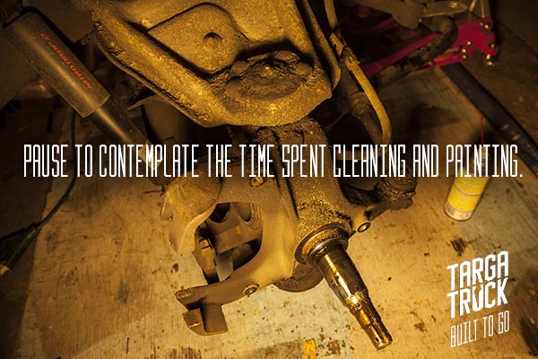

      Quick update. Tore everything apart tonight and am figuring out how to run ducts to cool the brakes.
      Did a quick mock-up of the D52s to make sure all the bolts were right and everything moved correctly. It does. If you pop back to Ron's numbers, this upgrade is about effectiveness (cost too), not sexiness. Hello stock rotors.
      And as I tear everything apart, I remember how everything was shiny and new as I notice all the dirt, and grease, and grim... I take a time to:
      I love form, but function wins. Because race truck. More soon.

      Also, How is the car seat mounted? No rear seat in my Falcon at this time.
      I'll find the pics and post them. I built a custom mount and use an Orbit Baby car seat - they are amazing. Great design. Pricey, but worth it.
