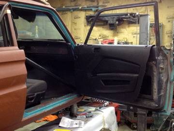

      I want a race car disguised as a street car. I also want all of the creature comforts. So the car will be getting a full interior. Interior sprayed with Lizard Skin.
      I was going to retro fit a 2010 interior into the car as much as possible. Being plastic though, it wasn't going to very easy to modify parts to fit.
      So I decided to make fiberglass panels and have them leather wrapped. First plan was to use foam insulation panels and carve them out. Since resin eats a way at this type of foam, I planned on wrapping it all in plastic first. The problem was that the plastic would pull up every time I tried to brush resin on. These are the panels pre-shaped.
      I decided to use 2 part foam. It won't get eaten by resin and it'll allow be to fit the pieces a little better.
      So I lined the whole area with plastic and made cardboard block off panels.
      Foam poured in. The stuff sets really fast. So I did it in 4 parts.
      First initial cut
      Shaping with air sanders. Still really roughed in. I figure the back should take 4 pieces to fit around the roll cage.

      Just a little update.
      Finished shaping the back. Rear side panels are poured, shaped and speakers are fitted.
      Started on the door panel:
      Laid out the design after roughing in the height.
      All shaped and ready to be fitted to the car.
