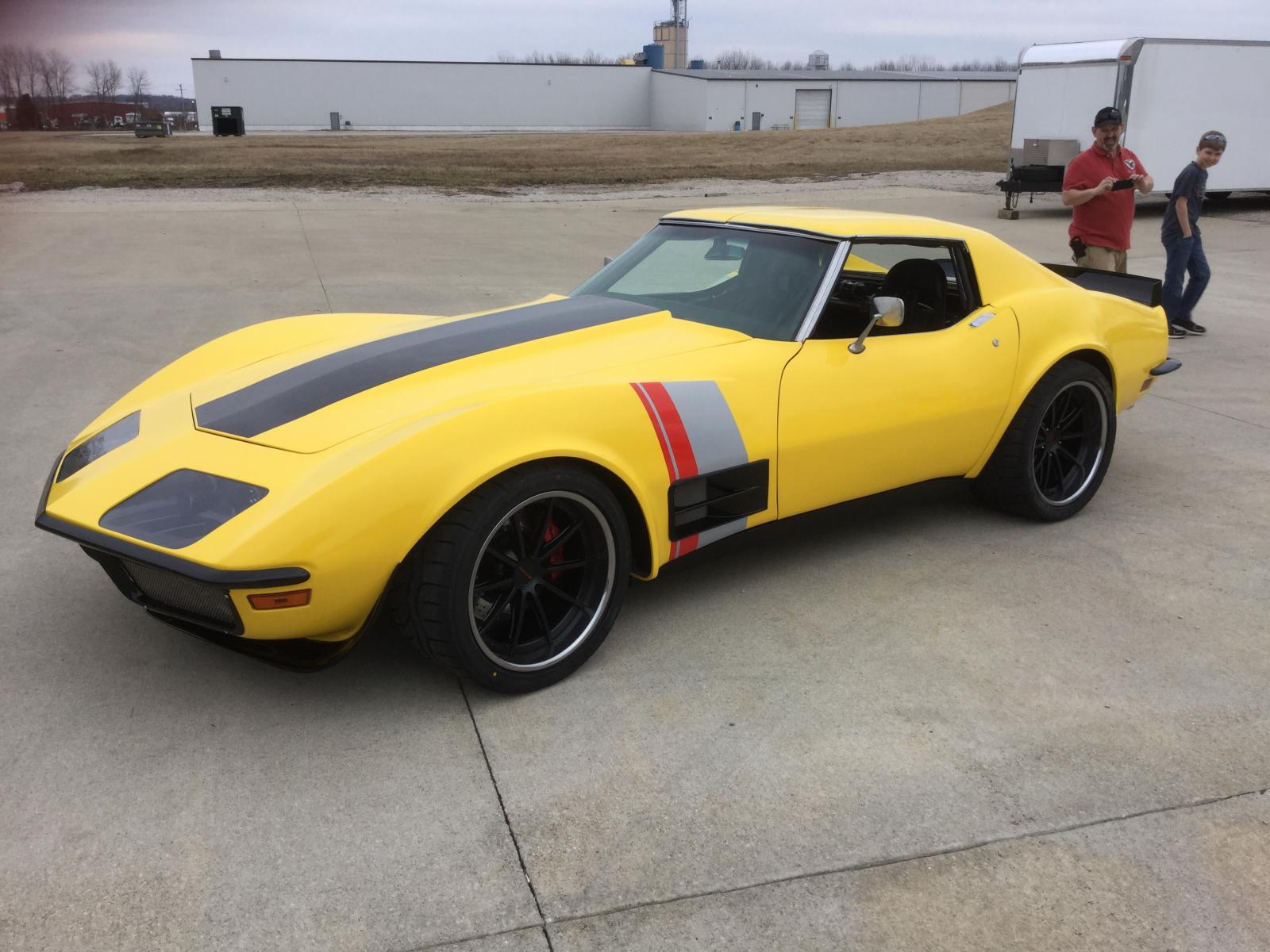

      So is it a 315 tire front & rear? I have not read thru the thread yet.
    2. #82
      Indiana
      1,371
      Quote Originally Posted by eric1967 View Post
      Falken Azenis 615K size is 315/35-18. Forgeline wheel size is 18x10.5 with a 5.5 backspace front and rear.

      Bret, were there any other modifications required to fit the 315 other than the new suspension?
    5. #85
      Jan 2014
      Dixon, IL
      270
      That looks great.
    6. #86
      Indiana
      1,371
      Quote Originally Posted by FLYNAVY53 View Post
      Nope.

      Quote Originally Posted by bret View Post
      Do the front tires rub on the frame at full lock?

      Quote Originally Posted by Kid Vette View Post
      They do not. The tire will rub on the swaybar arm just enough to rub the paint off at full lock.

      We will be at the Texas Goodguys event this weekend MArch 20-22, and again the next weekend March 28-29 for the optima Ultimate Street Car event. We can take passengers at Goodguys but not at optima, so if you want to ride come to the Goodguys event. If you want to see the car run on the road course, come to the Optima event. Better yet...come to both!
      Right now we are trashing to make some minor revisions [that ALL new cars seem to need]...more aggressive brake pads, seat position adjustment, replace a bad power window motor, heat sheilding, finish up the fire suppression system, a thorough wheel alignment, finish the center console.
