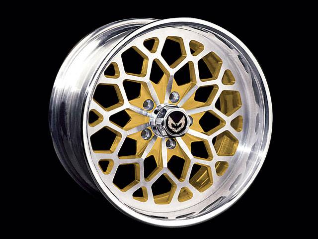

      Wheels - I'd love the 18" Bandit honeycomb wheels from Year One, but spending $3,000+ on billet wheels is a good chunk of my budget!

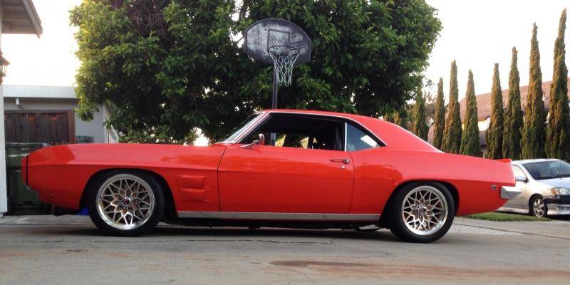

      But, after seeing Quikbrd's '69 with cast 17" snowflakes that he had polished, I'm really liking this cheaper option! $800-ish for the wheels, then tires, mounting, etc. maybe $1,500 for everything?
      I love the idea of staying with some Pontiac history with the wheel choice, and honestly, nothing else out there really peaks my interest.

      Also if you want big inch snowflakes, but are scared of the price of those billet ones, they sell cheaper versions
      https://www.yearone.com/Product/wheels/gsf179kr
      These are the ones I have my eye on now for sure.
