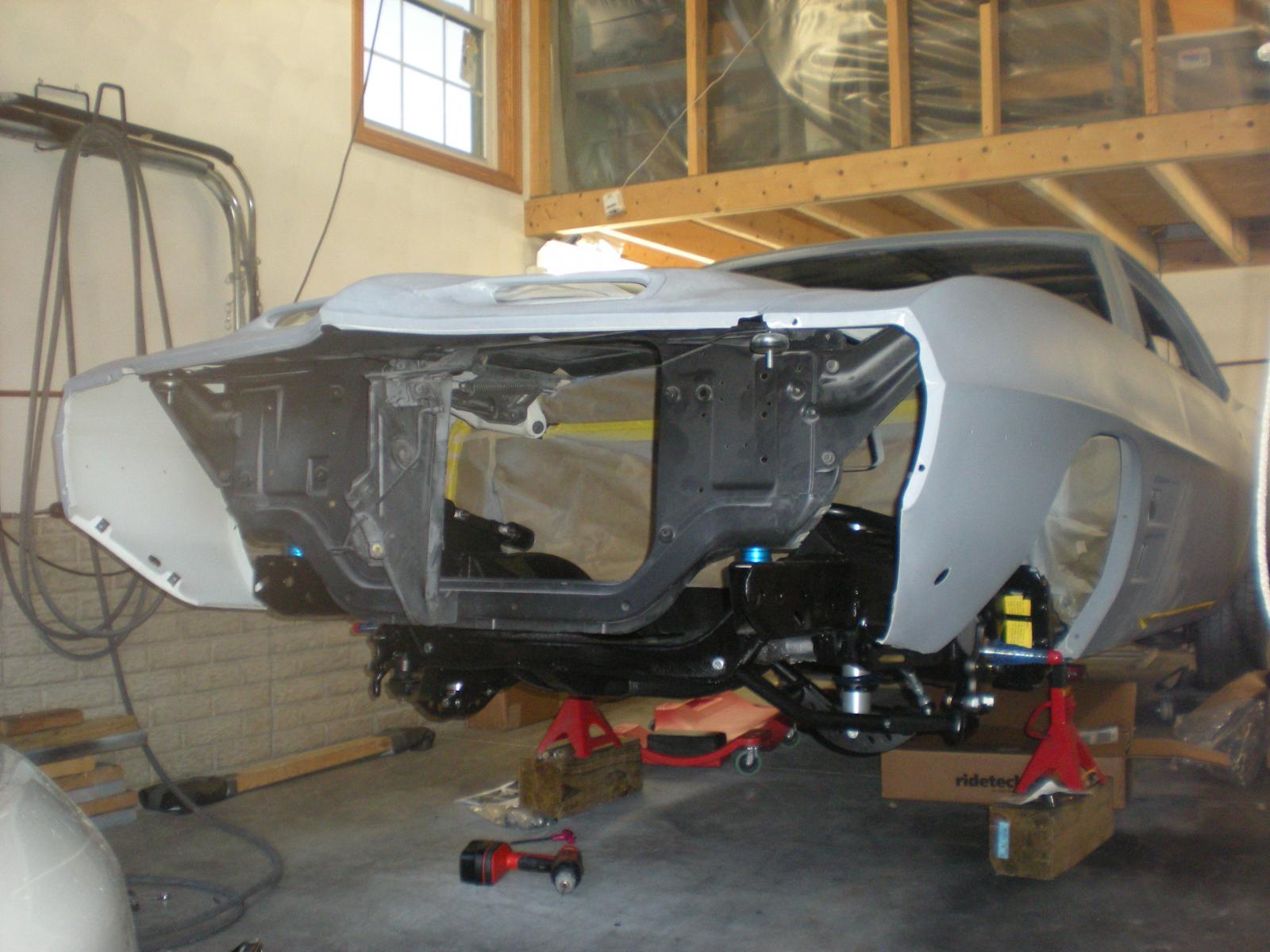

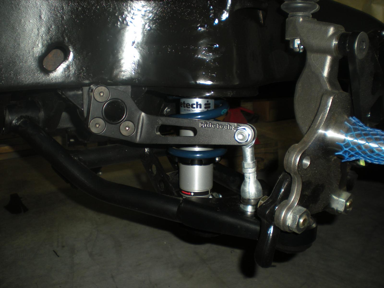

      I was able to install most of the front Ride Tech suspension this weekend. I'm not sure if I will have to pull the coil overs and cut any of the spring pocket yet for more clearance. At full sag the shocks don't touch, so maybe I will be ok. I started to install the front Muscle Bar. I'm in the process of drilling holes for the mounts and I'm not sure if I will have to trim any metal from the subframe bumps for clearance as it states in the directions. I am close to getting the Wilwood's mountes as well. I have to get a shorter lower caliper bracket mount bolt since I am using TruTurn and the bolt no longer has to pass through the caliper mount, bracket, and steering arm since the TruTurn steering arm mounts in a separate location. I also need to order a Camaro drag link since the Pontiac drag link doesn't work with TruTurn. Pictures to come!
      Joe
      1969 Firebird Project
      1967 Frirebird 400 convertible
      2013 Boss 302
Size:  141.1 KBName:  frontridetech 003.jpg
Size:  126.3 KBName:  frontridetech 004.jpg
Size:  172.3 KBName:  frontridetech 002.jpg
Size:  147.2 KBI had to trim a little off of the front subframe cross member for Muscle Bar clearance. I'm still not sure about trimming the metal bump stops.

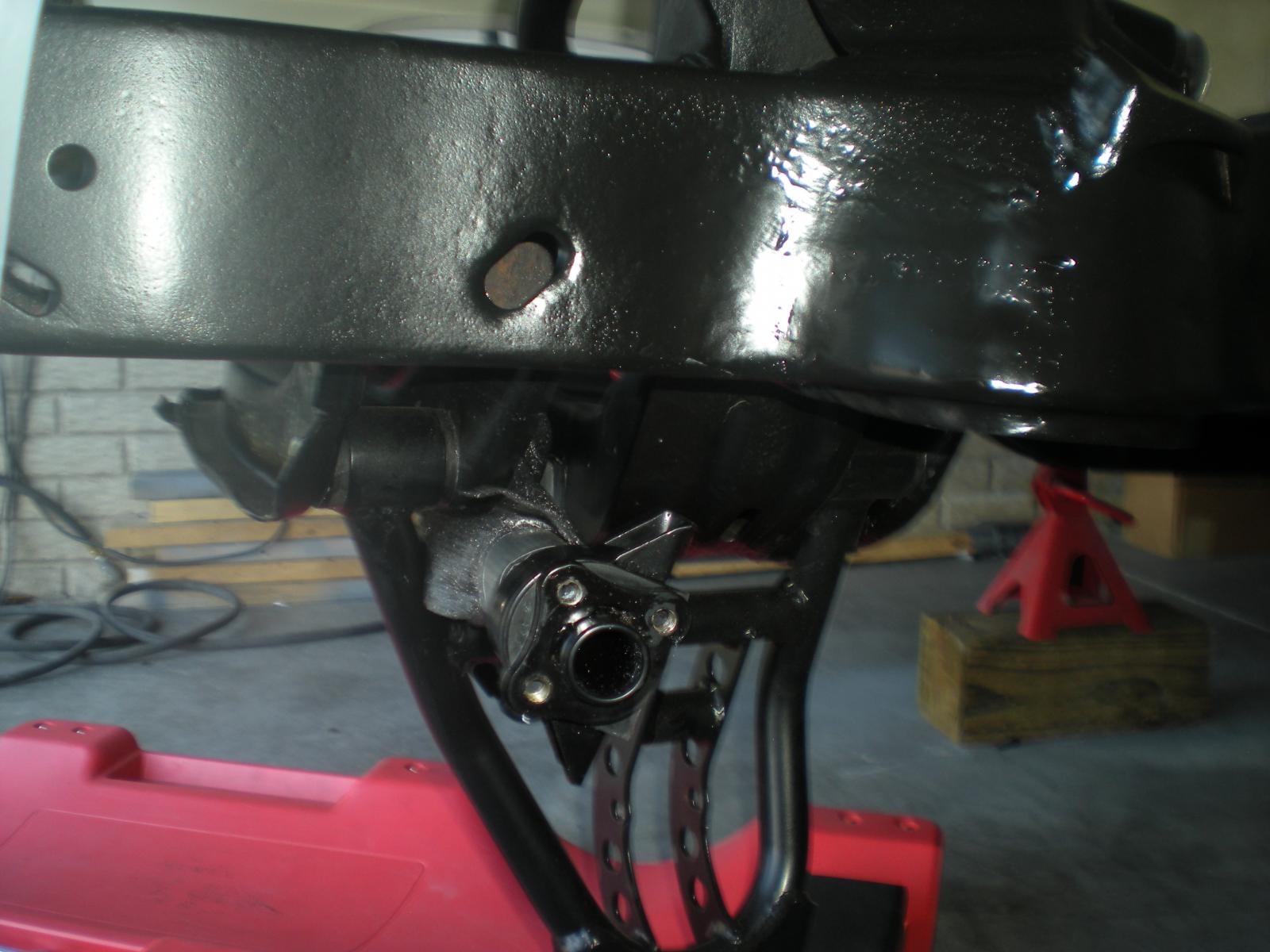

      Aug 2010
      451
      I should have mocked up the suspension before I sprayed the subframe. I have to remove the metal bump stop from the bottom of the subframe (in front of the spring pocket) for sway bar clearance. Luckily a cut-off wheel and a grinder should do it. Shouldn't be too hard to touch up the SPI epoxy.

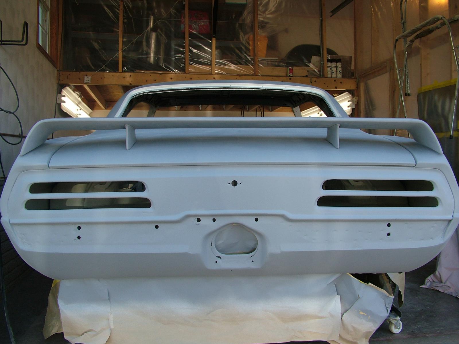

      Aug 2010
      451

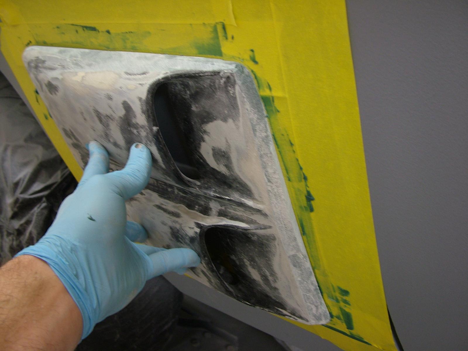

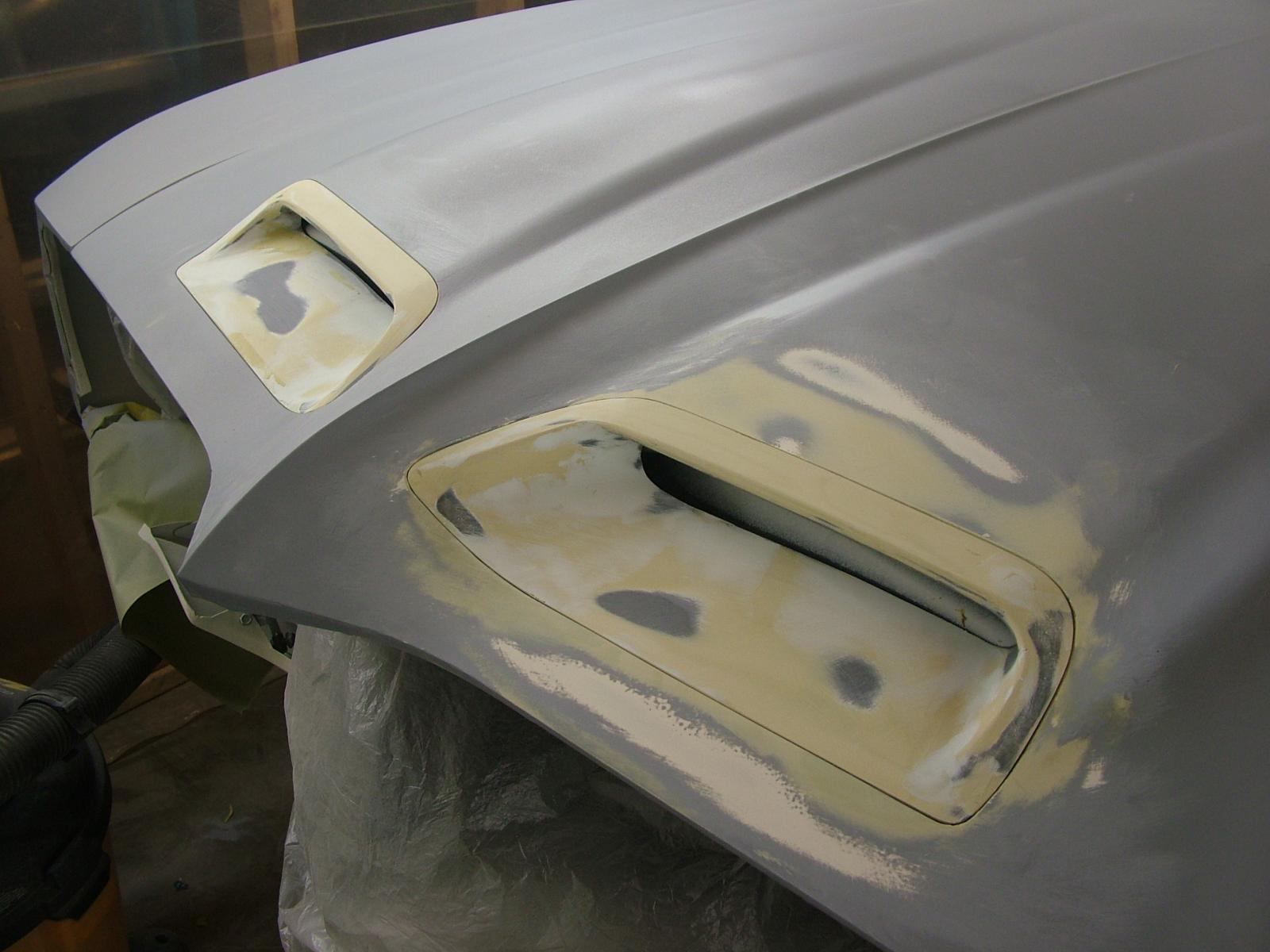

      A few TA goodies. I am going to trim some metal from the lip of the dog house to get a little more air flow from the fender extractors. THey are more "show" than "go" as delivered from GM. I did quite a bit of fitting with Tiger Hair filler to get the gaps for the fender extractors and the spoiler pedestals tight.

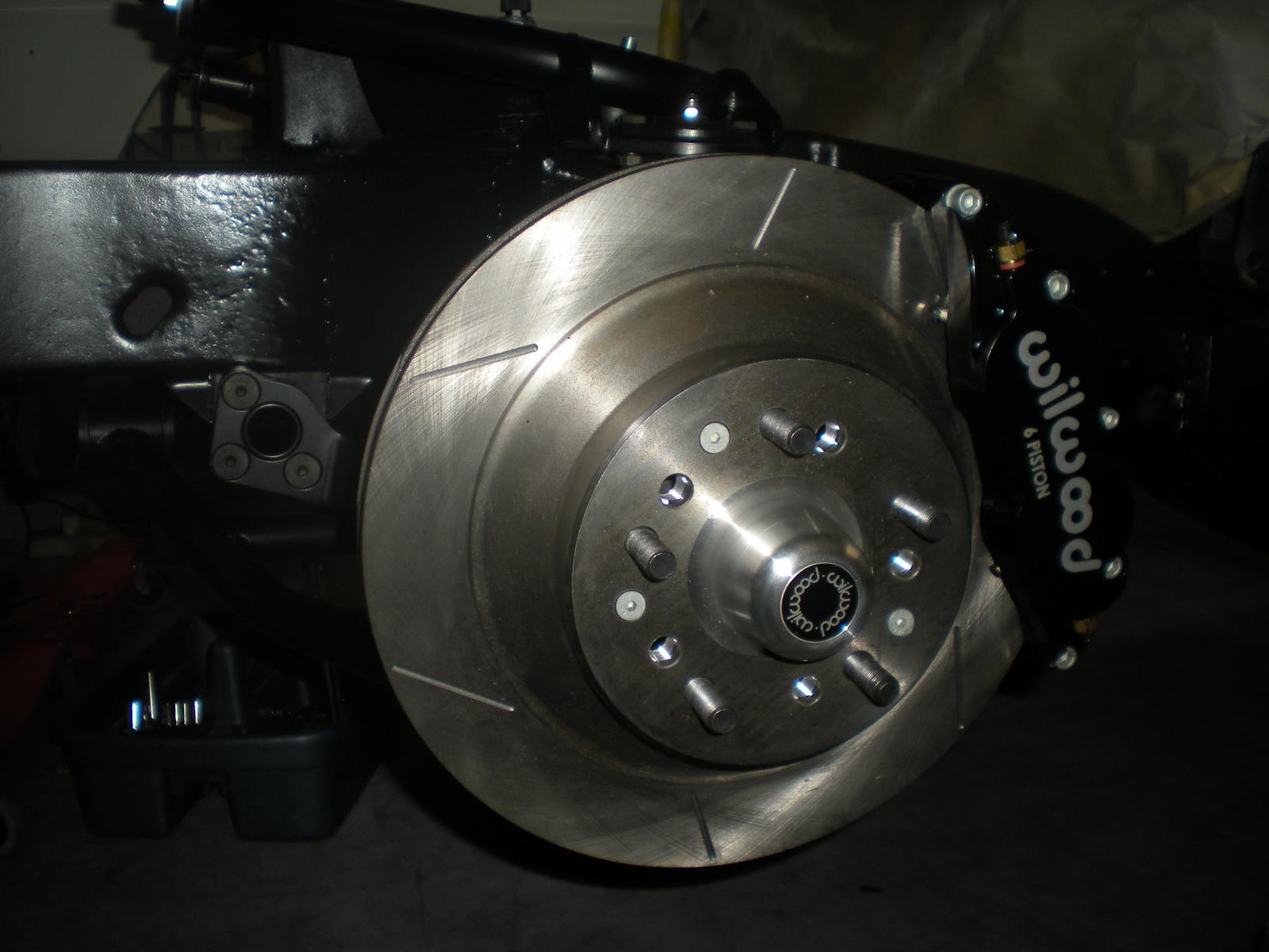

      Aug 2010
      451

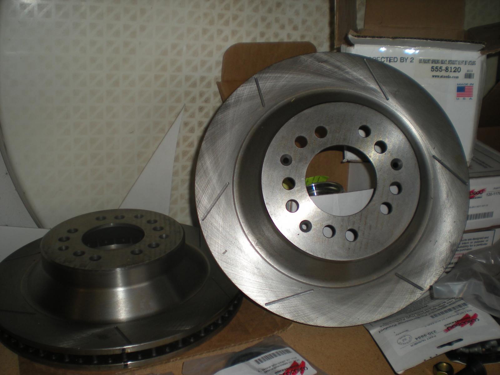

Size:  125.4 KBI tried to put the pads in last night and it looks like I will have to shim the caliper mounting bracket to move the caliper outboard. THe inside pad has plenty of room (not touching the rotor), but I can't slide the outside pad in. I'm going to try to get ahold of Wilwood today to see if this is common with ridetech spindles.

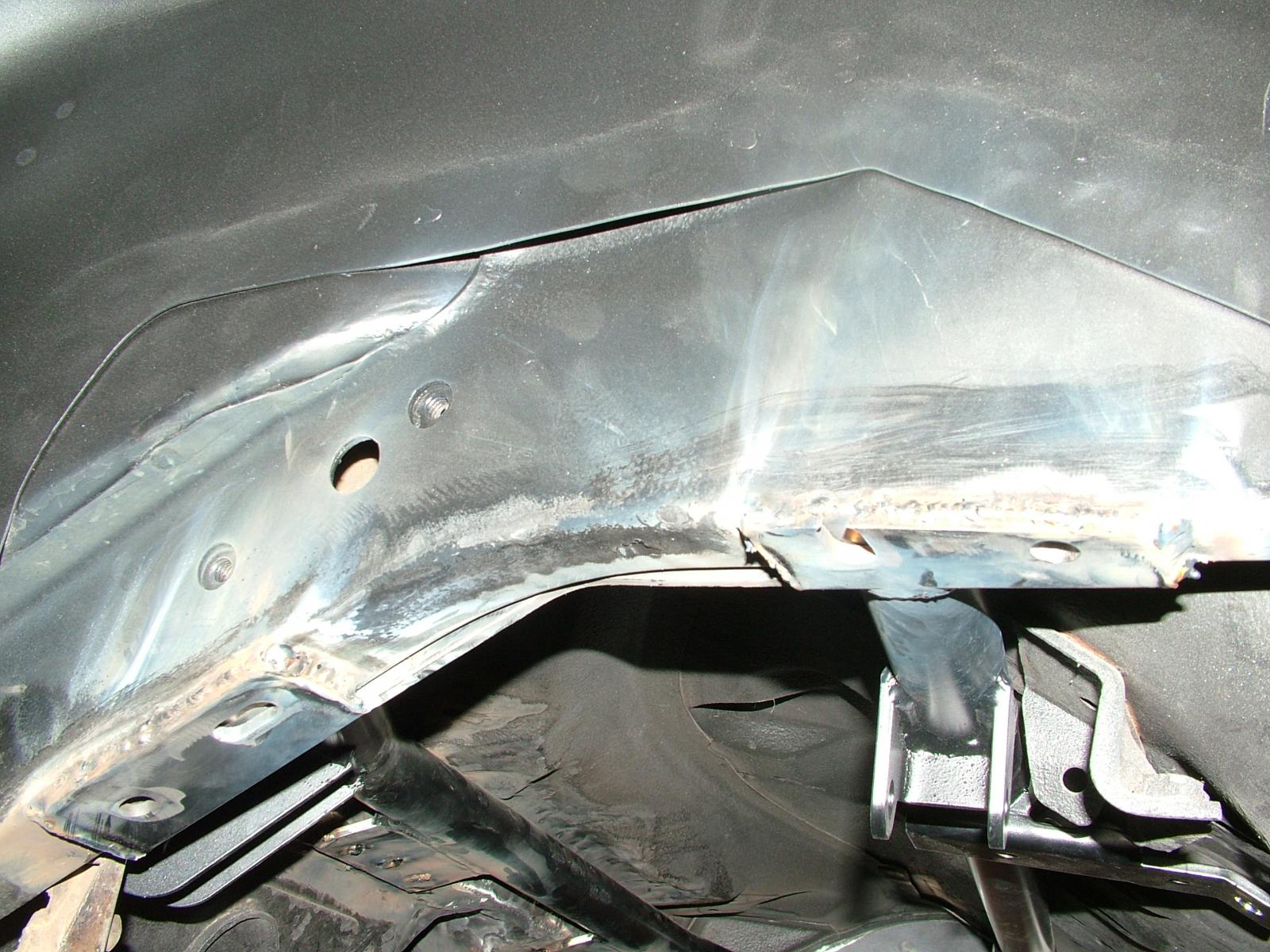

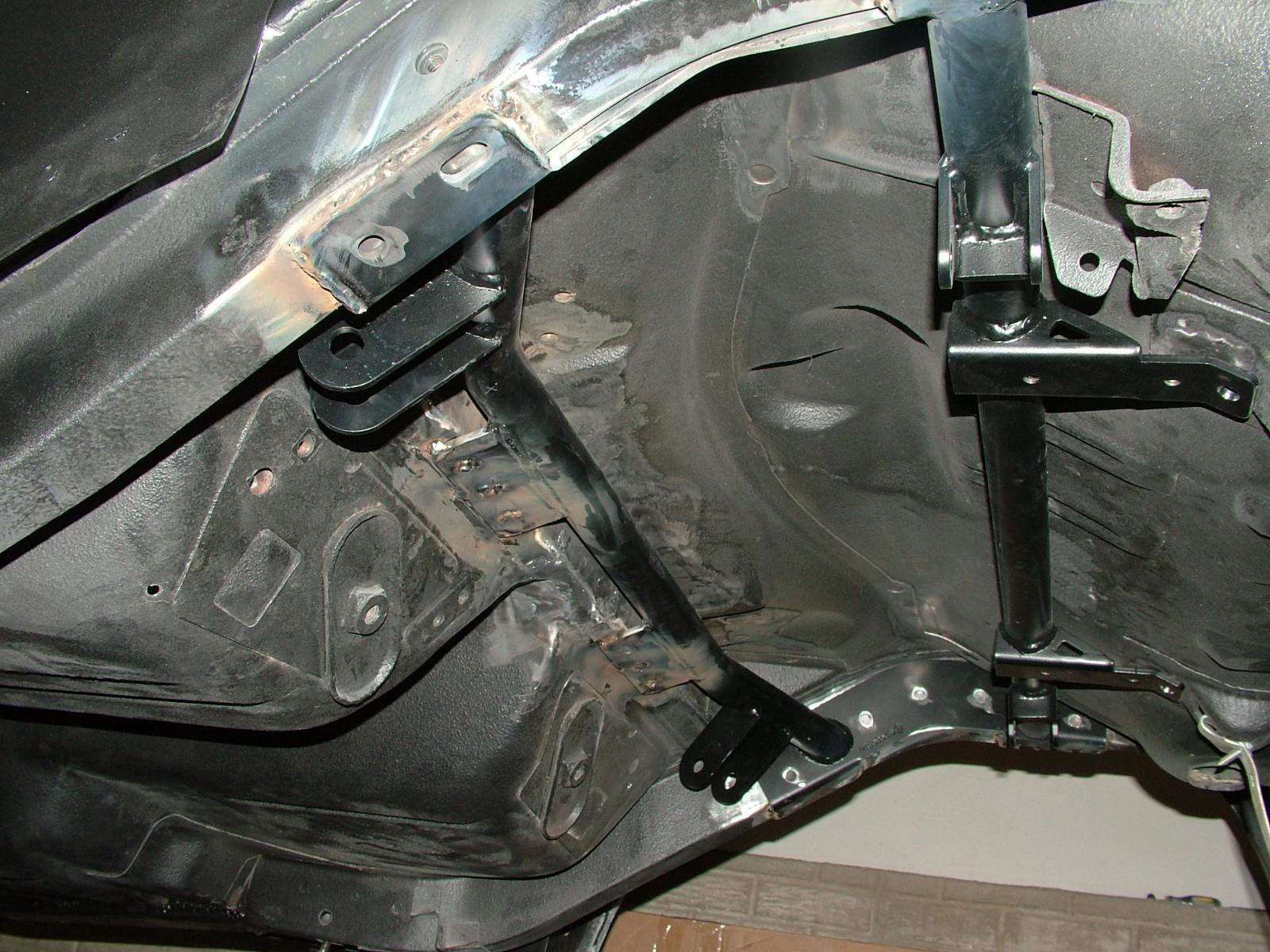

Size:  188.5 KBName:  4-link 009.jpg
Size:  111.5 KBName:  4-link 007.jpg
Size:  141.2 KBName:  4-link 004.jpg
Size:  132.1 KBStarted to install the 4-link. I had to massage the area of the floor pan at the front bar quite a bit and also a few areas where the trunk pan was ribbed (you can see where I was pounding on the floor pan). Trying to figure out how to get the frame rail L-brackets flush for welding. The bottle jacks give me a souple extra hands since I am doing all of this by myself!

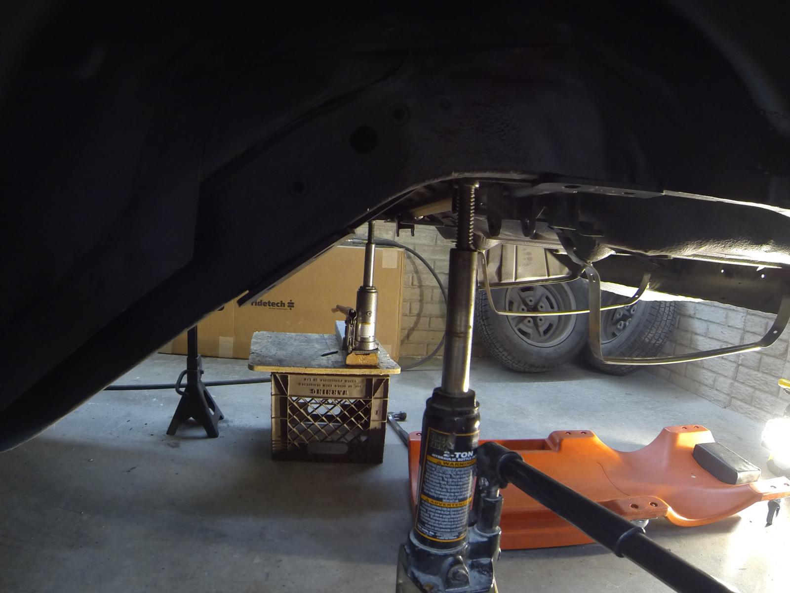

Size:  277.8 KBName:  4link 003.jpg
Size:  274.7 KBAfter much pounding and massaging, I got the 4-link where I think it needed to be. I held it in place with a bottle jack on each side (working alone) and ran a plumb bob down from each upper coil over mount. Then I measured to a bolt hole on each side at the front leaf spring pocket to get it as close to square as I thought I could (within 1/8"). Welding is almost done. I have to get my 9" ordered and getting closer to biting the bullet on an LS3 and trans!

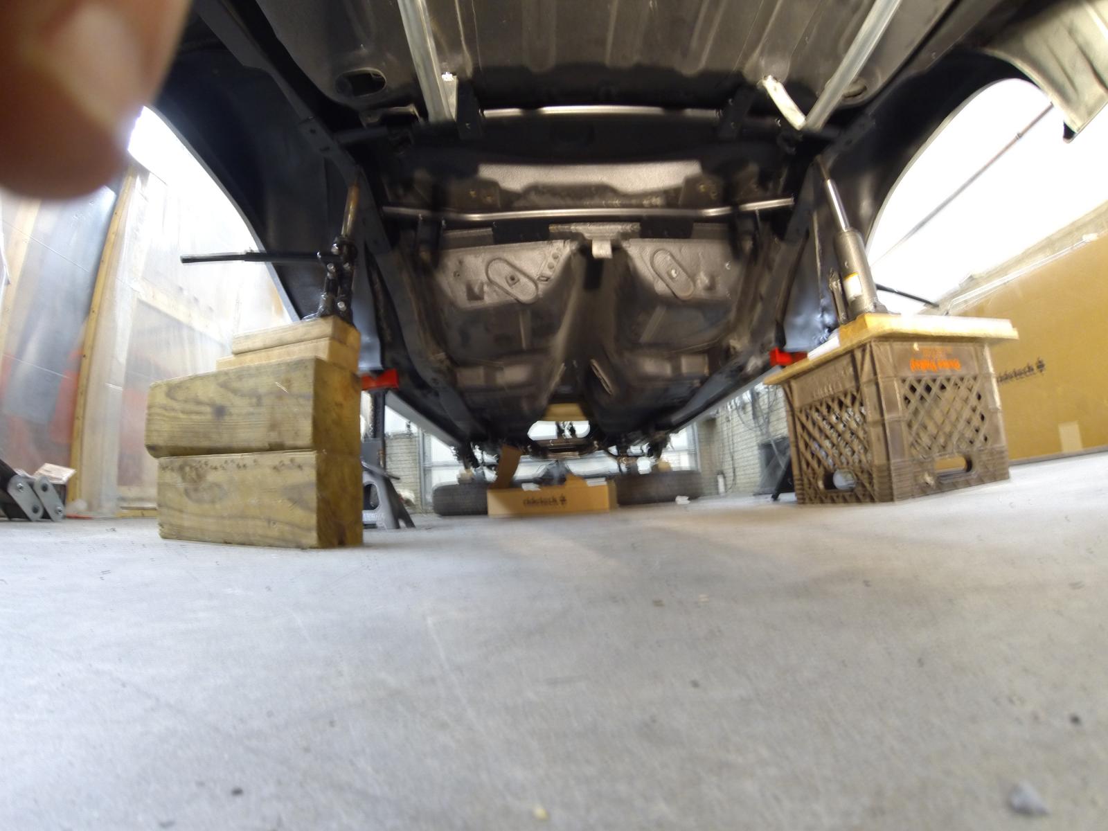

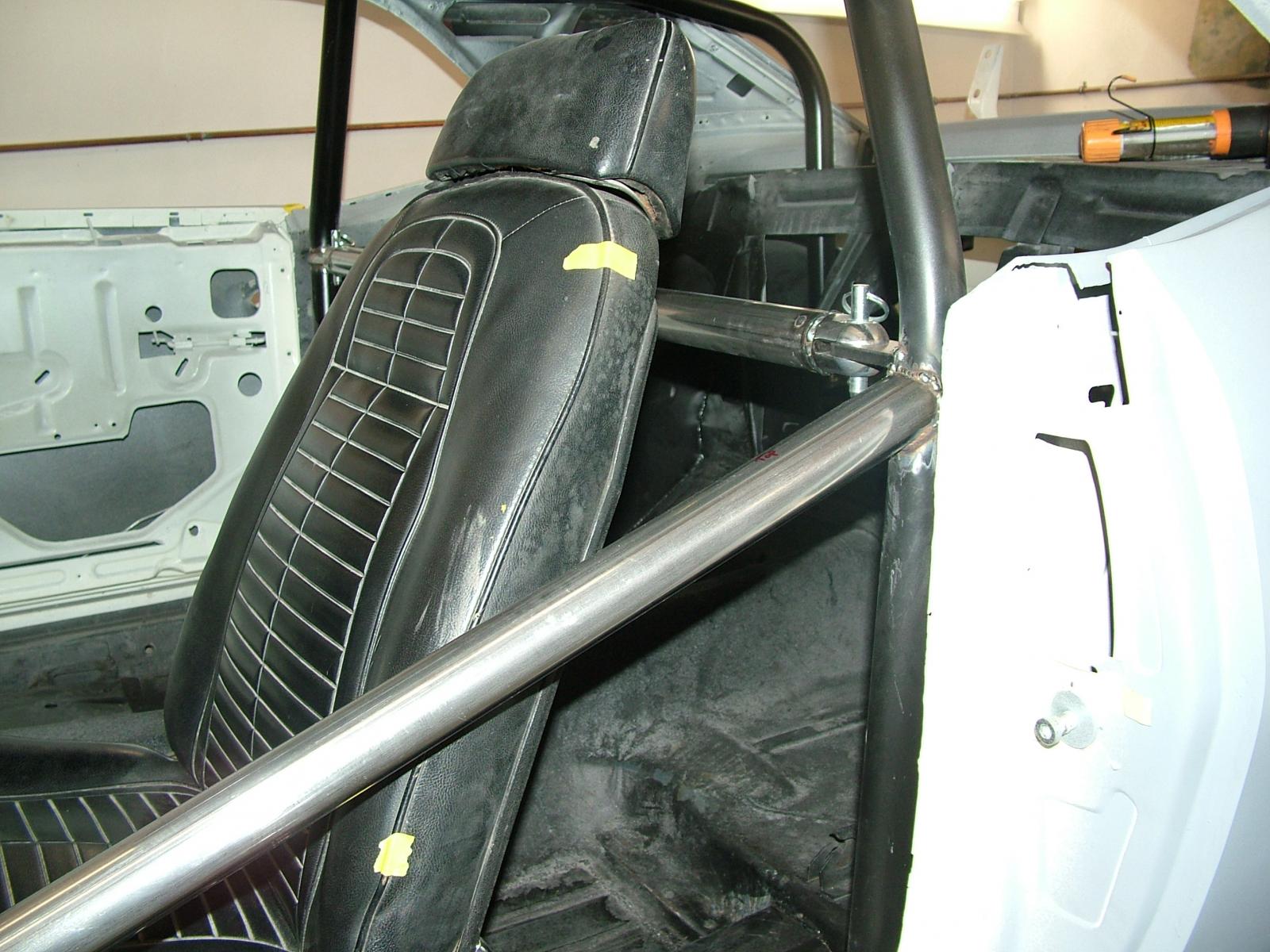

Size:  191.7 KBI've had a lot going on lately to say the least and the car has been on hold. I got married and moved into a new house. I managed to get the Chassis Works 6-point cage welded in. My new garage has similar dimensions but I am going to change a few things. i am going to park the Boss in the 3rd stall (shortest stall) and have the 69 in the middle with clear tarps/curtains hanging from the ceiling on a steel rod similar to a shower curtain set up. We removed 2 4'x4'x1' sections of concrete and poured 5000psi concrete so I can install a lift! http://www.revolutionlift.com/RTP9-9...px#MoreDetails I've decided on a Texas Speed LS2 with a Tremec and a Strange S60 rear end. I got a set of Toyo R888's 275's and 315's for my tires. Now I can figure out rim size and get some v40's ordered, then I can get my rear end width figured out and get that ordered.

      Still trying to get the new garage up and running. You can see the new footings for the lift that need to cure a little longer before the lift can be installed. Prior to the move I trimmed the metal lip from the area behind the fender extractor openings and then welded the edges back together to make them a little more functional. The fresh meats were delivered just after xmas and I have a new 670 steering box on the way from Speed Tech.
