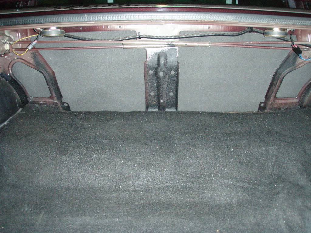

      The factory jute that was behind the seat back was toast so I put a layer of closed cell foam in it's place which you can see in this picture from the trunk.

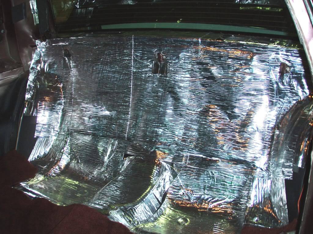

      Then covered the inside of that foam with more raamat butyl sound deadener. This is what the back seat area looks like today under the rear seat.
      Some of that sound deadener is going to have to come up to make room to weld in the roll bar mounting plates. The main hoop bars are going to weld onto the floor close to the B pillars which is several inches back from the carpet edge and the rear down bars will go through the sheet metal holes onto the trunk floor up above the axle.

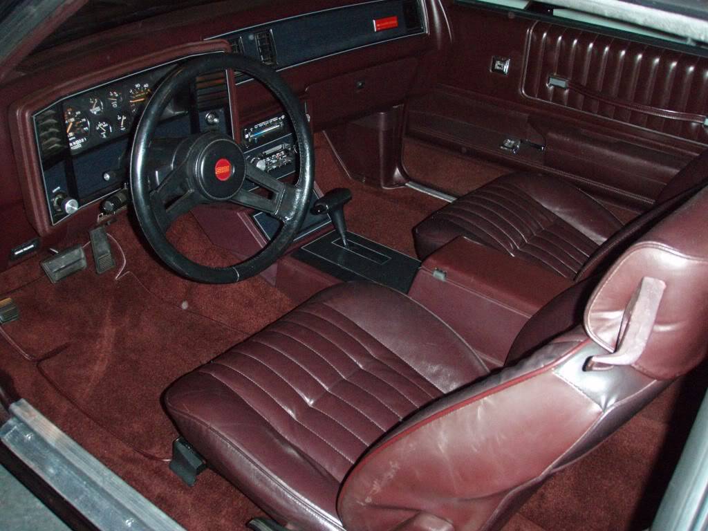

      There is really nice maroon carpet from the front edge of the rear seat forward and the rest of the interior is very nice. Here is a pic to give you an idea of how the rest looks.
      There's been a few changes over the years since that was taken, Dakota Digital dash, aluminum shift plate cover and 6 speed shifter, and there will be black with grey insert front seats installed at the same time as the roll bar that look lke this.
