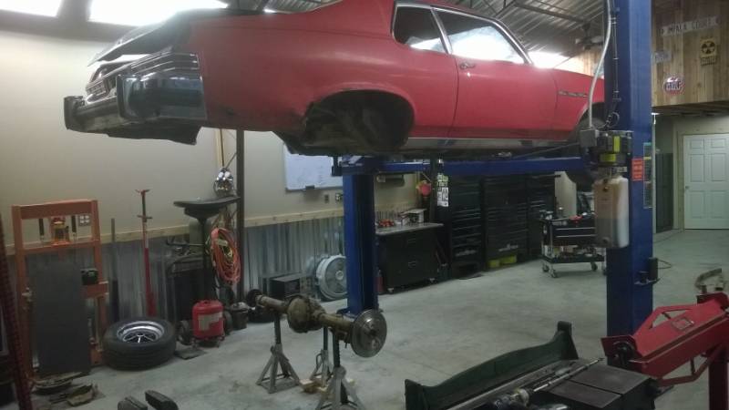

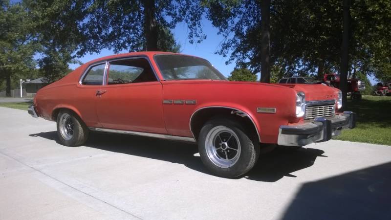

      Ok so after 13 years of sitting around watching everyone else have their fun it was time to find some room in the shop and get started.
      I have been collecting parts and building this in my mind for years. Plan is to get this on the road minus the paint and body work and get all the bugs worked out and then blow it apart and make it nice. Mostly plan to AutoX but won't back down to take it anywhere and open it up.
      GSiX comes from combining GSX and the Turbo 6 the dot in the i will be the turbo six logo. The concept is to create a phantom musclecar, the what if Buick could have built in 74, then restomod that into a pro-touring machine.

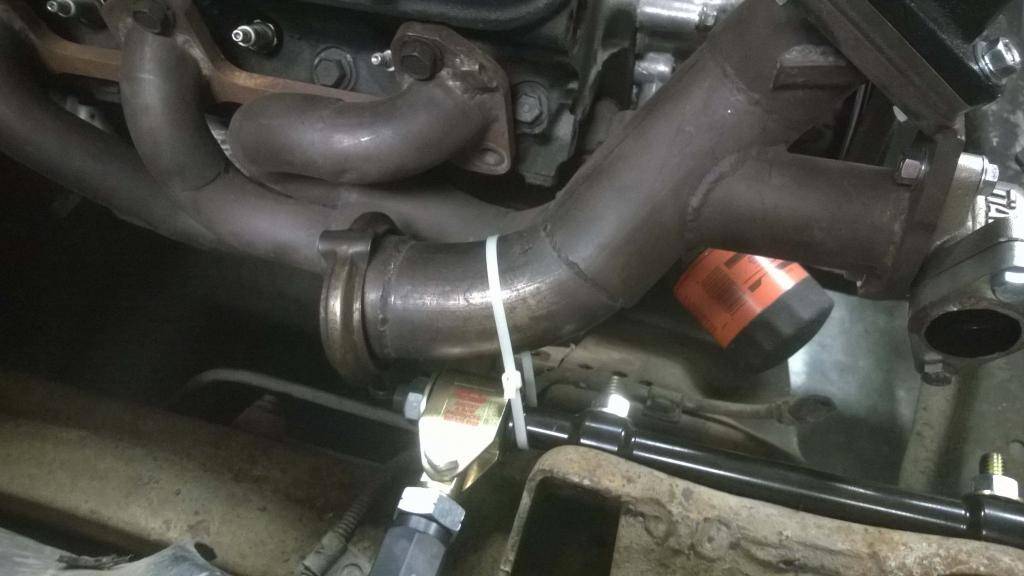

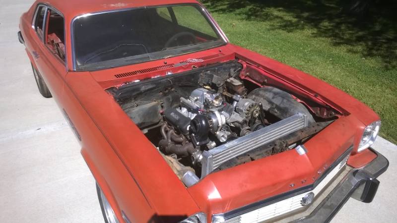

      engine set in for fittment, BGC intake, ATR stainless headers, 67 turbo, powerstroke intercooler

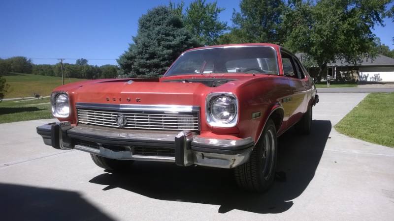

      must not weigh the same as the weak straight 6 it replaced nose bleed high in front

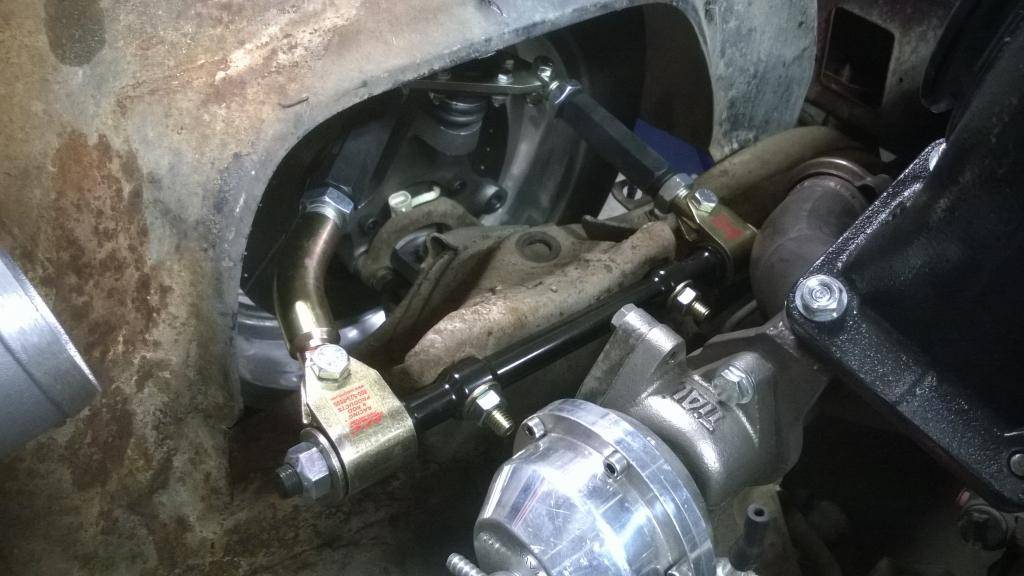

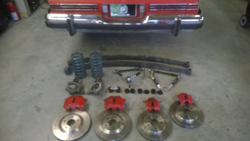

      This might help, CPP c5 spindles, SPC upper arms,hotchkis front drop springs, C5 brakes
      that's looking better
      Since these pictures were taken I have sold the CPP spindles , and bought a set of Speedtech AFX tall spindles and SPC arms, been waiting over a month for them and will post and update when I get them and have them on for mock up.

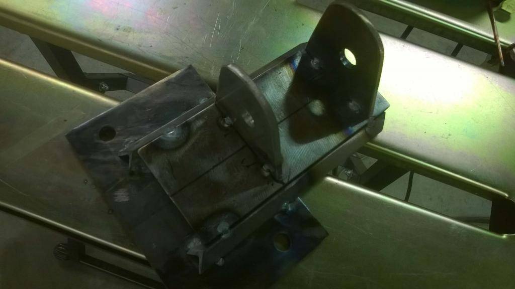

      Engine mounts

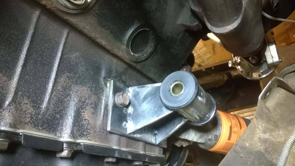

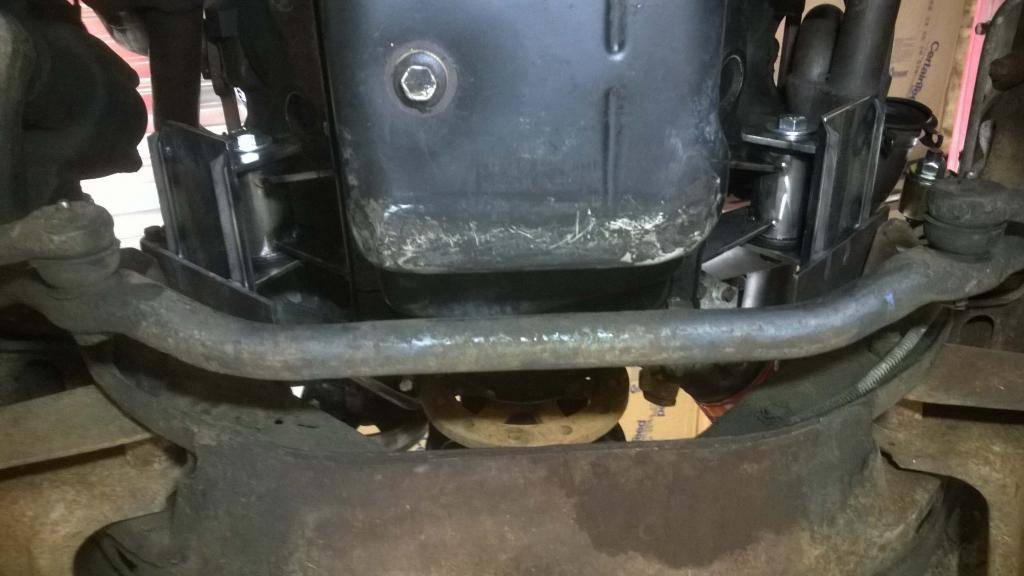

      Drivetrain is mounted, and this is what I did for the engine mounts. Since this engine was never offered in this subframe I had to get creative. I also did not want to use stock rubber engine mounts because they are known tot be weak and fail.
      I am very happy with the engine placement even though it was very tight. I can't believe how much real estate this little six takes up. I originally wanted to go the 455 route and decided this would fit better, not so sure now.

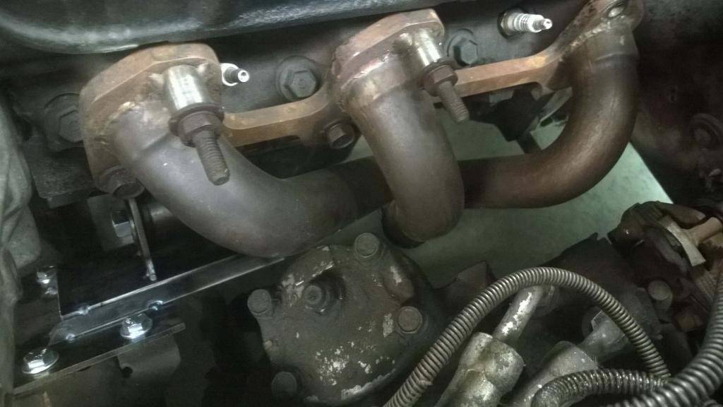

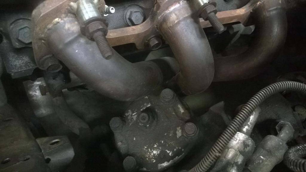

      Could not get the stock manifolds to clear the steering box, so I found a set of ATR stainless 4 bolt headers and they fit like they were made for the swap.
      Crossover pipe to upper a-arm pivot is close, but I have some delrin bushings coming that shoud give just a little more room.
      Started with the engine mounts, energy suspension bushings

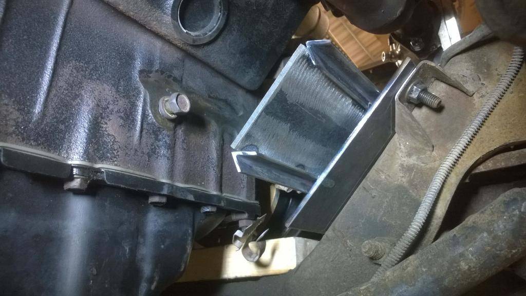

      Then moved on to the frame pads, they had to extend back from the subframe but this also pushed the engine almost behind the crossmember I like the set back.
      Also bought a TIG welder and am trying to get it figured out, not the best but...
      Transmission crossmember also did not work due to set back so I fab one up it will get it posted as well, stay tuned...
