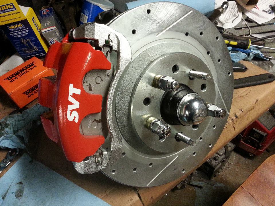

      Test fitting the new wheels and axle. modifying the original auto console to house a T5 shifter, lokar hand brake and all the on-board engine controls. Also got a killer deal from Roush on their 13.2" Mustang GT take-off front brakes. A quick call to mustang Steve and he shipped me out a set of brackets to mate them with my factory drum spindles. the original 67 strut rods needed to be replaced so I fabbed up a set of adjustable units.
