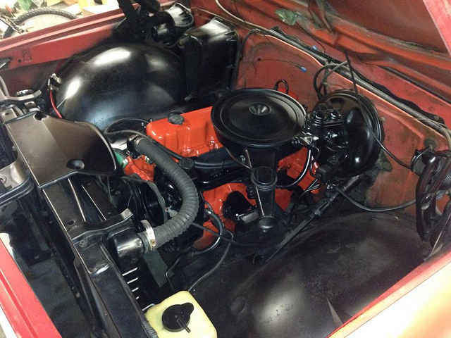

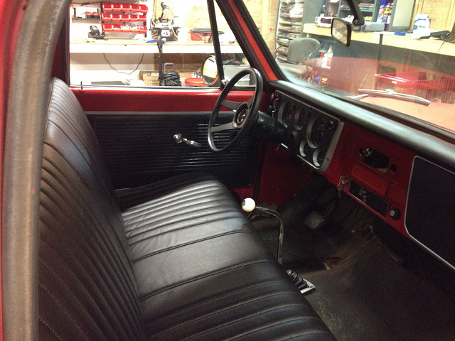

      What the truck looks like now:

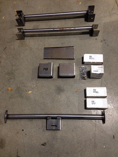

      Parts laying in the garage awaiting install:

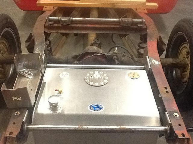

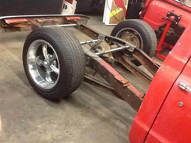

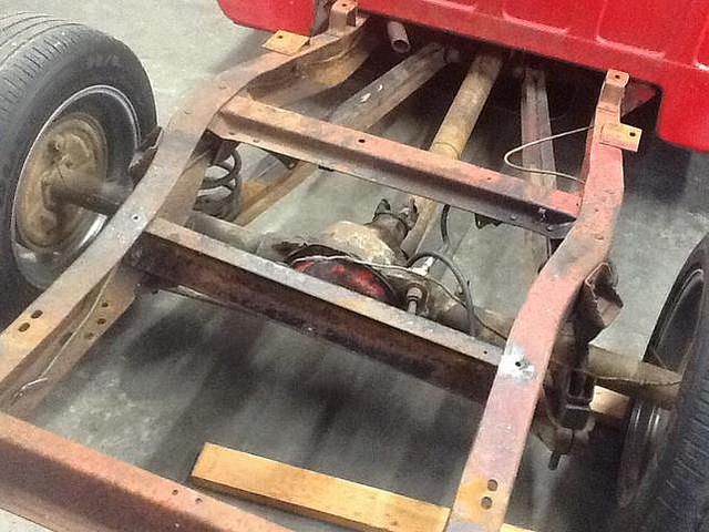

      Started mocking up the rear suspension:
      Before

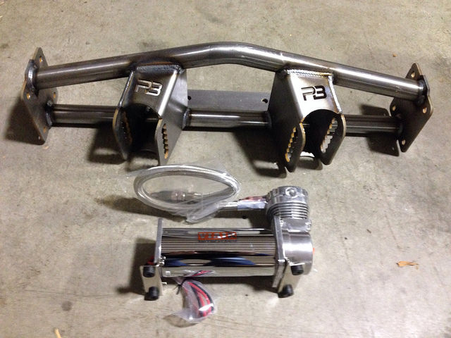

      Porterbuilt rear frame crossmembers installed and layed out the tank and air compressor mount
      C-notches installed
      Current look of the back of the truck

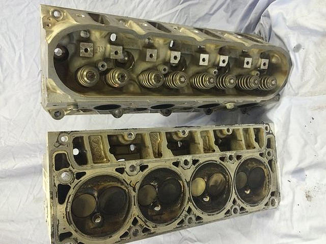

      I've still be doing a lot of reading, making decisions, and collecting parts. I picked up all of my valvetrain, currently leaning towards swapping the 317s for a set of 799/243s, and changing cams to either a BTR Stage 3 or 4 cam. I also bit the bullet and ordered a Porterbuilt Mild Front Dropmember, Tubular Control Arms, and Rack & Pinion steering kit. Should be here in the next 7-9 weeks.
      Shot of valvetrain stuff (boring pic)

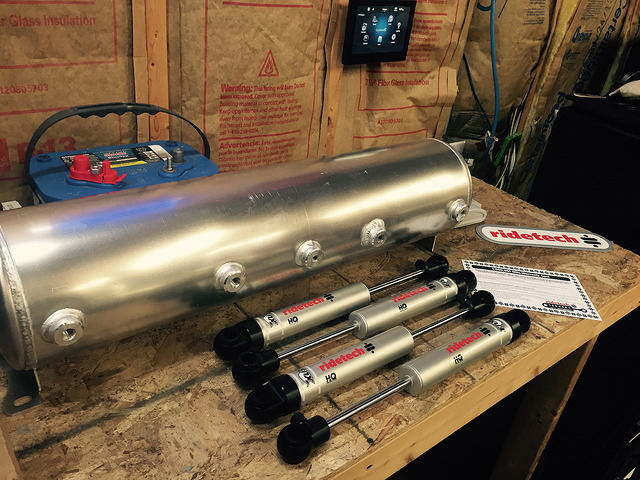

      Well summer is starting to wind down and its almost time to get back to working on the truck. Been collecting parts, but unfortunately still have more to acquire. Next on the list is as follows: T56, Brakes, Air Management, RT HQ Shocks. That should hopefully conclude the chassis.

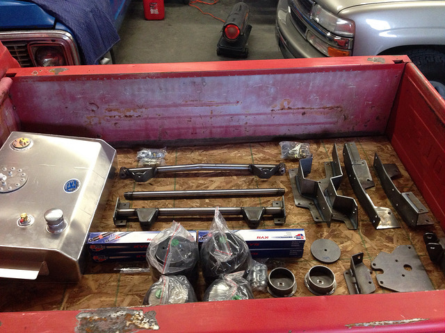

      Some goodies sitting in the garage waiting to go on the truck:

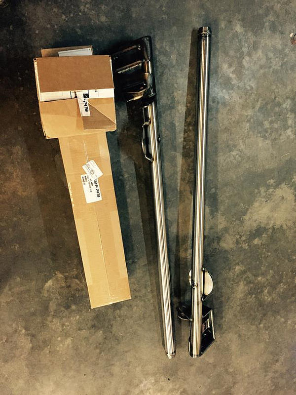

      Full Porterbuilt Level 1 front end with R&P and control arms
      Porterbuilt tubular trailing arms and longer trac-bar
      243 heads. Going to clean these up a bit, mill, and install my BTR valvtrain

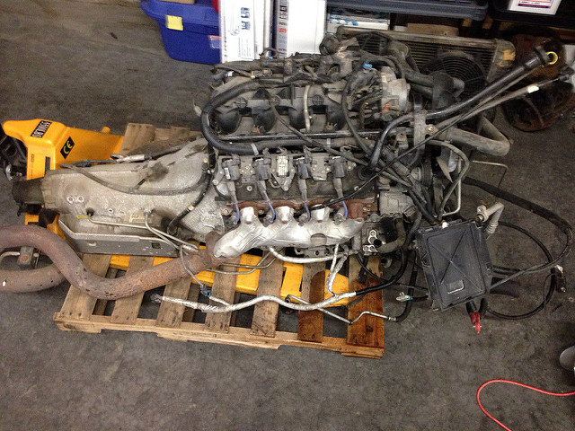

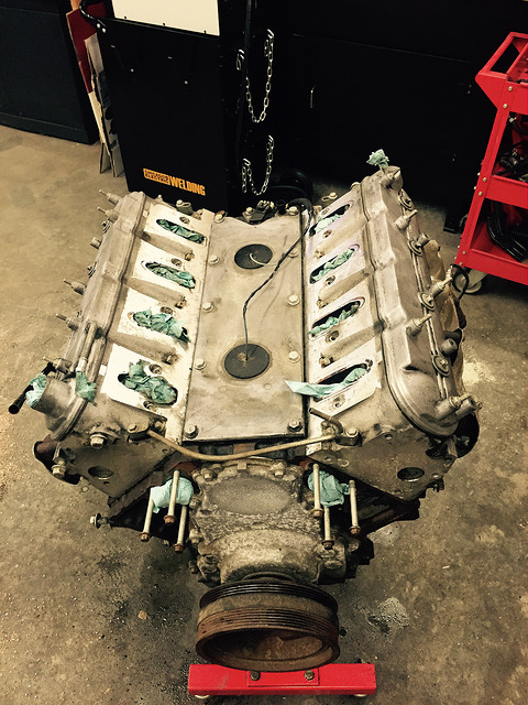

      Got the engine and transmission out of the corner of the garage. Engine is on the stand, halfway torn apart, and the transmission is with its new owner.

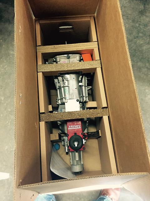

      I sold the 4L80e to make room for this guy: T56 Magnum

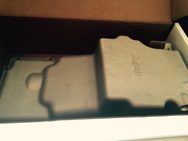

      And Summit delivered this along with a new oil pan gasket
      The boat goes in storage in two weeks and then its hopefully time to really start making headway on the chassis.
