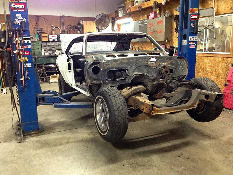

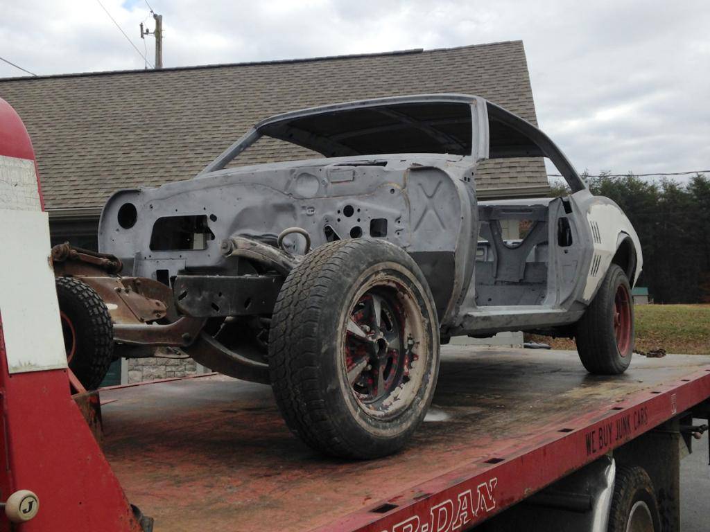

      Back in March, on the rollback, the day it left to my buddy's shop!
      Sadly, my subframe is quite a bit bent, and the cost to fix and restore it is about the same price as just buying a new stock style frame. Still trying to decide on my options. I'd love to go fully aftermarket with all upgraded suspension, but right now that's not in the budget.

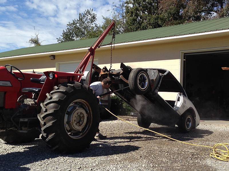

      Pressure washing the undercarriage. Floor pans need patching, so does my trunk, have all the sheet metal to go in. Doors were a little rough but are fixable (trying to salvage the frames and reskin the passenger side using AMD sheet metal). QPs luckily only need partial skins, and those will be going in once it's back from sand blasting.

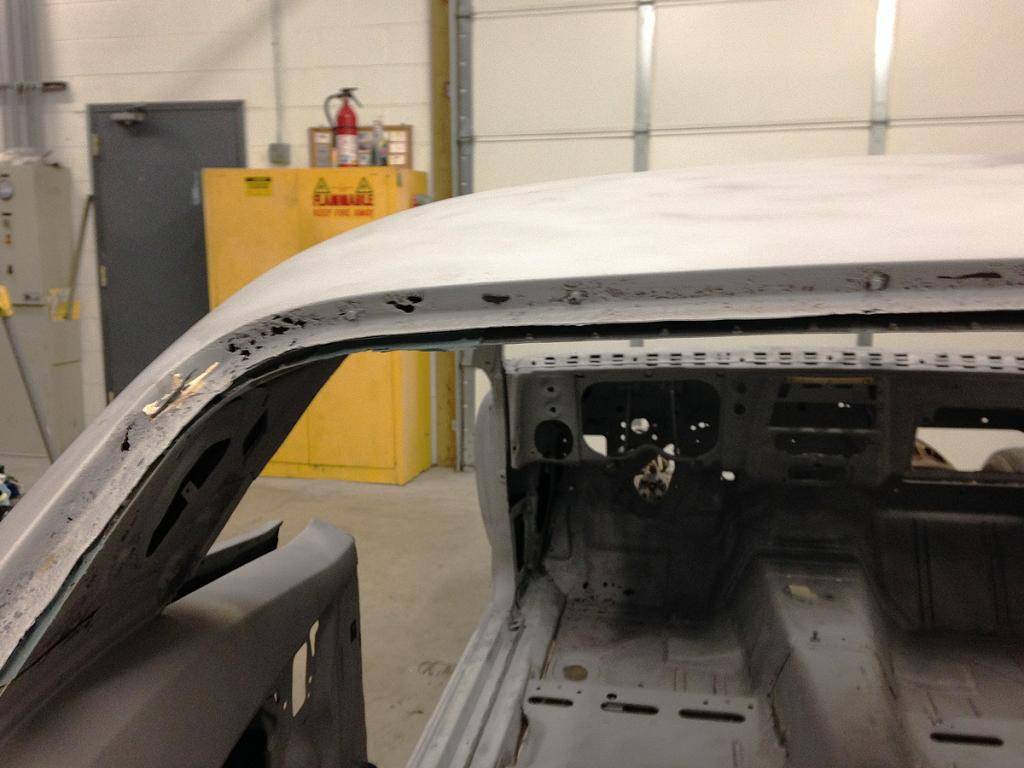

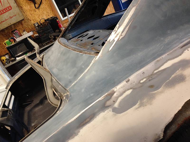

      Roof shot! (Of course it has a nice dent in it )

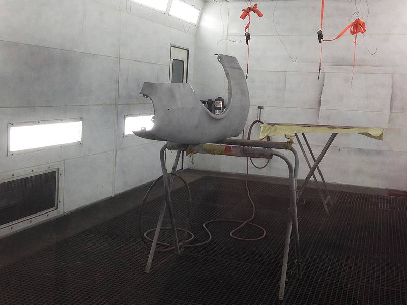

      I'm incredibly impressed with how solid the passenger fender was once we had it blasted. Only 1 major spot of rust that we cut out and fixed, and several tiny pin holes that have been closed up. Sadly, the car had been hit at one point in time from the driver's side, so that fender (god I wish I took a picture) had a 2'x9" chunk of filler hiding the obscene dent. We're thinking that same wreck was responsible for the bent frame. Fender wasn't really worth repairing and I had an awesome buddy I know through facebook spot me a brand new unused reproduction fender for the cost of greyhound shipment. Really curious to see how much finagling it'll need to fit right, but was pretty awesome of him to do that.

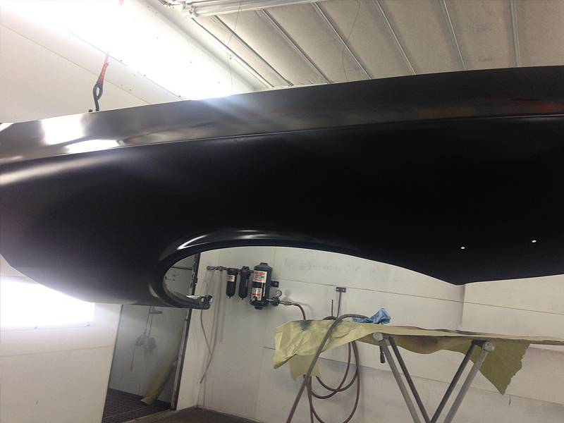

      RH fender shot in epoxy ready to be body worked! Again, very happy with my RH fender!

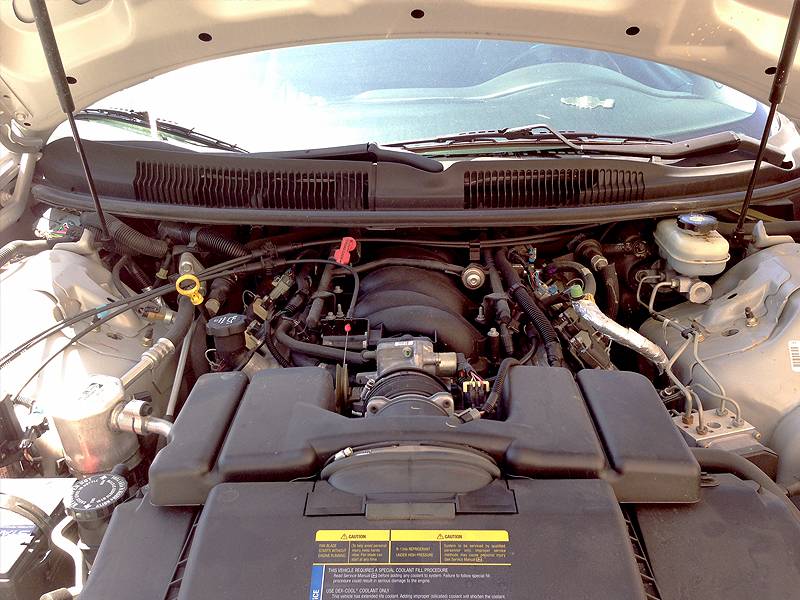

      I've already procured a lot of parts. I've got a full brand new Vintage Air unit that will be going in, new brake setup (Right Stuff) master cylinder, booster, stainless lines, etc. Have my brakes that I've already retrofitted and used a set of spare '68 hubs I had that I had turned down on a lathe to fit the rotors off of an '02 Trans Am. Figure those late 4th gen brake components will hold me over until I can get a more beefy brake set up. The wheels may be 17in Year one Rally 2's to accommodate the disk brake and wider wheel/tire setup. Not tubbing the car so only going I believe 8 in the front, 9 in the rear. My buddy has a set on his '70 Judge that I plan to steal for a little and see how I like my car with them.
      And the parts car we scored. Yes, some insurance company totaled it out. Has some front suspension damage (think it slid off the road), and had quarter damage that we have since rednecked the dent out. The car is a solid running car with service records. Almost hate to tear it down but, I want/need the motor.
      42k miles, the entire car is super clean.

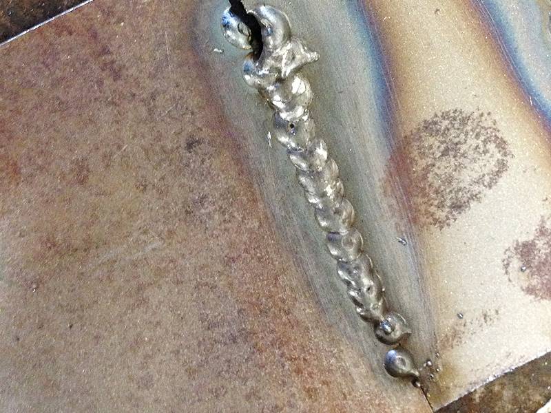

      For those who are curious about my amateur welding skills, I haven't actually welded on the car. My buddy who has been building old cars for years has been doing all the metal work; though he is giving me welding lessons whenever we've got some extra time. Here's my first attempt at MIG Welding! Don't laugh too hard. ;)

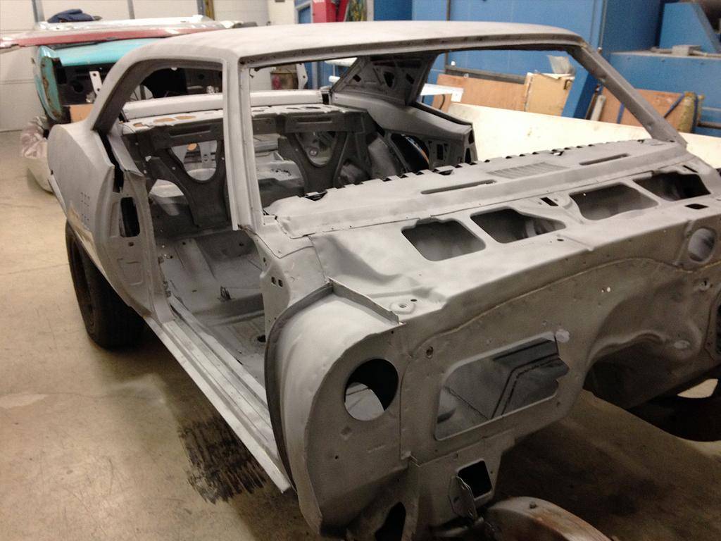

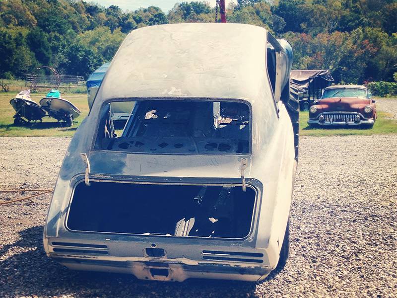

      We FINALLY were able to pick up the shell from the media blaster. He only blasts on weekends and we had a lot of rain and his compressor had a sensor that ended up going out when he first started shooting the car. Long story short, the shell is finally done, and here are the results and what we found:
      You can see the damage where the radio goes... Someone had a field day whacking it to pieces apparently. Needless to say, I need some replacement metal for it if anyone knows of anyone reproducing it or a parts car of some sort. Ignore the transmission tunnel, that was previous "fixed" by some previous owner, which is currently on the list of un-do and re-do properly.
      Doors are currently being blasted as well as the rear end. I think it was worth the wait for this guy, very pleased with the diligence he took.

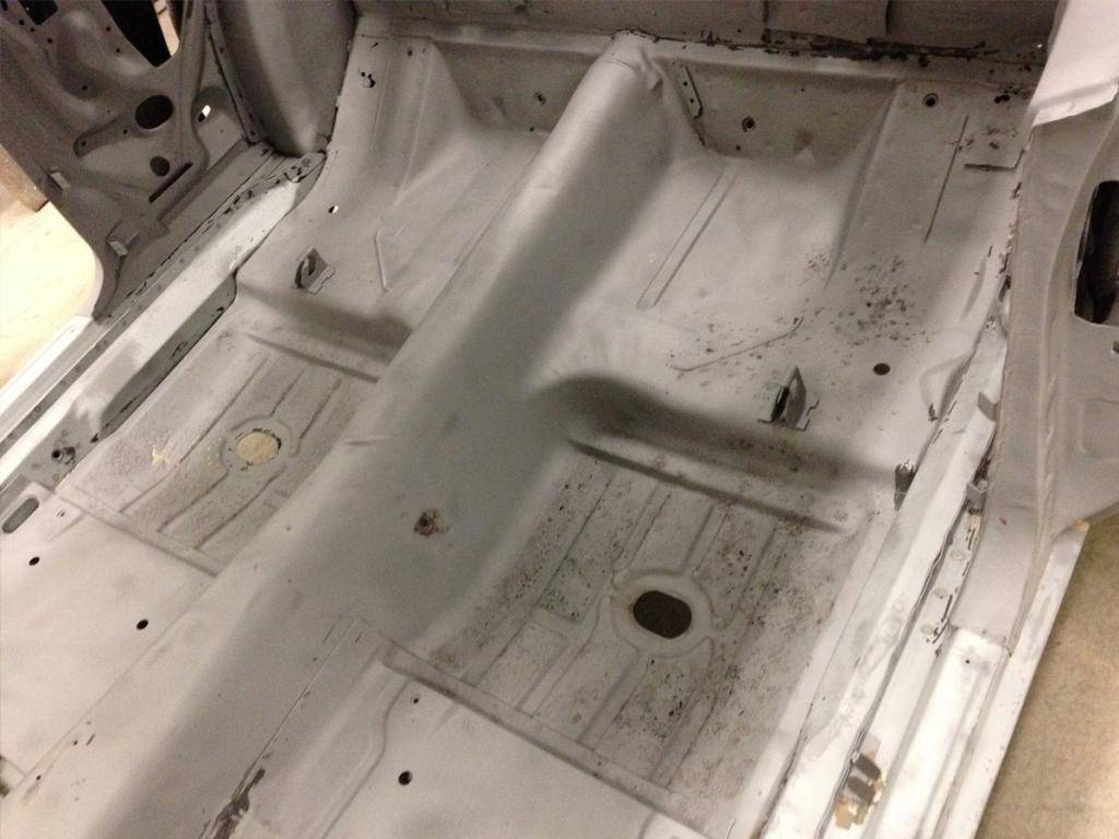

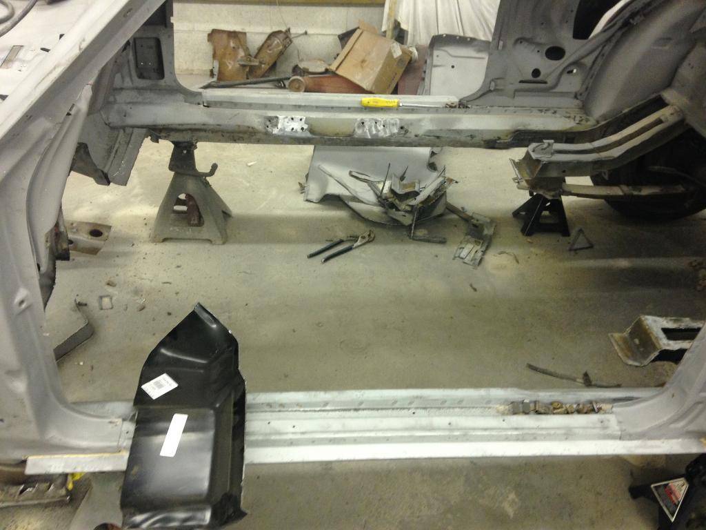

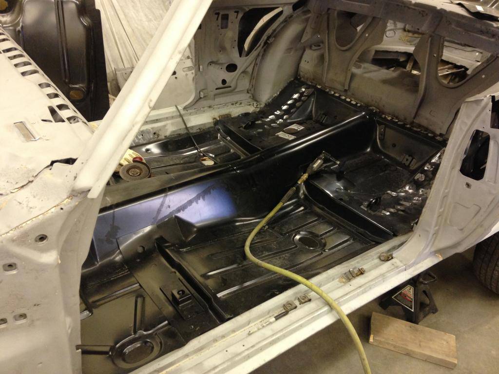

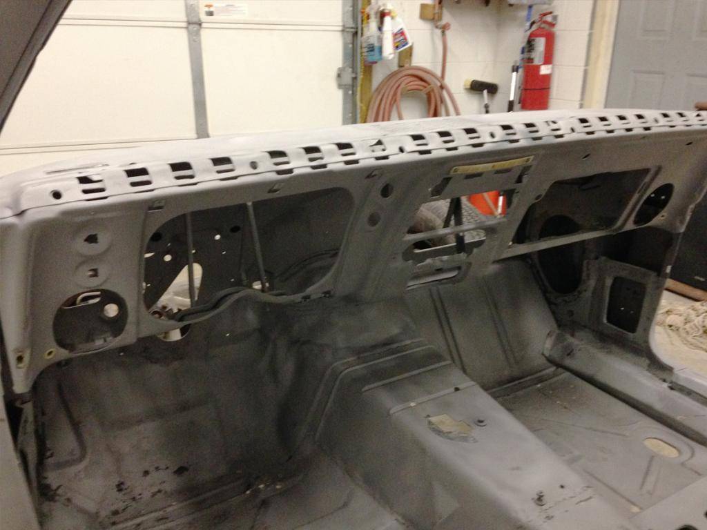

      Okay, so a TON of work has been done since I last posted. Full floors to firewall (went with the heater core delete firewall), partial quarters, inner fender wells repaired, had to source another subframe since mine was bent, new passenger side door skin, both door frames had to be repaired, got a new trunk lid as original was warped, new hood (went with 400 hood), new lower valance, core support, new inner fenders, list goes on haha. I'll just share some pictures. ;)
      So all of this work started January 5th, 2015

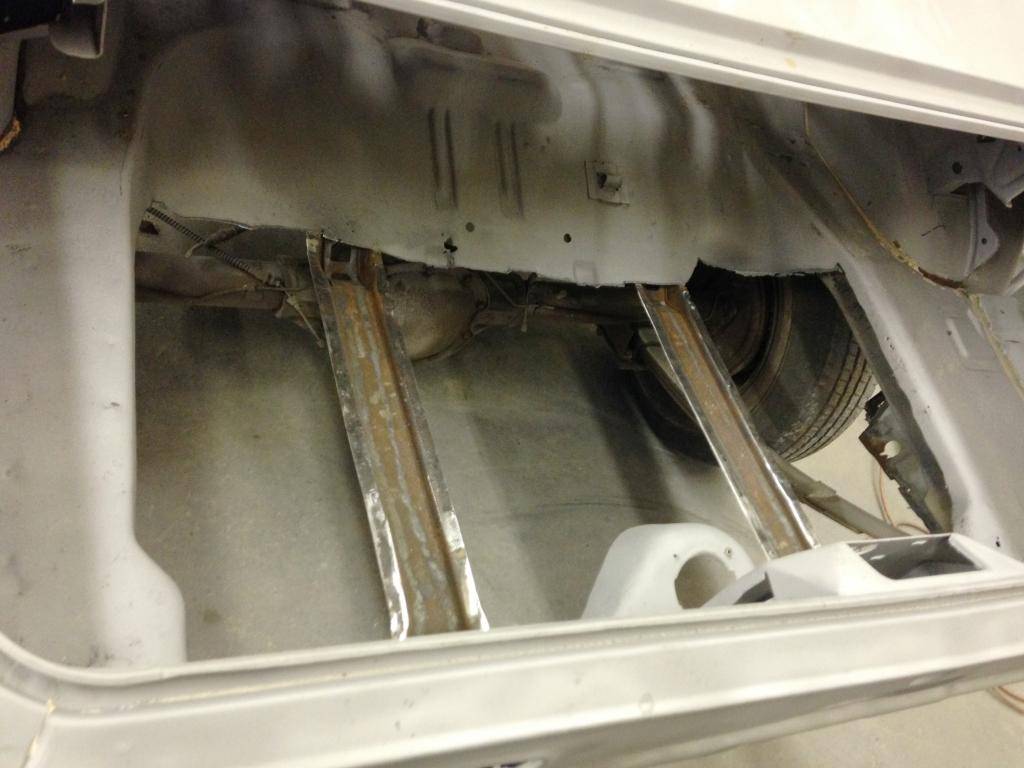

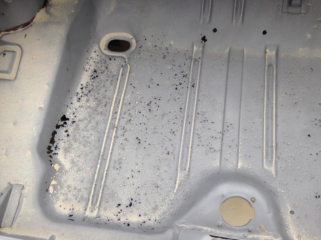

      The floors were pretty much entirely full of pinholes. Rather than trying to patch it every where, we opted to just replace the entire floors. My transmission tunnel was also cut to hell by a previous owner, so a new floor fixed that issue as well.
      There was a bit of rot up into the toe boards as well.
      New floors in.

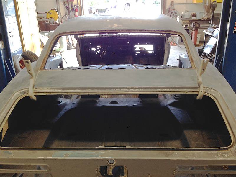

      Old trunk gone ;)
      New trunk in.

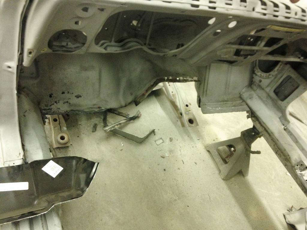

      Repaired & epoxied driver's side inner fender well.

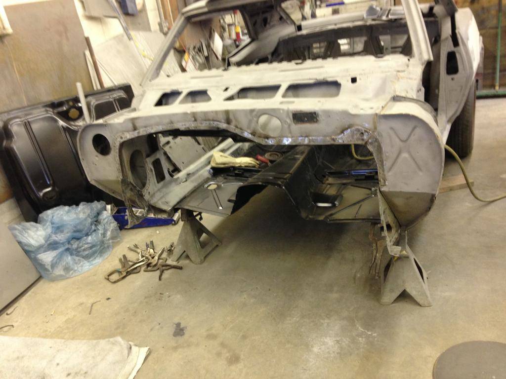

      Inner fender repair on passenger.

      Got some epoxy up inside the firewall since it was blasted and well, the firewall was out, so why not? haha.
      New firewall in and sealed up.

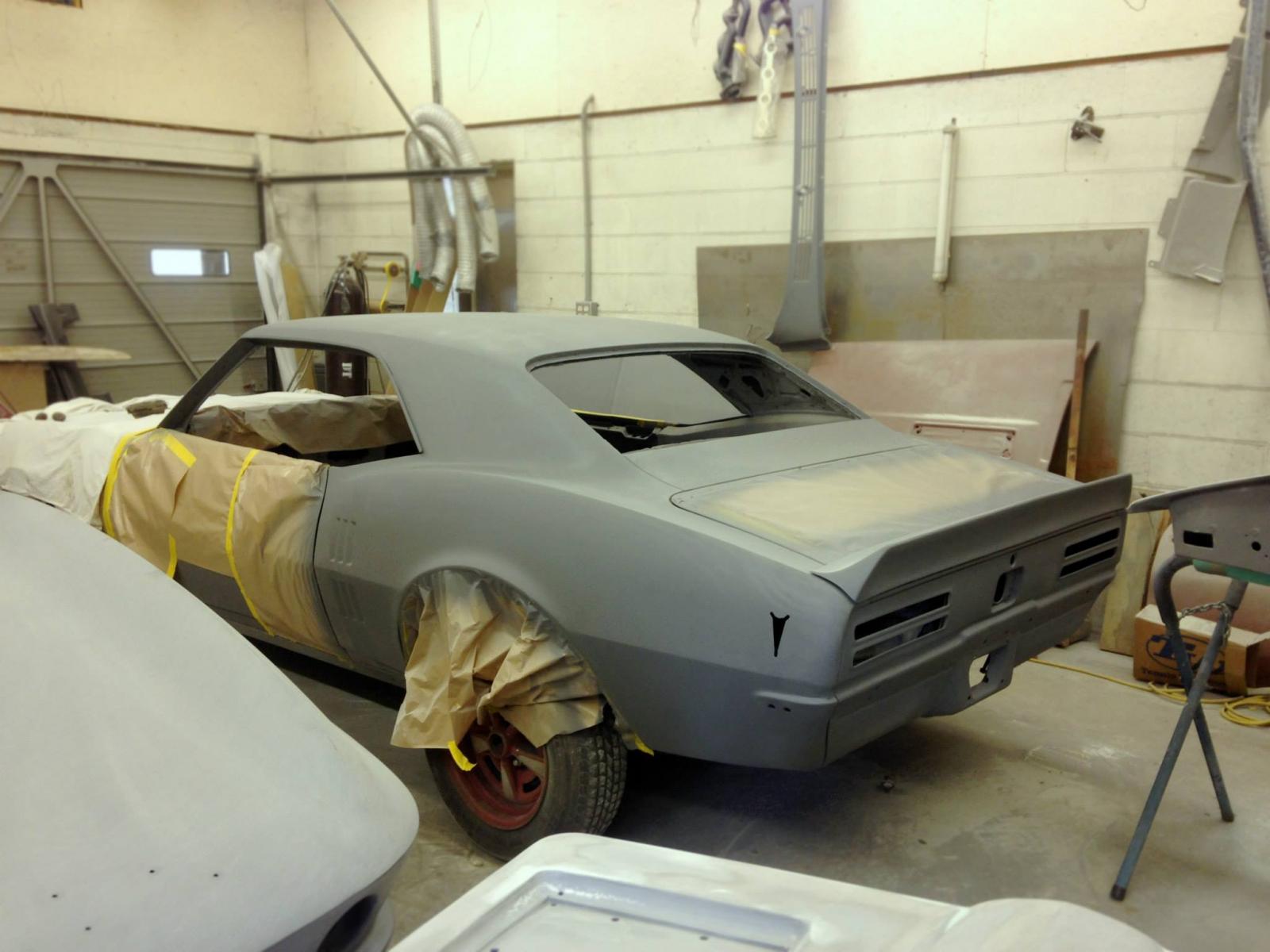

      Body workin'
      Even had to get a new spoiler. My orginal '68 Camaro spoiler had all but one post broken hah.
