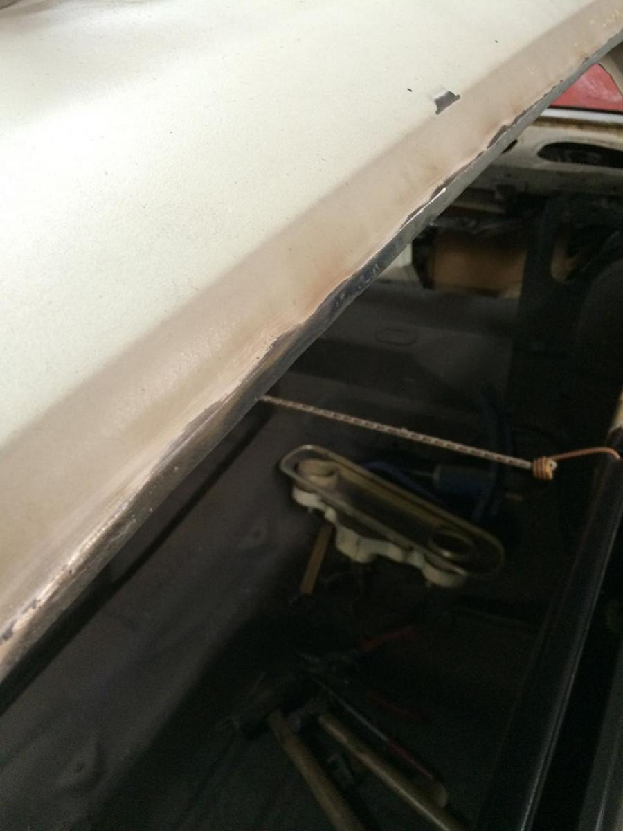

      Drip rail shaved and welded (still need to tweak a small area at the front and fix a couple spots where the roof was joined (lead) and the quarter panel was joined (bondo by previous owner):

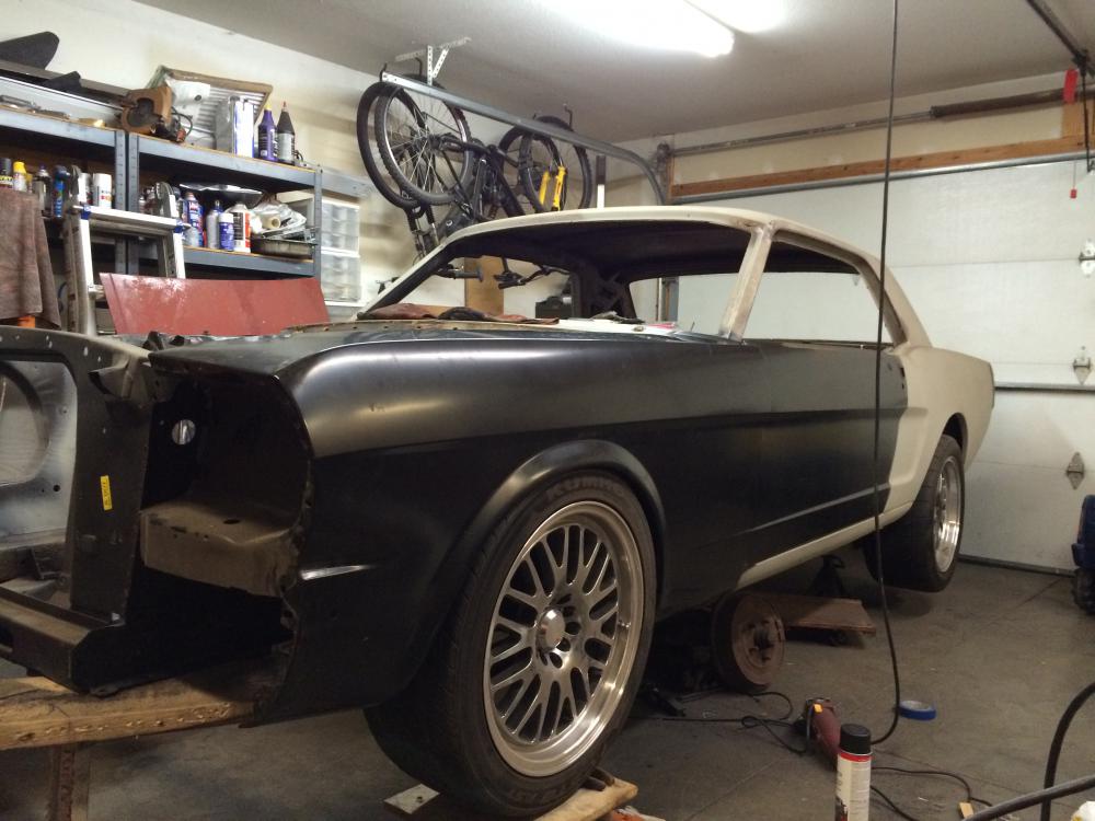

      Oh, and quick mockup with the fender and wheel (ride height will be a tiny bit higher than this, but it was close enough).
