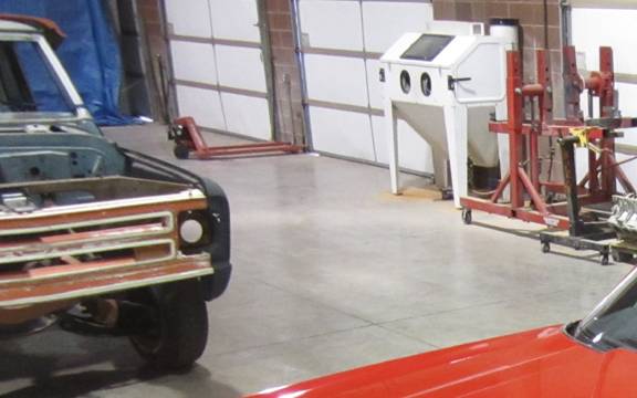

      We've been hankerin' for a hauler for some time now, we needed a good excuse to develop some new suspension parts for the 67-72 C10 crowd. Well this little p'up wandered into the shop lookin' like it had a pretty tough life. It's got quite a history, we'd tell you but we really don't know what it is, lol. Needless to say, there wasn't one matching color panel, it was missing half it's parts, it had rust all over and it looked so bad it would run and hide every time a camera came out. I barely got this first shot while it was hiding behind the paint booth.
      After hiding in the corner of the shop for several months the stars aligned and the truck came out with a pretty serious game plan. Instead of simply adapting our suspension to it's battered frame we decided to start fresh. So along with this build will come one of the first of Speedtech's new line of full frame products! These frames will offer super low stance, proprietary front suspension geometry based on our ATS tall spindle, a little bit of a straying away from the norm out back, and some subtle body mods to create a look that hasn't been seen before. This is a side project being built for us to play around with so follow along over the next few months as it all comes together.
