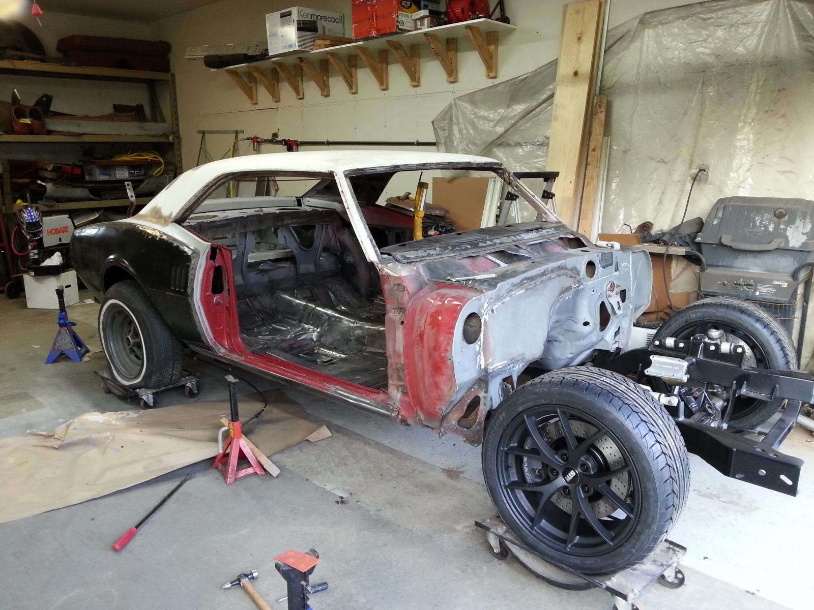

      Ok so here goes. I have a 1968 Firebird and I'm doing a LS conversion pro-touring build. I have an Art Morrison subframe with the C6 front suspension, and I decided to try something different and fab in an irs from an 05 GTO. I was able to pick one up for $500 and I just thought I'd give it a shot. I had found a few threads about trying to use the gto rear suspension in a 1st gen, but they always seemed to just end. So after a lot of trial and error and plenty of head scratching I've finally got it stuffed in there.
      Here is what it looked like when I first brought her home:

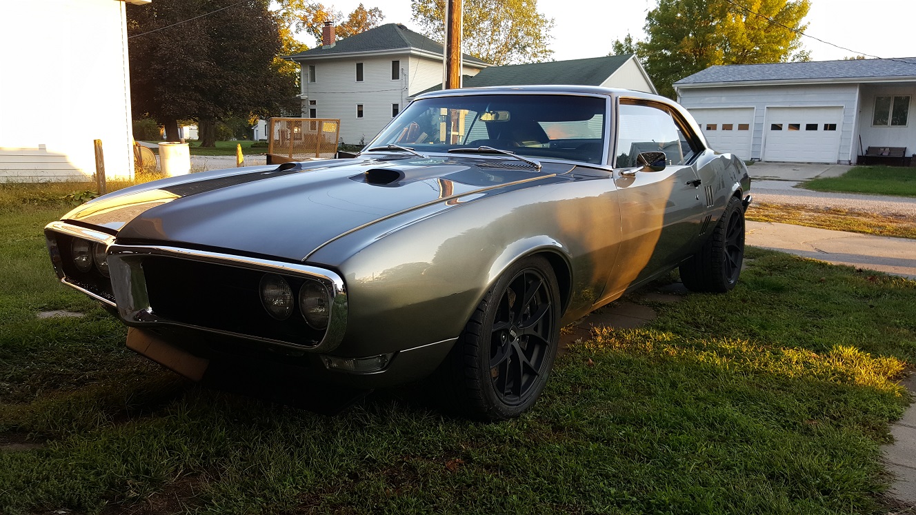

      Mar 2010
      42
      The To Do list is rapidly shrinking. She runs and drives and most of the interior is done. Still need to get the back seats covered and installed, but I don't need back seats to drive it! Still working out some bugs but overall very pleased with how it runs and drives.
