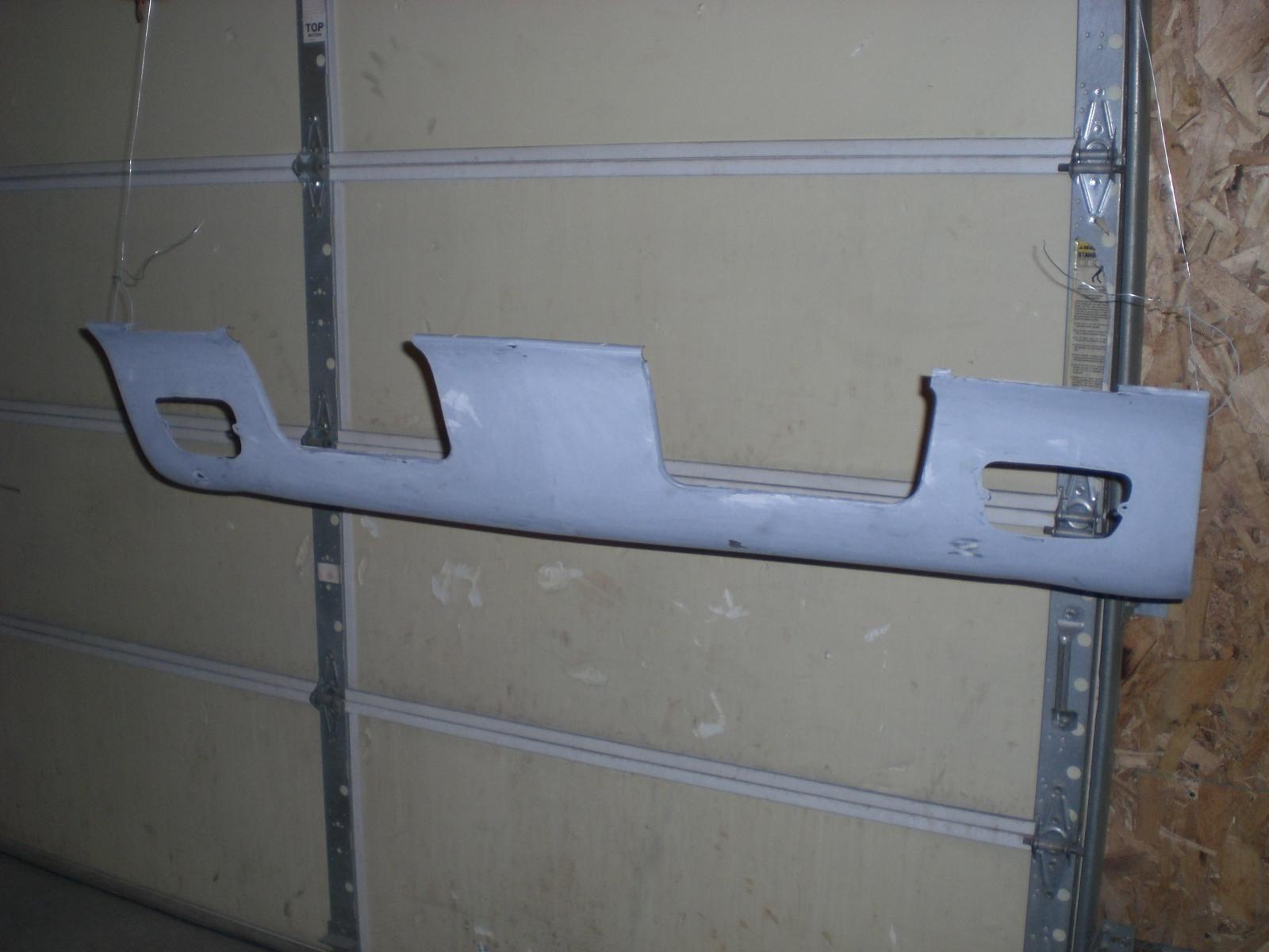

      Well' once that was finished the mods needed to continue to the lower vailance---
      To complete the nose, a camaro vailance was used. The air openings were narrowed about 6" giving me just enough room to put in a set of "frenched-in" '69 parking lamps. The narrowing of the openings put their start at the inside edge of the headlamp instead of some random point the factory chose, and the park lamps are centered between the headlamps. ALSO---the center X of the park lamp grill was removed and to my pleasure the shape of the remainder matched the curvature of the bumper perfectly.

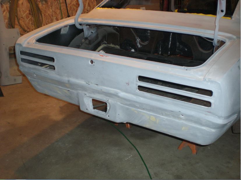

      And well, Since we are on the topic of bumpers, I don't like the Firebird rear bumper either. It is WAY too much for the car-----
      I knew I couldn't just put a Camaro bumper on a nice Firebird, puritsts and mod-guys agree on ONE thing-that. So I set out to make something that was neither camaro or Firebird. The rear "split" bumper is 2 camaro bumpers that gave their life and were split-chopped-modded-and welded back together. It is tucked in nice and close with 1/4 gap all around and I plan on having it re-chromed. The '68 fuel fill is filled-in and fueling will be accomplished behind the flip-down liscence plate using a '69 Firebird gas tank.
      All/all the cal has the "feel" of the stub-nose Camaro, but still maintaining the Firebird styling. I plan on the original black vinyl roof and a modern charcoal grey paint.
