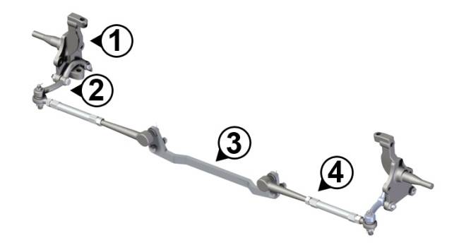

      This upgrade is useful just for stock power steering or also for rack and pinion ?
      Installing this upgrade on a stock power steering I can avoid to substitute it with a rack and pinion to have a better steering/handle ?

      Its designed for stock steering systems and will not work with Rack and Pinion, the Tru-Turn eliminates bump-steer, (1) the tall spindle that comes with the system it help the camber curve and gives you better handling (2) has shorter steering arms to increase steering ratio and allow a wider front rim and relocates the steering pivot higher (part one of the bumpsteer system) (3) the center link locates the inner tie rods to the correct pivot point to reduce bumpsteer (part two of the bumpsteer system) (4) Tie rod assemblies with billet adjuster sleeves and Hiem joints (the third part of the bump-steer system)

      So, with the Tru Turn the car will handle better than a rack and pinion ?

      might not handle significantly better than a well dialed-in rack system but it's a great alternative to all the changes you might have to make to do a rack in some chassis setups. My Camaro is a pita to do a rack on but the ride tech will pretty much bolt right in with no welding, etc. It's all in what you feel best with.

      the problem with adapting a rack to an early frame is in the packaging......if you look at a corvette chassis c4-c5-c6-whatever the rack sits as high as the middle of the front dampener pulley..... because that was the area needed to match the control arms pivot points, so on a camaro (rear steer 67-69) the rack would have to be so high, you would have to notch the pan all the way to the crank, to get the pivots points lined up....so they mount it low and some give you steering arms that almost make up for the arm inclinations, but now the racks arms are at such a weird angle they have to limit steering movement as not to bind the ball joints,..... so the cars still have noticeable bump steer, and less steering radius, I have seen some claim they don't limit steering or don't have bumpsteer....I call BS on that....but they can send me a rack if they like and we will put it on a stock chassis and see what it does

      I took a rack off my car to run the True Turn. Yes your car will handle better with the True Turn. I would stay away from the rack. I had bump steer issues & it is a packaging nightmare. Do the whole ridetech setup. You will not be disappointed.

      Before the Tru Turn Kit, Many did the Rack kits, a lot fought the install, some didn't. Now, the Tru Turn has changed everything! We have many happy customers running a well engineered system that does what its advertised to do!
