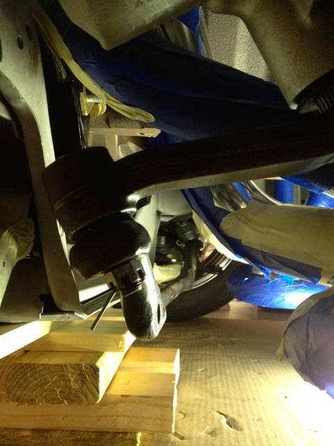

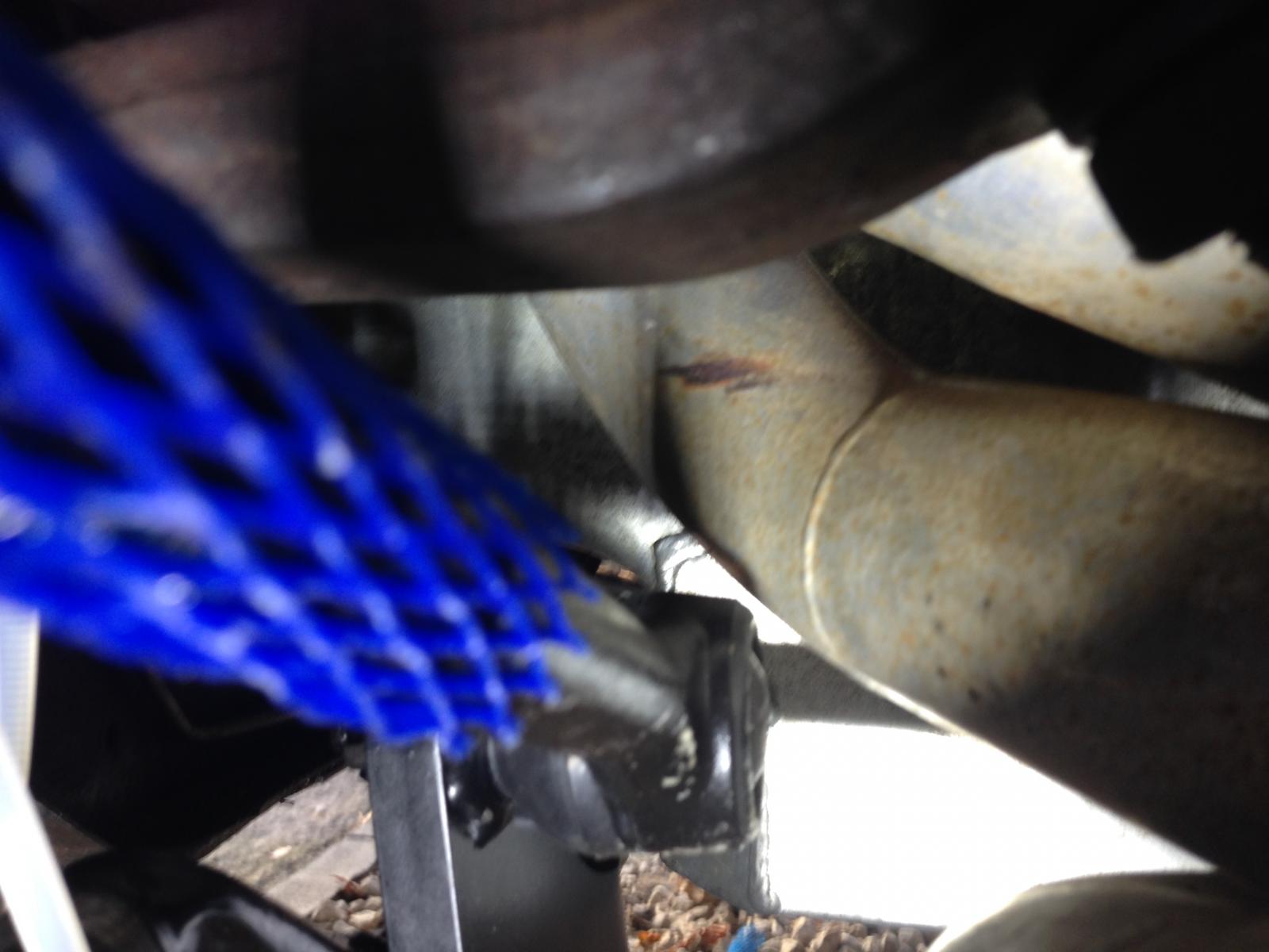

      I will get some more info up later on, but here's a pic of the drag bracket bolted to the drag link. I will bolt it up and see what or if it hits anything.

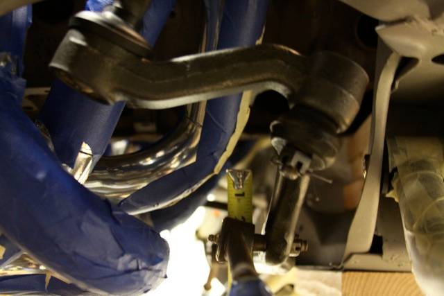

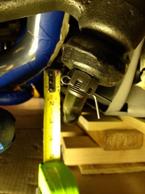

Size:  173.1 KBName:  IMG_1706.jpg
Size:  111.6 KBName:  IMG_1707.jpg
Size:  149.2 KBName:  IMG_1708.jpg
Size:  120.2 KBName:  IMG_1709.jpg

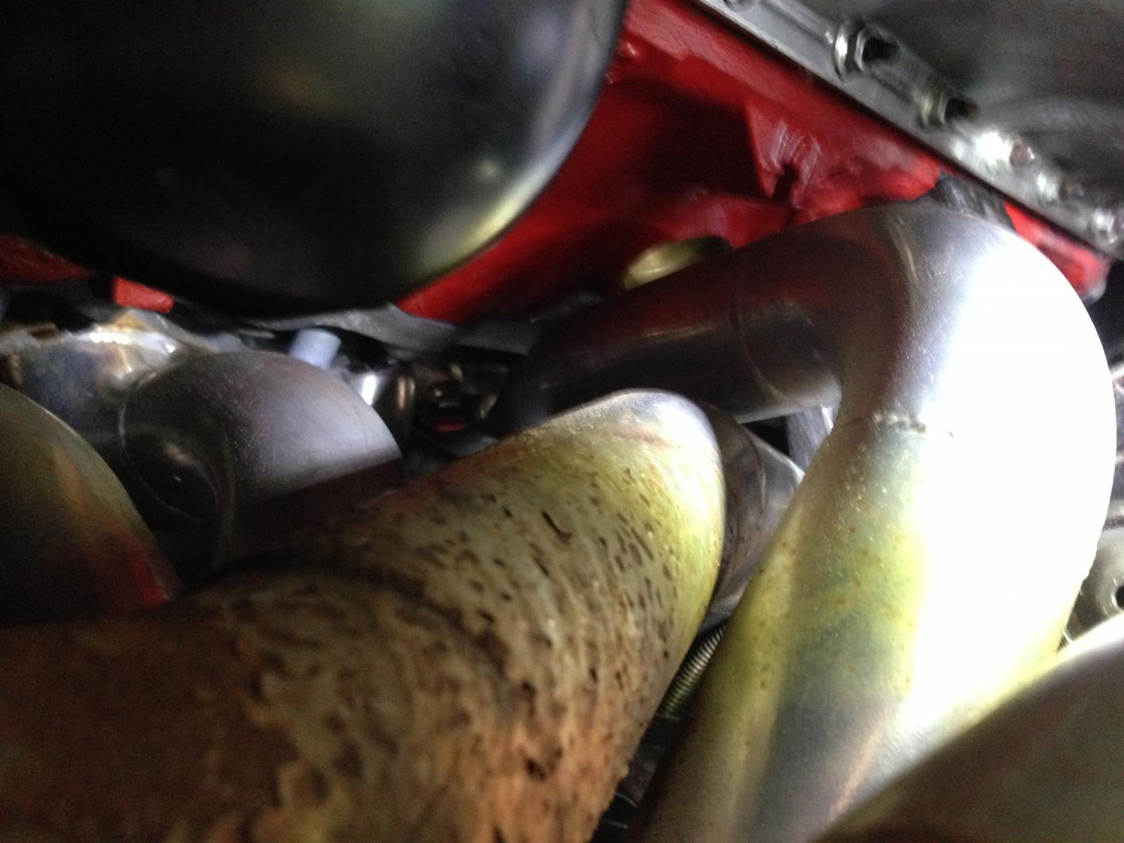

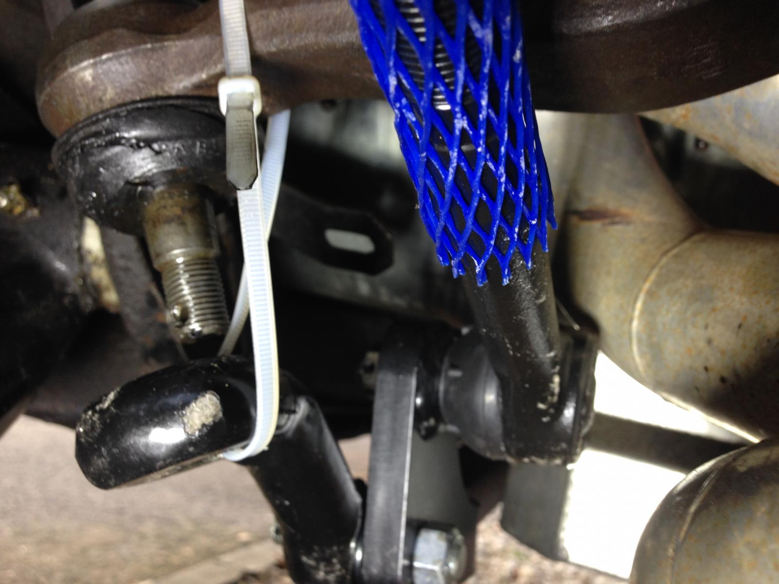

Size:  147.2 KBName:  IMG_1711.jpg
Size:  183.6 KBName:  IMG_1712.jpg
Size:  152.6 KBName:  IMG_1713.jpg
Size:  108.7 KBName:  IMG_1716.jpg
Size:  145.3 KBName:  IMG_1716.jpg
      Nov 2010
      107

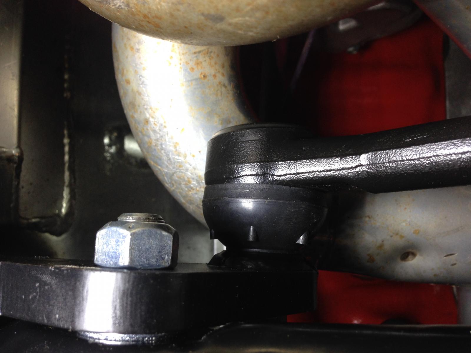

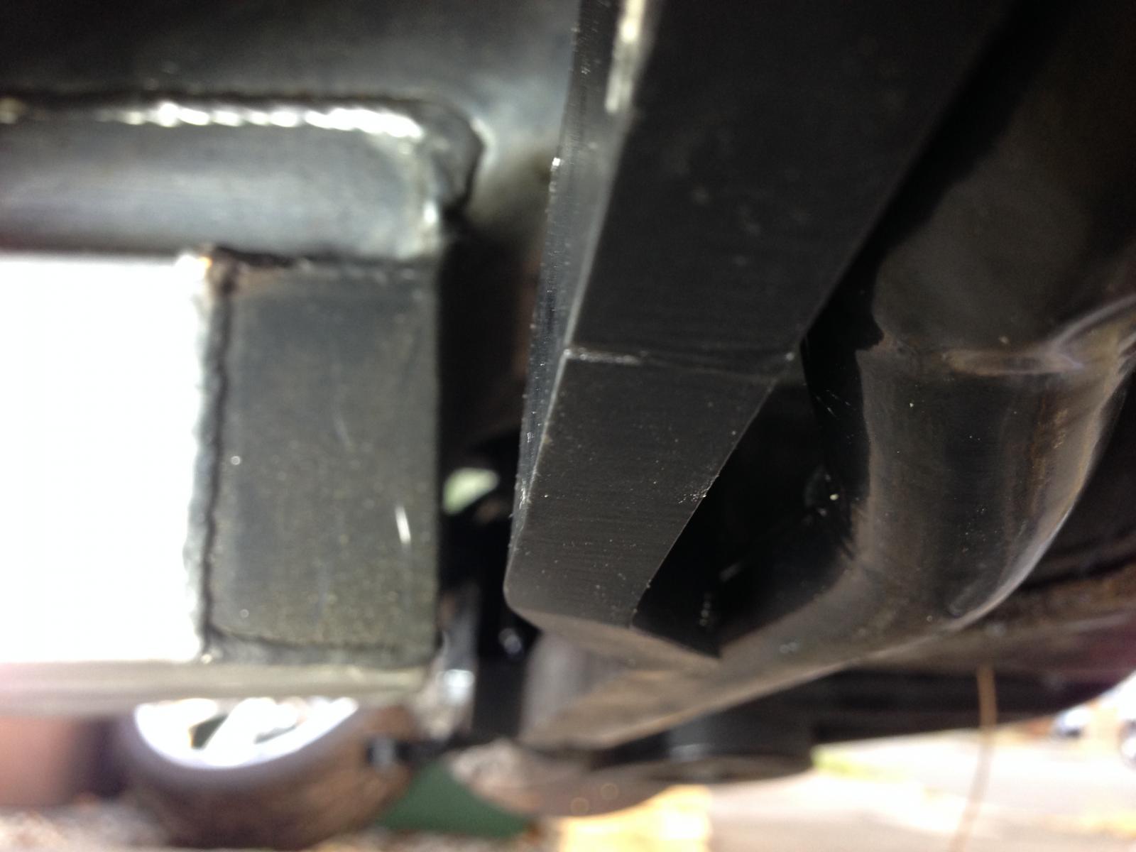

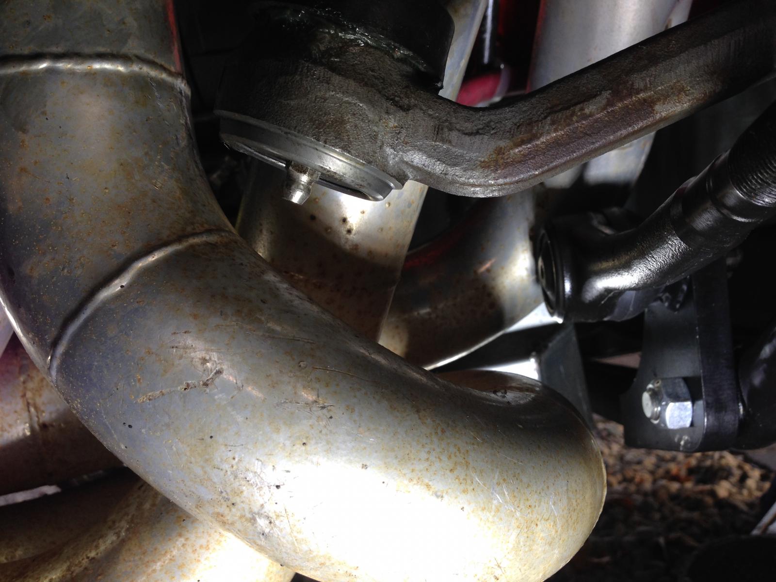

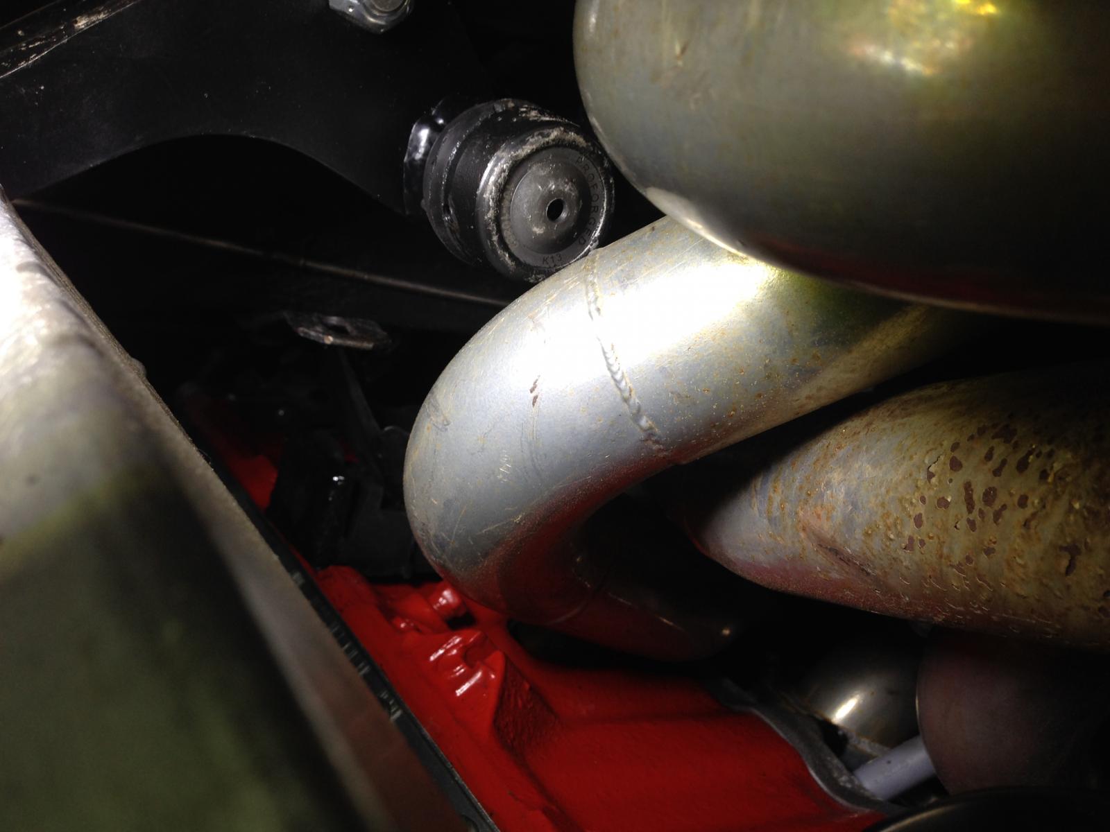

      Well bad news, but not too bad. Headers are Lemons #BBPT-600 and they hit exhaust tube #3 & #4, but there is room to have them cut and have the bend moved out of the way. I tried to take as many photos of it as I could, but if anyone would like a different pic let me know while it's still on. I will probably leave it in for a week or so until I decide if I will have it all done now or wait. The drag bracket looks to clear the oil pan with a little bit of wiggle room. The oil pan is Moroso Street/Strip Oil Pan 20403. The motor mounts are stock for big block, or I believe to be. They aren't aftermarket or solid. My drag link seam to be worn according to the instructions and the bolt that mount the bracket to the drag link go a bit to far into the drag link or at least that what the instructions say. New one on order though and I'll see if it's any better.

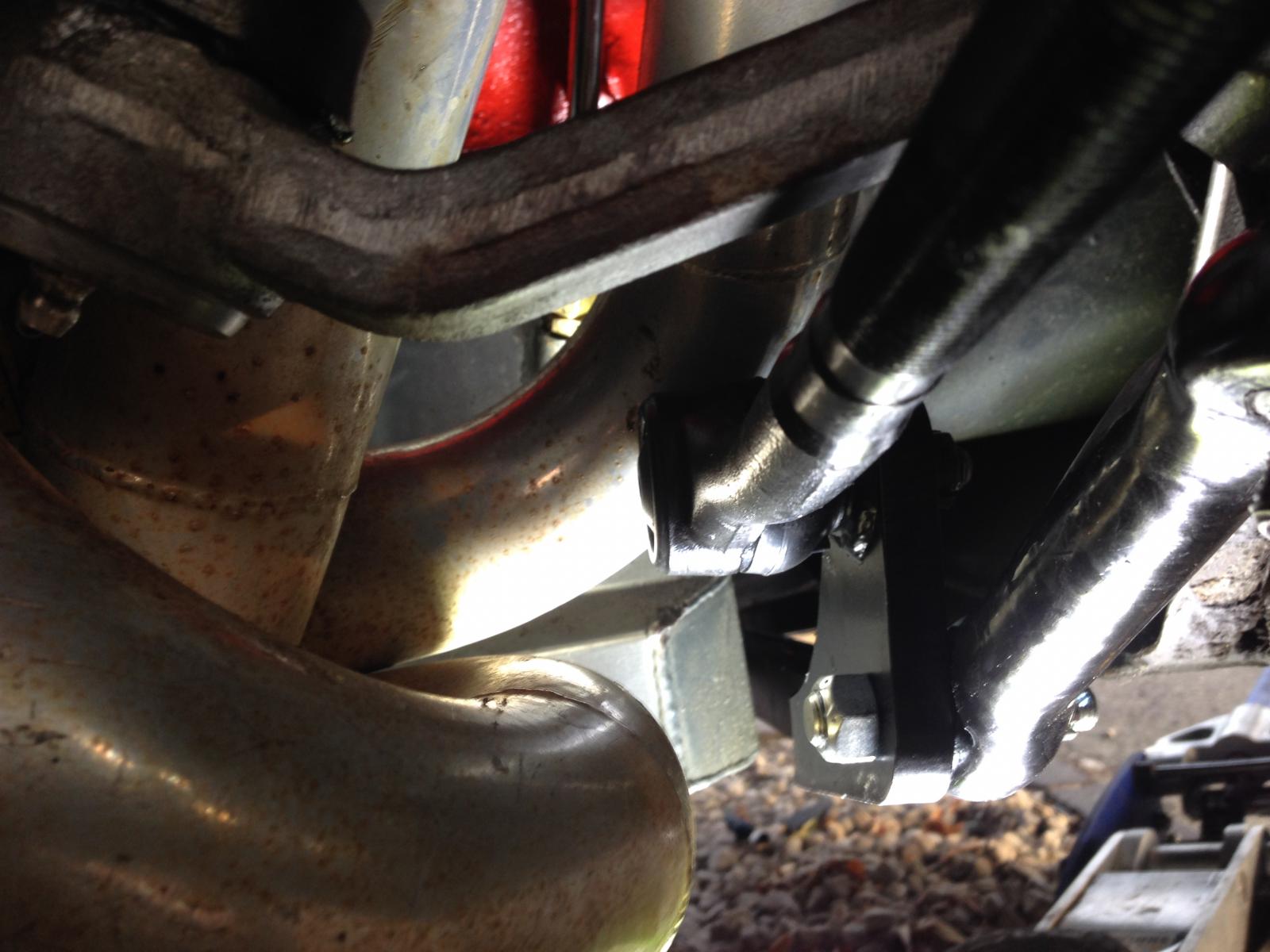

      It almost looks like my Lemons headers are slightly different than your set. When I mocked mine up I dont remember having issues on the driver's side. However, the passengers side would definitely hit the tube as you can see in the below pic. Later I had to move my drivetrain back about 1" for unrelated issues. That helped with clearance but sadly still wasn't enough to clear the Tru-Turn. I'll likely end up having the tube modified to fit but emotionally I havent' come to terms with that yet :-). I've got a ways to go and mine is torn back apart at the moment to have the heads flowed. Since different heads locate the exhaust ports differently, I want to make sure these heads are what I'm going with before I start more aggressive surgery to get it to fit.
      Here is similar view from driver's side. It might hit as the arm moves through the arc but not sure. I didn't worry too much since I knew at the time the passenger's side was a mess.
      Lastly, here is another shot from passenger's side after I moved the drivetrain back. A good bit more clearance but still not enough as I mentioned.
