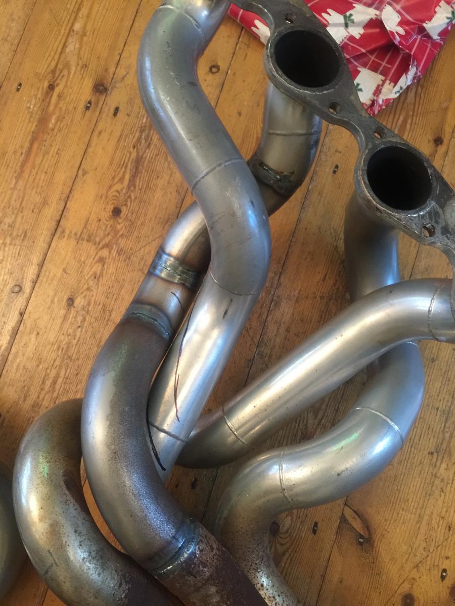

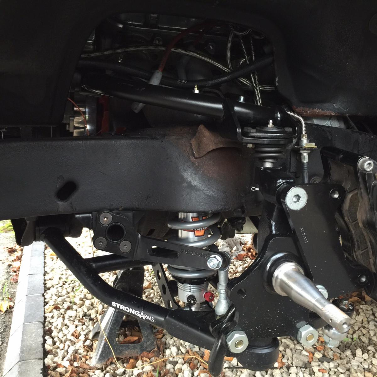

Size:  165.0 KBName:  image.jpg
Size:  175.5 KBName:  image.jpg
      Sorry for the long delay on the update, but finally got the shocks installed and sway bar. Everything went ok during the install. Next is to have the headers modified so the don't hit the raised steering arms. I will post pics of the finished headers afteris gets back fro the chassis shop.

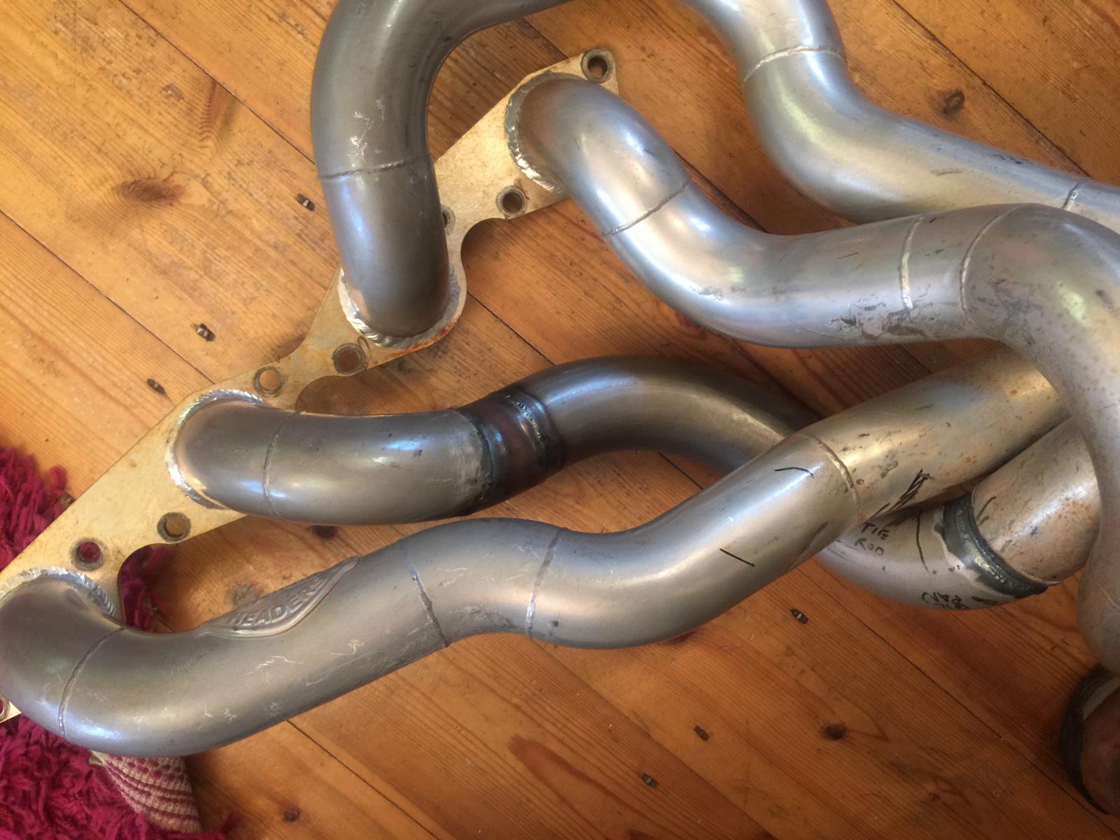

    6. #26
      Nov 2010
      107
      Ridetech Tru-Turn with big block
      Finally got the headers finished and received my spacers for the front coilovers. I contacted ridetech and they did not offer any spacers for the strong arms but found some after contacting chassis works. I will post some pics up when I get on the computer.
Size:  207.1 KBName:  IMG_0453.jpg
Size:  139.5 KBName:  IMG_0452.jpg
