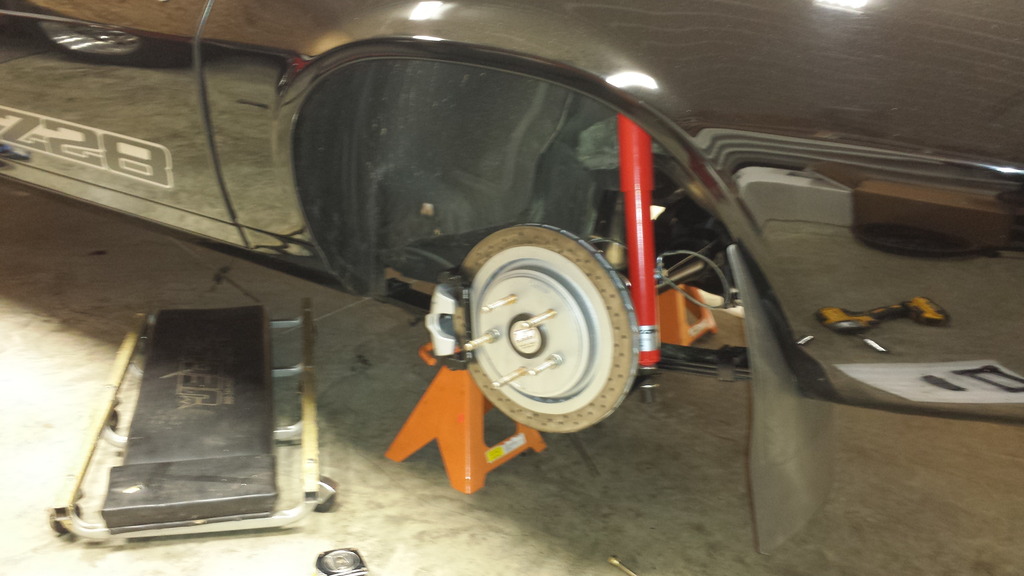

      I got the drivers side mocked up. The front brake lines are done and the rear line is bent up just needs to have the shut off valve installed for the parking brake.
      Going to finish the pass side tomorrow
      This year I am just bolting all the parts on the car and next winter when I change the engine and trans the car will come completely apart and everything will be blasted and coated or painted. Vintage air going in.

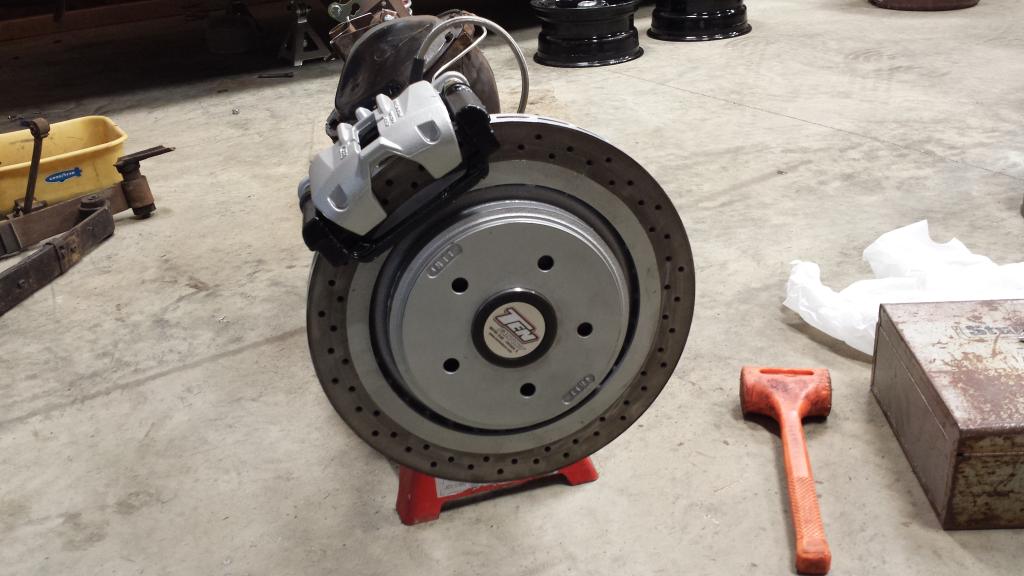

      Quote Originally Posted by gray86hach View Post
      Well the axles were not a direct bolt in the brake pilot had a step in it for some reason so I had to turn that down.
      Attachment 108547
      Could you elaborate a little more on this...I'm not understanding what you had to do here.
      Also, Is the shut off valve for the parking brake electric or how is it activated?
      Thanks
    9. #49
      Jun 2012
      250
      Where the rotor slides over the end of the axle the center of it is the brake pilot. Between the lugs.
      Also had to trim the end of the axle down so the center pin would go in with the c clip installed the axle hung into the pin boss by .080 per side.
      The valve will be controlled using a rod connected to it coming out where the stock park brake release handle is.
      Tim

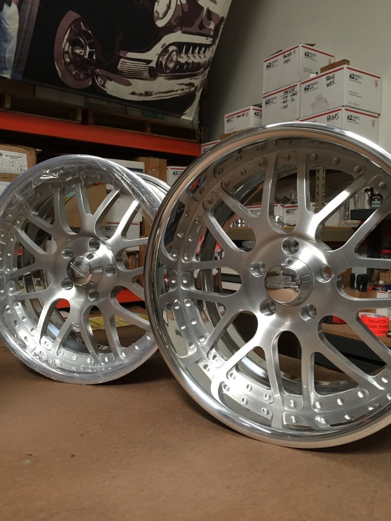

      These shipped today.
      Tires will be here tomorrow

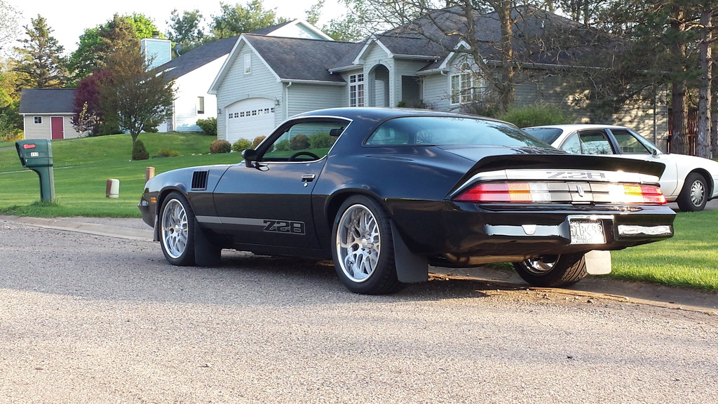

      86 Mustang
      454 LS3 Mast 4500 intake FTI cam Holley EFI Drag radials and pump gas 9.24 143.73
      79 Z28 Bonspeed GT-B DSE front and rear Z51 Brakes 5.3 Holley EFI Vintage Air

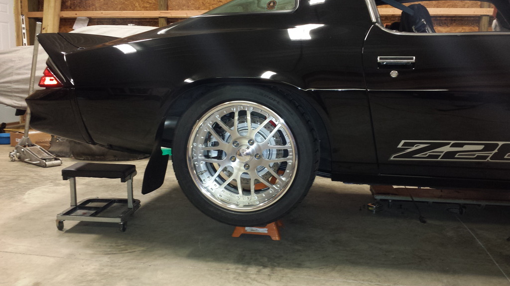

      It rides really nice. almost better that stock.
