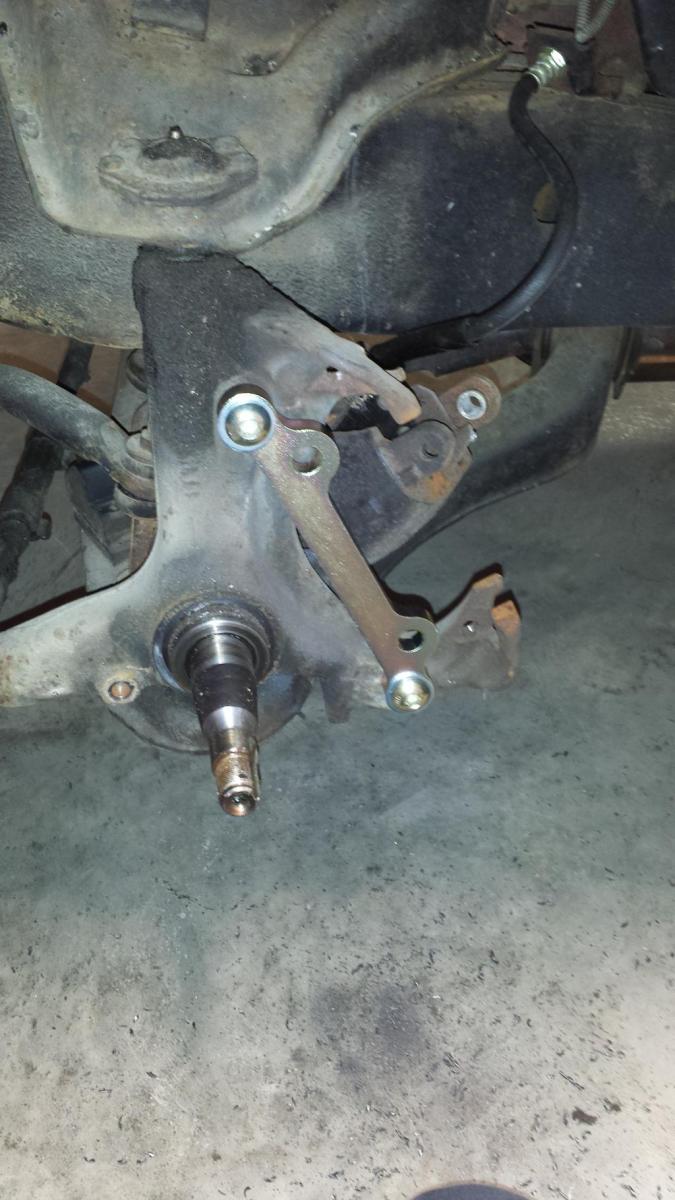

      Machined the rotors down to make hubs for the c6 brakes.
      Going to clean and blast everything to prep for paint.

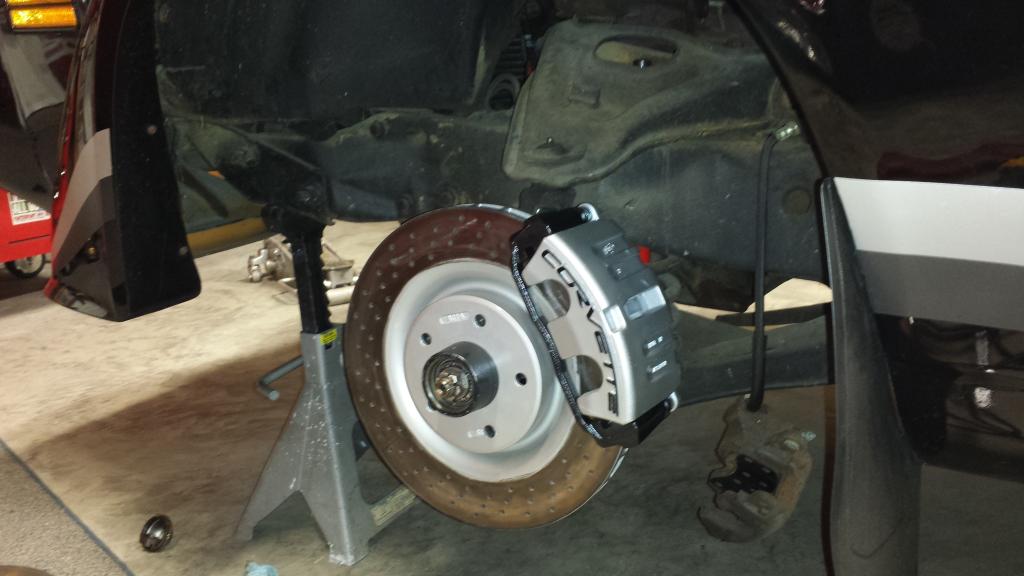

      I have been picking away at it a little. The rotors are cleaned up and centers painted. The calipers are painted.
      Spindles are modified and painted. Picked up a set of Hawk HPS pads. Mast oil pan. DSE 2" rear springs. Switch to put modern delay wipers on the car.

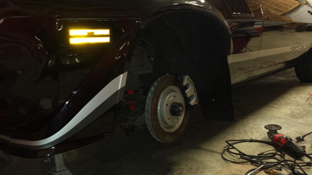

      Kore3 brackets installed.
      C6 ordered kore3 hubs friday.

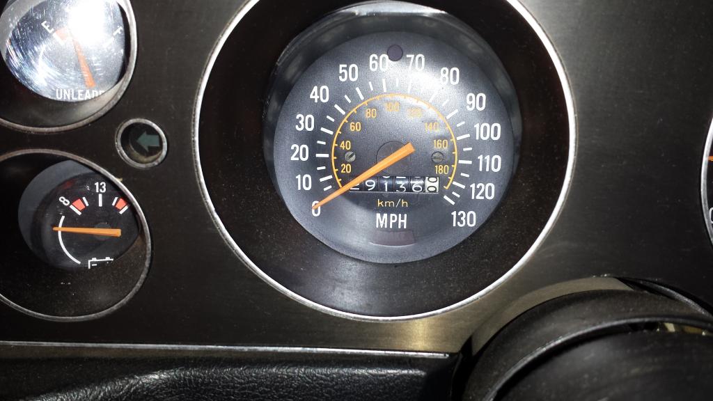

      Yes 29136

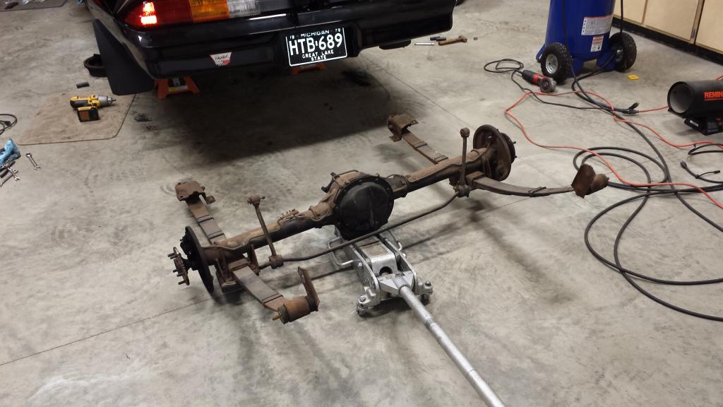

      1.75 hours the housing was on the floor.
      All the bolts came out with no hammer, wd-40 or heat.
      I picked up spring bushings yesterday those are going in the dse 2"drop springs.
      Have to get the housing apart and prepped for the brakes. Install the arp studs. Turn the axle flange down to fit inside the rotor. Weld the tubes and have it straightened.
