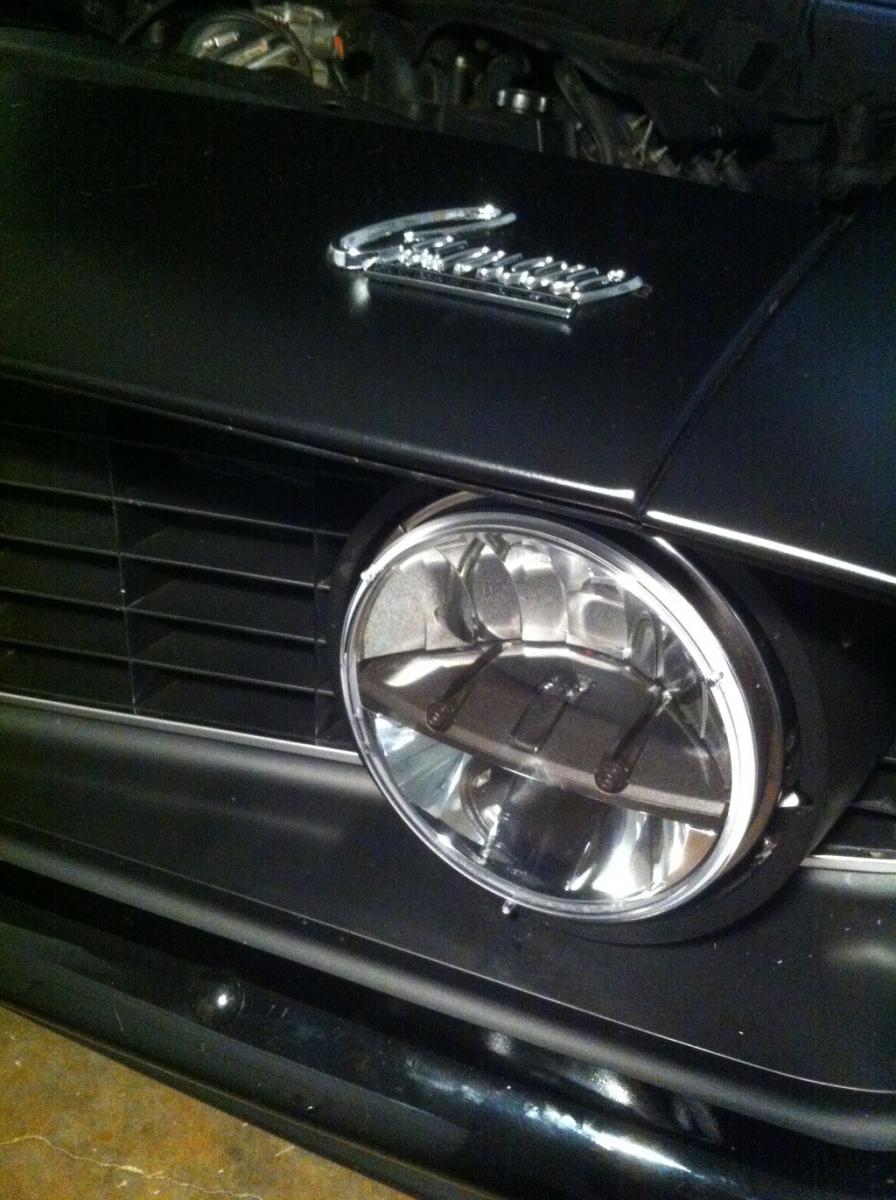

      I need help guys. I ordered the truck-light 27270C for my 69 camaro. Its not a direct bolt up. The chrome ring is about 1/2 of a inch away from the headlight bucket. Not sure how you guys are directly bolting up these headlights. Help anybody? Thanks Ray

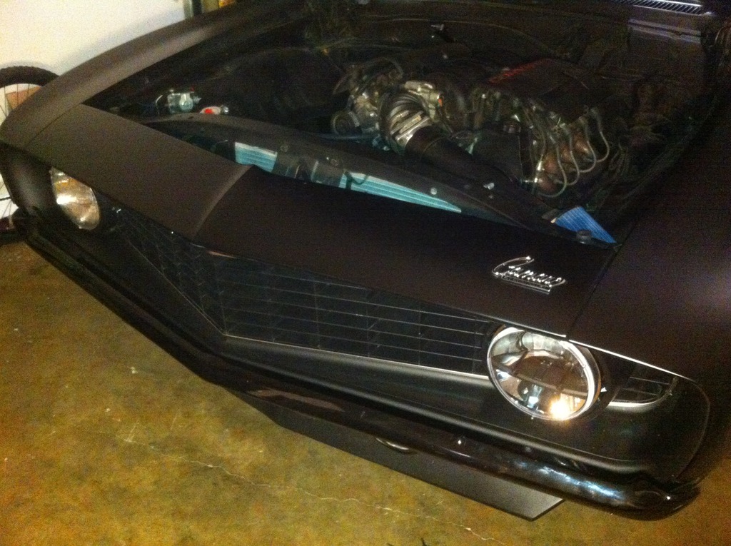

      I just figured it out. That beauty ring was a pain in the ass slipping over the truck light. Have it all mounted up. Looks great. Light output is freaking awesome. Lights up my whole garage.

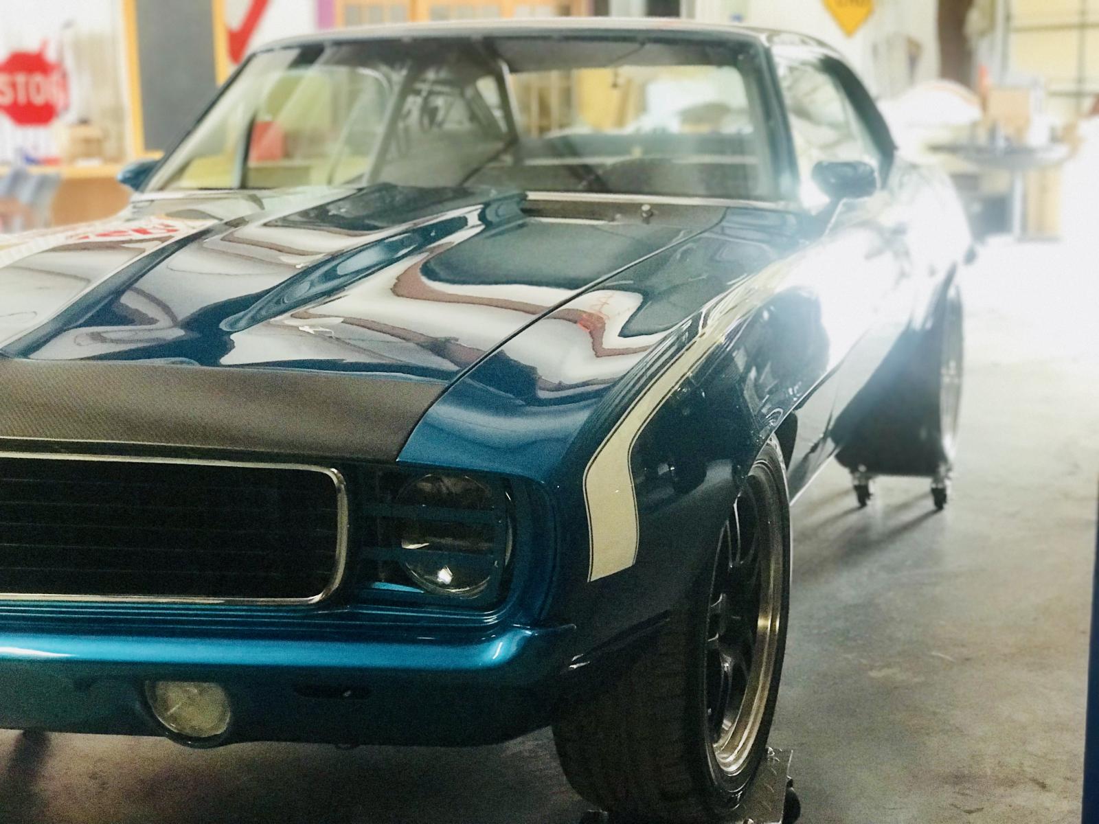

      Not on mine. I am currently going to cut the "grills" out of my inner doors and flush mount either a mesh, or tinted acrylic glass.Name:  E3EDA612-758C-4696-A97A-A1626009C984.jpg

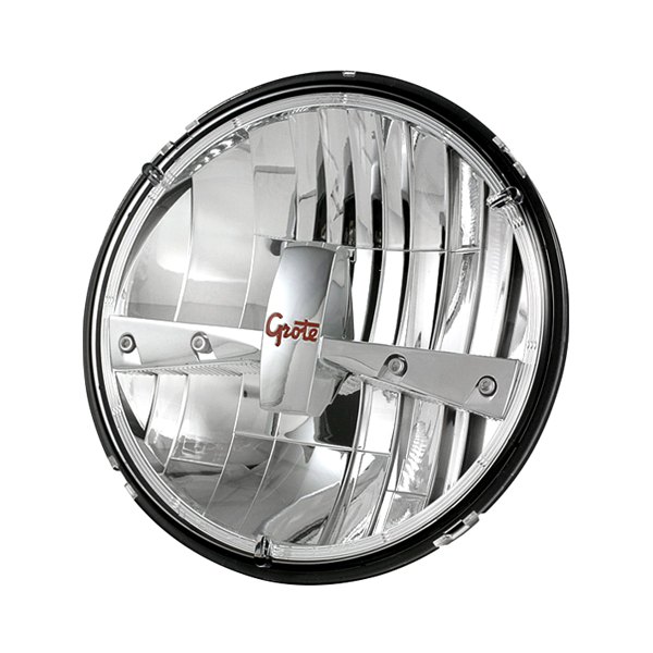

      anyone tried grote 90941-5? seen them on a jeep, they seem less flat than trucklite, more oem shape, may not stick out as much

      Update 69 RS headlights with lexan cutouts. Trucklite led
